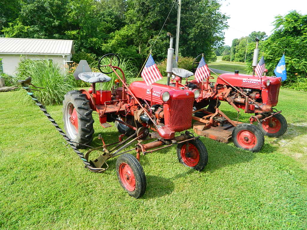

I have Delco alternators on both my Cubs. When I got them the 6 volt systems were in very bad shape so I went with an alternator and all new wiring. Yes the Delco alternator fits under the hood.

I have Delco alternators on both my Cubs. When I got them the 6 volt systems were in very bad shape so I went with an alternator and all new wiring. Yes the Delco alternator fits under the hood. View attachment 79994
