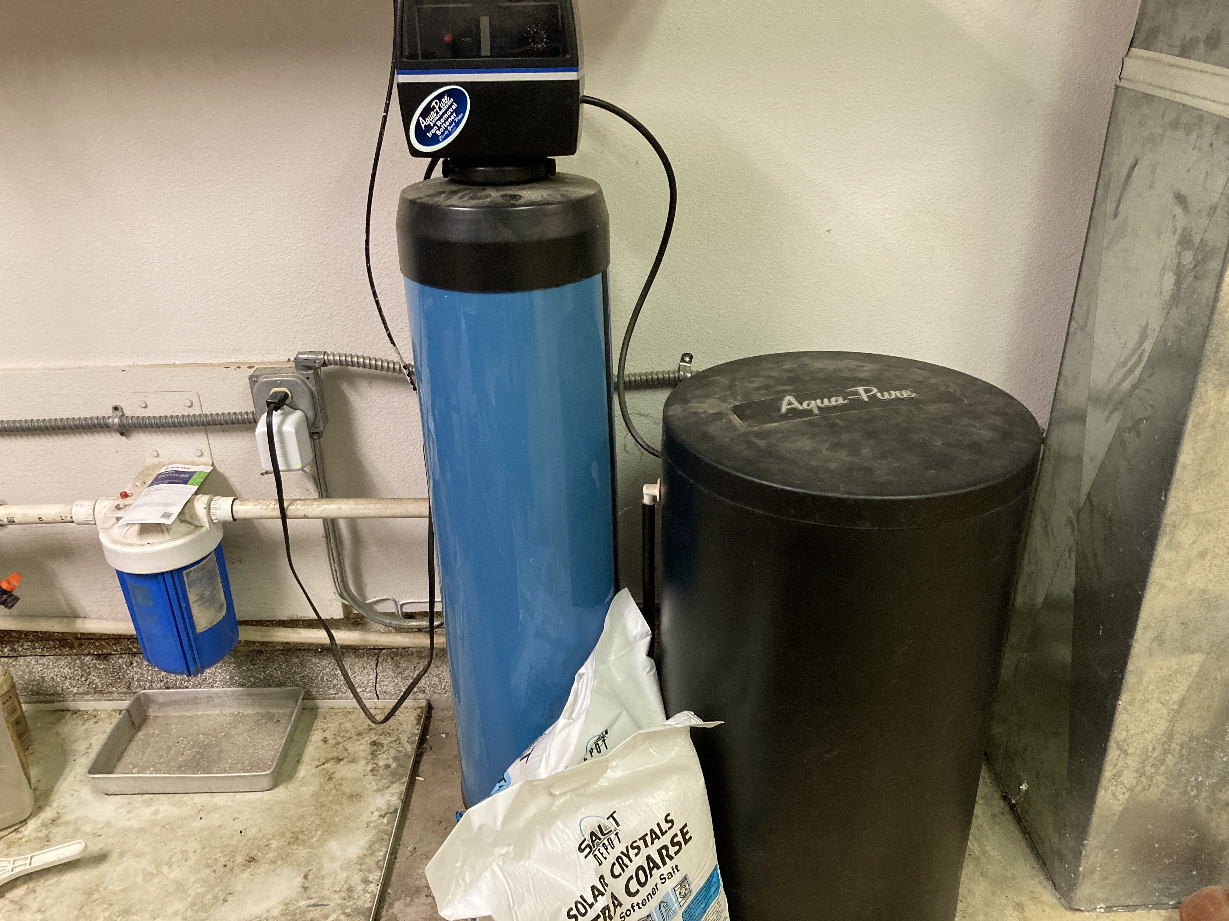

Aqua Treatment Services water softener. Regenerates based on volume. 10 years old and in process of replacing “the board”. No other issues prior to this.
5 micron particle filter on incoming water from tank.
