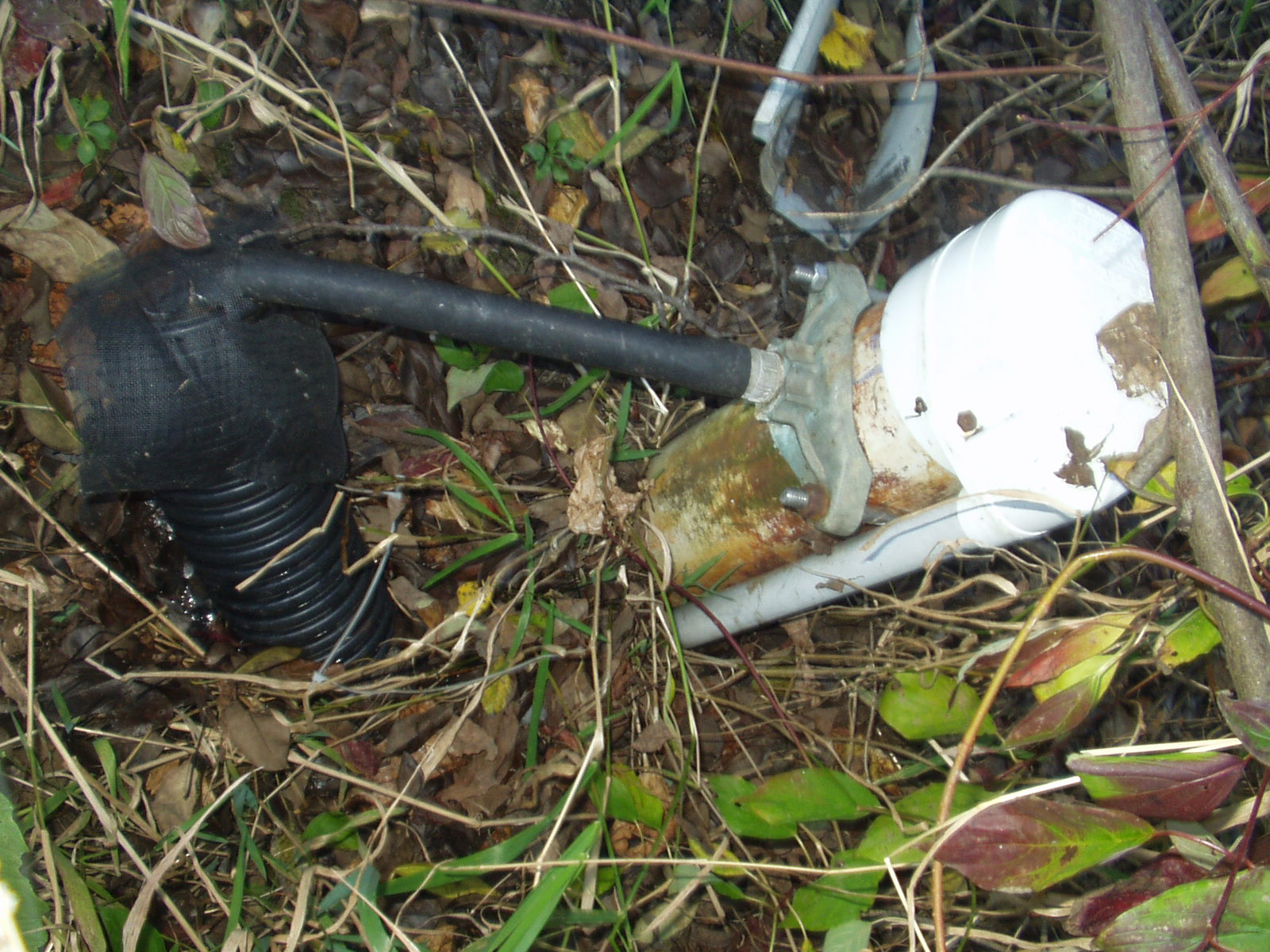

When I called the well people and told them it was doing this, they said "Ya, ok, that happens. You'll need to put a relief hole in the casing. We've got a part that will help you control where the water goes." I went in that afternoon and bought this:
They had that brass piece in stock, I bought it that afternoon. Seems odd for a one in a million situation ;)
I originally put a 1/2" hole in the casing, but it still oozed some onto the lawn. I enlarged the hole to 3/4" and it's been fine ever since. I will assume the size of the hole needed varies with how much force the water pushes up with.
And I had to improve on the 4 inch drain tile, as a nearby flowering plum tree found it with its roots and plugged it. I took a piece of inch and a half ABS pipe with a barb in the end with a galvanized cap on it (to keep it from catching on the corduroy inside of the drain tile) and pushed 125 feet of it through. That pushed the plug of roots out, at which point i removed the barb and cap and routed the water into that inner pipe. Been working for 15 years since the roots found it, and if I should need to replace the inner pipe ever, it will easily pull back out.
PS: as I said, I don't know how deep the casing goes. Bottom line - if water can come up that distance, it can come down too, at which point it merges with your well water. I prefer not to drink insecticide.
PPS: I am ashamed to admit, that piece of gutter has been laying there since the day I pushed the ABS pipe thru. In my defense, it's under a tree and hard to spot.
