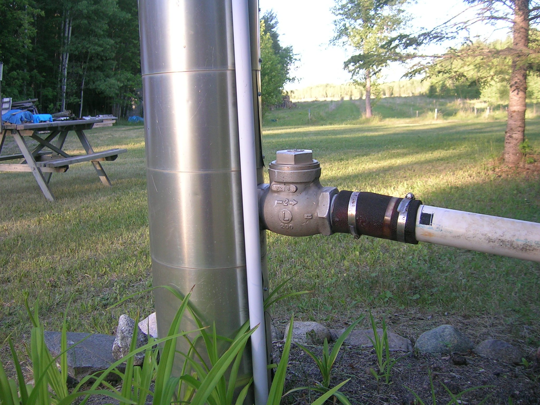

Our well at the cabin flowed over 50 gpm when it was first drilled, but that was a wet year, now most of the time it doesn't overflow, but the water table never gets more than 4 feet below ground level, the well is 65 feet deep. I added a section of casing to the top with a 2-inch nipple and check valve in the side, so when the water isn't overflowing mice can't crawl in, I have heard of that happening.
