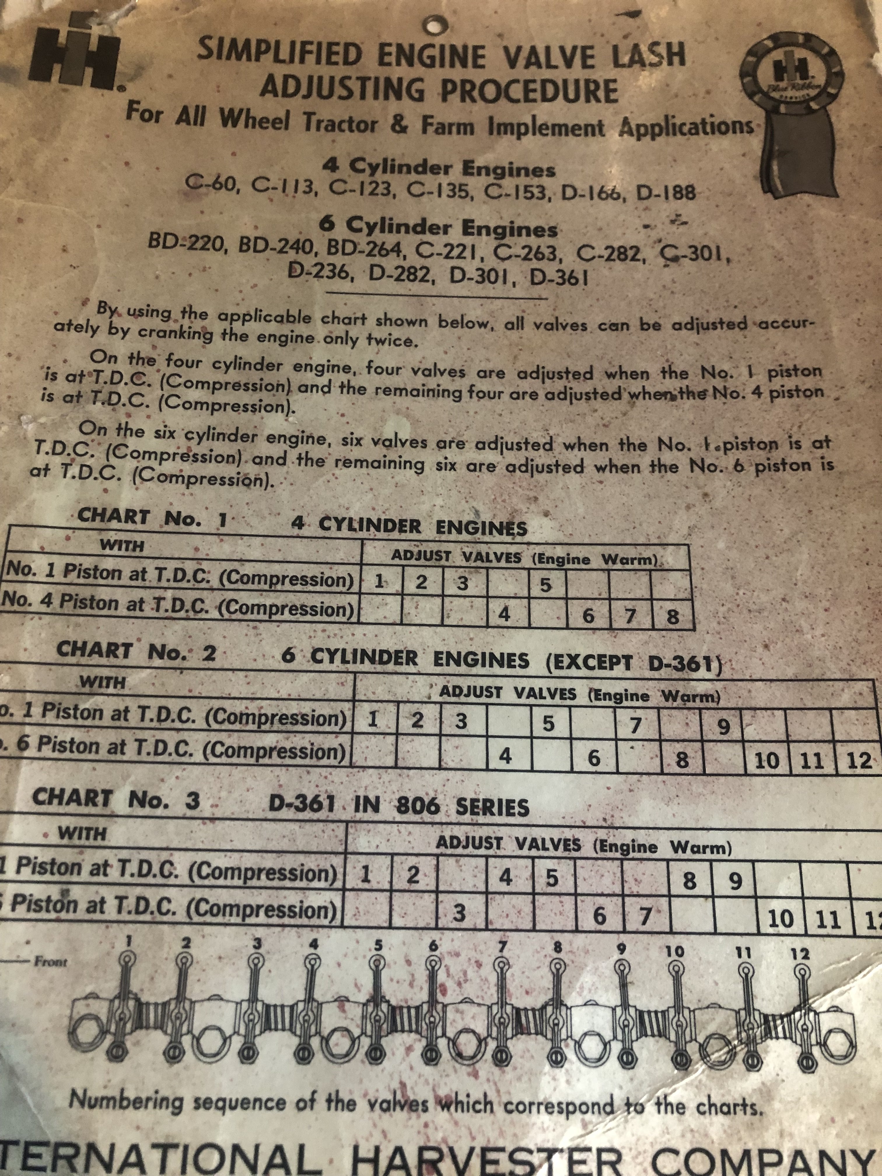

It sounds like you definitely have a little trouble understanding the concept of timing. The dots on the cam lined up per a diagram in a service manual? Or if there is only one set (one on each gear)then there is no question. And the key does all the alignment on the camshaft. Nothing else is timed until the distributor is installed. To clarify a bit about what cat guy said. If you set the engine at TDC compression for number one now with pushrods installed in the block you should be able to turn the engine either way off TDC and they won’t move. If they do you have to turn the engine one more revolution. Because it was at TDC for number 6.

i actually get tired of explaining how to set valves, as it appears lots dont understand the concept. all engines have 2 TDC'S . you need to have the adjusting cylinder on the compression stroke. to get it there you need to watch the running mate for that cylinder. if you have no idea what i am talking about then do this. write down the firing order 153624 the u write the last 3 numbers under the first three. 153 624 , now u have the running mates 1 and 6, 5 and 2. and 3 and 4 . sooo to set number one's valves you watch cylinder 6 so the valves are on the rock, meaning rocking the crank back and forth, both valves are doing exactly the same,... rocking. you want them valves in the centre of the rock, then you adjust number one's valves then you turn the engine following the firing order which will be number 5 cylinder, so you watch number 2's valves to be rocking. then set number 5 cylinder, and so on till done. totally fool proof when done this way , which is the industry standard the mechanic's use . the other way is the simplified method . so there is 2 methods mechanic's use. when i find my chart i will post that also. which will be simpler for you. no going wrong that way either.
