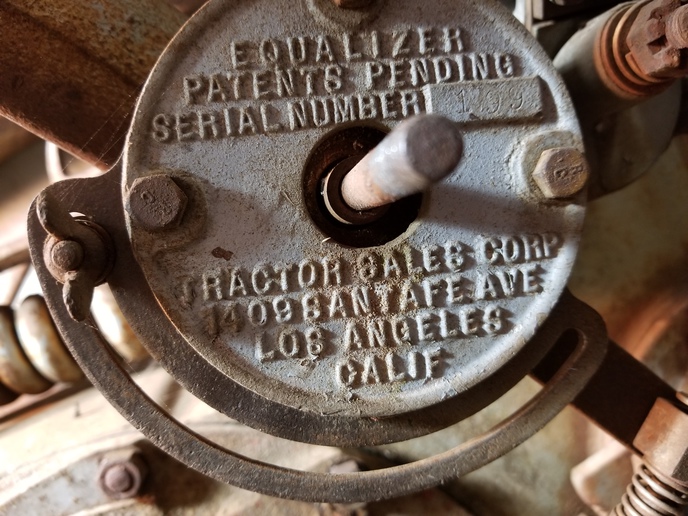

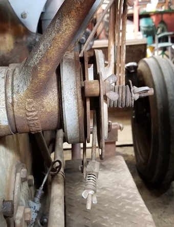

Hello, being new to Yesterday's Tractor Forum I posted an item on another section that seems more related to this HF page. This device is on a TO30 I purchased several years ago. I have not been able to get any information on it's origin or operation. It appears from information on this page there have been several different devices made. Does anyone have information on my device? Thanks for your help.

The device is an aftermarket position control that is supposed to keep the lift at the height it's set at. There isn't much too them and the description and instructions for a " Zane Thang ' ; a similar device might help with the information you need . Lubricate the joints and make sure they move freely , loosen the tension adjustment over the spring then re tighten it and it should work . The tension should be set once a load is on , start loose , then tighten until the friction between the plates allows the lift to remain at the height you want . Once set it is usually good for almost any load.

The Ferguson three point system is specifically designed for depth control of furrow not height control. The aftermarket height controls are literally for height control, not furrow depth.

This device should not be used with a plow which uses the draft control. It will be useful with all other applications
where a stable heigh position is desired. When plowing just disconnect the little rod.
