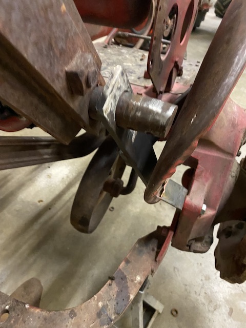

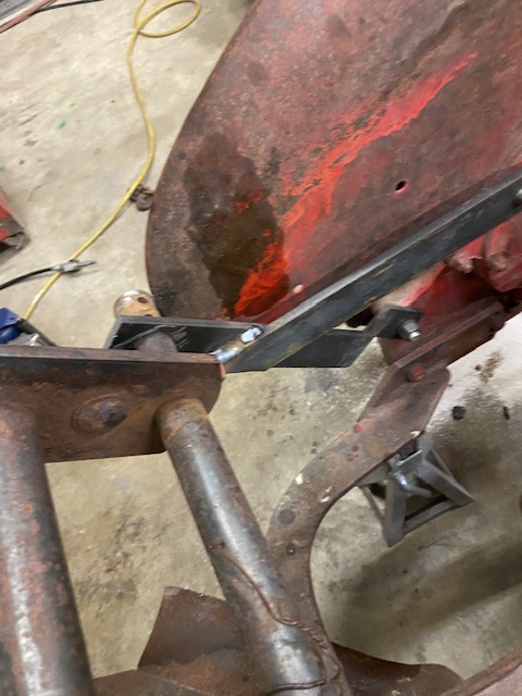

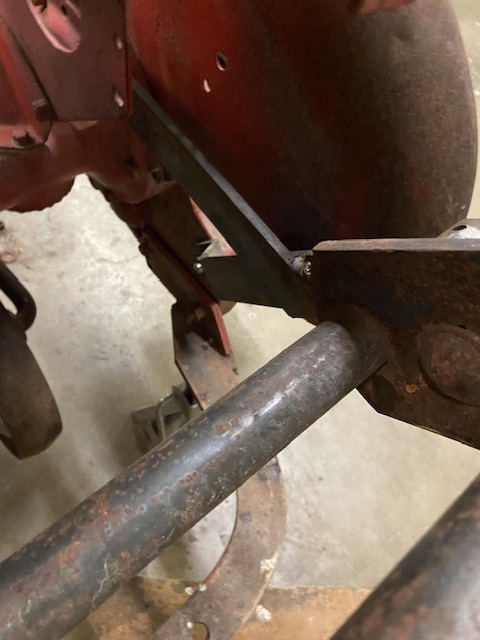

Here is my B, it has most of the plow linkage (and is setup with exhaust lift). In the photo, there is a blue arrow that I drew in, does anyone know what the bracket looks like that connects there? I assume it goes to the axle (as most pics I have seen, show the drawbar removed when the plows are attached.)
I would contact Steve Smith , he has a lot of books on ihc plows . He advertises plows, parts here. Hes in republic Ohio.
I think I have that setup for a single plow for the exhaust lift on a Farmall A at my house I will try to grab you a couple pics or you can run
out and look sometime. I think it is a pair of flat straps that bolt to the axle housing and have a hole large enough for the round shaft to pivot
in. Are you going plowing Saturday? Mike
is that the one that bolts to the final then to the rockshaft give me the
dimensions and size of the hole for the rockshaft i have over the yrs had
three of them email [email protected] or call 319 430 3907
(quoted from post at 21:41:38 10/19/23) I think I have that setup for a single plow for the exhaust lift on a Farmall A at my house I will try to grab you a couple pics or you can run
The B isn t ready, and our cub that has a plow is (but it s my wife s, and she s busy this weekend) and I don t want to break it. But I may go and watch.
