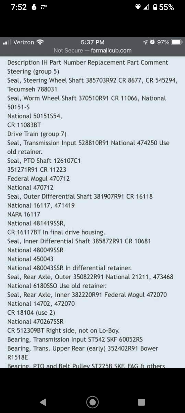

here is to hoping this is the last time i have to post about this tractor before it is all put together again but i am having a hard time finding the bearing for the spine shaft. later today i am taking the trans housing to a buddy of mine to press out the old bearing and will see if i can find a number but both this site or steiner seem to list one. any help would be greatly appreciated and if the bearing has a number i will post it here after bit.

Jim, the Messicks online parts catalog has a lot of positives over the CNHI version. Just remember for some reason when you post a link to it you are taken to the home page of that tractors parts book. So you have to call out the items, Category 04 -Drive Train, Diagram 07- Transmission
621 are you talking about bearing 11 in the diagram following Jim’s link and my details?
It is shown as ST542, not sure how woreout turned that into 6005z, I will neither confirm or deny the accuracy.
( inspected at least) Suggest you also change one in clutch housing also) one went the other will have flexed carry more load than design to . While you got it torn down . Save time and cost another redo, 70 year old tractor not maintain will need rebush oil slinger gear ,pto bushing , some more to check out.
Bearing 5 and if i can find them parts 4 and 6

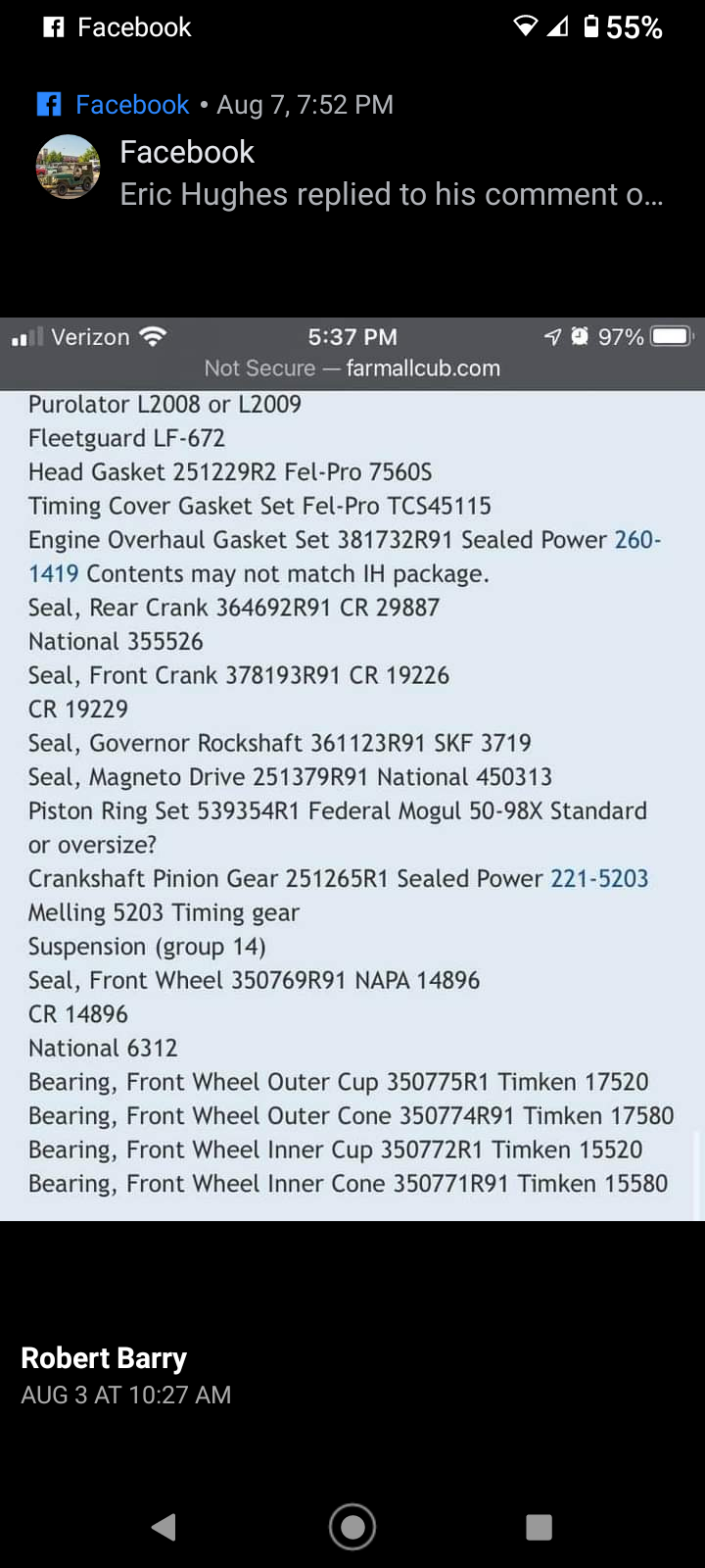

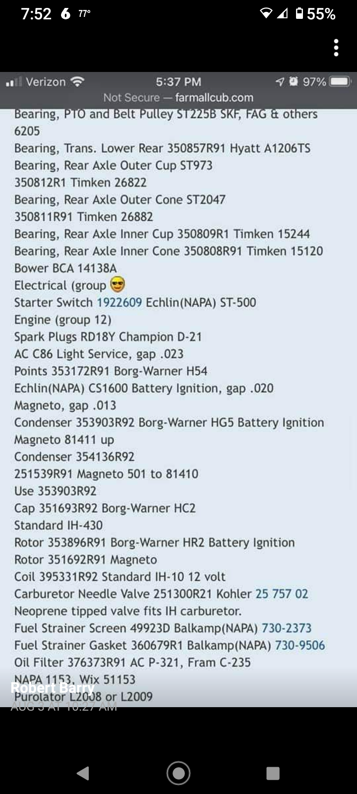

Maybe it's on
this list

Back in the 90s (or was it the 80s?) when I went through Dad's Farmall Cub transmission, I could get the front bearing on the top shaft from a bearing supplier but I had to go to a CaseIH dealer to get the rear roller bearing. I also notice that Cub Cadets (about 10 years newer than the Cub) use a needle bearing at the rear of the top shaft. So you have to know what bearing you need.
