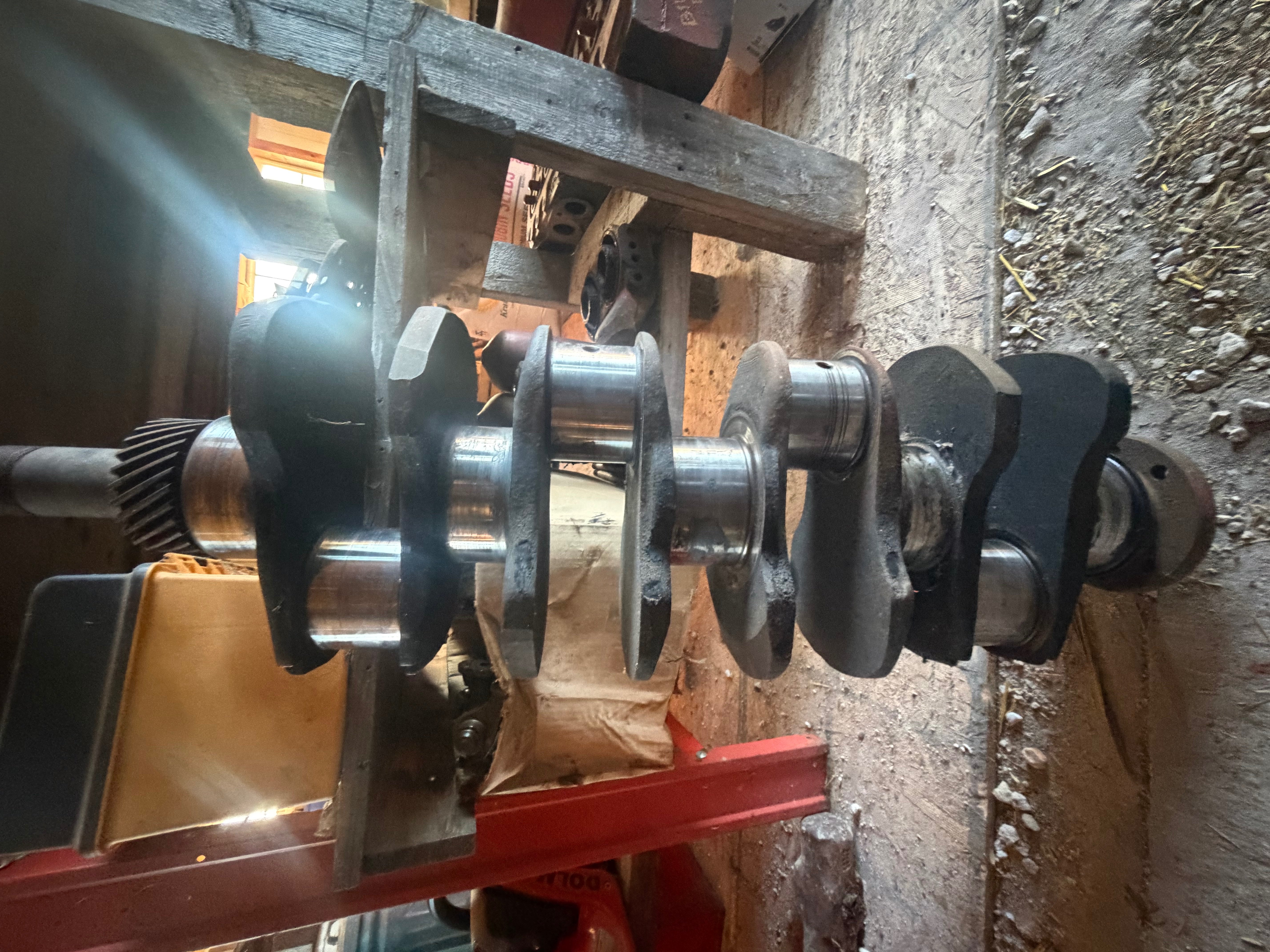

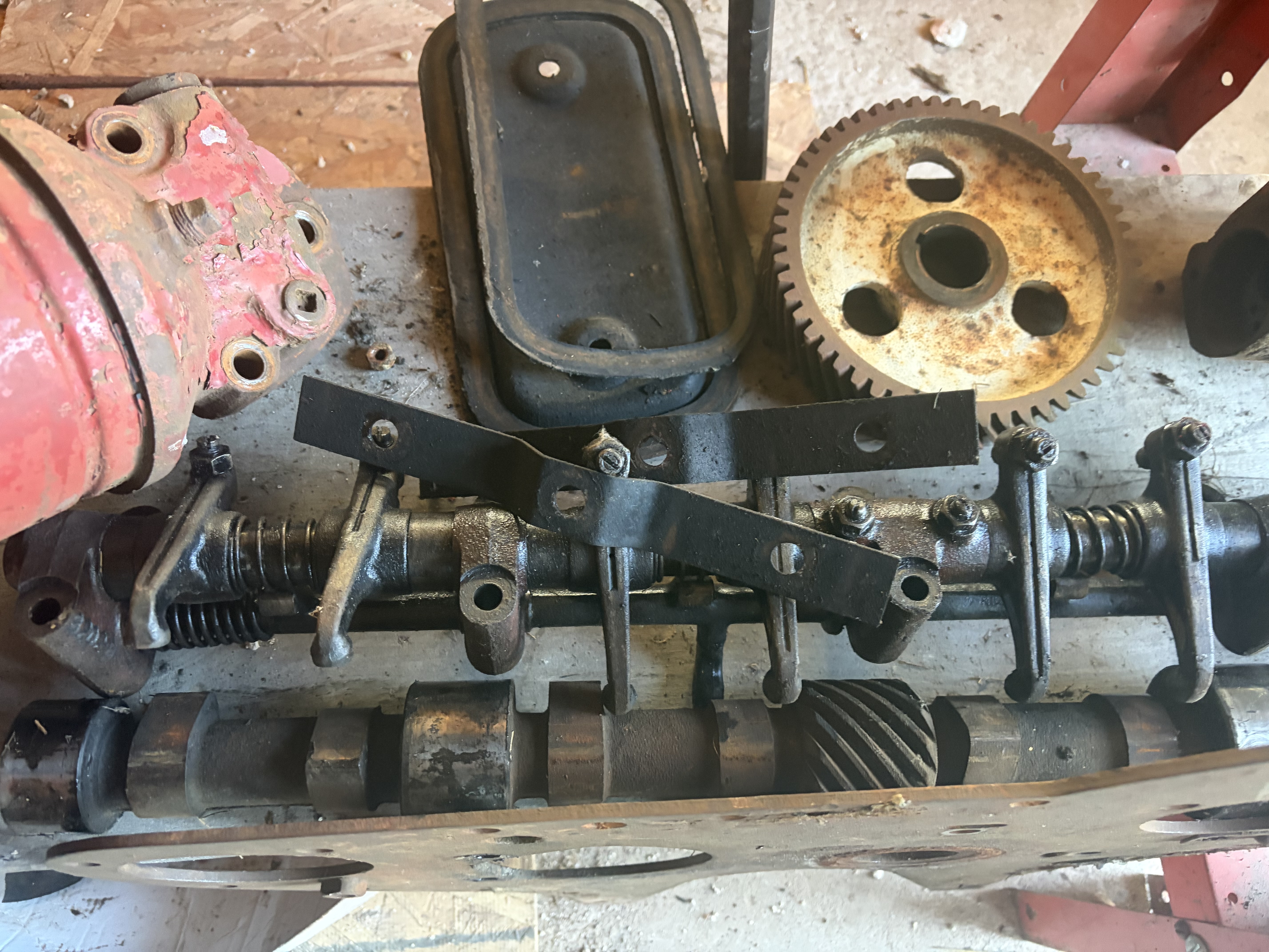

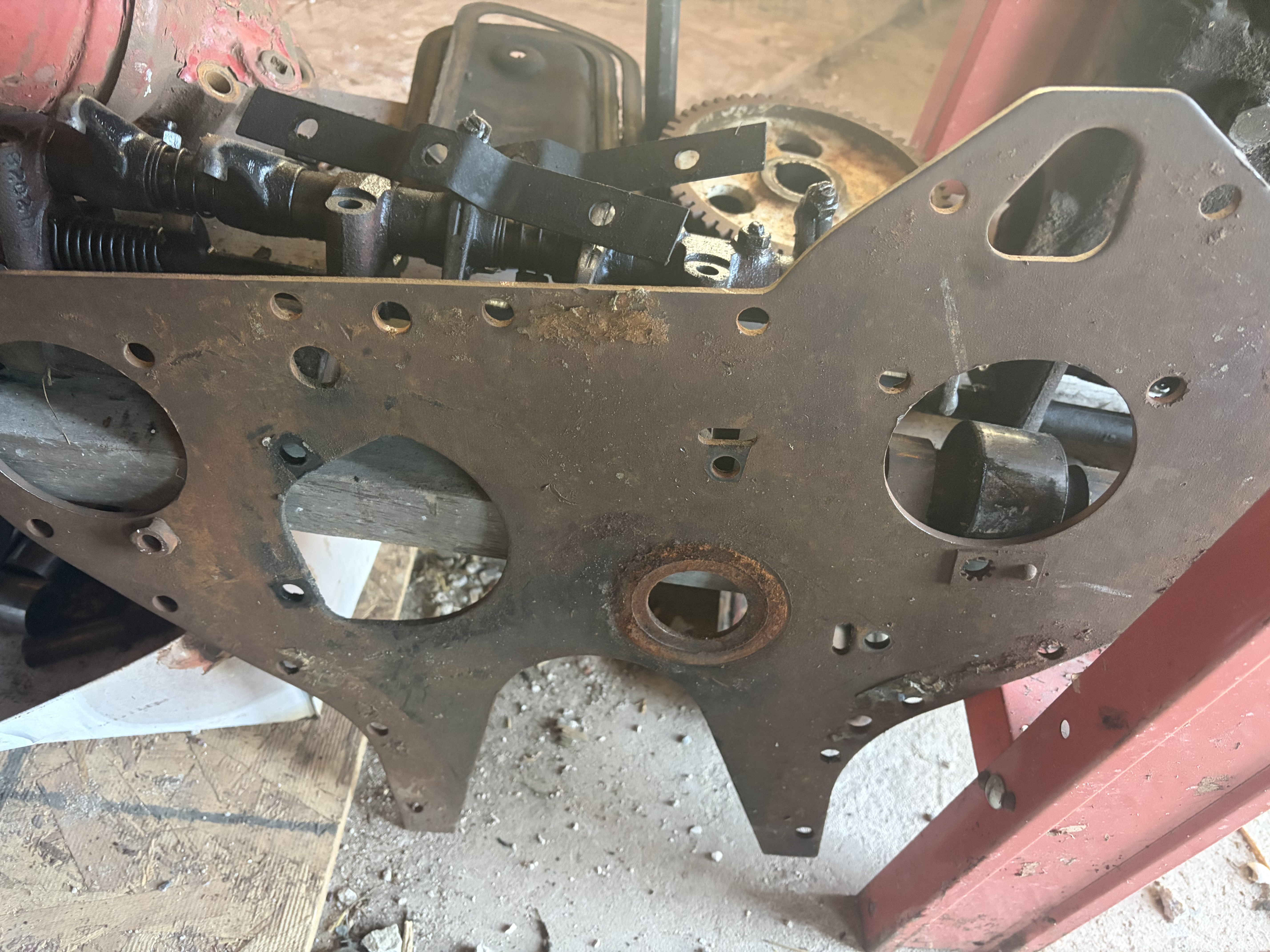

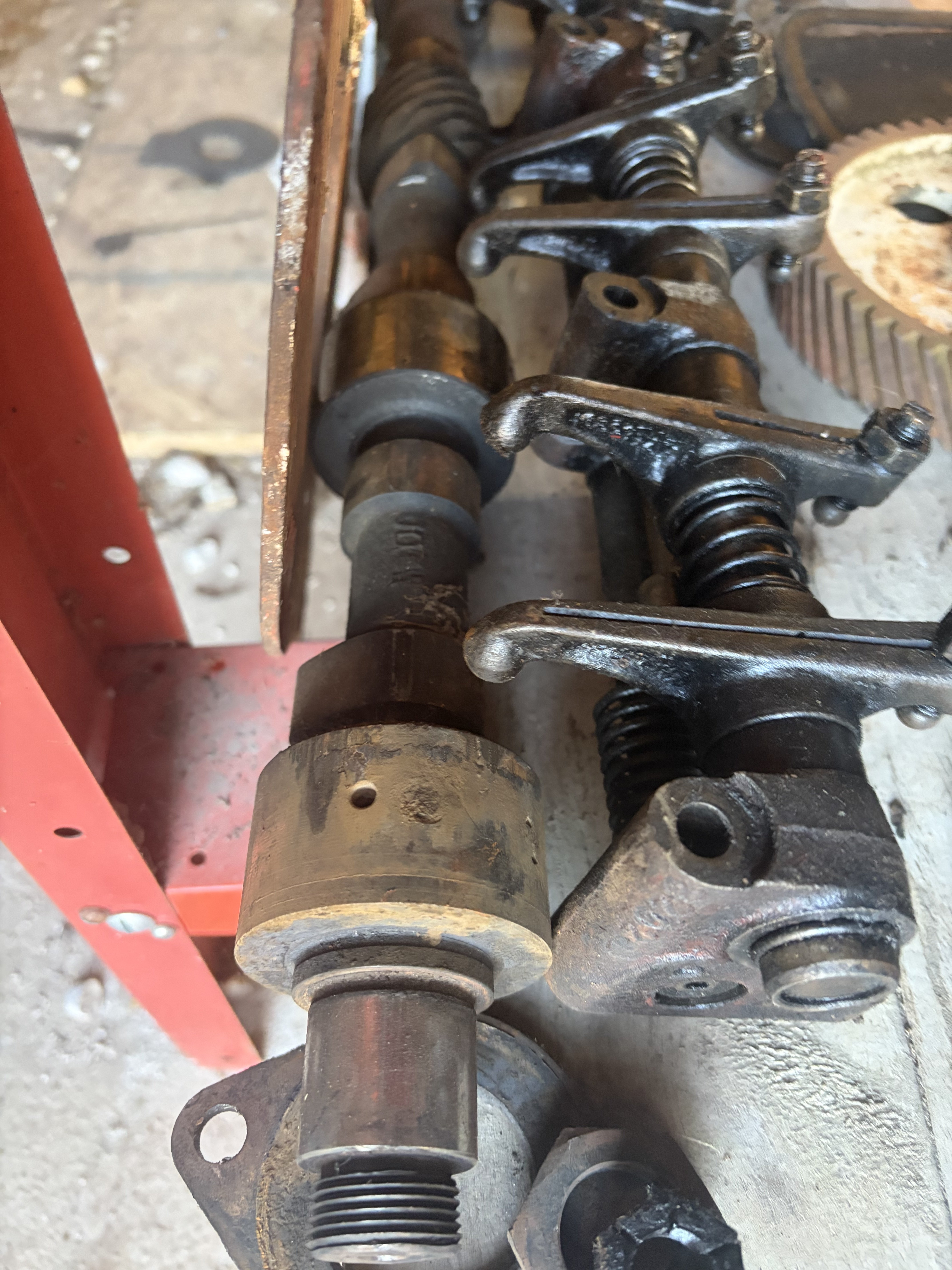

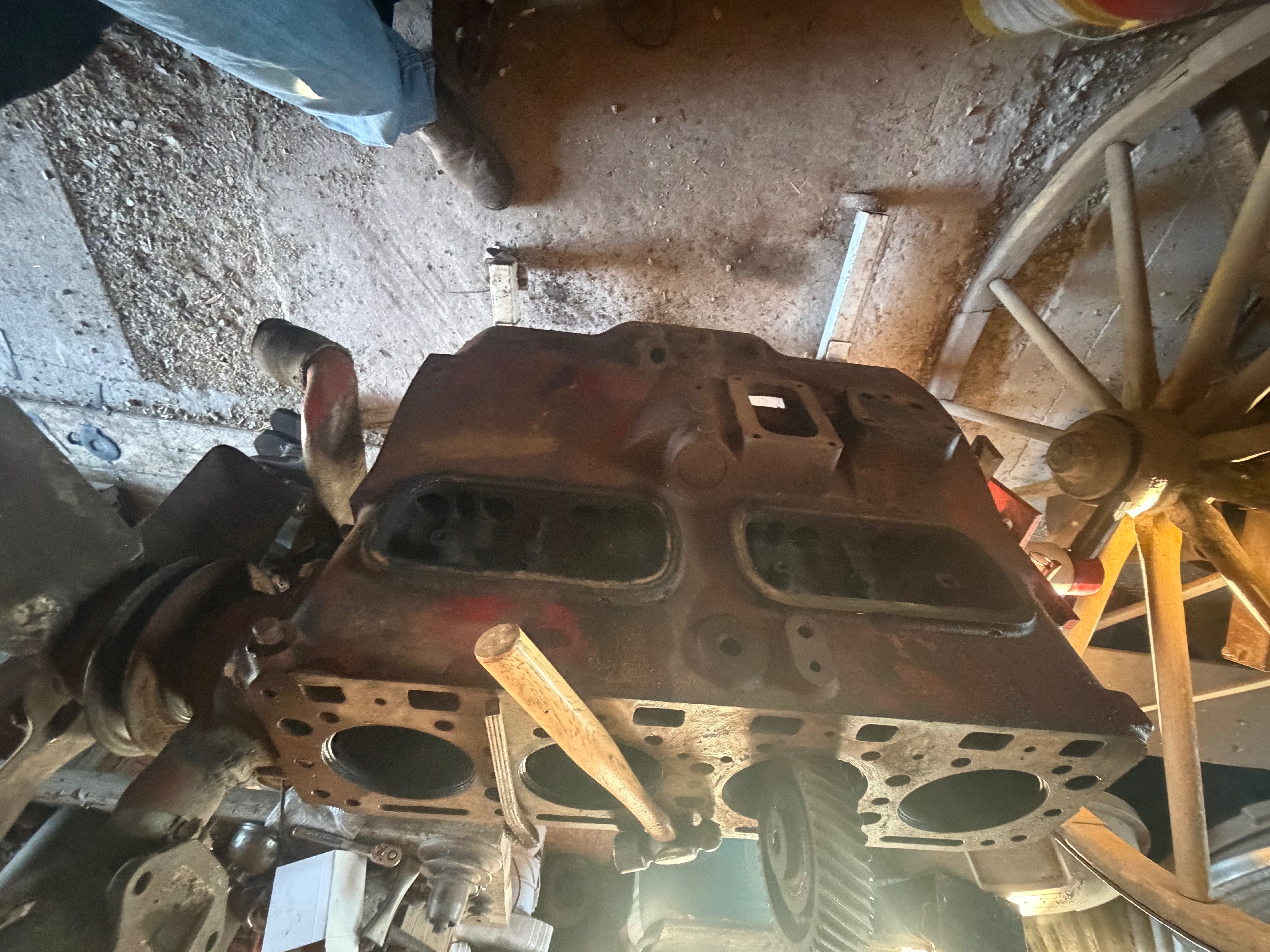

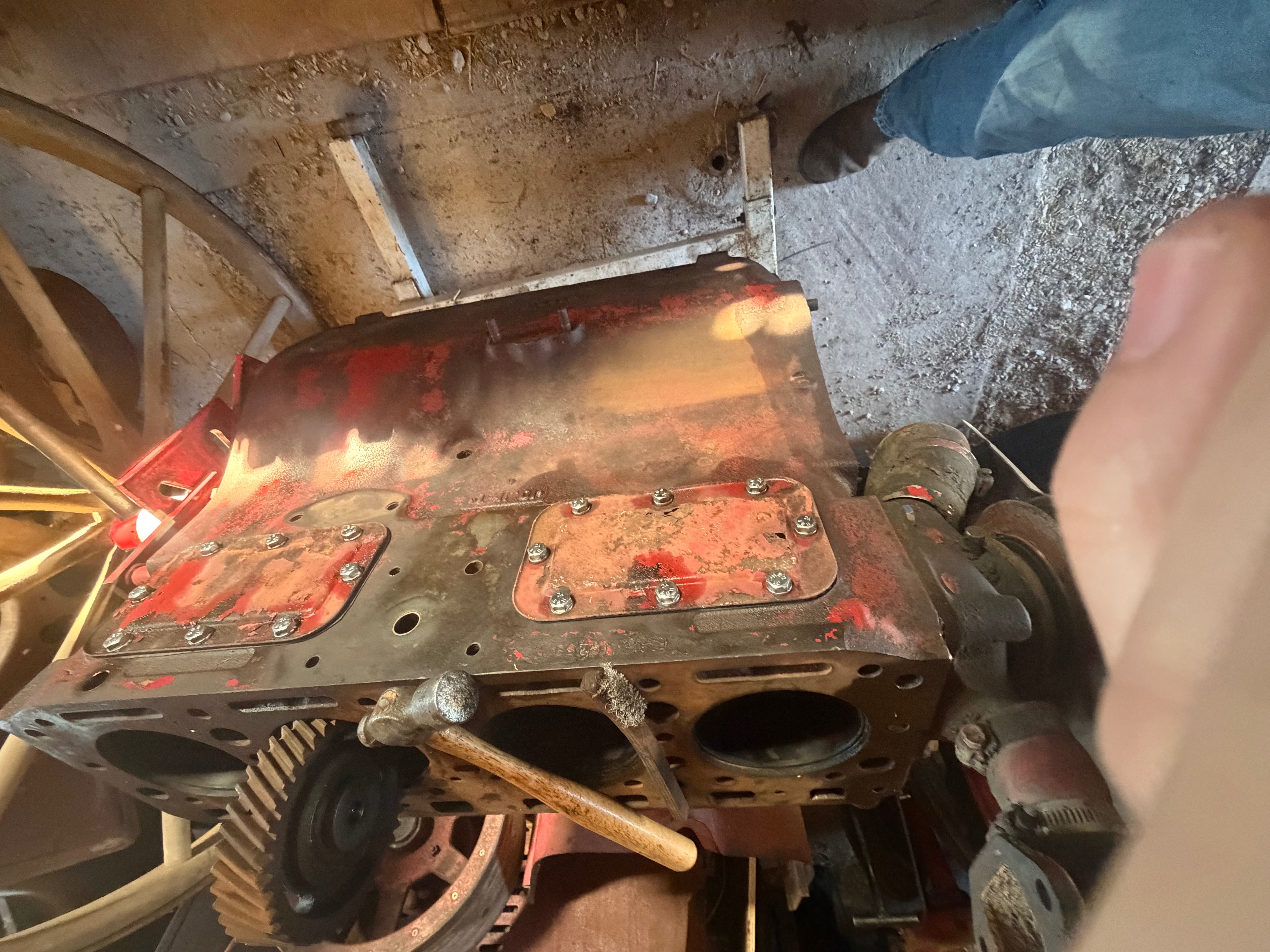

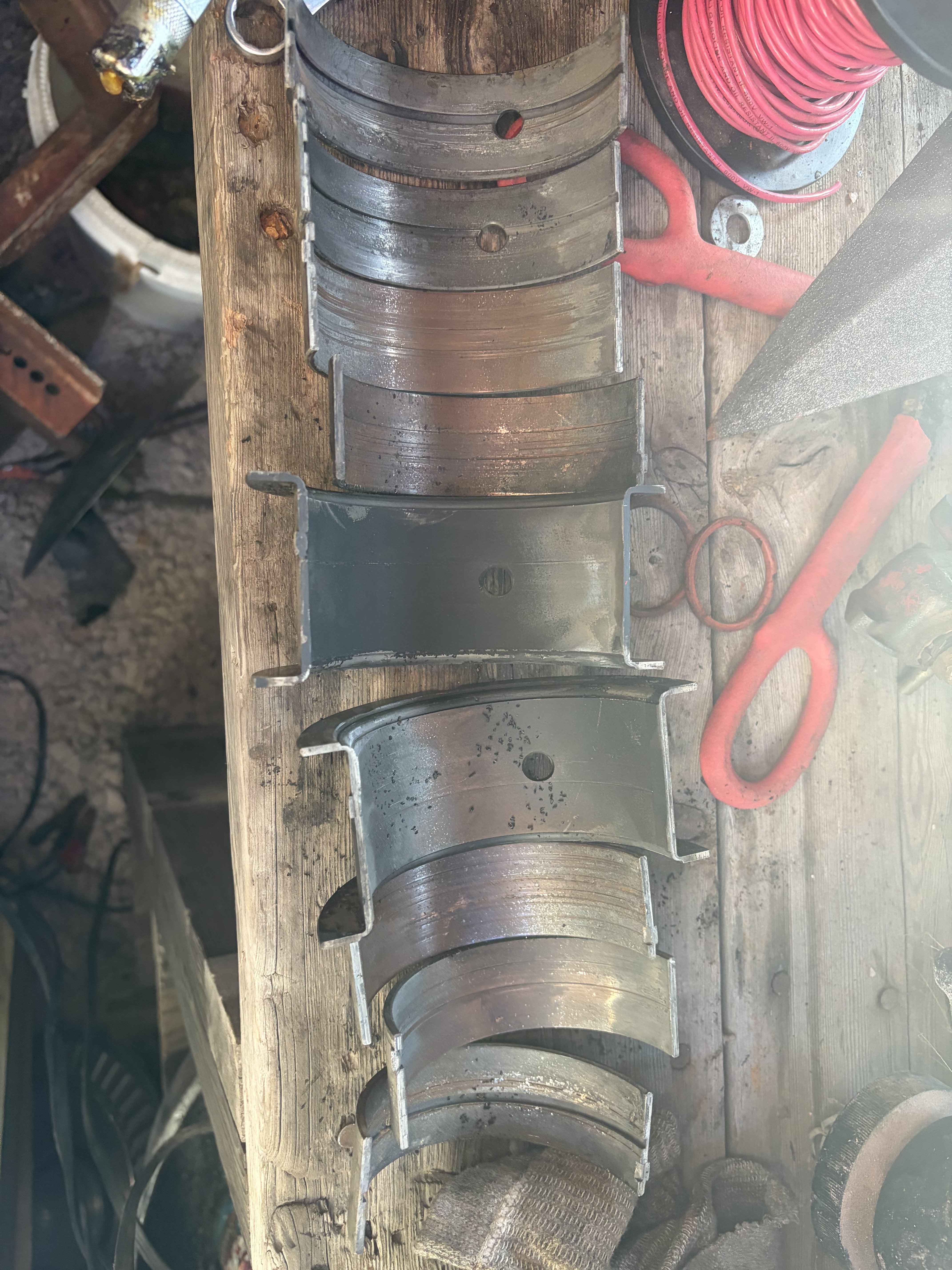

The only reason I would have it hot tanked would be to expose any cracks if any and the rust remover that we use does just that.
The cam was stuck pretty good in there and to remove it I had to take out the cam plug and use a big punch to get the cam out and that’s why the bearing came with it and yes I know that the holes are supposed to line up and that’s why they make cam bearing tools. I’ll try to take a picture of the crank,cam,tappets and bearings tomorrow if I have time.
Better figure out a way to clean them oil galleries as that is one reason blocks get soaked before rebuilding. Least get it to a car wash with hot water and soap. And make sure it’s blown dry as to not rust. Kinda nice to work on a nice clean block.
When you get your bearing rods,mains and cam bearings make sure you measure or verify that they are correct size ordered.
Because the wrong parts can be put into the wrongs box. Don’t trust the supplier.
Parts cleaning gas and air hose works pretty well and there was no rust in the oil galleries .
Here’s some pictures.

From photos cannot see surface of rocker arm radius contact to valve to stem , suggest resurfacing.
The Three and four journals from photos look like bearing surfaces are not real good .
I also suggest ring the crank with brass hammer for solid ring tone . This will tell if it is cracked
I also suggest the same ring test for the camshaft . Care, do not drop the camshaft it will shatter.
The crank can be welded and resurfacing to perform.
Cam can be resurfaced . https://www.camcraftcams.com/contact/ possibly
Don’t know how far you want to take this projects just some ideas to be looked at.
Press ahead with you project .

Thanks for all the information I think you some good ideas, and I saw those spots on the crank to so l was thinking there was a couple more cranks at the parts yard where I got the block and I thinking of getting one of those and same with cam.

I’m planning on doing more than a little bit of work with it so I going have “as good” or “better than new” because I know what I have in it then.
