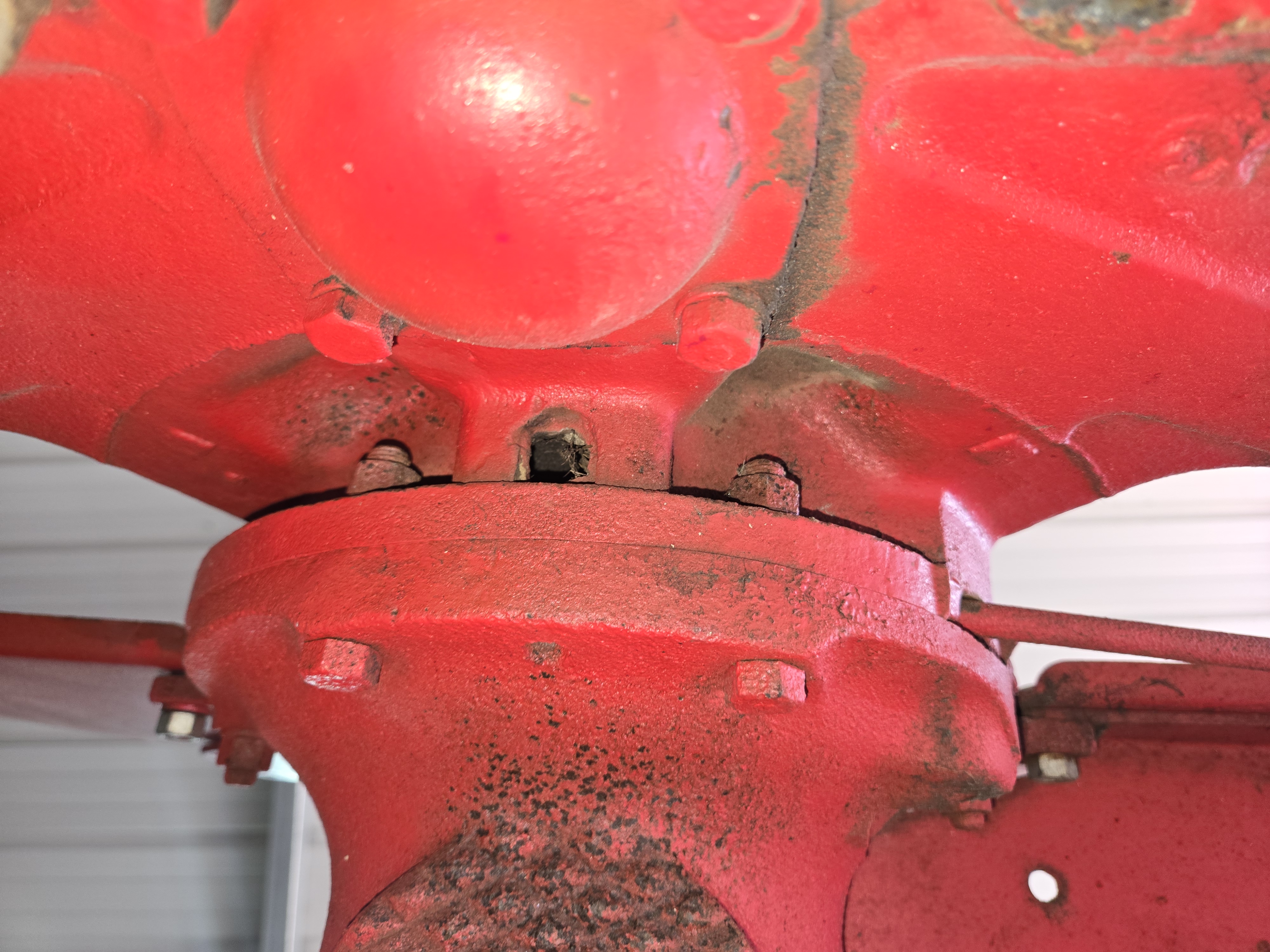

There are three holes under my Farmall Super A. The one on the left side runs transmission fluid out of it as fast as I put it in. Is there a plug that is supposed to be in these holes?

There is no plug there - just a way for mice to climb inside. Sounds like the seal behind where that hole is is shot. I've never heard of one leaking oil as fast as you say but when the seal is bad it will leak oil and eventually come out that hole. Probably brake band is oil soaked also. Maybe yours is leaking so fast because it is way over filled. Have you checked the oil level? I don't recall for sure but I don't think the oil level is so high as to be covering the seal.

On the side near the center of the tractor next to the main gear case the seal is number 26 in this linked diagram. I am not to familiar with those model of tractors so maybe someone else that is can tell you why there are 3 different options.
CNHI Farmall Super A parts diagram I suggest just to just X out of the options to choose a dealer.
The axle and final drive assembly just slides out once you have it all unbolted. You’ll want to unbolt the wheel and use an engine hoist to lift the final drive to remove it.
On the outer final drive end there is also a seal which looks like where you are leaking the most. On the parts diagram at the top Click “Chassis” by the arrow. Then select diagram 172, part 9 is the seal for that location. Again there are 3 options. Also the seals are no longer available from the dealer so you will be using the numbers to cross over to find them. I think YT has the seals, I suggest calling them to get the correct ones. Also as mentioned by Charlie you will probably find that your brakes are oiled up when you get it opened up.
Agree with both other replies. I agree strongly on it being overfilled. Crack the drain plug open and see how much water you get out of it. Only fill it to the level plug which is on the left side partly obstructed by the brake rod. There is a picture of the plug in the Owner's Manual. The 3 different part numbers on the seal are just replacement part numbers. The "D" number is probably a thick leather seal. The others are probably neoprene. You should be able to cross reference from any of them to a standard seal number.

Transmission is probably way over full. Most likely water ( condensation) oil floats on water,gets pushed up and out. Those seals are much better at keeping dirt out than oil in. Drain the transmission, leave the plug out overnight ( let's 99% of the sludge drain) then refill with 80/90 or thicker gear oil. 4 or 5 quarts, depending on if you have the 90° gear box. Leak should stop, the proper amount of gear oil never gets high enough to leak 😔

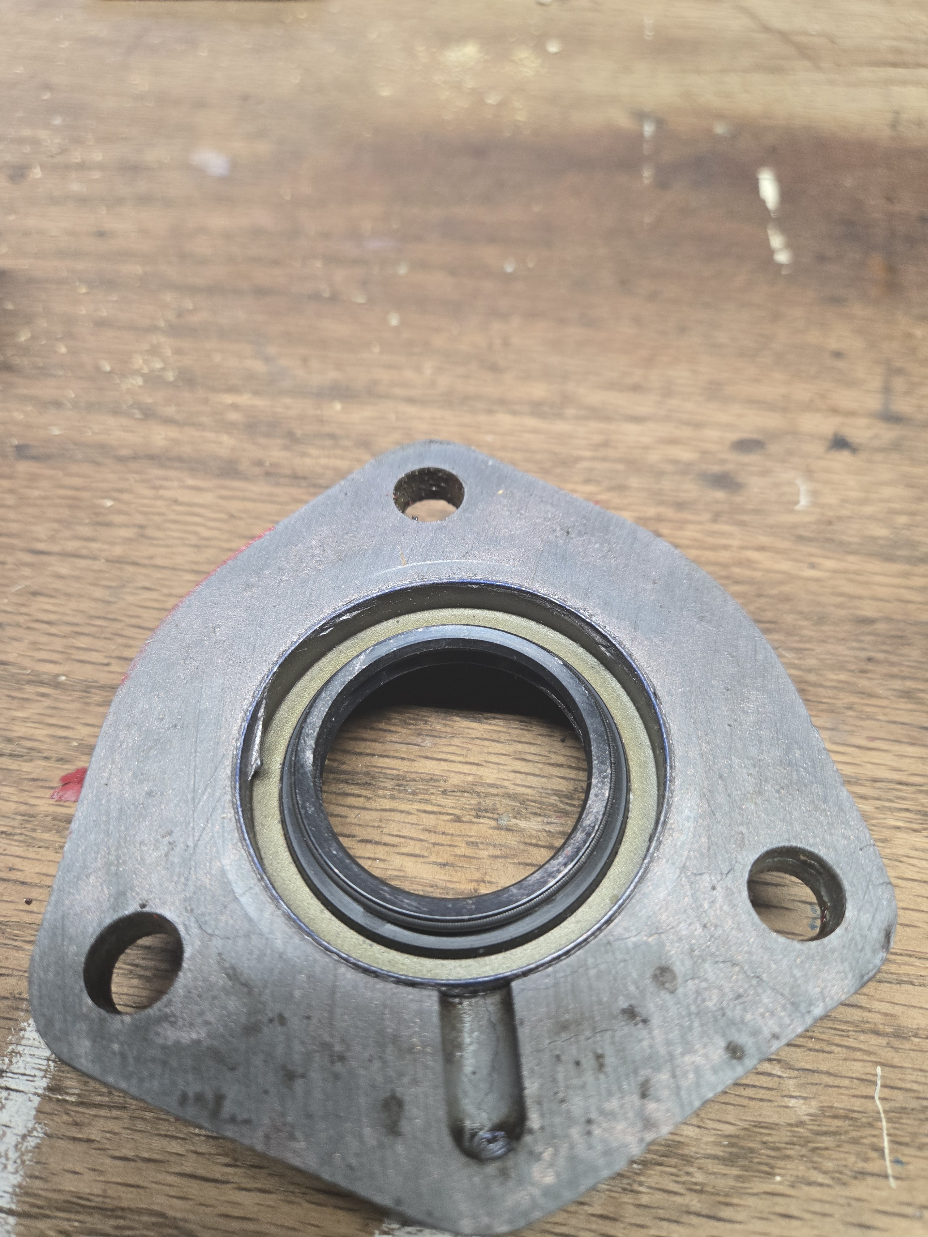

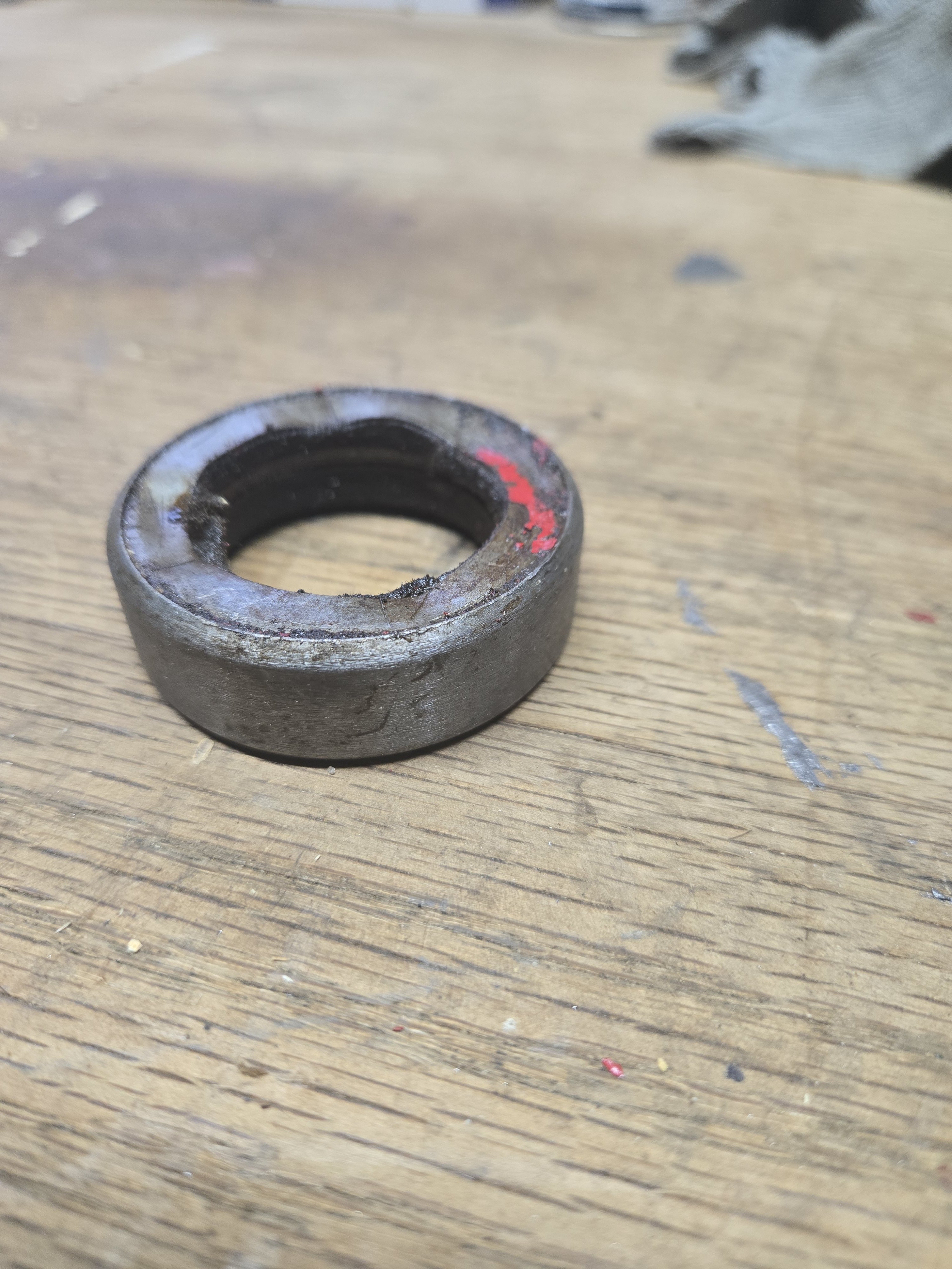

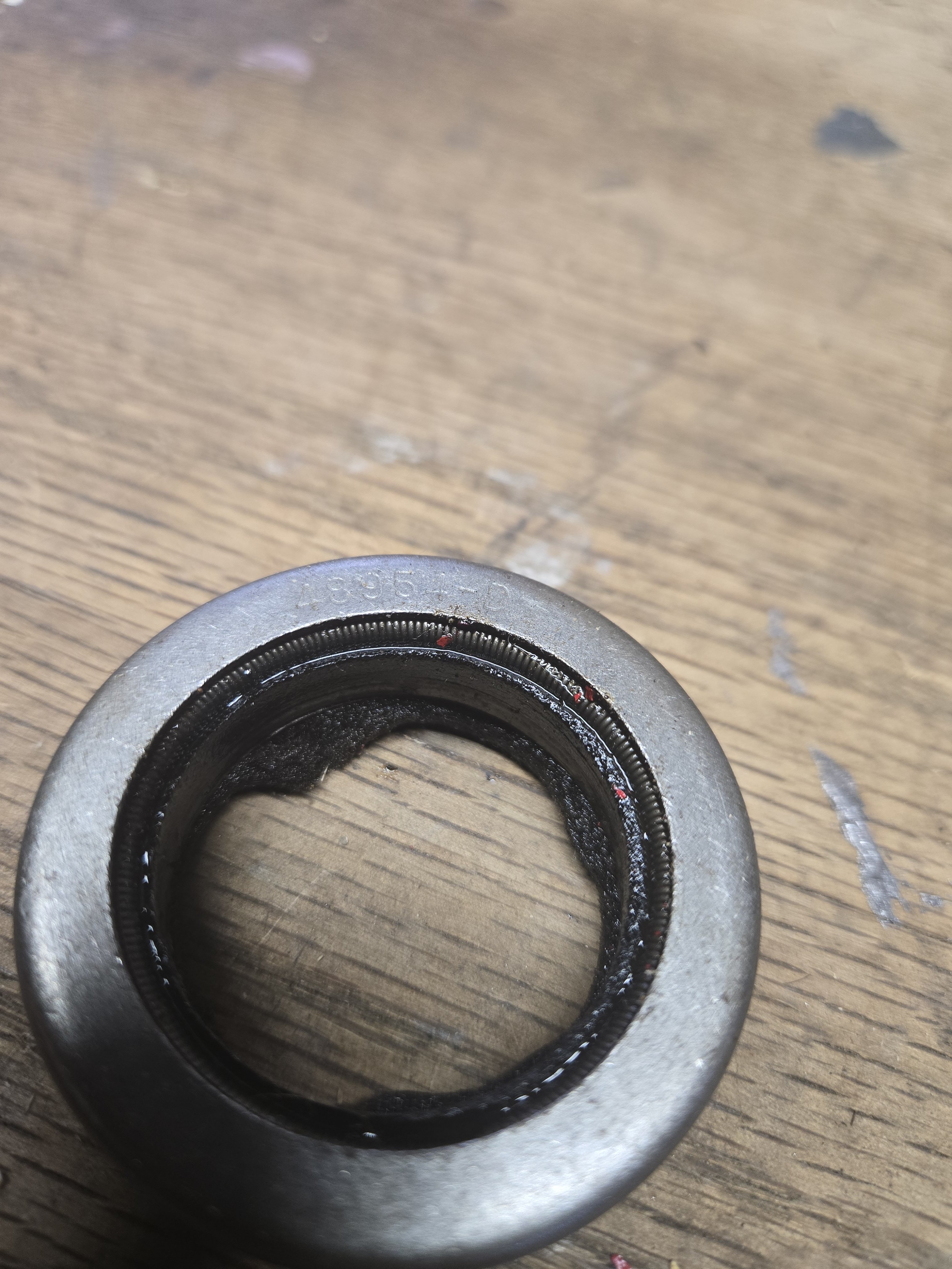

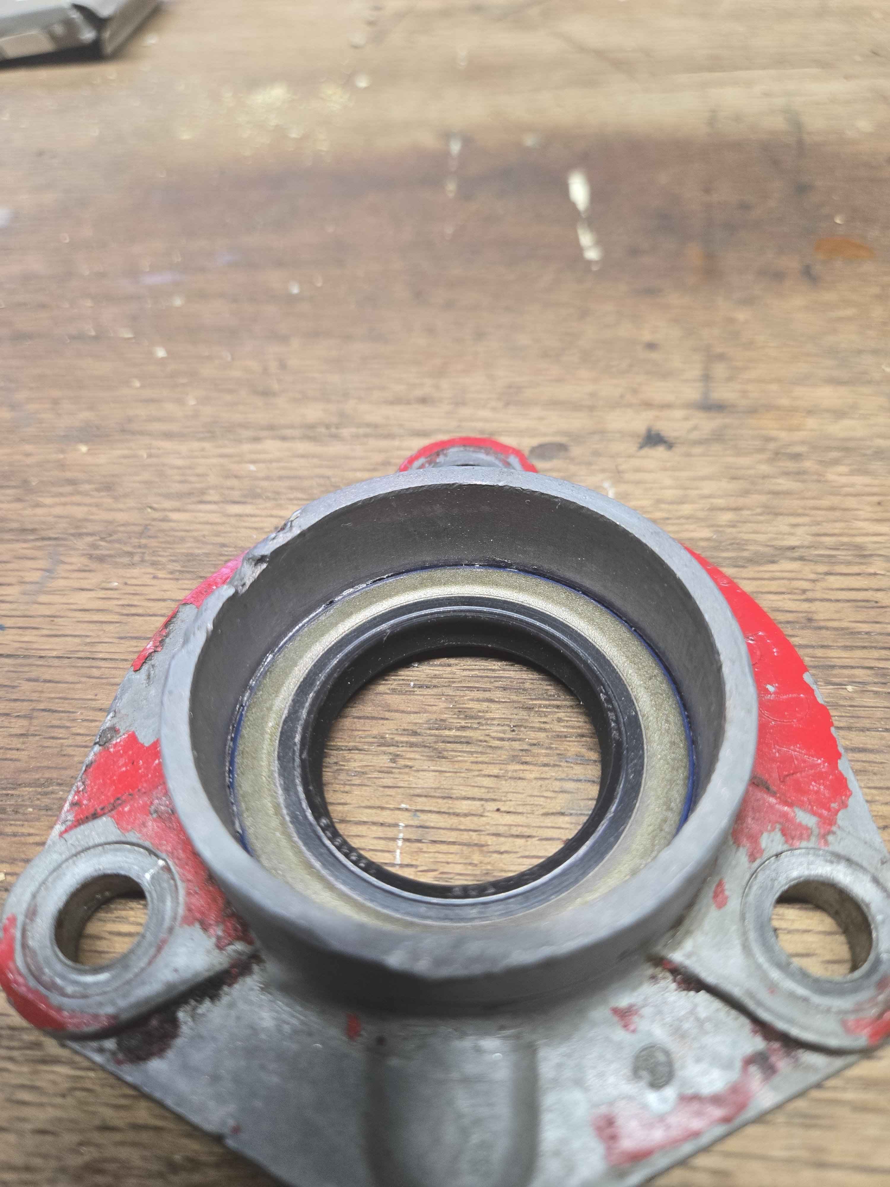

Thank you for all the information. I drained it overnight and that corrected the problem.
The belt pulley seal was also leaking I took the number off the seal (48954-D) and ordered a seal for it. It is a complete different size (thickness) than what I have originally. Is this correct or what do I need to do to fix this problem.

Modern seals are a different thickness,it's fine

The sealing part of those original seals were leather. To shape the leather to seal on the shaft and form it to be clamped/stamped into the seal housing they had to be made physically thicker. They lasted a good long time though.
They sure did. Doubt this one lasts that long
