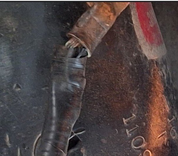

Jim I thought you were talking about my jumper cables but you are talking about the battery cables on my tractor. Those cables and the one from the switch to the starter came with the tractor. I'll find some 1/0 like you said. Saw Rons picture and it dawned on me. Thanks again.
I was referring to the cable end connected to the starter stud. It appears to be a very poorly crimped end and appears to have been heating (sign of high resistance) in the past.

Your picture shows the positive battery cable is connected to the engine block flange right below the starter, that is good.
The end of the battery cvable that is connected to the starter stud appears to be a very poor connection, that needs to be fixed/replaced.
For a 6-volt system 1/0 battery cables are best. It may be the pictures, but your cables appear to be smaller gauges than that. Many over the counter premade cables for 12-volt cars are only 4 gauge, some maybe 2.
And I agree the starter needs to be looked at if it won't try to turn with the booster cables hooked up.

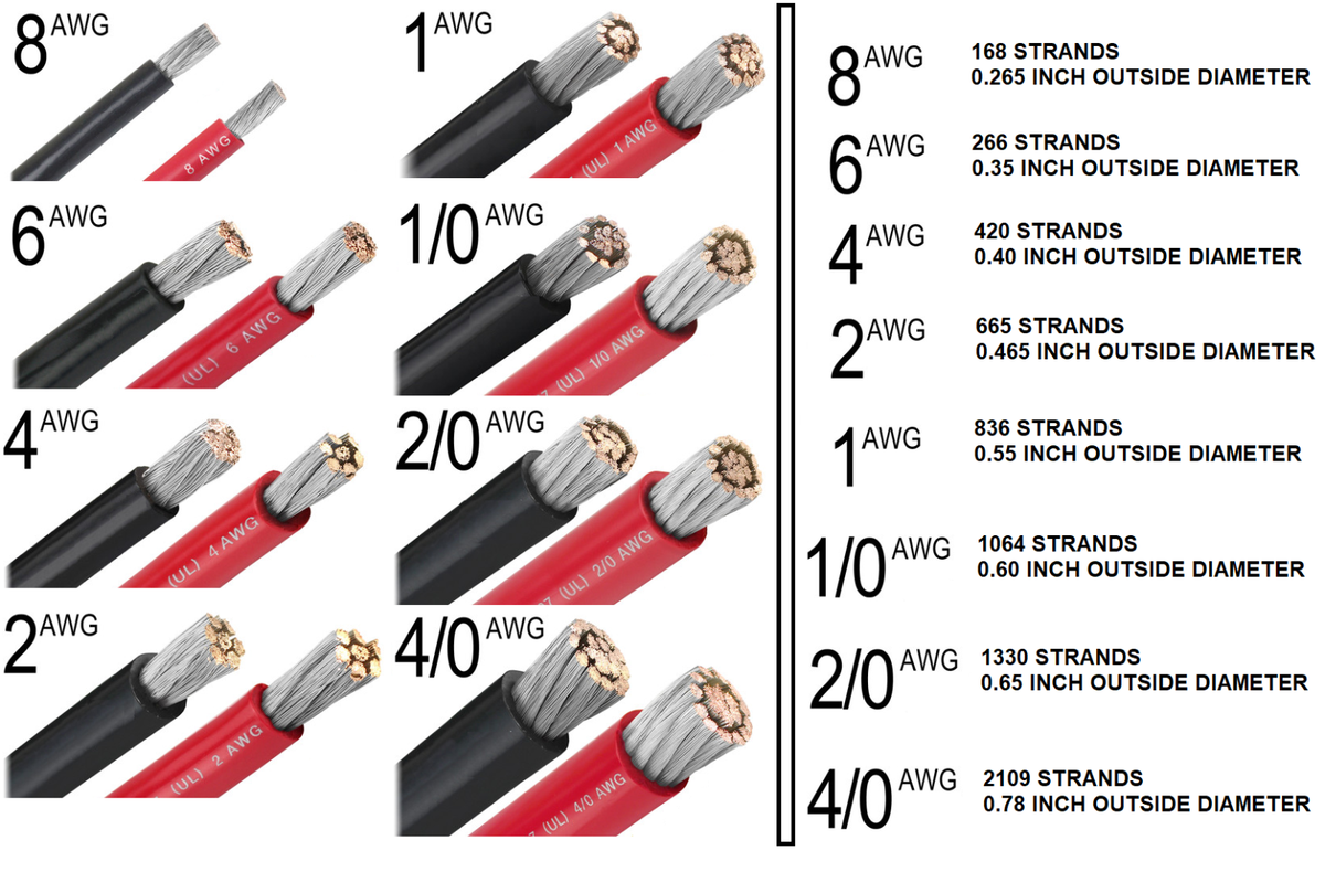

It is 4 times bigger. Great info Jim. Thanks again!
It is not uncommon that those cables have to be made to the length you need with the ends you want. Some parts stores will make them some don't. A truck shop or dealer should be able to make them. That size would apply to all the battery cables on your tractor. Every undersize one is a "restriction".
Upvote 0
Here is a pic of my battery cable. 2 gauge is what it says. I will get these cables made somewhere as well. Thanks again for the advice and the patience for a guy who knows next to nothing about fixing stuff. You've been a great help. May God bless you sir.
