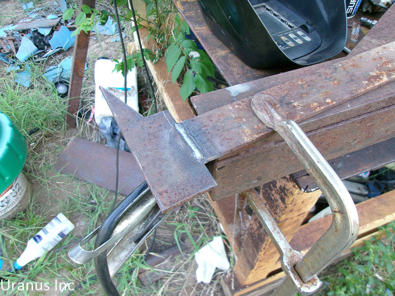

DRussell: The fingers look like a good solution. Not sure there's enough meat, or clearance, to do such a thing in this baler. It is interesting that this is a problem that's shared by many of these balers. I'm not sure why it bales with damp hay...........my thoughts have always leaned towards more traction when wet, but your thoughts might just be spot on (flexibility). Last year when the hay was full of Blackberries, it baled better...... The thorns adding traction??
DanielW: Did the round stock welded to the dimpled rollers actually work? Looks to be something around 1/8" diameter stuff(maybe a tad larger). One of the problems adding cleats, is the tiny bit of clearance between these rollers. Anything large diameter would have to be timed so that when rolling, the cleats wouldn't hit each other. Same same with the factory seams on the rollers.....they have to be timed so that they don't hit each other. Yes.......this baler would make an ideal boat anchor!!

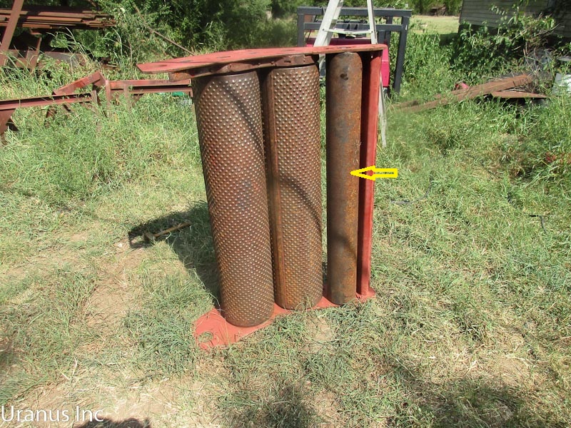

Put the goo on the two shiny upper rollers. All pics on the internet show the bottom dimpled roller with intact paint after years of use. This tells you that this particular roller doesn't see much pressure from the hay. The roller with intact paint always seems to be the pivot roller. The shiny rollers always seem to be the same.
The new schmooooo is rough. I don't feel it will last for more than a few bales. THE IDEA IS TO FIND OUT WHETHER IT ACTUALLY MAKES THE POS WORK LIKE IT SHOULD. If so, it's a matter of doing something more permanent. Yeah...........you can weld all sorts of crap on the rollers, but there are consequences..........mainly the limited clearance between rollers. This limits the height of the cleats you might add. A few threads, spread across the internet, have mentioned this.........AS WELL AS ME EARLIER. It's a roller timing issue.

To install a cleat on a dimpled roller required grinding down the dimples. This is untenable. These rollers are made of 12ga, or thinner, material. You CANNOT SIMPLY GRIND OUT THE DIMPLES. You create a perforated line.............leading to roller failure.
At best, as I addressed Daniel on the issue, you might get away with maybe 1/8 round stock placed atop the dimples.............which will create timing issues. THIS WAS ADDRESSED IN A THREAD I CAME ACROSS. New Holland, at one time, sent warranty/upgrade kits to the disgruntled owners of these balers. Crap to be welded on to the rollers to help bales start.

To get by, until I can get the proper grinding wheel, I gouged the starter roll. The load on the grinder was excessive when trying to grind the rubber off with a heavy grit steel grinding wheel. Rather than ruin an expensive grinder, I cut slots. Might work, might not. Either way, the rubber has to come off eventually.

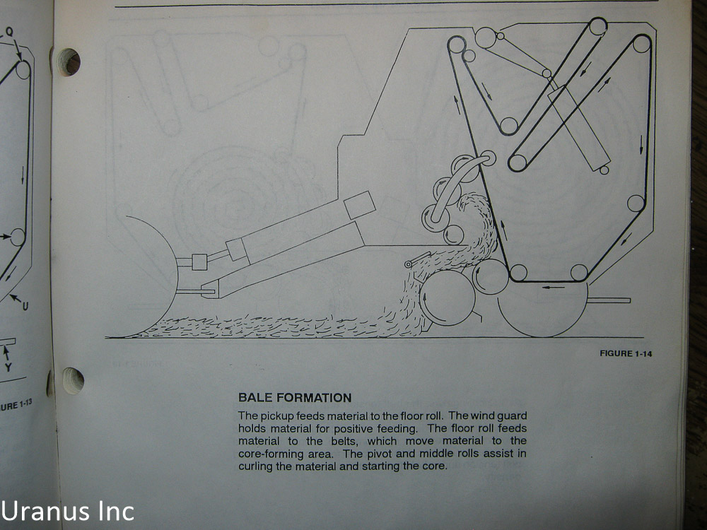

There's a 3/8" gap between the belts, and the stripper roll. The belts are pulling hay into this gap. I believe I could make a removeable filler strip to close the gap, but it would entail some welding on the sledge frame. This would require removing the sledge roller frame. Any welding will cause distortion, which would have to be dealt with by using heat on the opposite side of the frame. This can't be done with the frame up against the bale chamber. So, it sucks big time.
Ridiculous design. The hay is shoved up against the top, where the belt runs over the roller. As the belt, which is new, and aggressive, moves the hay upwards..................it gets sucked in between the belt and the top roll(stripper roll) in the core forming area.
This is the roller that carries the belts. It's absolutely asinine to have that huge gap between it, and the other roller. Before I rebuilt the baler, it had slick belts.....completely worn out. So, naturally I never encountered this problem before. The slick belts couldn't shove the crop through the gap.
