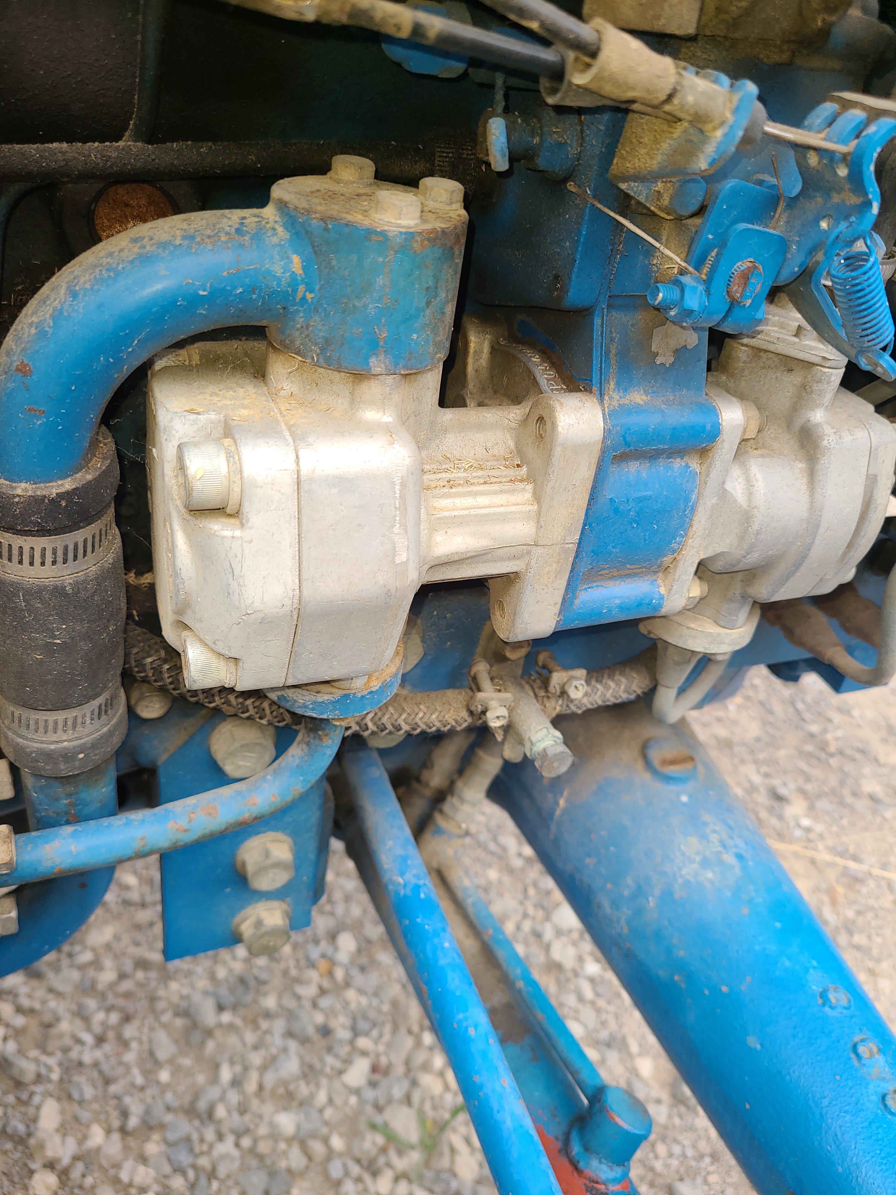

My 1520 has been slowly loosing hydraulic performance over the past few years. When it was new to me, it would lift the loader arms - and anything attached to them at an idle, basically. I usually leave my grader blade with about 150lb of weight on the tractor all the time. Over the past couple of years, I've had to rev the engine a bit to get the arms to raise. well, the other day, they stopped raising at all.
They will hold position if I help them up by hand. I removed the weights and it did not really help enough to work around the problem. I rev the engine hard and get a few inches of lift.
I suspect its my pump, as the fluid level is fine. Is there a procedure to check pressures somewhere? The pump is some variation of a KP05 and rated pressure is 2130psi
What about the relief valve? I see its not adjustable. Maybe I'll pull it and look it over.
Is there are preferred source amongst the members here? The YT store? It doesn't look like my pump.

My money is on the pump. Ideally you would test pump output pressire ahead of the relief for a definitive diagnosis. That requires a pressure gauge and needle valve test setup. Not expensive to put the test gear together but finding the proper point to connect it requires some knowledge of the tractor plumbing. Post a picture of the loader connections to the tractor hydraulics. Probably two or possibly three hoses going into a block on the side of the engine

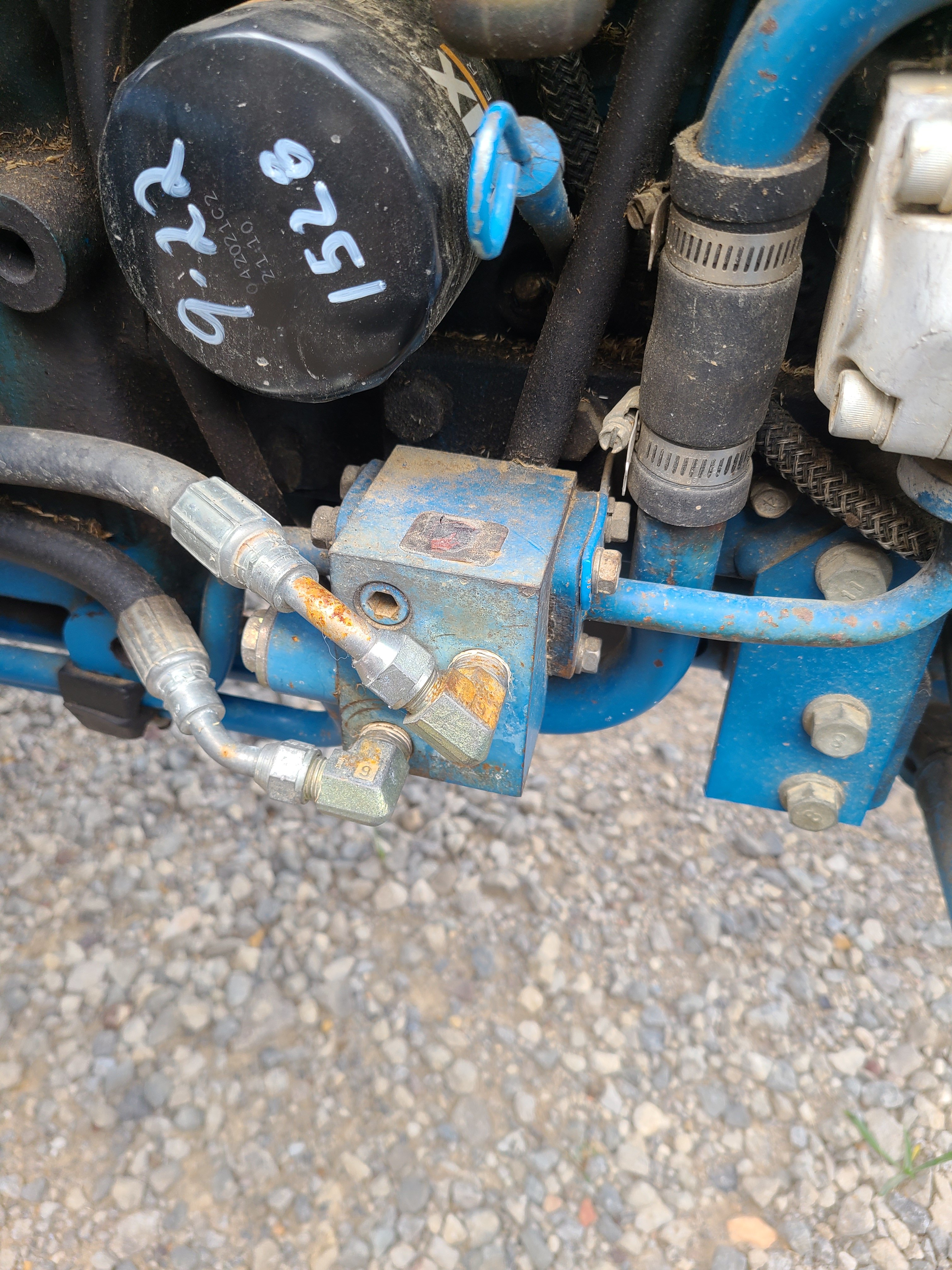

I checked the relief. Everything seemed in order there.
This valve is where I connected some lines for an implement. There's a rotary selector behind them that i use when i run my log splitter. I tried moving it to different positions, but it didn't improve my condition.
the pump output goes directly to the block. It's been so long since I connected them, I'm not sure which port is what now. And there's a 3rd port too.

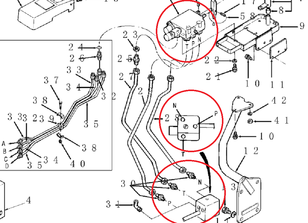

That block has three ports
P - is the pump pressure outlet for an auxiliary implememt
N - Is neutral or pressure beyond return from your implement and powers the 3pt.
T - tank rreturn from your implement.
When no implement is attached to P and N pump pressure goes straight througjh the block to the 3pt via the other hard line.
When you connect an implement (e.g. loader) you turn the selector valve to divert fliow out P and flow must be returned to N where it continues to the 3pt as above. The selector valve should stay in that position as long as the implement is attached. If the implement is disconnected the vslve must be switchef back to the straight through position.
So what is hooked to those two hoses? Hopefully it is your loader valve.
And where Is the relief valve you checked?

The relief valve is on the underside of that block. The spring and o ring were fine, and no dirt or trash.
I'm out of town for a few days, but will be working on this when I get back. I'll look closer for the connection markings.
As far as what's hooked to them? I have a couple of wet line connections that I use in conjunction with a valve for a hydraulic top link cylinder, or a log splitter.
I don't always use the hydraulic top link, so there's nothing hooked to them currently. And when I use the log splutter, I have to rotate the selector on that block.

I am happy to hear there is a releif in that block. That block should be used to connect your loader to the tractor as shown below,. You do have a loader on the tractor don't you?
If there is nothing hooked to those hoses the diverter needs to be in the straight through position for the 3pt to work.
You need to familiarize yourself with the operation of that block. Misconnecting it can shorten the life span of your pump and I fear that may be the case already.

Your confirming my suspicions. Your remote valve is not plumbed properly and has been deadheading the pump against the relief. That wont kill the pump right out but it can over years of use.
That may not be the immediate problem and you need to check the filter and confirm the pump is getting oil. Then its very simple to pressure test the pump.
Once you confirm thr pump is producing pressure we can fix the plumbing on the remote so that everything works independently and you never have to touch that selector valve.

If thats the case and you have the hoses connected as I think you do that may well be your problem It will render your 3pt inoperable regardless of the position of the selector valve.
Your entire hydraulic system is open center and all valves have to be daisy chained using the power beyond (aka neutral) circuit to work properly.
