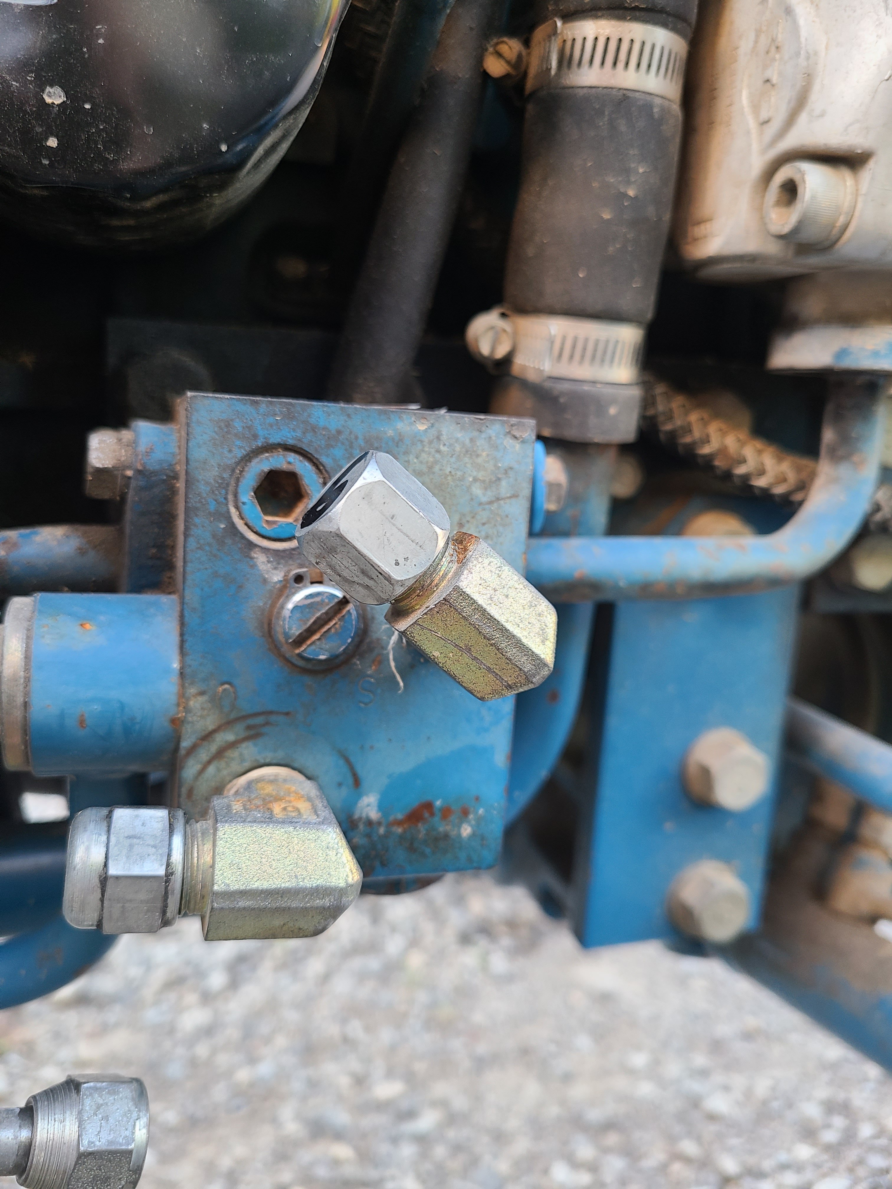

Hopefully you dont have a closed center valve on your open center tractor. That would subject the pump to constant maximum pressure whenever the selector is in the implement position and kill it over time. Post a picture of that valve if you have any doubts.
You apparently have an open center directional valve connected to the.P and T ports on the hudraulic outlet block. That short circuits the open center hydraulic system on the tractor and has never actually worked correctly. You have worked around that by fiddling with the selector and operating multiple valves at the same time. There should be no need for that.
Move the bottom right hose on the outlet block to the upper left port as Mark has described and put the selector valve in the "implement" position as shown in your manuals. That is the correct open center plumbing.
Connected like that the pump, 3pt, and add on valve will all be in series and both valves should work independently with no need to ever touch the selector.
If things arent working after moving the hose the next step would be to put a pressure gauge directly on the P port and see what the pump is doing. It may have finally given up the ghost.

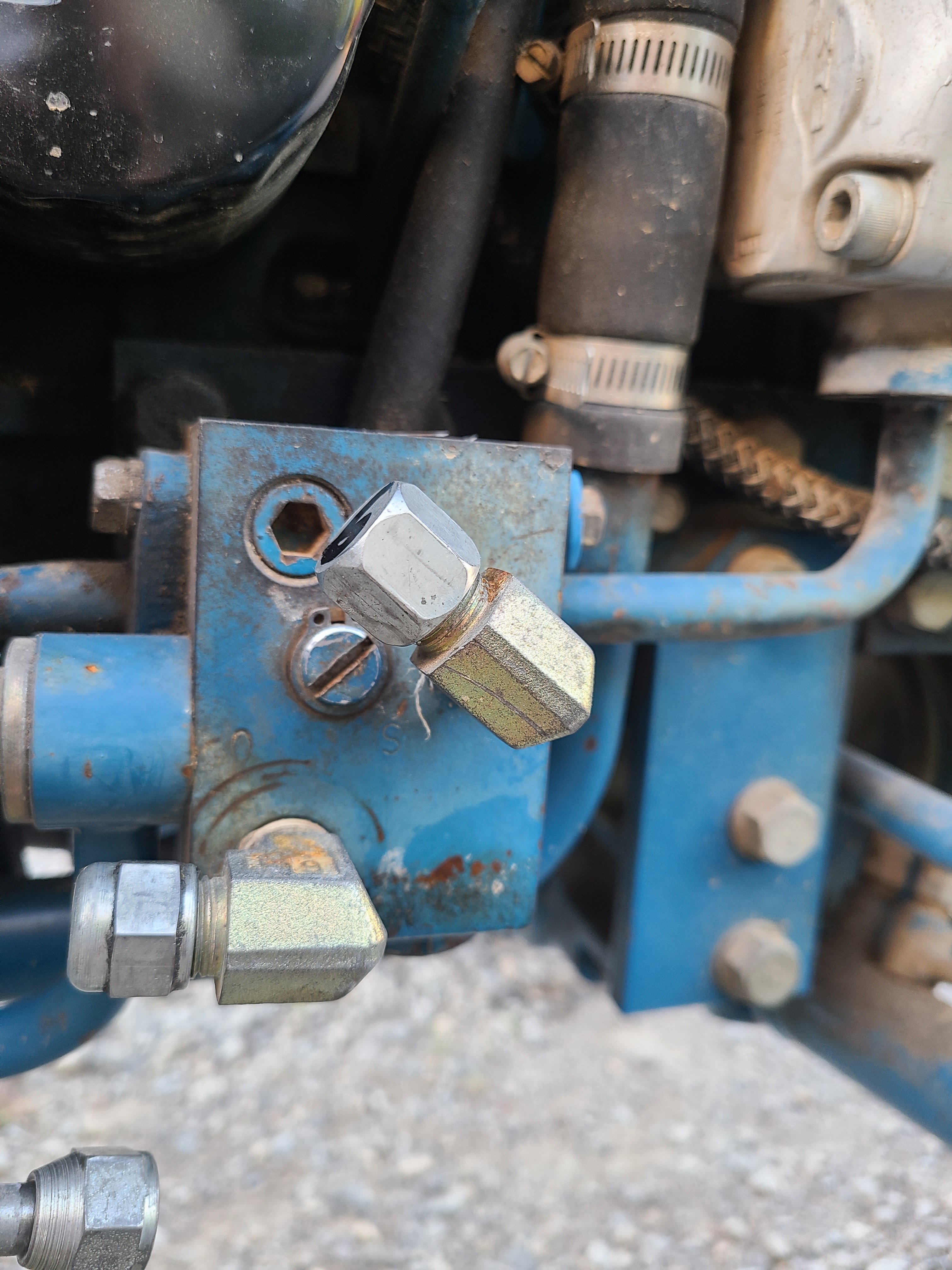

That block has three ports
P - is the pump pressure outlet for an auxiliary implememt
N - Is neutral or pressure beyond return from your implement and powers the 3pt.
T - tank rreturn from your implement.
When no implement is attached to P and N pump pressure goes straight througjh the block to the 3pt via the other hard line.
When you connect an implement (e.g. loader) you turn the selector valve to divert fliow out P and flow must be returned to N where it continues to the 3pt as above. The selector valve should stay in that position as long as the implement is attached. If the implement is disconnected the vslve must be switchef back to the straight through position.
So what is hooked to those two hoses? Hopefully it is your loader valve.
And where Is the relief valve you checked?

My valve definitely has O & S, which I connected to. The 3rd port doesn't seem to have a legible marking.
They seem to match up with T & P from a previous drawing
But the valve rotates 360. Always has.View attachment 76833
On the back side of the diverter block there should be a roll pin through the spool and 2 roll pins in the block that limit the rotation of the spool.
They seem to match up with T & P from a previous drawing View attachment 76834

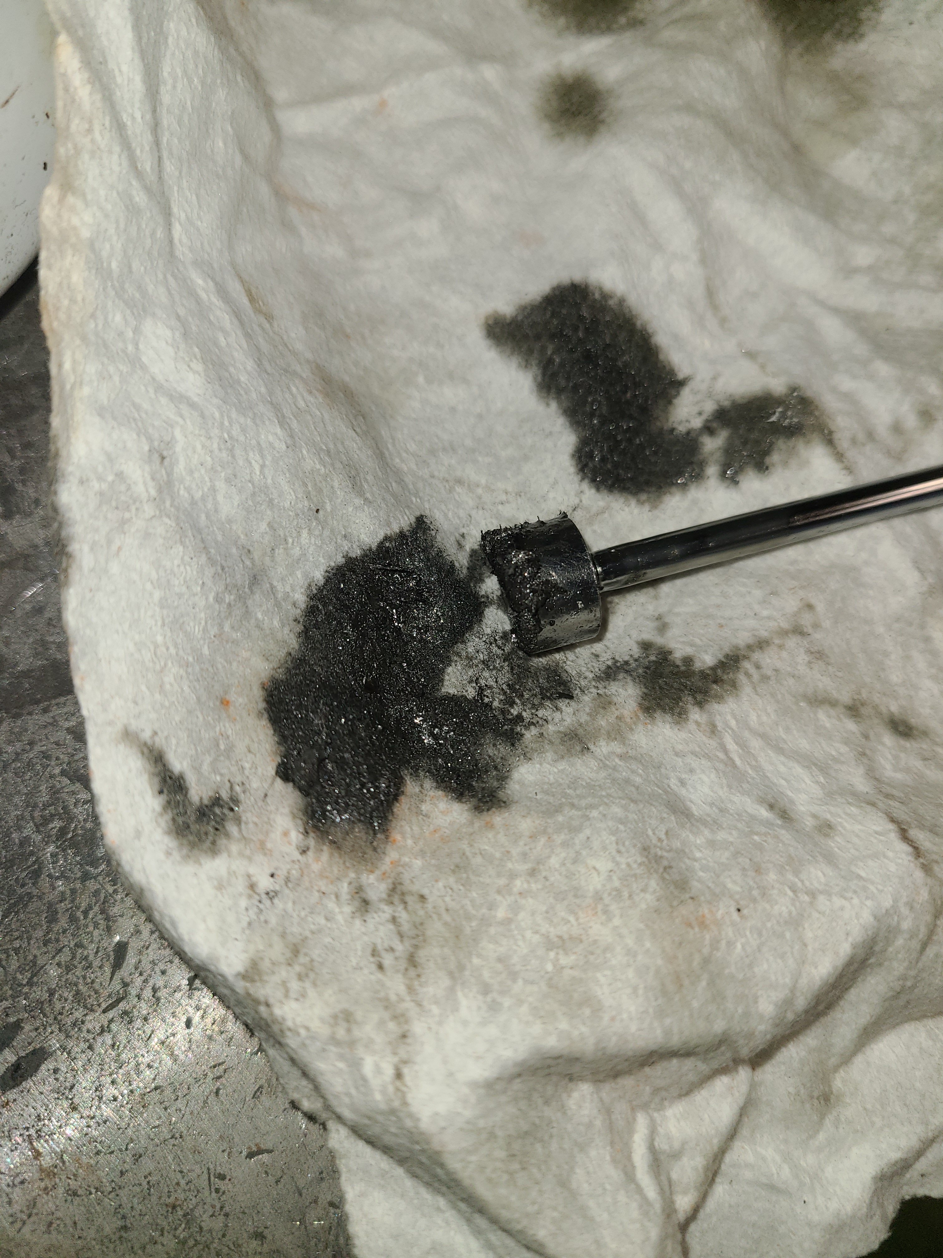

I think I would have a peek inside the intake and exhaust ports on that pump to see if that trash in the filter is coming from the pump.

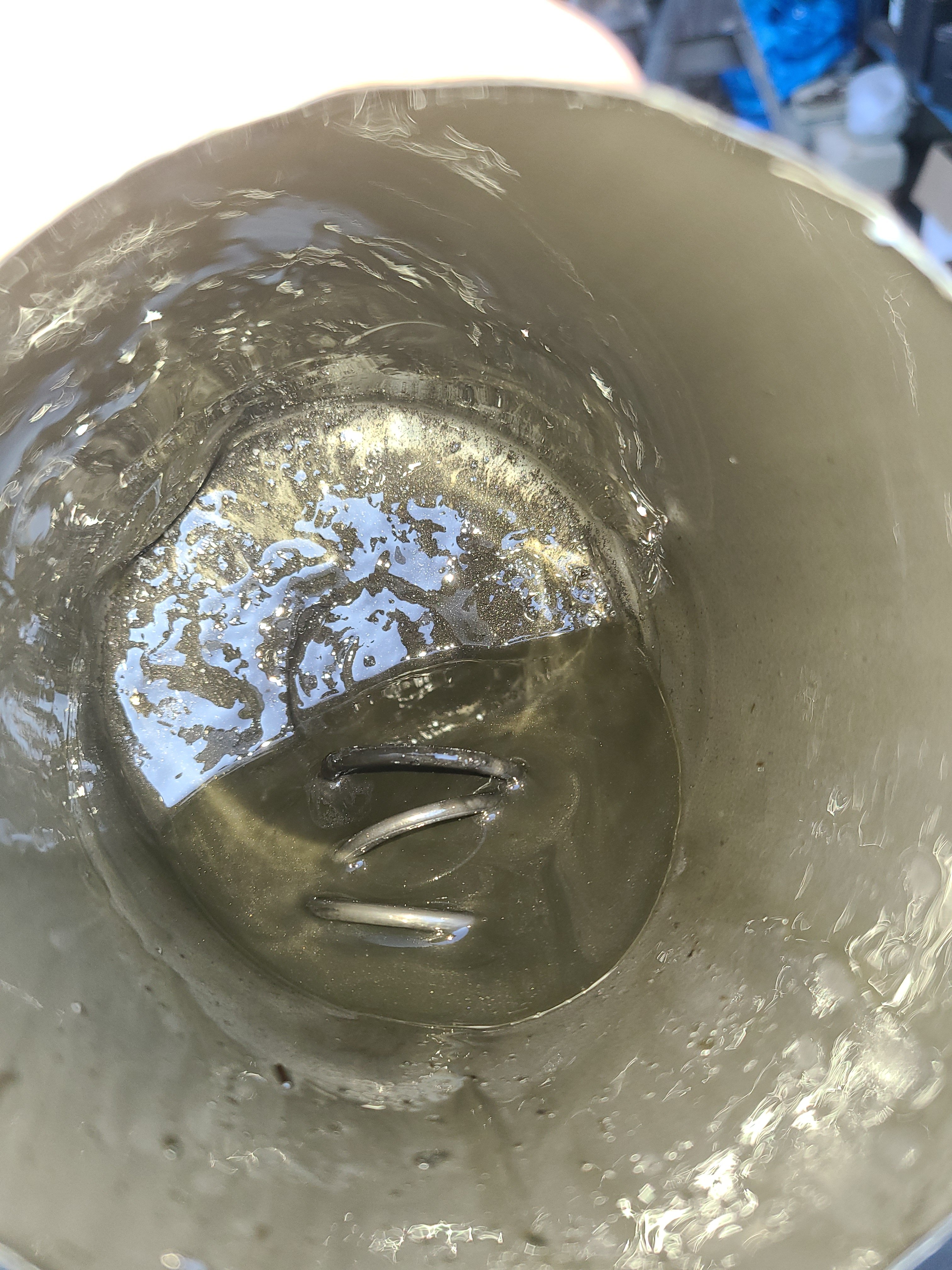

View attachment 76824View attachment 76825View attachment 76827
You said you checked the relief on the outlet side of the pump and found no sign of that stuff? Seems significant. I would not be so quick to jump to conclusions.
You clearly need to drain and flush the system, replace the filter, and refill with new clean oil.
Then I would read the manual to make sure I had the selector valve set ti the implement position, remove the cap on just the P port, and check flow pressure at the pump outlet port.

Yea. Oil on dipstick looks good too.
That "filter" is a strainer. It's been a very long time since I had changed it. I might guess that it's sized large enough to allow the oil to slow down enough to let everything settle out in it. And that trash has been accumulating for a while.
The oil was normal looking when I was unscrewing the filter and initially when I poured it out.
I'll know more after work when I tear into it.

You appear to have a paper element suction side filter as opposed to a wire mesh strainer. That filter will clog up and restrict flow to the pump if not maintained. The parts diagram also appears to show a mechanical bypass valve in the filter head that will open and allow unfiltered oil through if the filter gets totally clogged.
It looks like your filter may be clogged and cutting off supply to the pump. Thats good news because it offers a chance the debris is from something "normal" like wet brakes and the pump is not yet damaged. The system needs to be thoroghly flushed and that is hard to do without a working pump.
Hopefully you can get things reasonably clean by draining and refilling. Then put on a new filter and with thecselector set to the implement position see if you are getting flow out of the P port on the outlet block. You can do that by hooking up a hose, sticking the open end in the hydraulic filler, and starting the engine. If you get flow and the oil looks OK hook a pressure gauge to the hose and test pump outlet pressure. With the gauge connected the pump will be unloading through the relief with so you dont want to run the engine any longer than it takes to see the pressure.
If you are lucky the pump is OK and you can turn your attention to fixing the hydraulic block plumbing and findig the source of the trash in the filter.

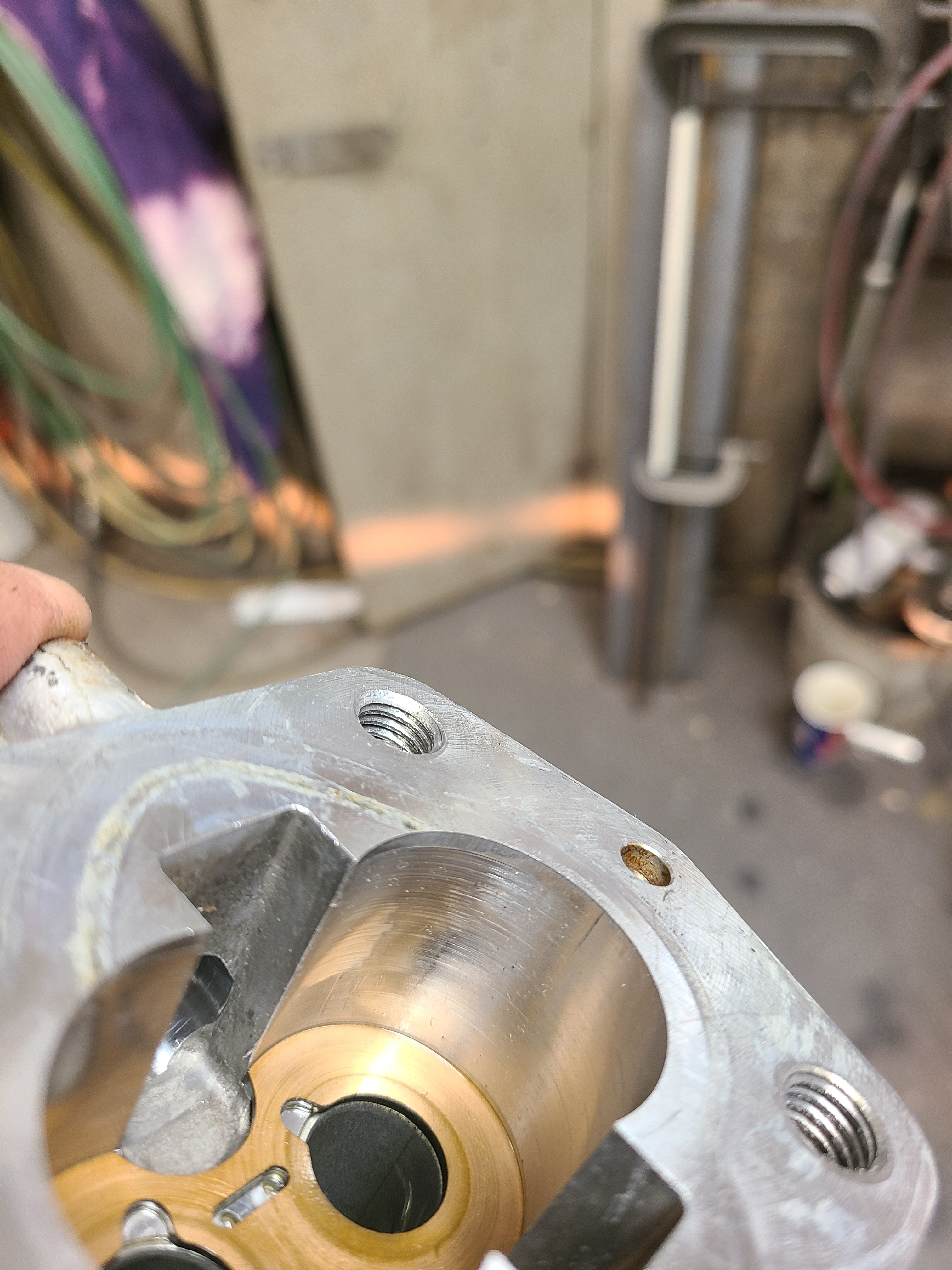

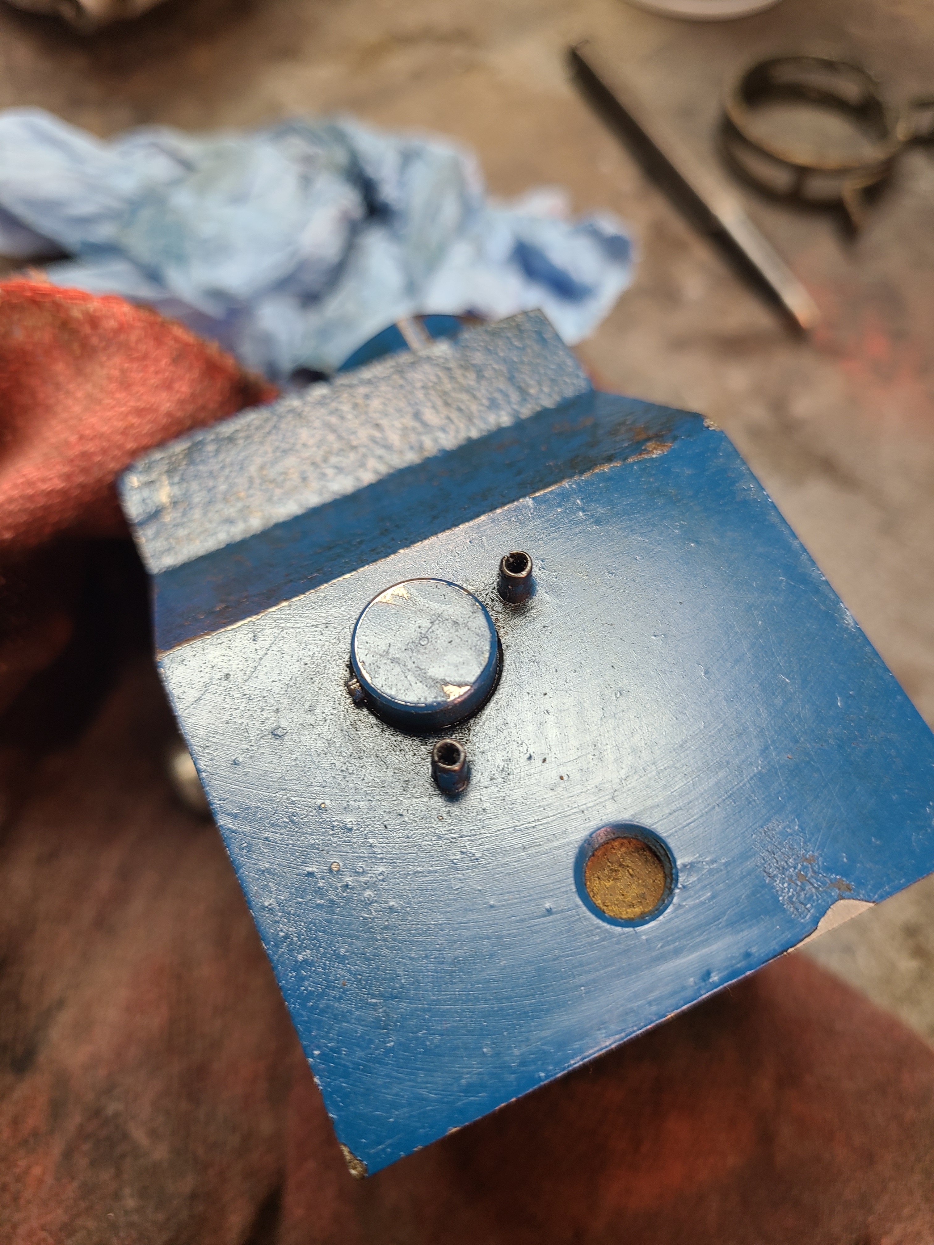

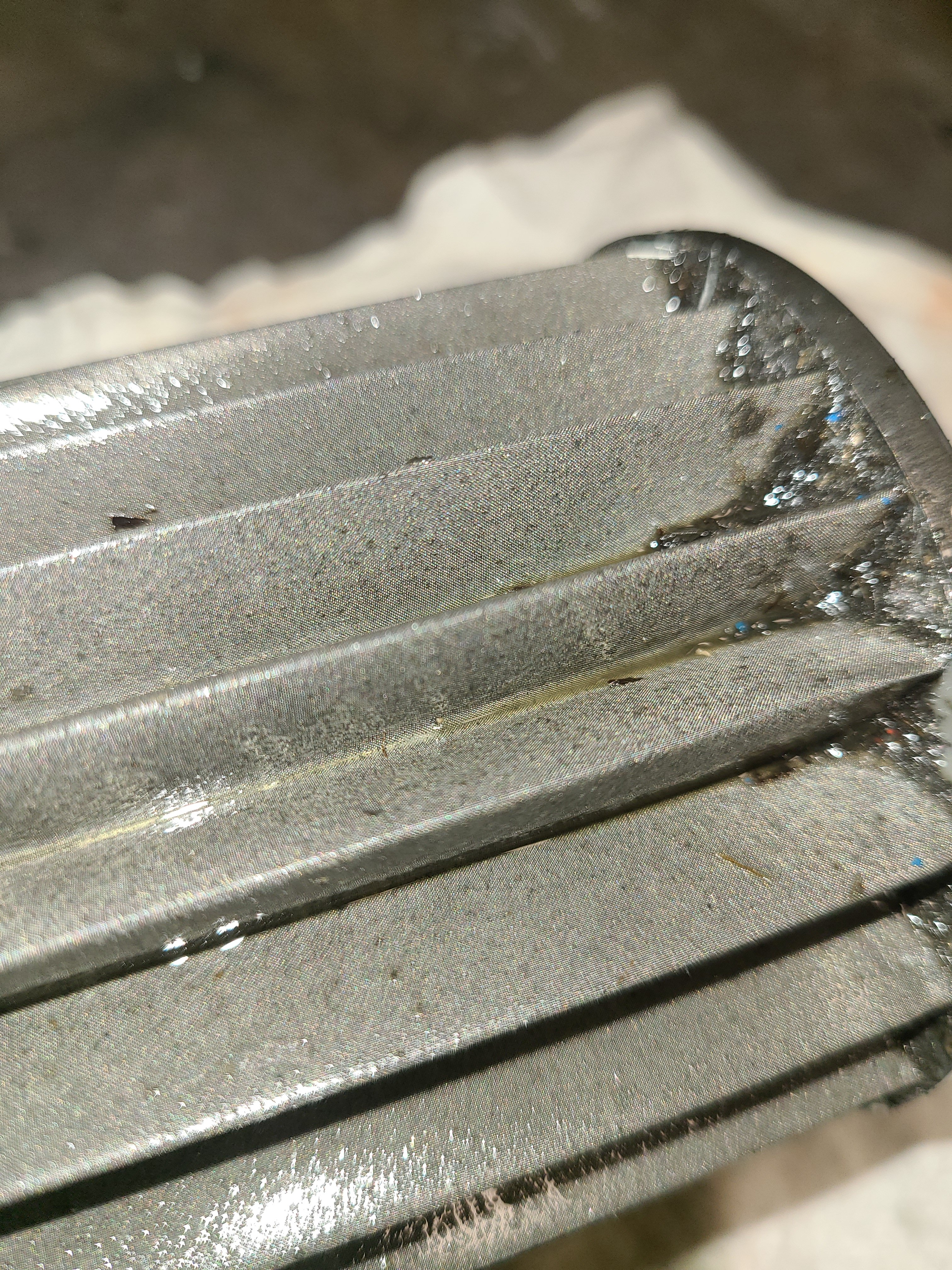

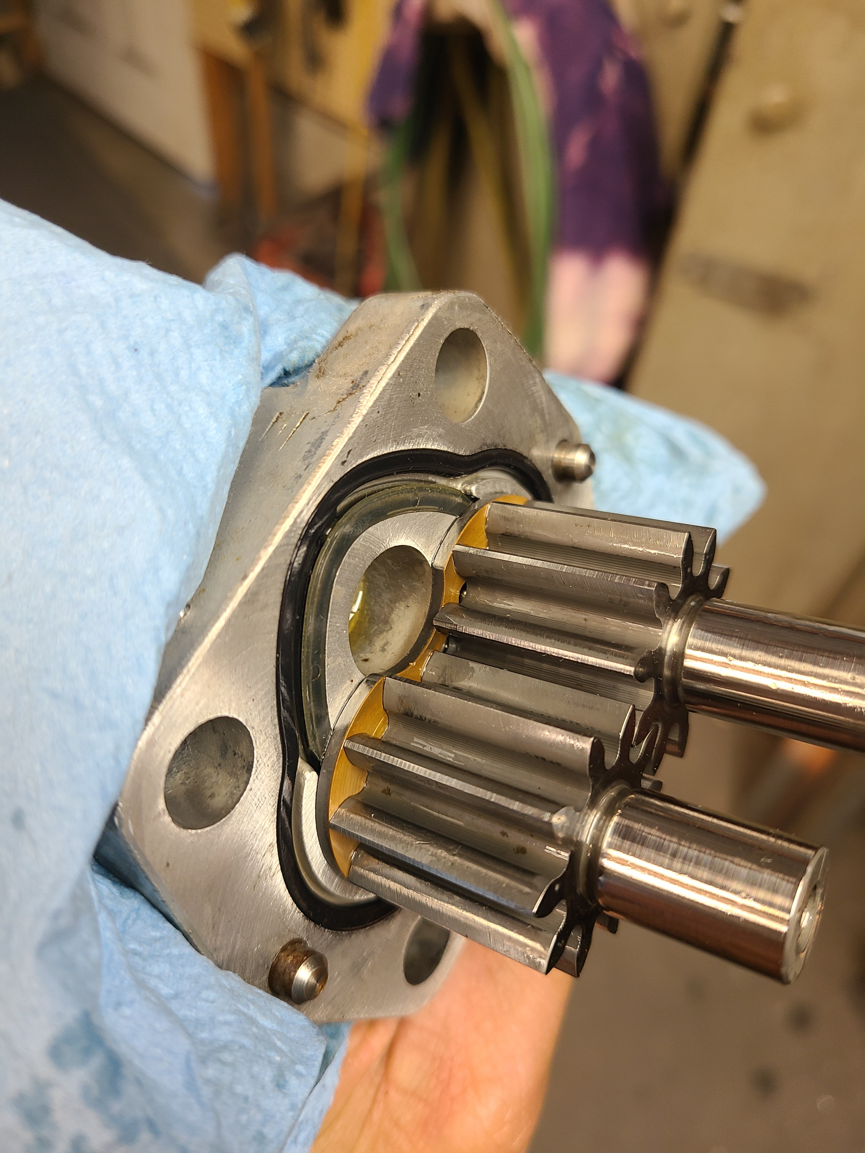

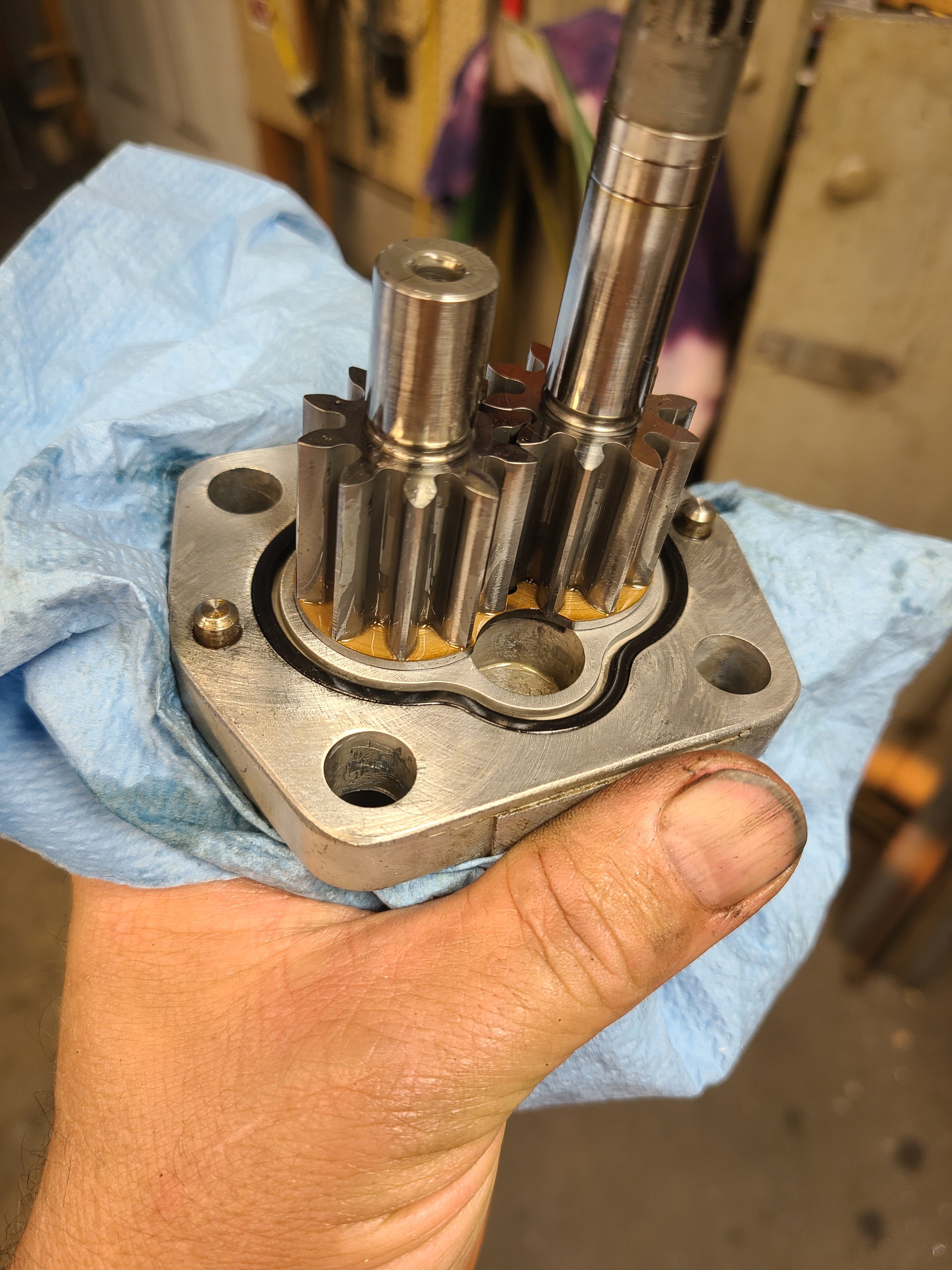

No, it's a metal strainer, but built as a non serviceable screw on. I just took my new replacement off to double check it(different brand), and it's a metal mesh also.

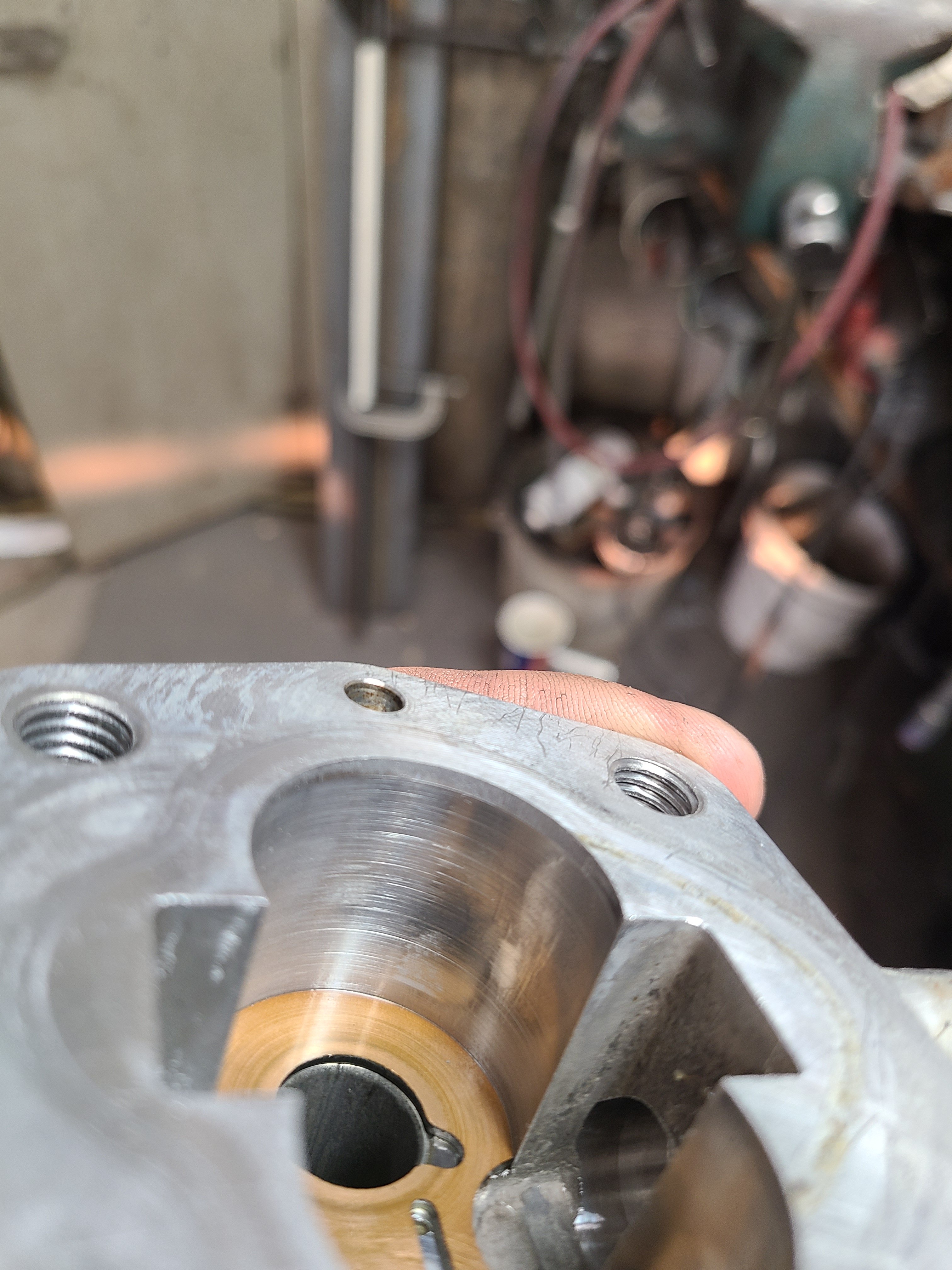

Anyway, my pump looks a lot better than I had expected. I don't believe it warrants replacing just yet. I've seen inside lots of hyd pumps, and while there is some scratches on this one, there is barely a lip warn at the end plates.
I believe the problem is elsewhere since it occurred/got worse so suddenly.

I checked that website out and they do have a choice of 2 pumps, but at this point, maybe just a seal kit which I didn't notice. I'll look around.

Anyway, my pump looks a lot better than I had expected. I don't believe it warrants replacing just yet. I've seen inside lots of hyd pumps, and while there is some scratches on this one, there is barely a lip warn at the end plates. View attachment 76968

I guess I did not look closely enough at your pictures.
Clean the sump out and put in new oil, fix the stops on the selector, put the pump back together, and correct the plumbing on the external valve. Should be better than ever.

Well, I'm rather embarrassed to admit that I found the "sudden problem" I had. The position of my additional vlalve had completely slipped my mind. Its under my seat, and i guess it had been so long since I had used it, it never entered my mind. And it's not spring return. 🤪
But anyway, it's forced me to do some overdue maintenance, repair my selector valve, and learn.😀
I believe the O & S are markings for the position of the selector valve, and not the actual port markings. I'm waiting on some paint to dry before final assy, but I drained and flushed the case while removing the pto cover and cleaned that magnet too.
For now I'm going to leave my aux circuit capped off, as I don't use it anyway.
