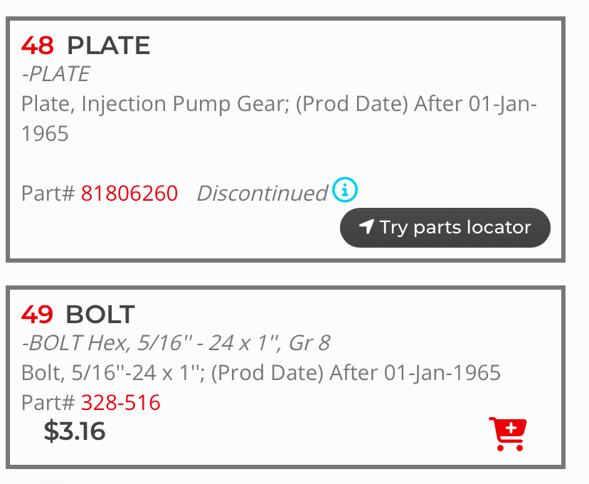

Thank you for your reply. I read the procedure this evening in the IT Shop Service manual that came with the tractor. The tractor is in the previous owners shop. The family is allowing me to reassemble the tractor in place to get it running. I was able to find almost all of the parts except the 3 bolts that hold the drive gear to the injection pump. I need the part numbers for those bolts and a name of a vendor that can supply them. Thank you.

Hello Daytona, welcome to YT! The bolts are New Holland PN 328-516 number 49 on the manufacturers parts page. CNHI Ford 3000 parts catalog Here is a link to a catalog from Messicks in PA, less monkeying around to get a price. Messicks Ford 3000 parts catalog You may have to select Category 02-Fuel system and then select the Simms pump diagram They show them for $3.16 each, I would think any New Holland or CaseIH dealer should be able to get them.

The pump hub bolts are 5/16 NF thread about 3/4 inch long I use on the test stand.
Make sure you have the triangulated plate (# 48) that goes in front of the gear, it helps the bolts clamp the gear to the pump hub
The bolts (item # 49) can be picked up at a hardware store much cheaper

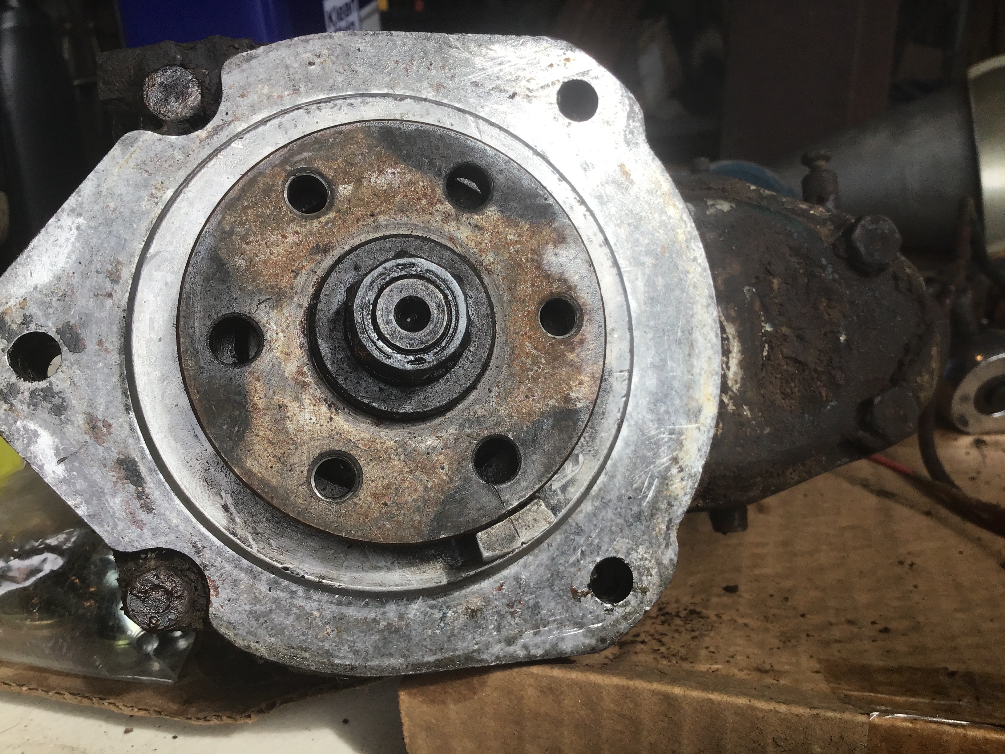

I found the timing mark on the injection pump. The manual says there is a cover on the right side of the engine to locate the rear timing mark but I do not see it.

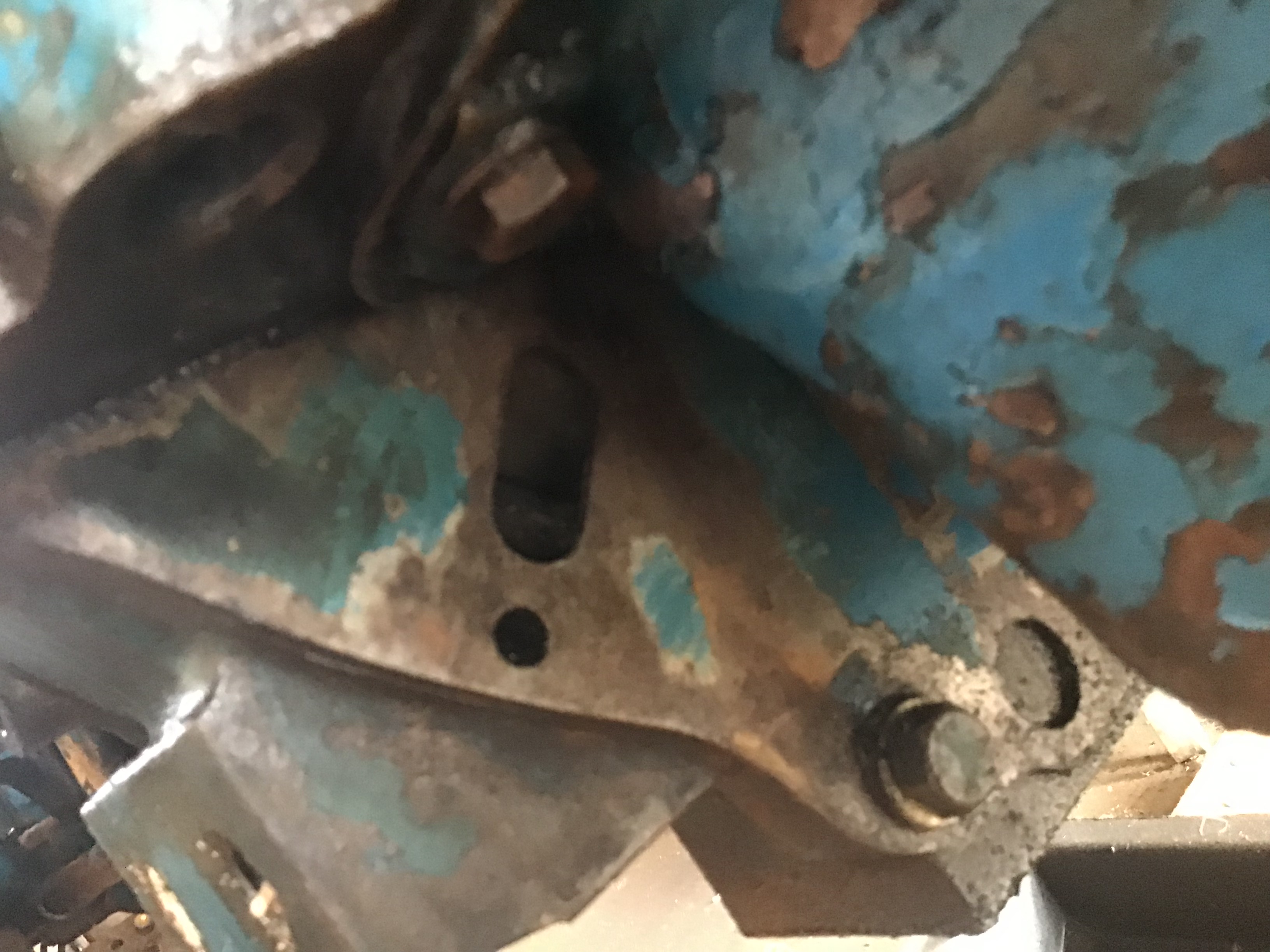

There is a small opening below the starter with a cover. That is where you can see the timing marks on the flywheel at the rear of the engine.
Thanks for the information. I installed the reman head yesterday using copper coat on the head gasket. Wanted to get the pump installed/timed today but drove to the shop without the service manual. Took it home to study and forgot to bring it with me this morning. Went on Messicks this afternoon to see how the fuel lines go on. The grandson told me yesterday the tractor was taken apart about a year and a half ago. Some small parts are missing so I put it together until I figure out what I don’t have then get the missing pieces and move on.
This is the opening under the starter next to the oil pan. There are stamped letters am visible on the flywheel through the opening. This is the only opening I see under the starter. What does the timing mark look like and which way does the engine spin looking at it from the front?

I do not see a timing pointer or arrow stamped near the opening. Do I assume that the timing mark on the flywheel be centered in the opening is what needs to be for the injection pump be in time. This is a first for me timing an injection pump.
I found the timing arrow on the engine and the 0 degree and 2 degree marks on the flywheel. I aligned the arrow with the 0 degree mark and will proceed to install and time the injection pump. Thanks so much for your help.
