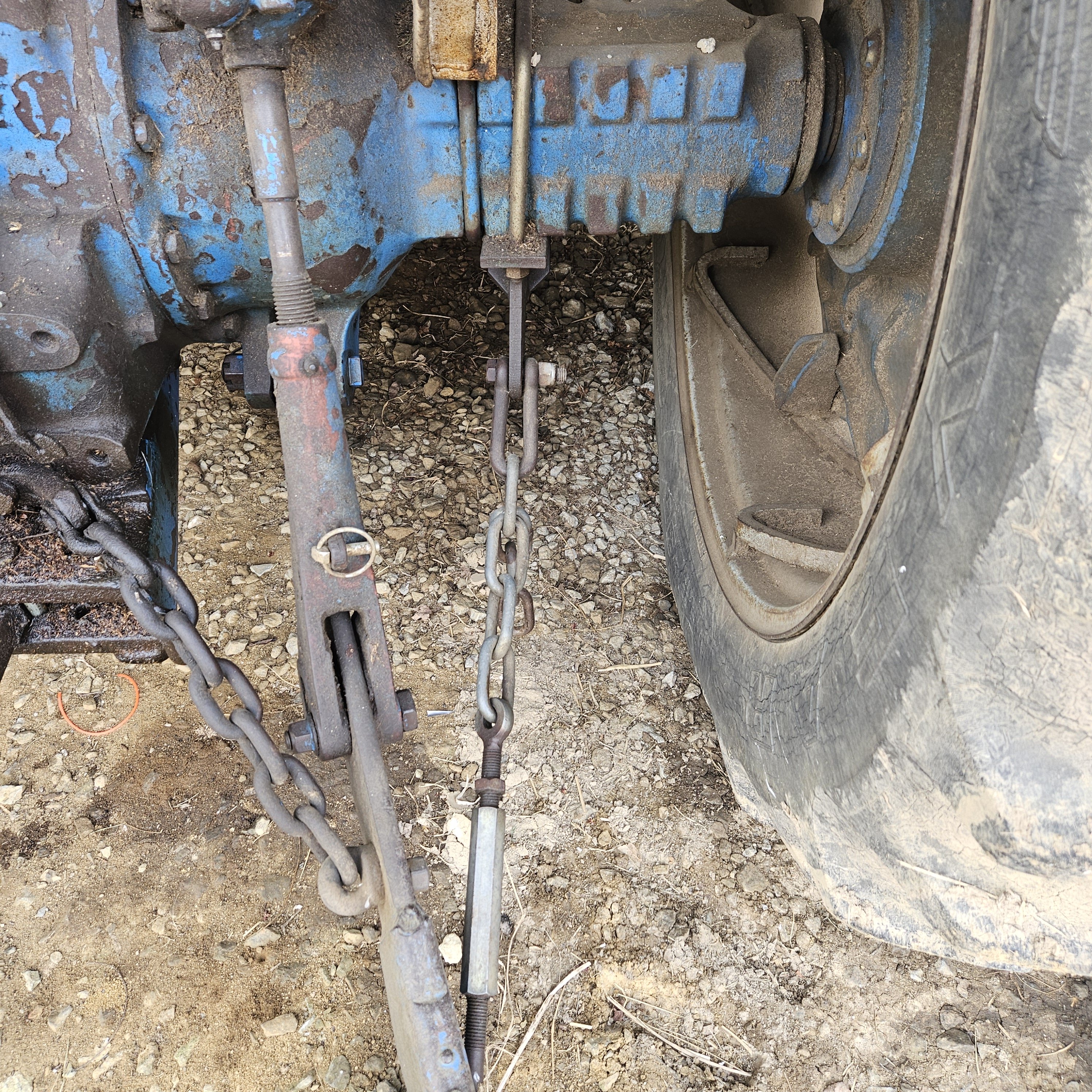

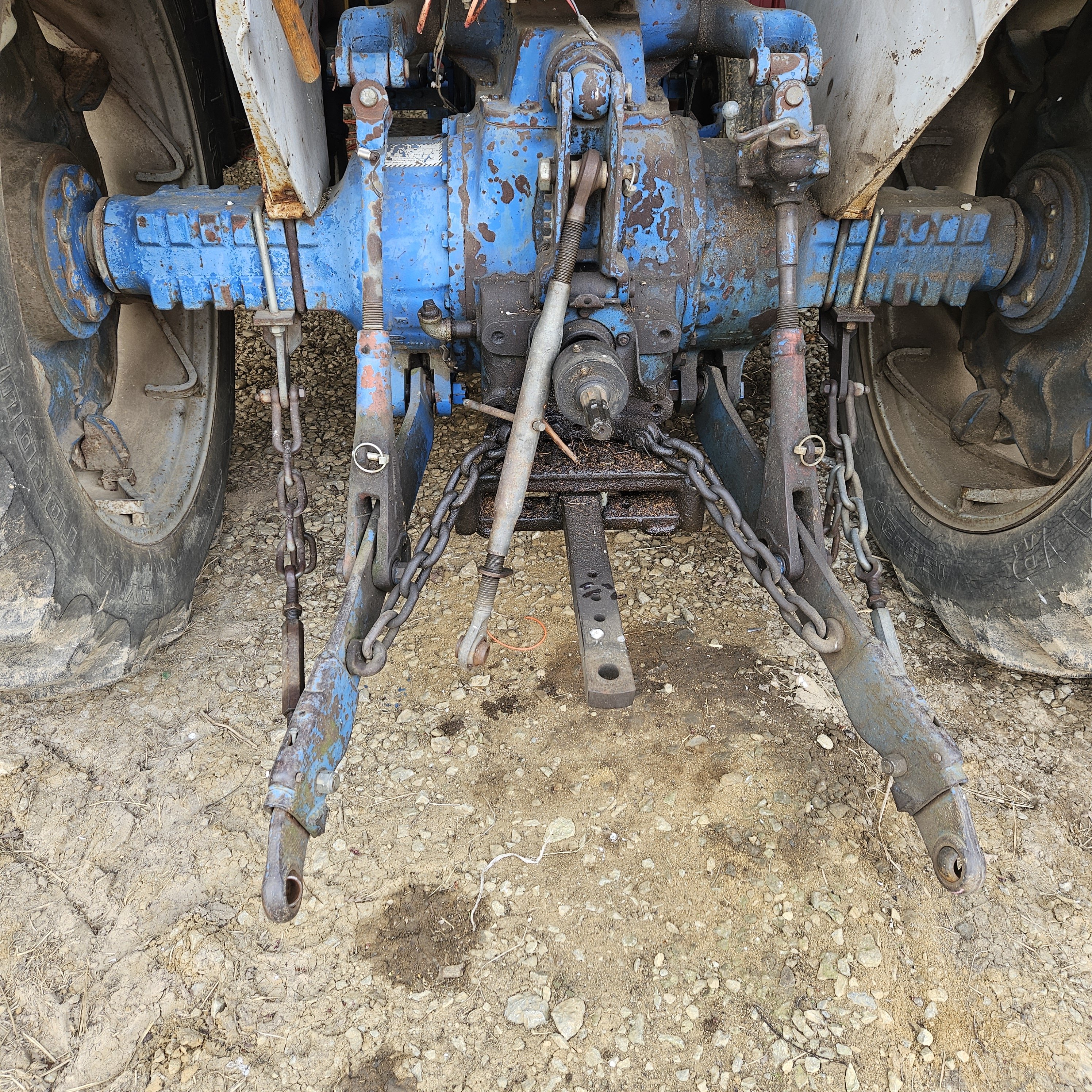

The setup I referenced in my post on the back of my 5000. Note the sway chains on the inside of the lift arms to keep the arms from hitting the tires when no implement is attachedView attachment 108755View attachment 108756
How am I gonna know how far to place these brackets? The photo above has em all the way out on the axle and you'res are all the way in? Dose this depend on the implement I'm using? Or how far I have the sway arms twisted out???
The farther out you have them the more stable they will be with less stress on the chain.
You are making a triangle with them. The wider the base, the more stable the triangle.

Been 25 years or so since I put these on, so my reasoning for that location eludes me.
I do know I cover a lot of ground with a heavily built 7ft 3 point rotary cutter (bush hog) and this handles it with no problems.
Have also had a 7'10" disc mower (before I bought a caddy), 4bottom plow, 250 gallon 3 point sprayer and other implements on there with no issues.
I think I moved the tires outward after I put the stabilizers on, so it may have been a tire clearance thing.
And if one bracket position doesn't work for you, scoot it over.

Guess Ill just monkey around with them. Like I said I am running a stump grinder and it's very .... Aggressive lol.
All states Ag. Parts (tractorpartsasap) sells a square tube within a tube with holes for setting the dimension. Easy to mount and bullet proof. You'll never go back to anything with a chain on it.
Third picture from the left. The 5000 isn't mentioned but gonna bet it will fit...might ask them....also that's for one. I recall getting a set like picture 4 for my 3000 but I think there were a pair for about a hundred bucks. The lift arm may need to have a hole drilled for mounting, or on the larger tractors like yours there is probably a hole already there. The other end fits on the bracket that's underneath the axle housing held in place with the bolts holding the fender on.

As Hemmjo said, the farther apart the better. Makes sense.
I guess put the brackets out as wide as you can without messing with your tires.

As previously mentioned the little stay chains should always be used with any stabilizer system.
In regard to rusty turnbuckles, everything rusts if not properly maintained. I use Never-Seez on thing like the turn buckles. The top link on your : point is just a likely to rust and get stuck in position.
The damaged components you mention are a result of improper use and lack of proper care.
To install the aftermarket square tube style I had to remove the stay chains as the bars use the same hole in the lift are and the stay chain eye bolt isn’t long enough add the bars bracket
I use the threaded, adjustable bars from TSC in place of the flat bars. Work ok . Did have to heat and straighten one end to get the angle correct on the 3400.

Finally got back outside and I did about 8 stumps today. The turn buckle style works great and keep the grinder right where I put it. Took less the 10 mins a stump.
