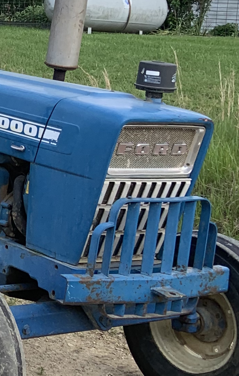

Hello,
Been browsing the forum for awhile and this is my first post. I'm looking to buy my first tractor for our property and came across a Ford 5000 w/ loader for $8,500 that claims to be in great shape with a lot of new parts. I don't know a lot about tractors and am trying to determine if this is a good buy or not.
The main things I'm needing to do are some basic loader/bucket work around the property, move round bales, and bushog. I'd need to get a hay spear and would like to have some pallet forks in the future too. I've also contemplated getting into making hay for myself and some family nearby which I think this tractor has the horsepower to do.
Hopefully this isn't against the rules but I'm going to post a link to the craigslist ad that has some info and pics: https://carbondale.craigslist.org/grd/d/vienna-1968-ford-5000-diesel-tractor/7767008710.html#
I guess my (very uneducated) questions are:
  • Things to look for or worry about?
  • Can anyone identify the loader from the pic? It doesn't look like the Ford 772 loader that would have been original.
I'd greatly appreciate any thoughts or input from someone who knows a little more about these machines! While I don't know much about tractors I'm very comfortable working and vehicles and fully expect to spend some time wrenching on an older piece of machinery like this.
Thanks!

Based on the pictures it doesn't appear to be being sold by a dealer. My first question would be why are they selling it only 10 hrs after a "complete, major overhaul". To me, that's a red flag, selling it right after an overhaul unless something happened like the owner passing away, or it's being sold by a dealer, etc. It makes me wonder if the complete major overhaul is as complete or major as one would expect.
The Ford 5000 though is a nice machine and very capable of doing the things you mention you want to do. Before I bought it I'd want to see it running and fully warmed up, then check in the radiator and see if there's a steady stream of air bubbles in the radiator fluid. Ford diesels were prone to electrolysis of the engine block where you end up getting combustion gases in the radiator.

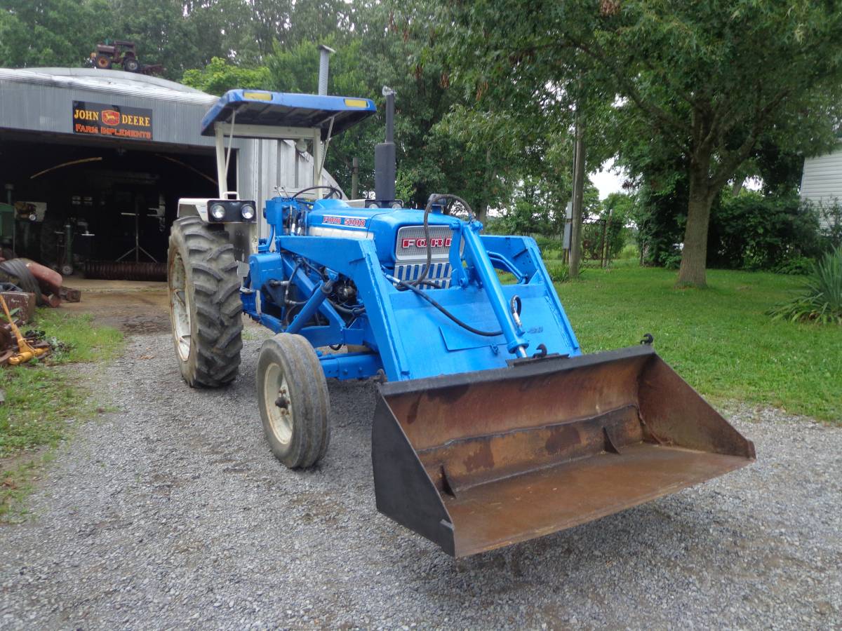

Probably a tractor trader. Try to look past the new paint. Maybe all good as described.
I believe the '68 has the smaller engine. I'd want to see receipts for the rebuild. If true and complete, that's a large part of the value.
Loader is not 'easy-off', and appears to have lots of welding. Fenders an ROPs homemade.

Probably a good thing to have a front-driven pump. That's the only thing I don't like about ours- how slow the stock pump is (especially when loading logging trucks or opening the gate on a round baler).
Looks like it might be the same Allied loader as ours, but is hard to tell: Ours has been so beat to heck, broken, and reinforced with whatever has been laying in the boneyard that I've forgotten what it's supposed to look like.
Gwiz does make a good point of having to look past the paint. Someone on here posted a few years ago that you have to be very cautions buying a used 5000, because no one in their right mind ever gets rid of one unless it's been seriously abused and has major problems. But it takes a lot of abuse to hurt a 5000, unlike the 4000: I was never a fan of the 4000. The early 4000 and early 5000 were almost neck-and-neck for performance; in some cases the lighter weight of the 4000 meant that it could out-work the 5000 - especially on hills where the 5000 used more of its own power just to move itself around. But because the 4000 was built so much lighter, they just couldn't take years of abuse and a lot of 4000's were beat to death and scrapped after only a decade or two, whereas the 5000 was bulletproof.

That 5000 is a early vent hood model built before May 1968 or the sheet metal has been changed
It has the wrong grill panels and makes me wonder if that worked on it knew much about Fords
The early 5000’s used a smaller 233 ci engine making 57 hp, later models with the 256 engine made 66 hp, owning both models I can say the later model is far better than the older 5000
5000’s up into the early 70’s had finicky power steering and a weak pto pawl brake but overall
where solid tractors
That loader on the other hand is a much different story, the home modified center tilt cylinder eliminates any possibility of adding attachments without major modifications
The engine may have actually been rebuilt but there’s to much mismatched parts and cheaply done modifications for me, plus new paint scares me

I can't tell for sure what is stock and what isn't. I know for sure the seller installed the fenders and lights when he did the paint job. Any pictures I find of that style grill on a Ford 5000 seems to be on the later models without the vent hood which makes me wonder if someone replaced the hood at some point. I'm going to clarify which engine it has and its the smaller one I'll probably walk away. I'm not afraid of buying something I need to do a little work to but I'm not trying to buy a problem by any means.
I'm with you on the loader. I figured with the custom center cylinder I may have to convert it back to dual cylinders at some point or modify a QT adapter to fit and be able to use QT implements going forward, which would be my preference anyway since I am starting my collection from scratch.

You can see the engine driven pump in the second picture of the ad. It's a good thing, gives you faster response and better lifting capacity than using the onboard hydraulics.
