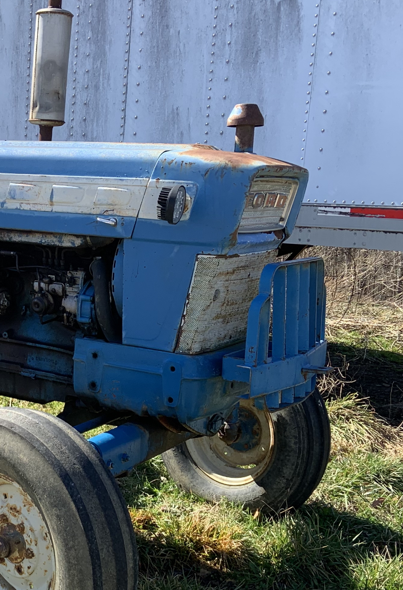

Hello,
Been browsing the forum for awhile and this is my first post. I'm looking to buy my first tractor for our property and came across a Ford 5000 w/ loader for $8,500 that claims to be in great shape with a lot of new parts. I don't know a lot about tractors and am trying to determine if this is a good buy or not.
The main things I'm needing to do are some basic loader/bucket work around the property, move round bales, and bushog. I'd need to get a hay spear and would like to have some pallet forks in the future too. I've also contemplated getting into making hay for myself and some family nearby which I think this tractor has the horsepower to do.
Hopefully this isn't against the rules but I'm going to post a link to the craigslist ad that has some info and pics: https://carbondale.craigslist.org/grd/d/vienna-1968-ford-5000-diesel-tractor/7767008710.html#
I guess my (very uneducated) questions are:
  • Things to look for or worry about?
  • Can anyone identify the loader from the pic? It doesn't look like the Ford 772 loader that would have been original.
I'd greatly appreciate any thoughts or input from someone who knows a little more about these machines! While I don't know much about tractors I'm very comfortable working and vehicles and fully expect to spend some time wrenching on an older piece of machinery like this.
Thanks!

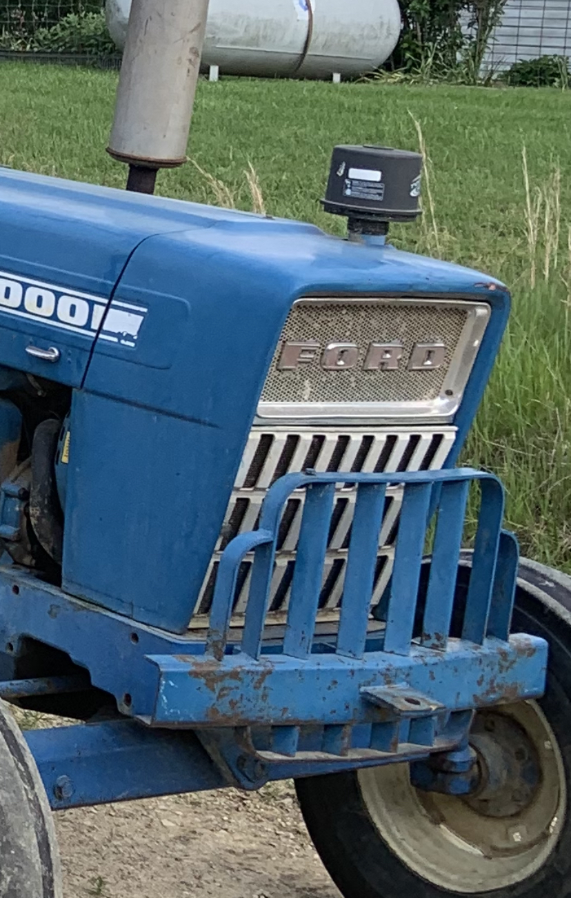

I will say check the serial number as I think it might be a newer tractor than a 1968 model/ I had a 5000 that was a 68model and it still had the steel grill, mine was a gas and had the smaller engine,That has a plastic grill so that is why I think it might be a newer tractor, Not sure when they changed from steel to plastic.. I had 2 4000 Fords one was a 65 and steel grill, the other was a 68 and had the steel grill but my 69 5000 still had a steel grill so that is why I am asking you to veryify the serial number to determin if it is not a slightly newer tractor.. It would be a later bodel than the 5000 I had and with more horsepower. Mine had the 15.5 x 38 rear tires and the 7:50x 18 front tires. If you do get it and need to buy parts and ask for a 68 year you might bet parts for a steel grill model that would not fit your plastic grill tractor. The plastic grill was used untill end of 5000 production in the 70's.

That one had a late model grill rigged up in a early model grill shell

Probably a tractor trader. Try to look past the new paint. Maybe all good as described.
I believe the '68 has the smaller engine. I'd want to see receipts for the rebuild. If true and complete, that's a large part of the value.
Loader is not 'easy-off', and appears to have lots of welding. Fenders an ROPs homemade.
James
Other thing is front end wear and tear. Front end bearings and kingpins, steering linkage all get a workout especially if the pervious owner had no idea as to why they make grease guns.......check to see if it steers smoothly from lock to lock...fully left to fully right, and work the steering wheel back and forth watching the tire movement vs steering wheel movement.
