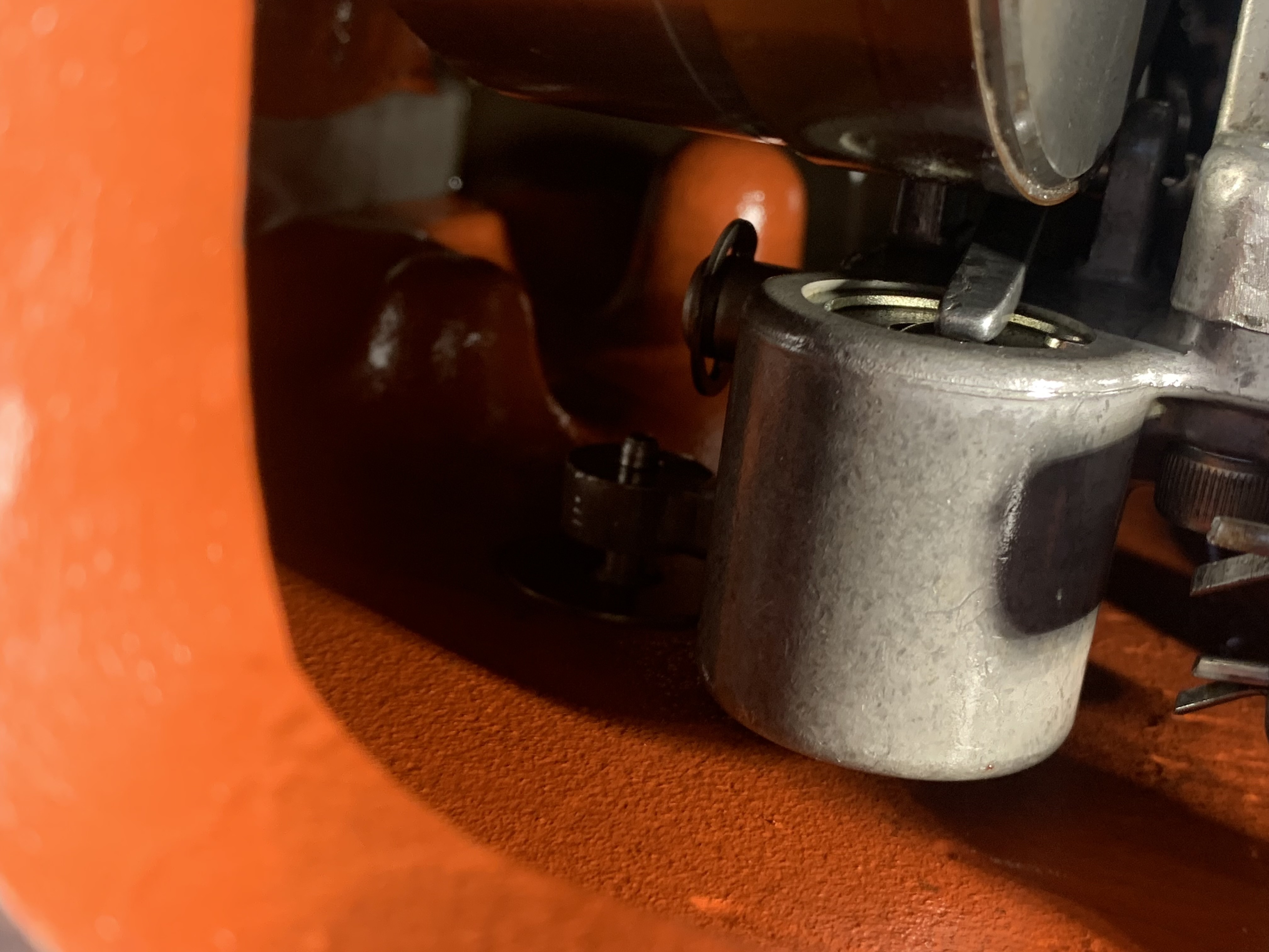

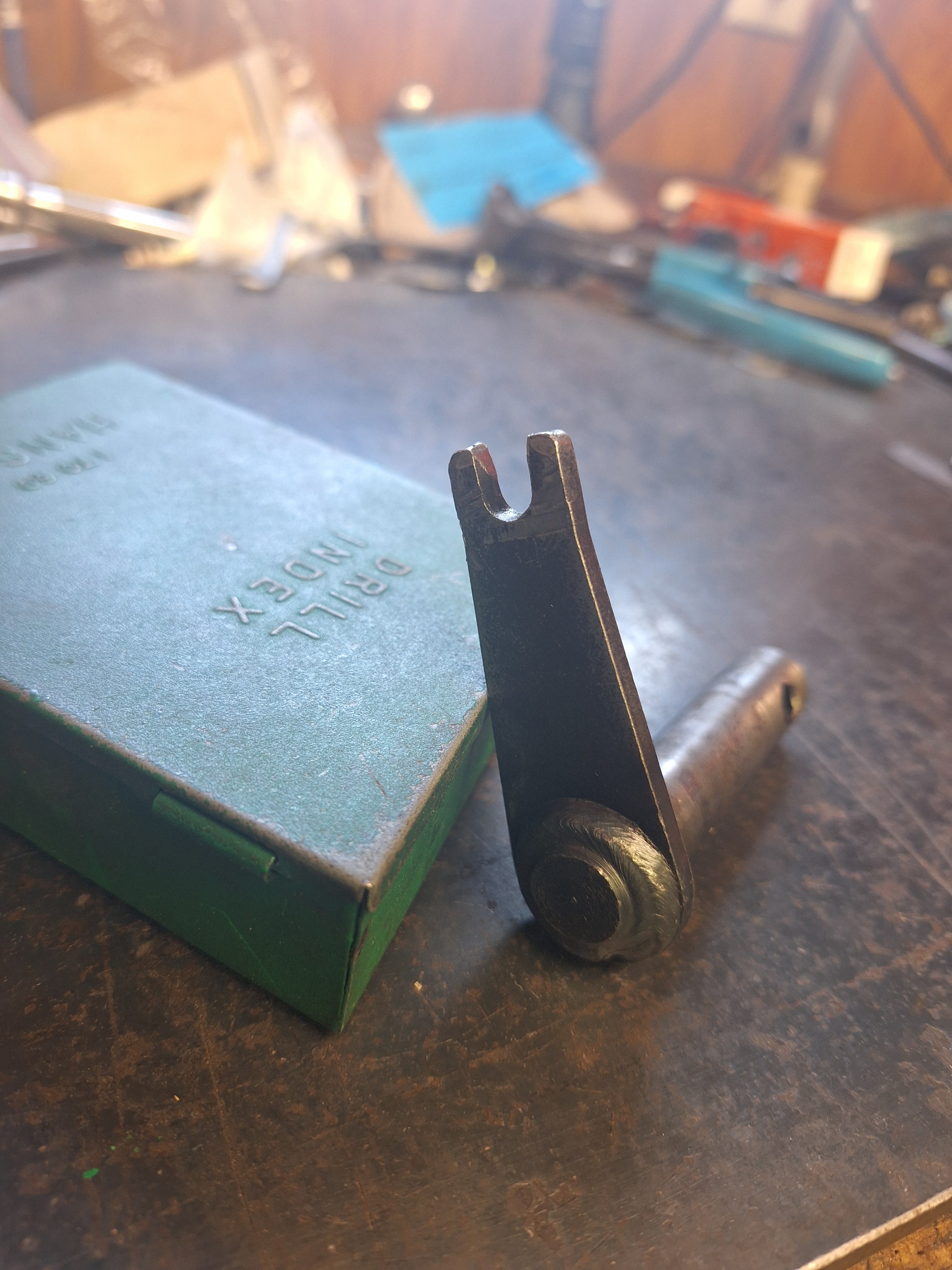

Ok... This is what I found this morning. When the shift handle moved outward from the outside of the case the spoolvalve clevis end managed to roll the fork out of the clevis.. There is no hole for a pin on the inside of the shaft like I thought there would have been. Seems like there should be a spacer or collar something to retain it......
Ok yours is the later model with the band brake
I’m working on one of these now

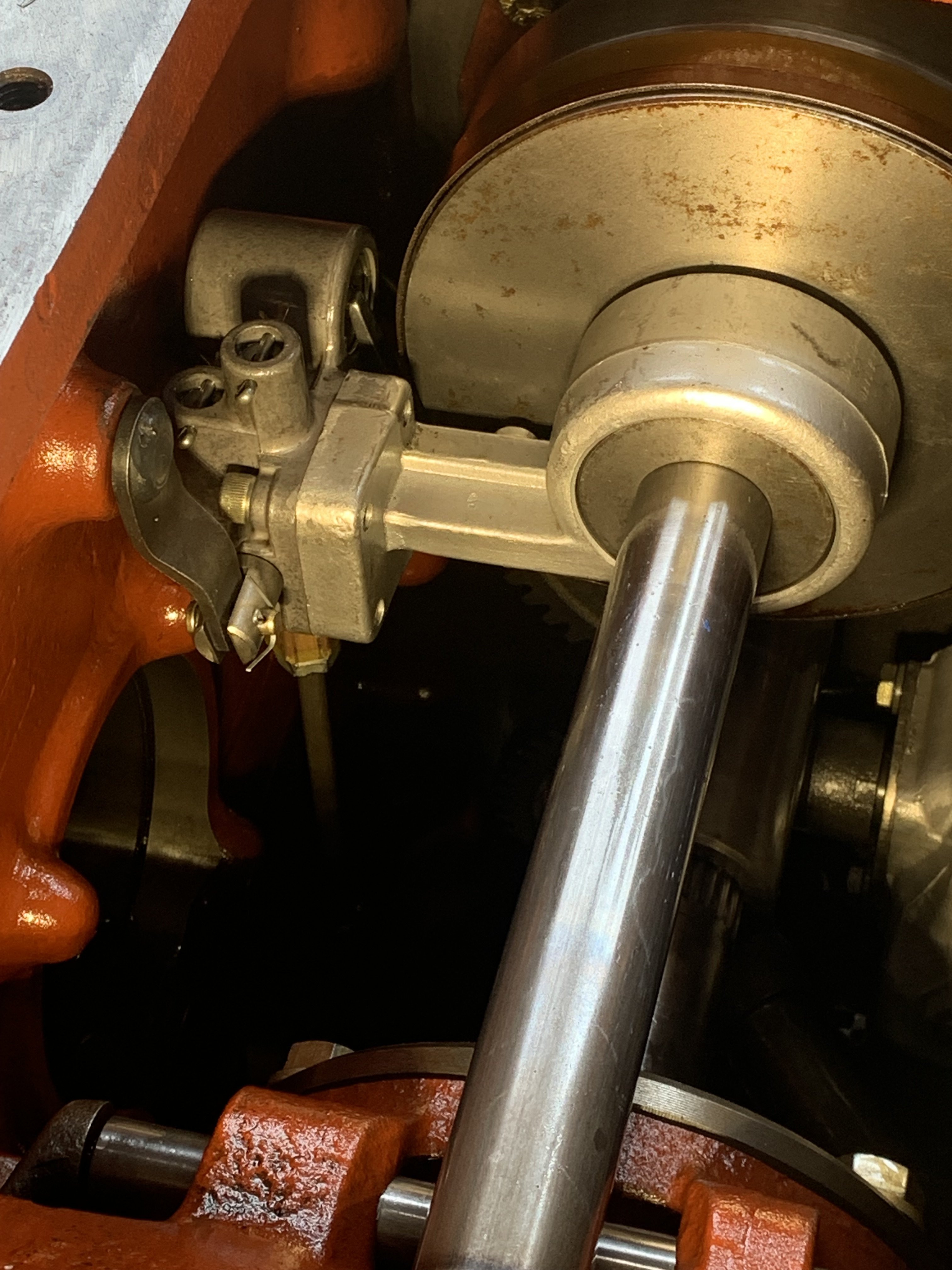

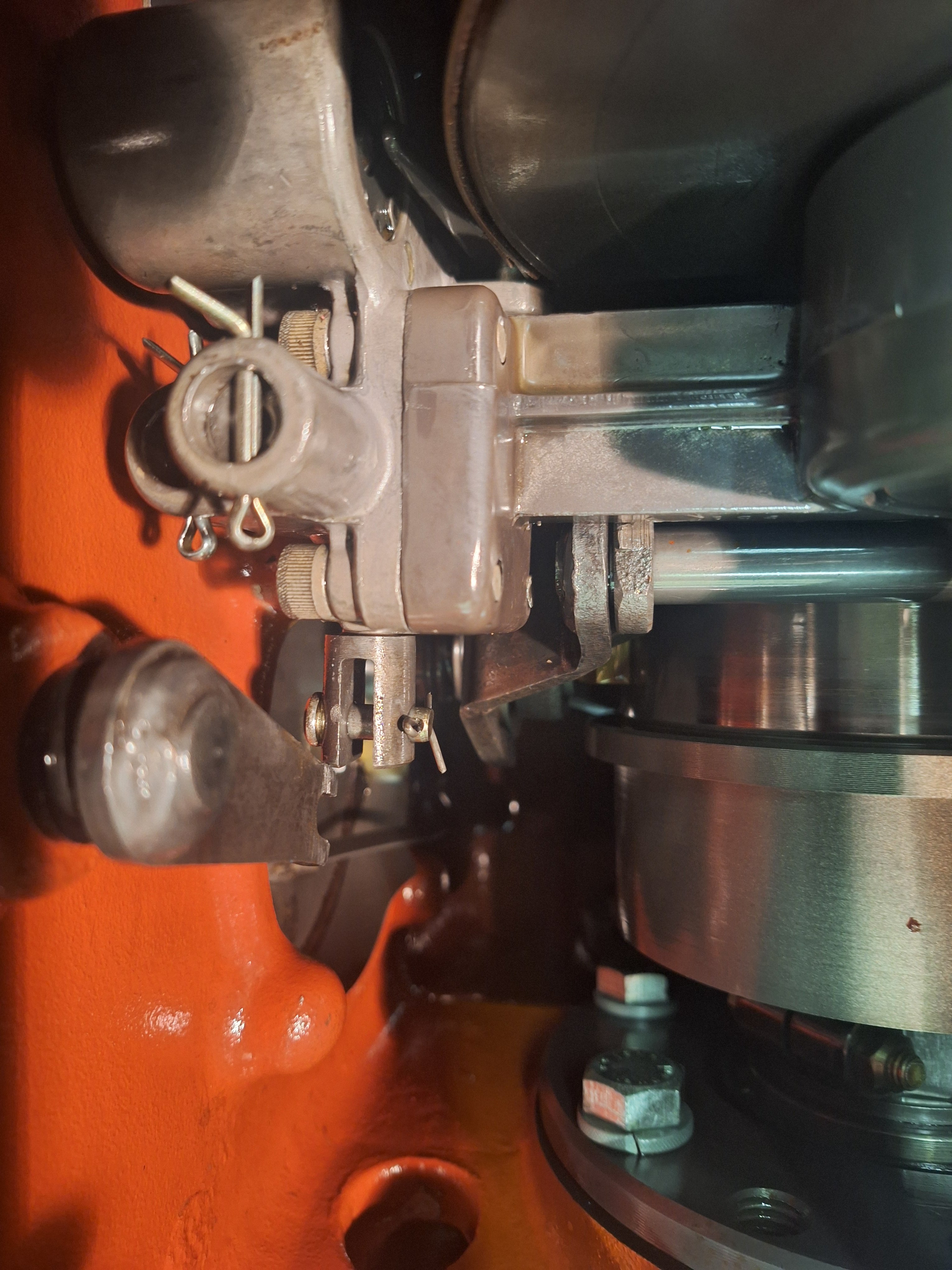

There’s 2 guide pins that screw in from the outside of the case that hold the pto control valve in position, have those pins come loose allowing the valve to drop down enough for the shift fork to not engage with the pin

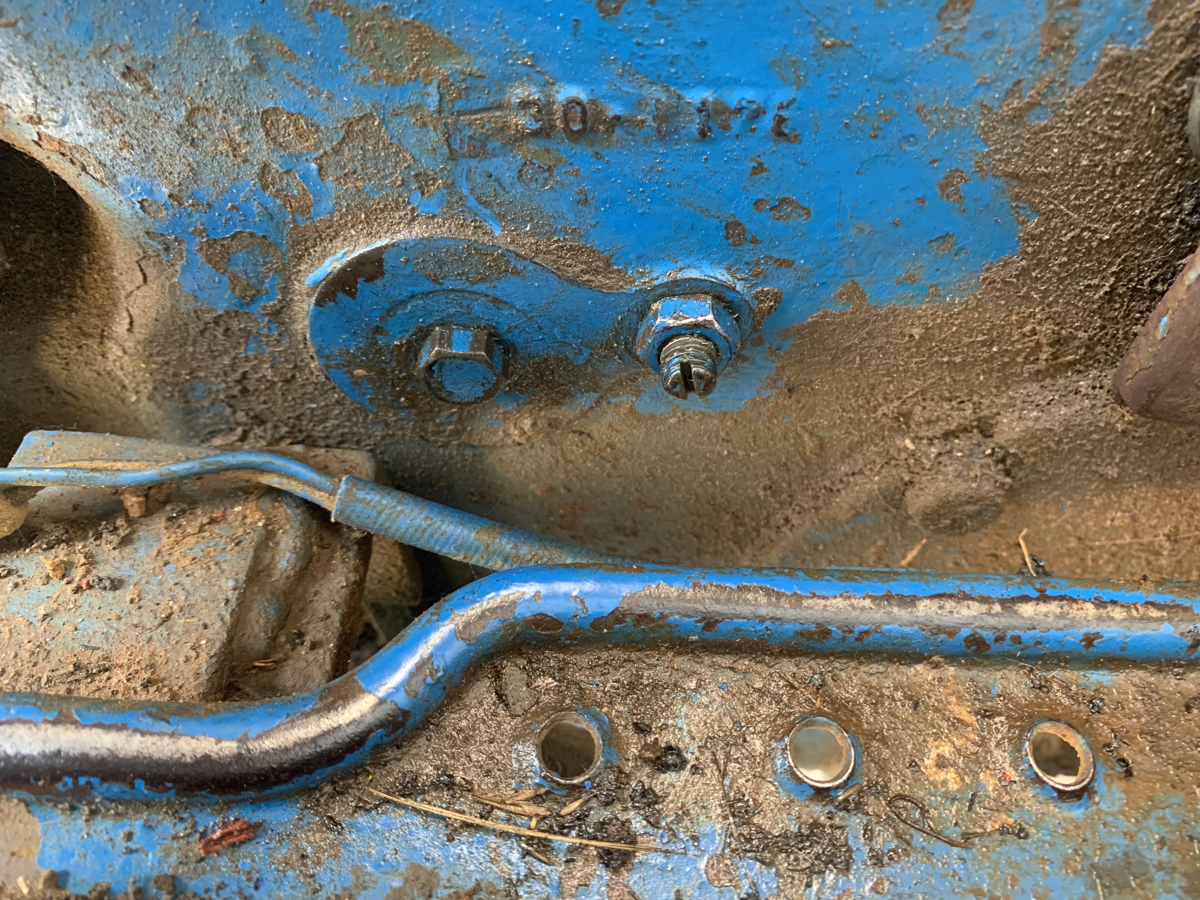

I’ll take a coupe photos an post shortly
Front pin screws all the way in and tight
Back pin loosen lock nut, turn screw in till snug, not overly tight, back off 1/4 turn and tighten lock nut
Enlarge photo and you can see the front pin sticking through the valves housing
