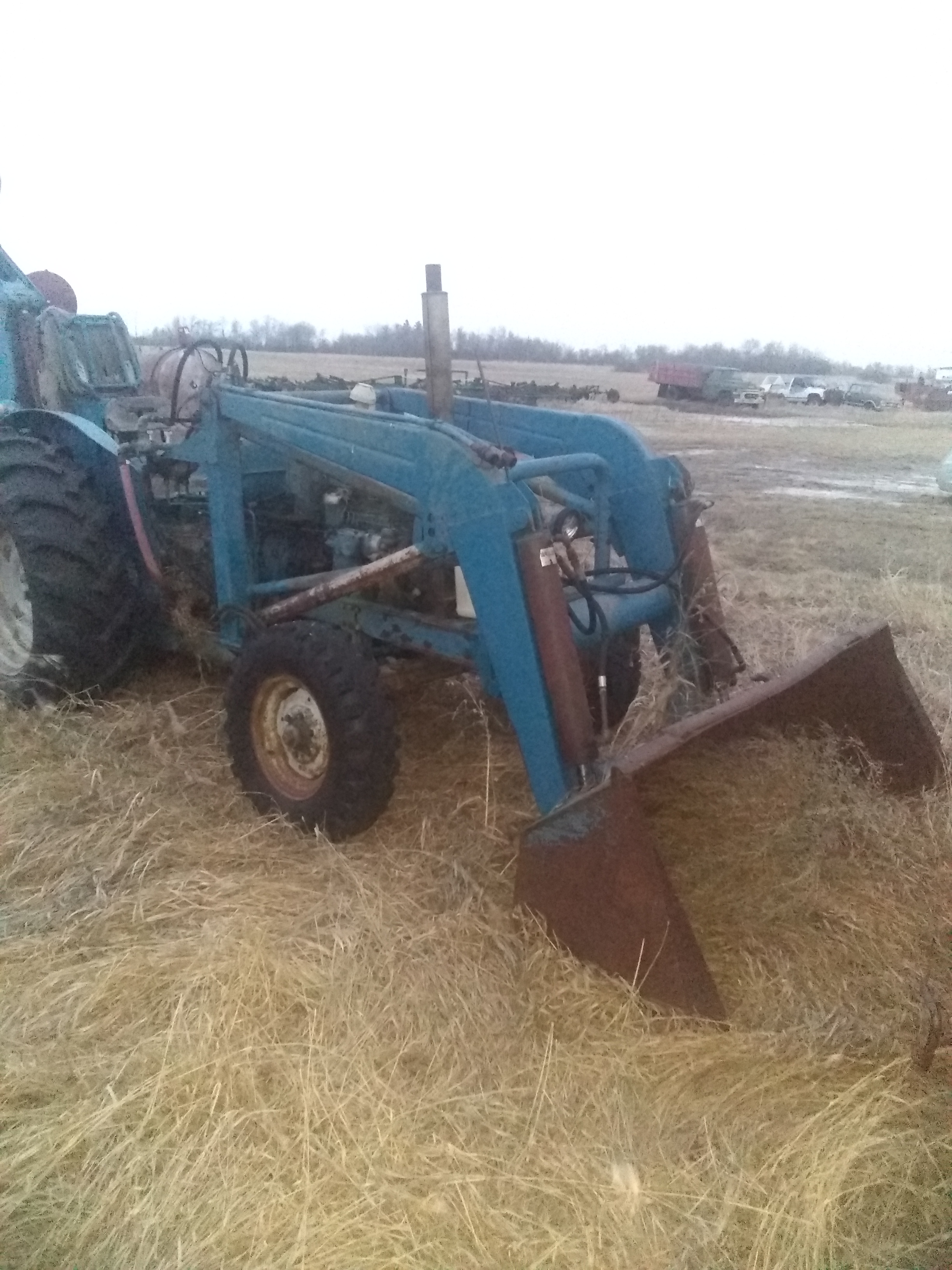

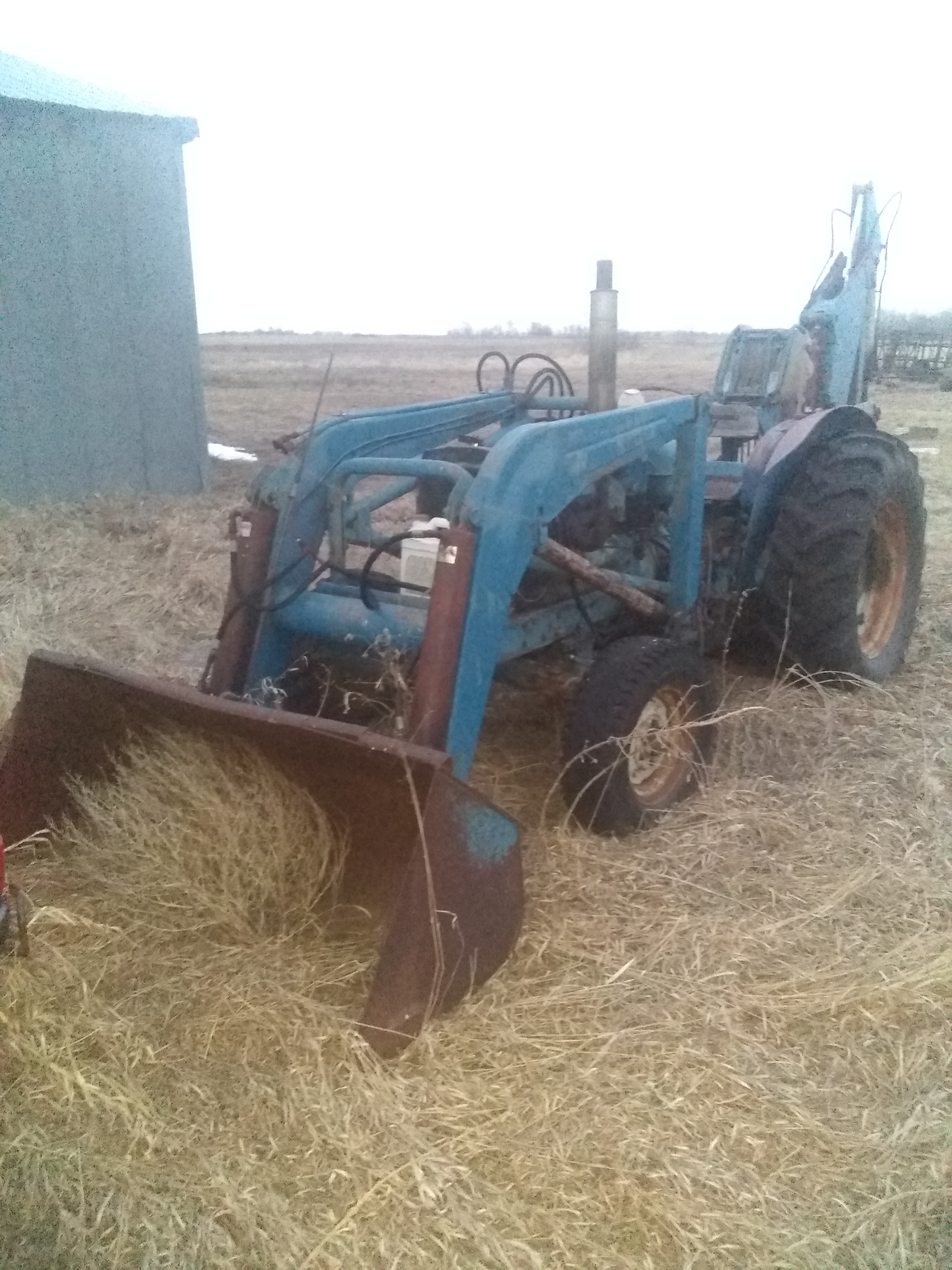

FWIW, here's my Power Major, a few years newer. I was thinking it was a Sherman loader, it may be Davis or a Midwest, I wish I knew for sure. The previous owner (now deceased) fitted the dual bucket cylinders.
I have a Sherman loader off a Fordson Major. It was built by Johnson Hydraulics in Minneapolis. Heavily built.
Sherman, Superior and Du All all made loaders that fit the Majors, but it's too far back in my memory bank to remember model numbers.

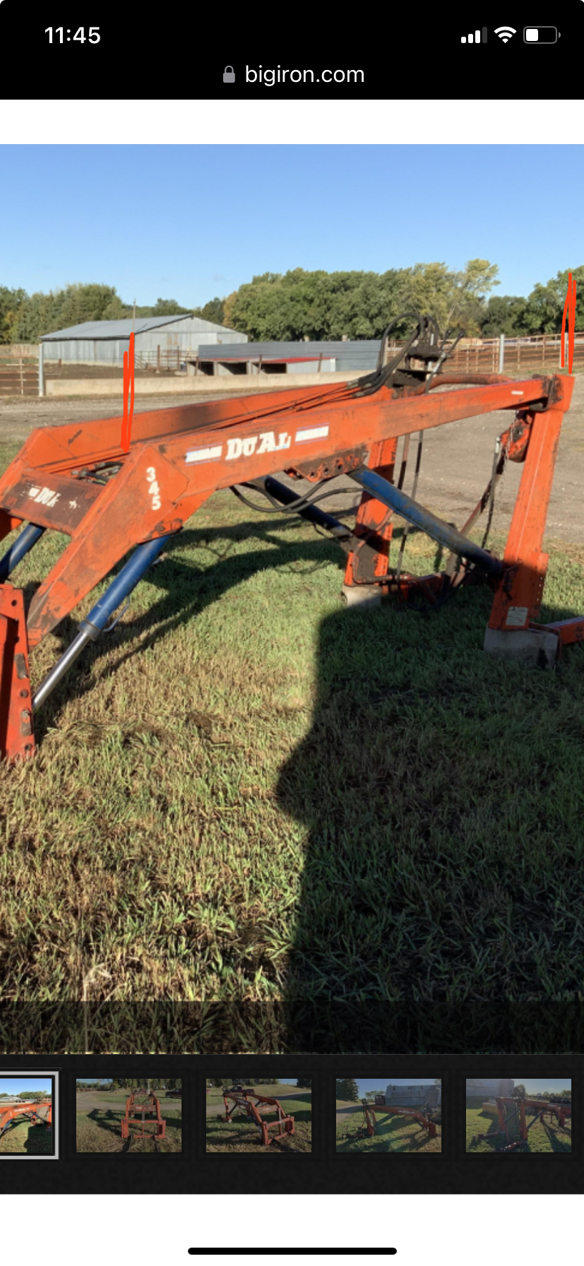

I have found a DU AL 345 loader and wondered if it would fit my Fordson any ideas? Also it comes with a lift cyclinder rebuild kit, is this a big job to do? Thanks
I did some searching and found references to 345s being mounted on 560 and 460 Farmalls. So depending on the adapters for attaching to the rear axles housings(length), if you are handy with a torch and welder, you should be able to adapt it. You will probably have to make front mounting brackets also. I don't remember the Du All cylinders being particularly difficult to repack, if you have the tools and skills.

If I was looking to mount a loader on my tractor I would be measuring its approximate fit for my tractor. Here is a photo of a 345. The loader would need mounted so the red line on the right would be placed so you could still get on and off the tractor the more it is placed towards the rear the better. Then measure from that point to the front of the tractor. If this would place the front cross piece below the left line any more than a foot and a half in front of the tractor grill than in my opinion that loader is to big for your tractor. Placing the load the loader lifts and carries to far in front of the front axle greatly reduces the load lifting capabilities of the loader in regards to weight transfer from the back of the tractor and increases the load placed on the front axle.

Was it removed from a Fordson Major? If not, and you're not equipped to perform the metal fabrication to make it fit, then the answer is no.
Rebuilding the hydraulic cylinder can be a big job, depending on the design of the cylinder. Some cylinders are held together with long rods. Those are easy. Others have the cap screwed on. Those can be difficult because they require large amounts of torque to unscrew the cap, so you need a giant vise bolted to a heavy bench, large wrenches, and possibly a torch to heat the cylinder. There are other types of cylinders as well which have varying levels of difficulty.
