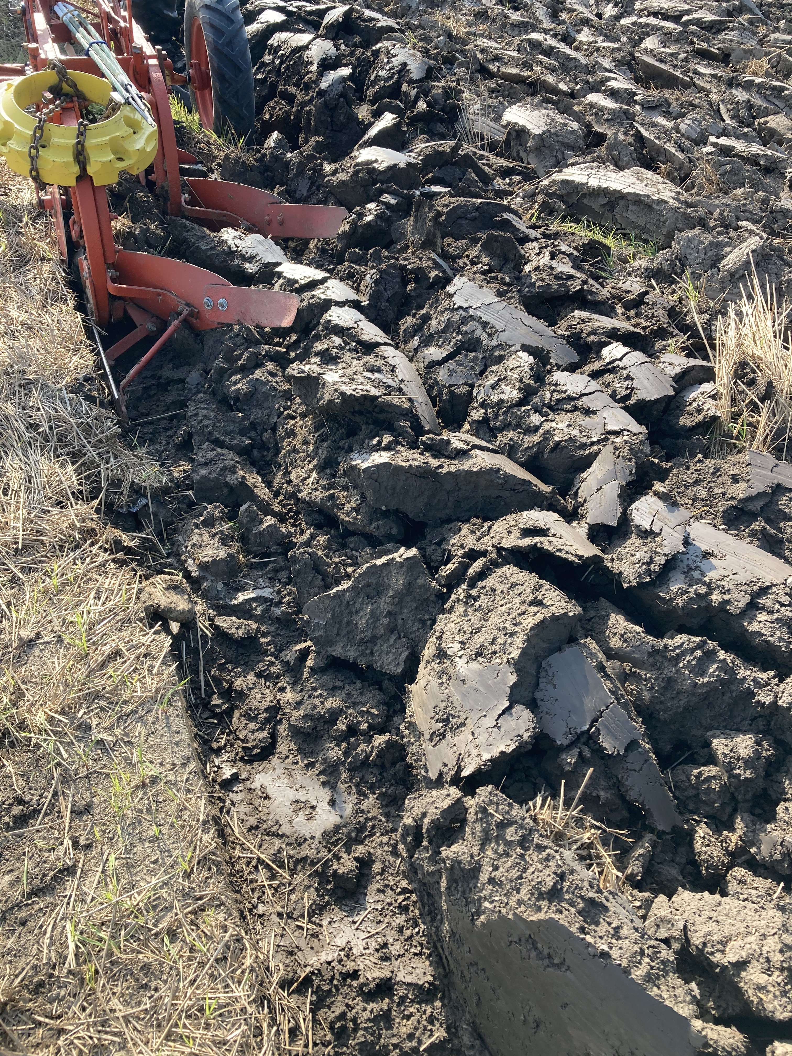

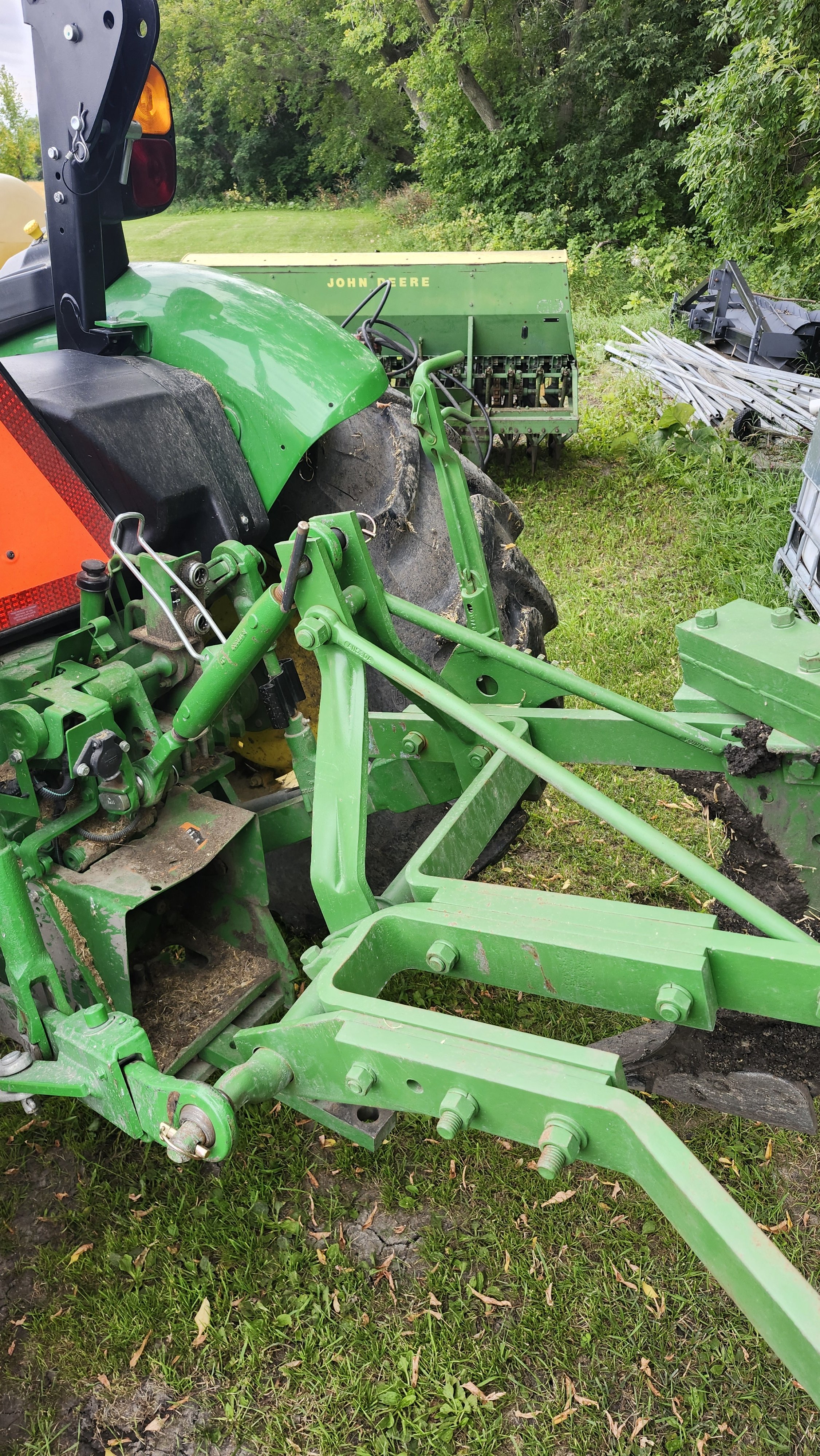

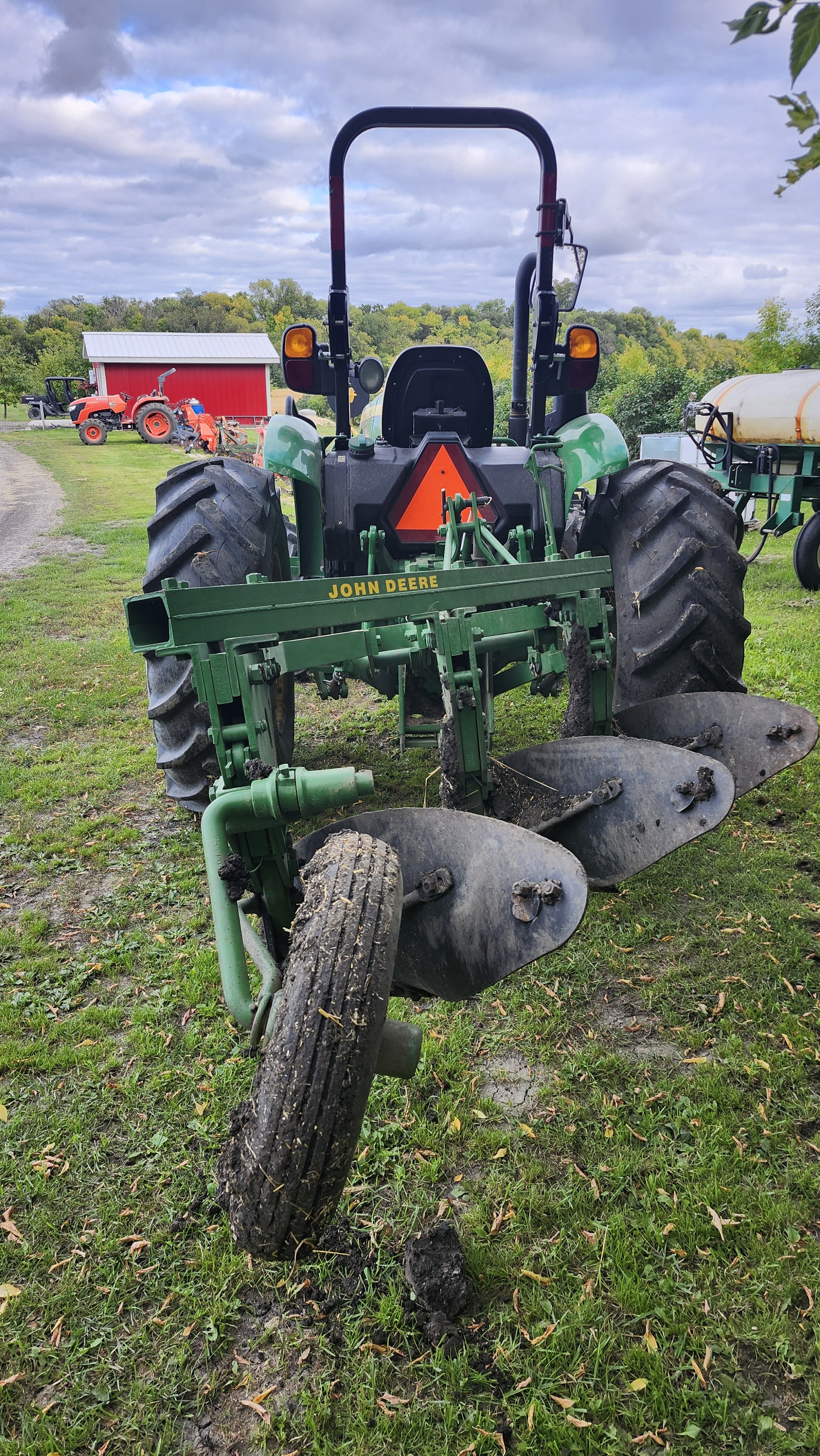

Need help with getting my plow to stay down. When I hit hard soil the back mouldboard comes out of the ground. I obviously don't know what's happening cause I'd say when I turn out the top link.. The push down the back board it's worse so if I got it right the front board pulls the plow down. How much does the leaver do for adjusting debth for the rear board.

I know I've badgered you into more and more photos, but I/we haven't yet seen the condition of the shares. A plow won't go in the ground if the shares are worn. I took a plow out once to do 'just a few acres'. It had worked fine the previous fall, but now it didn't want to stay in the ground. I finally bit the bullet, went to town, and got new shares. Night and day difference! the plow practically 'jumped' into the ground.
One disadvantage of a mounted plow is that it hasn't much weight to aid penetration. You may need to attach some ballast on the back. There are also 'Deep Suck' shares available.
As to the lever, it's called the Landing Lever, and it's for adjusting the width of cut for the front bottom. Should have zero effect on penetration of the rear bottom.
At this point- and really before you even went to the field the first time- you should follow instructions in the Operator's Manual for initial settings, not rely on what worked for the PO. You can look at it for free on-line here.
Thank you. I will look into getting some new shares. And I think a bit of added weight will help too. I'll get some more closeup pics when I get a chance
You can actually sharpen the shares with a grinder. Makes a big difference.

First thing I'll recommend is relocating centerlink attachment to middle or possible upper hole on the tractor. Where do you have draft control lever setting in control quadrant? What model is your tractor? Below are draft lever adjustment directions I copied from a different thread That I replied to that could apply to your tractor concerning operation of auto depth control of a 3pt plow. Back when I plowed with a moldboard in really hard ground I adjusted RH lift link a little shorter than normal to roll plow point to the left a little. ,

As others suggest, what do the plowshares look like, and we have to assume they are wore out since you didn’t show them. Even if they ‘look pretty good yet’ they are probably wore out. That’s the number one thing.
A plow sucks down into the dirt by having that front point pull into the dirt, and the angle of the bottom helps it stay down - sometimes too deep. As you found, tipping the plow forward or backward often has the opposite affect to what one expects.

All weight will do is make the plow "smear" the ground. Won't make it penetrate any better. You need good shares, need the plow leveled properly, and need ground that can be plowed. If it's dry and the ground is rock hard, trying to plow is a waste of time.
