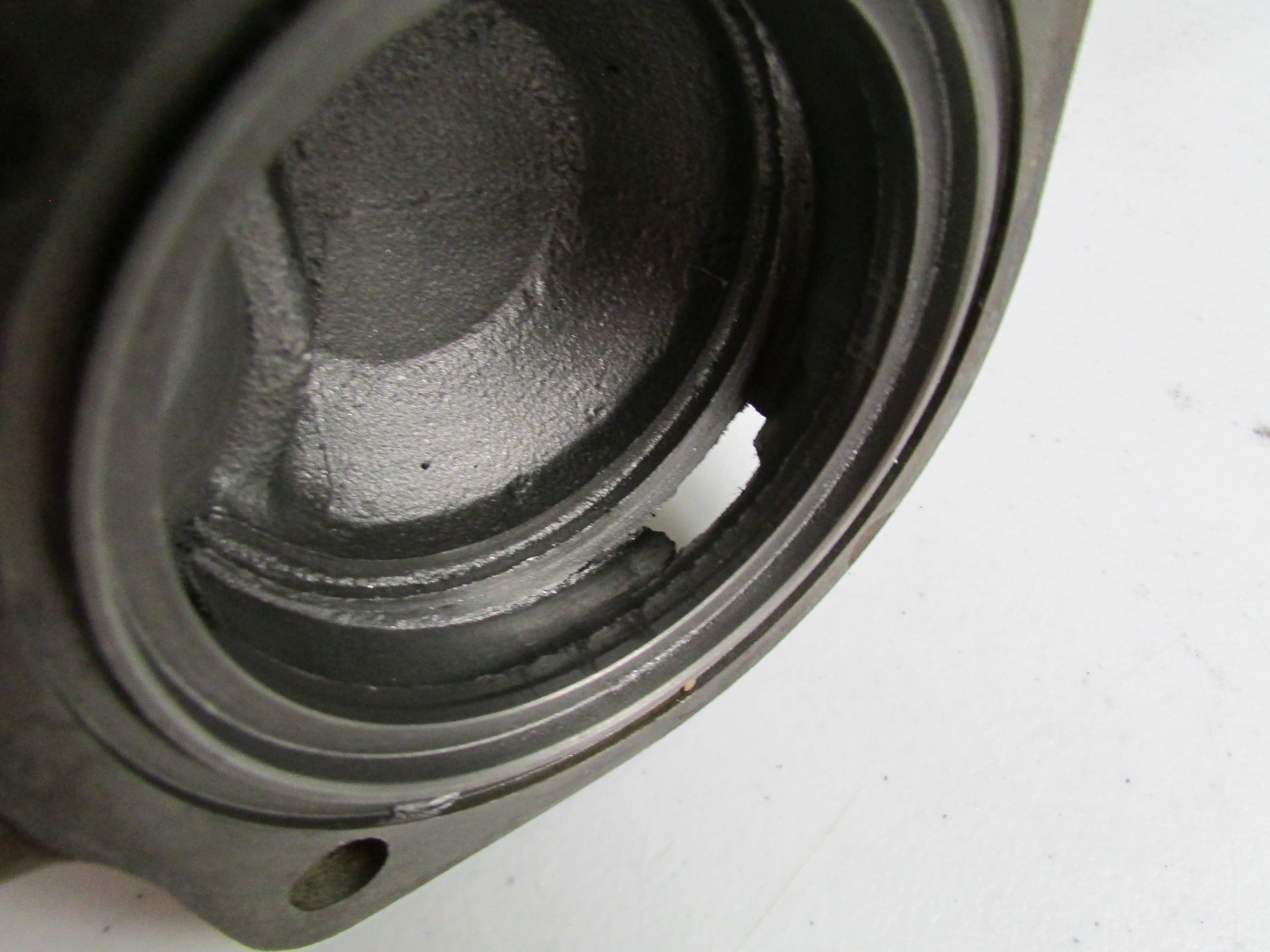

It has a gear inside it.
And show what goes in there? My point is it may not even hurt anything if it remains open, it is inside the crankcase, correct? So if it leaks it wouldn’t hurt anything. Only thing that might matter is if it is supposed to hood some level of oil in there for lubrication. Or you could skip all the possible heat distortion by repairing it with epoxy/JB weld.
Too late, I all ready welded it. It did distort a little bit, but not too much (I preheated it before I welded it, I also put it in sand sand after I welded it). I used a stick (with 99 percent nickel rods) and mig (with the regular wire) welder. Before I painted it, I tested it for leaks.
