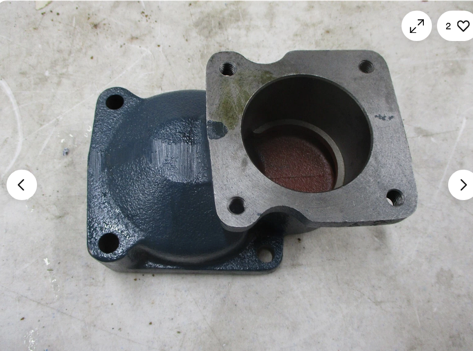

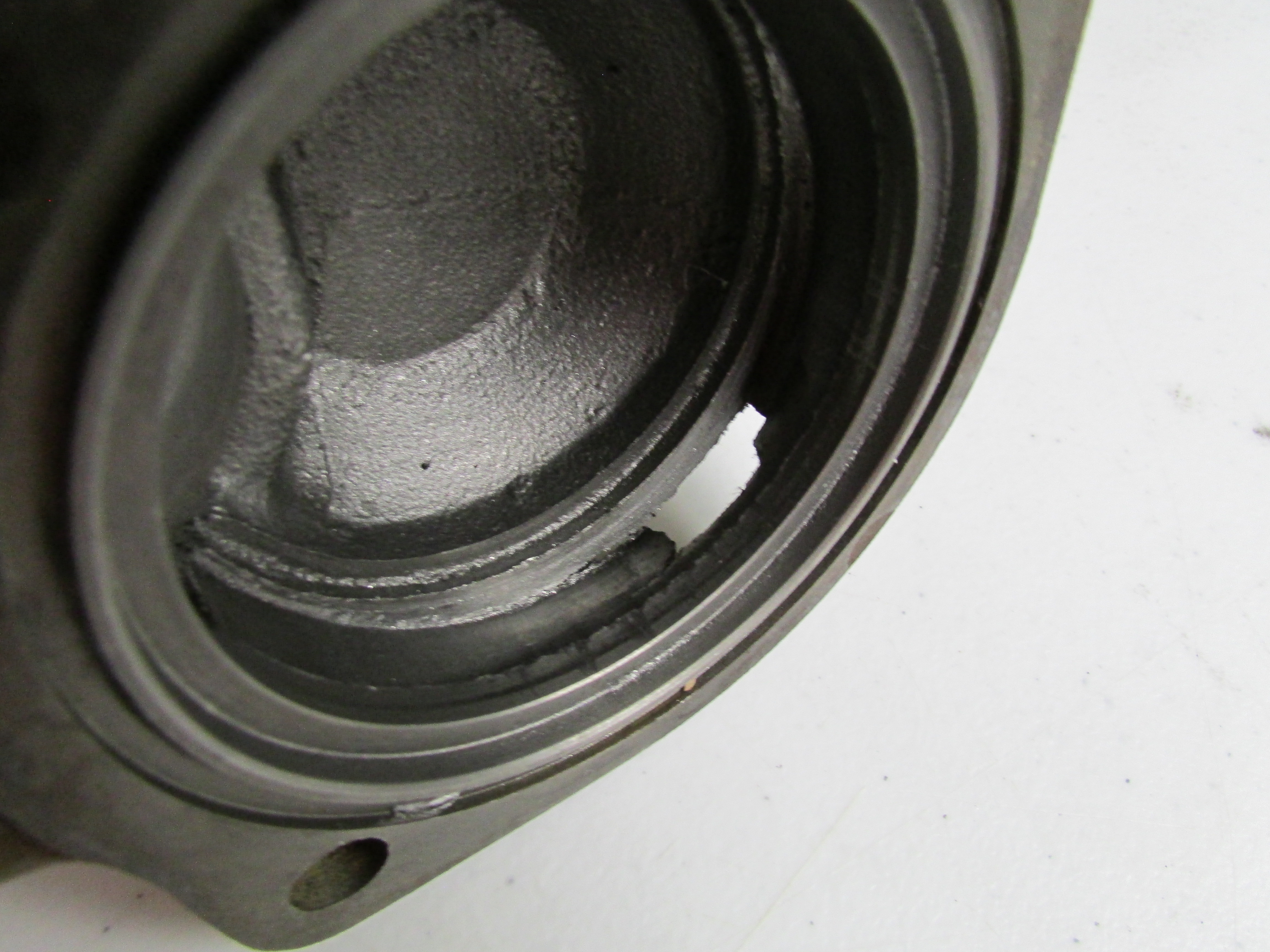

Doesn’t the part with the hole in it in reply 36 need replaced?And Ebay.

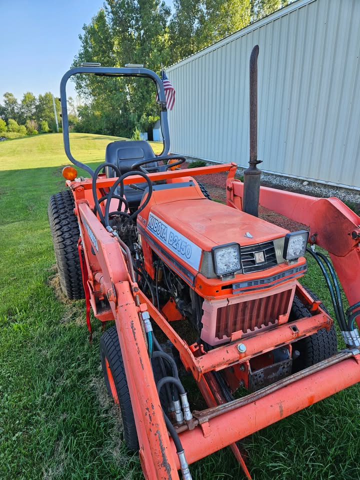

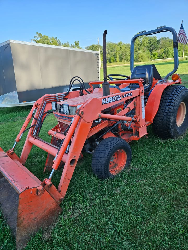

Today I bought a Kubota b2150 4wd tractor for $1700. They said it had a blown engine, but I think it has a blown head gasket or a fuel issue (maybe water in the fuel), because they said the exhaust went white, then it quit. what do you think?
There is no turbo on this tractor.Seal blown in the trubo?
Yes it does, I'm still trying to figure out what I'm going to do about that.Doesn’t the part with the hole in it in reply 36 need replaced?
Now I ordered it.Doesn’t the part with the hole in it in reply 36 need replaced?
Its not identical, but I think it will work.

What does the inside of that part with the hole look like? What goes inside it?Update: That housing didn't fit. So I ordered some high nickel rod to try welding the other one.
