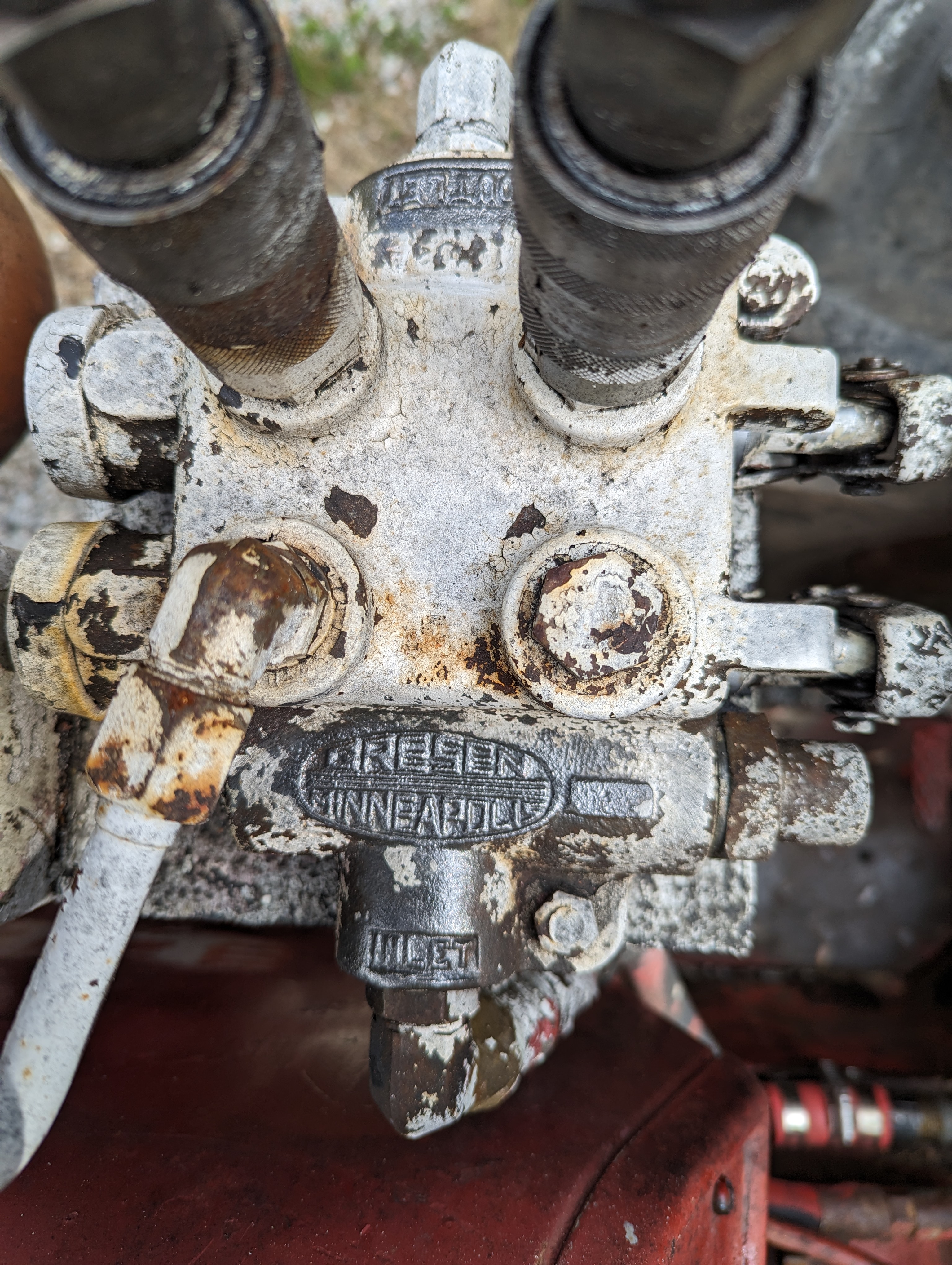

I'm trying to locate a rebuild kit for a Gresen Hydraulic Valve. There is no model number on the valve.
Any help is appreciated. Thank you.
Andy Frost.
Number appears to be right there by the word "OUTLET."
There's nothing to "rebuild" on these valves. There are a couple of o-rings on the spools to prevent leakage to the outside but the main seal is dependent on a lapped fit of the spool and valve body.
