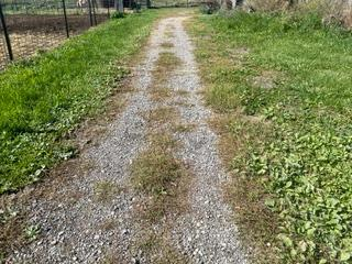

Just to be clear this is what my son in law dumped 1 year ago in early fall just taken. I have been filling low spot from it with s shovel this summer when I could. The next two pictures are of what they skimmed the top and laid down 3 inches thick and rolled with his vibrating road roller like what you see in construction sites That was done three years ago. Millings are not the same as you can read from reading from different areas. These pictures were taken between 1:09 and 1:12 ---10/18/2026
This first picture is what I put down last fall after repairing the fence on the left. The next picture is where I stop and dump feed every day and with the rain what happens when I try to back up ehat causes the rear casters to rotate causing resistance.
