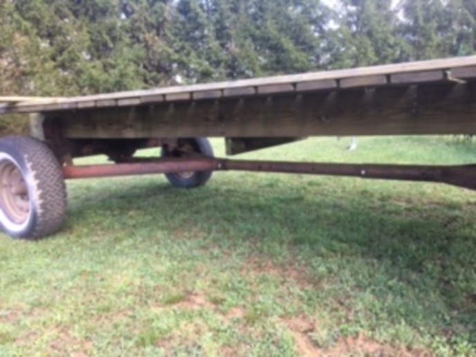

I recently picked up a farm wagon at auction. It has a 6x12 foot flat deck, which is fine for my needs. I am going to use the wagon behind a Farmall H pulling an engine-driven NH Super 66. It has a bale chute and my goal is to have someone on the wagon to stack bales while I drive. I've used the baler for the past few years just dropping the bales on the ground, so the hope is to make this an improvement over that. Small operation: 20 acres hay, with maybe another 20 if I can get a second field groomed up.
My question: the wagon is flat-top right now. I have seen them with just a fence at the back (1 side) and also with both sides and back (3 side on wagon). With a thrower 3 sides is of course needed. But what's the best option for baler chute and hand-stacking on the wagon? Any insight appreciated. Thanks in advance, Dave

6 X 12 sounds like it could be a repurposed barge box (grain wagon) from about fifty years ago. Is there a hydraulic hoist under the front end? It would probably hold 60 to 80 small square bales.
Thanks everyone for the responses. I'll pick up some stake sockets and build just the back.

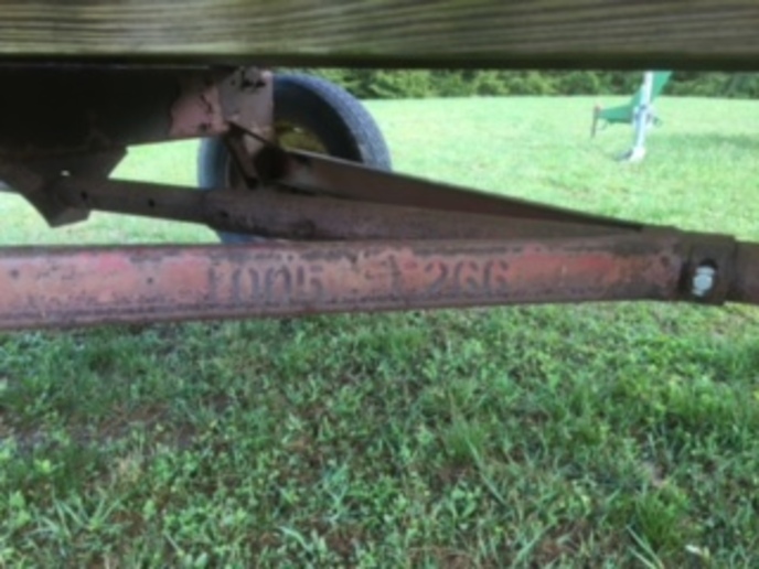

The running gear looms like a typical hay wagon running gear that has been set in a couple notches on the telescoping tube frame. The only markings I see look like L005-E266 on the rear half and L005-E255 on the front half. The deck is 5/4 pressure treated lumber. I'm guessing whoever built it had some 12ft boards and just cut them in half.
I would have preferred a 7x14 but it was slim pickings at the Spring auction this year. I could add an overhang at the back to add a couple feet length if I think it is too small. But with an H, the baler, and the wagon, a full load could be 80-100 bales. My ground is pretty flat but has some spots where I do not want to experiment with the upper limits of what I can control, especially with a person on the wagon.

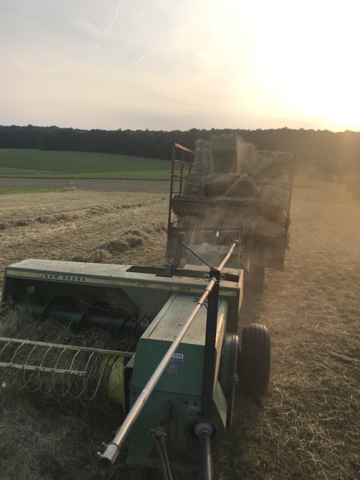

This is how I've settled on building my wagons. The one in the pictures is 8'3" wide and 20 feet long. It is the 4th or 5th one I've built, and I've built one or two since it, but it is about the optimum size and design for what I do. It has the most angled back backboard of any I have built, and is also the widest, and the hay stacks the best on it of any I have built. I can put around 120 bales on it stacking 4 high with it hooked to the back of the baler, or I could easily go 150-200 bales if I wasn't on such hilly land. The one in the picture is also on a home made running gear that I made from junk odds and ends I had laying around.
I have built them as small as 7'10" x 18' and as large as this one. I normally use 6" or 8" channel for the main runners if I can get it, but have used other scrap steel. My next one will probably have oak 3x8 runners since I have a sawmill now and can make my own lumber dirt cheap.
I bale anywhere from 500-2500 bales in a year, so I am definitely I small time operator. I use either a Farmall M or a Farmtrac 35 to mow with a New Holland 472, A John Deere 1050 with a two basket tedder, a Farmtrac 35 with a V rake or JD 1050 with a NH 256 rake, and a Massey Ferguson 35 with a New Holland 311 baler. My goal is to build 10-15 wagons and have enough barn space to bale straight onto the wagons and park them in the barn without ever unloading, until they are unloaded unto the customer's truck or trailer.
I have very little money in my wagons, just a little time, so if you are so inclined you can expand your wagon fleet without spending a lot of money.
