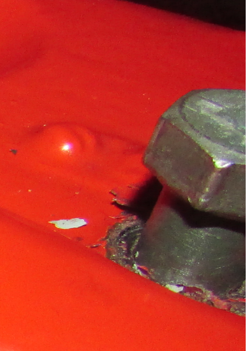

I think the question that remains to be answered is what are you going to do with the head? The uneven surface under the screw heads is bad for both the head and the bolts.
I would be tempted to look at drilling/spot facing or whatever you should call it to get a flat surface, but that surface may wind up in a bad place. Welding is not an easy task in cast iron. The third thought that comes to mind is to drill the hole larger and insert a threaded cylinder to spread the load better and give you a flat place under the screw head. At this point, I have to stop criticizing TOH knowing that his answer will be better than mine.
