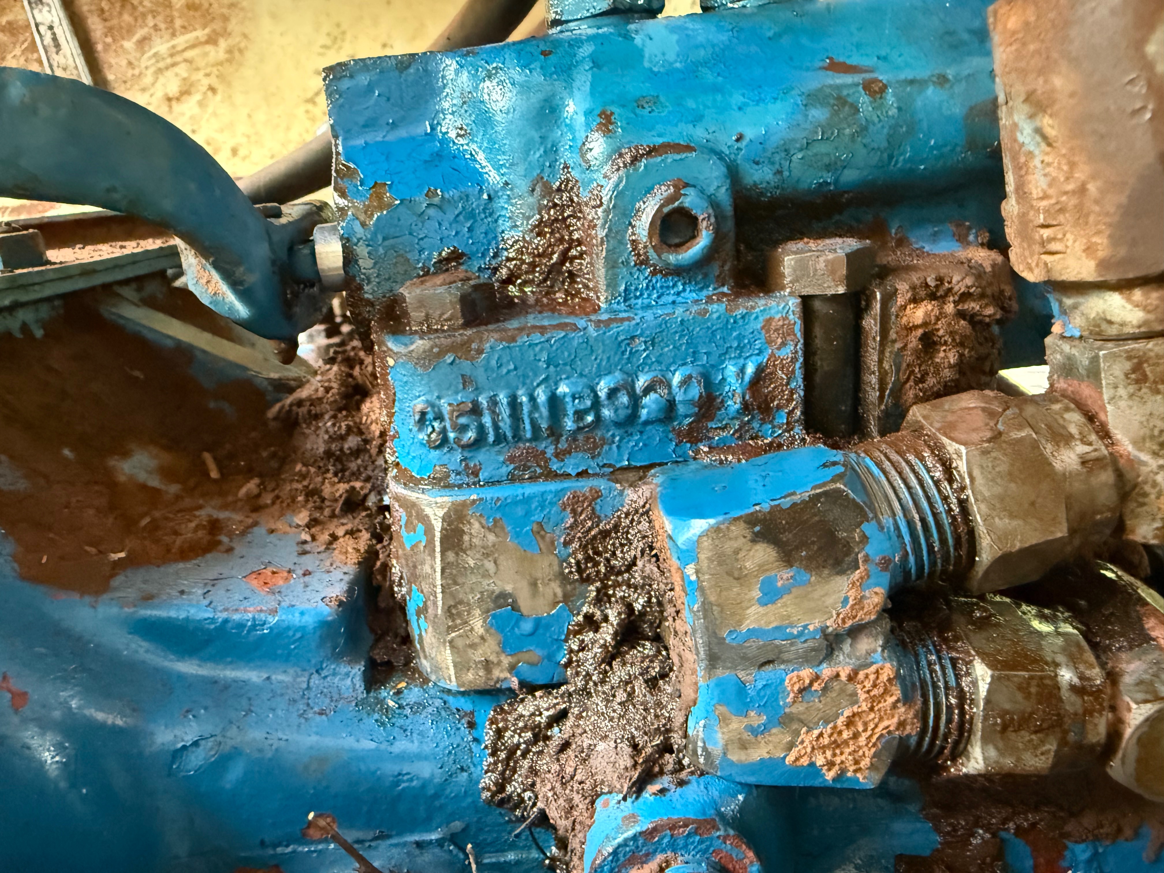

One is the serial number but this is the second Ford tractor located in Australia I’ve seen with a serial number that didn't match the normal Antwerp, Basildon, USA numbering systems
Second odd thing is the adapter block between the remote valve and lift top, this is to divert fluid the the valve on the left side that is probably the loader control valve, this would have likely been dealer installed and similar to the HV4902 adapter available today

Only two things odd about the tractor that I see

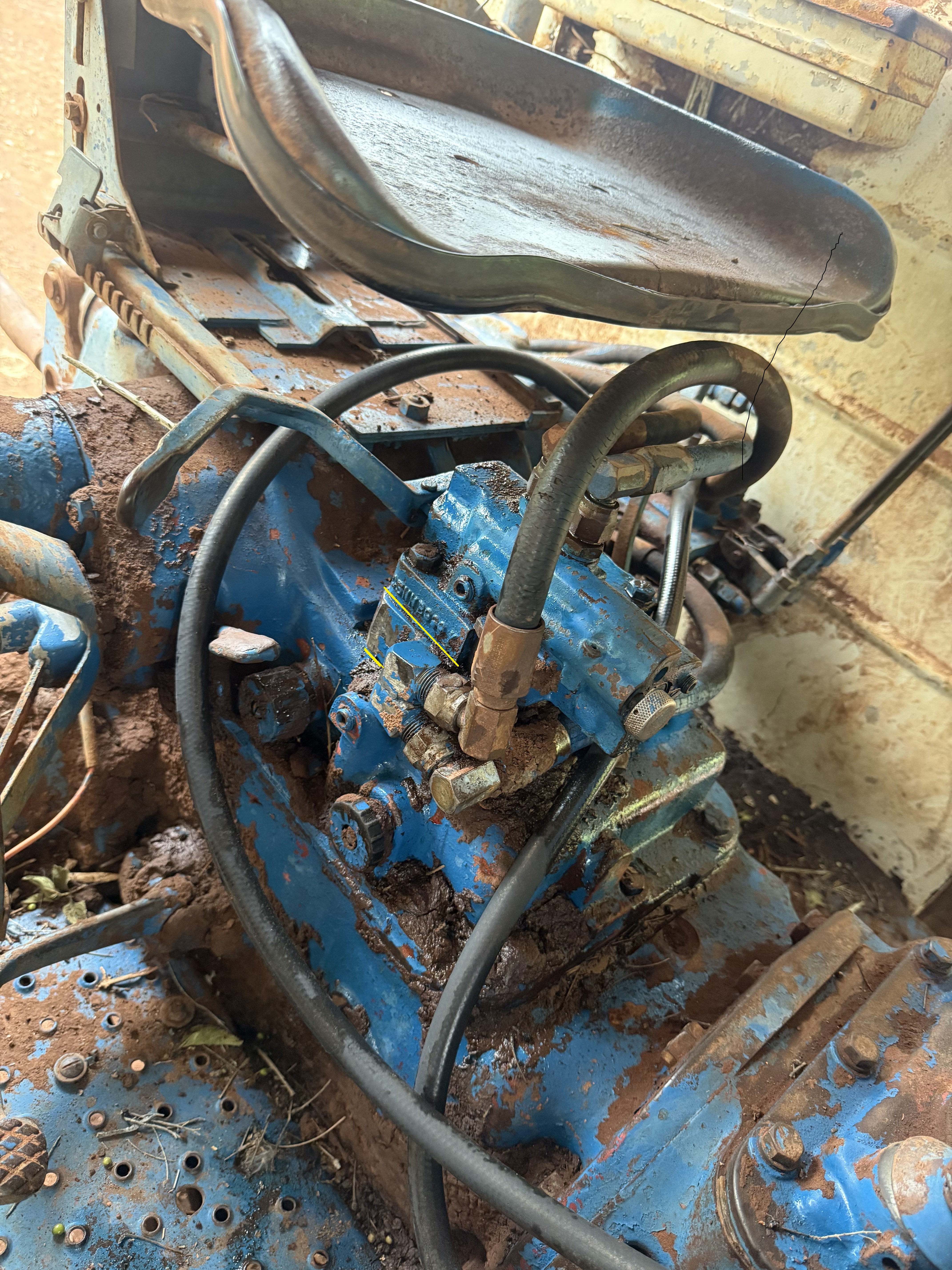

Hi mate, can you use one of my photos for reference about the valves you’re talking about? The control valves on the left had side of the seat control the bucket if it’s attached and the lever valve under the seat lifts the 2 front rams (this valve needs to be replaced) hence why I’ve come to investigate and talk to the pros on the forum.

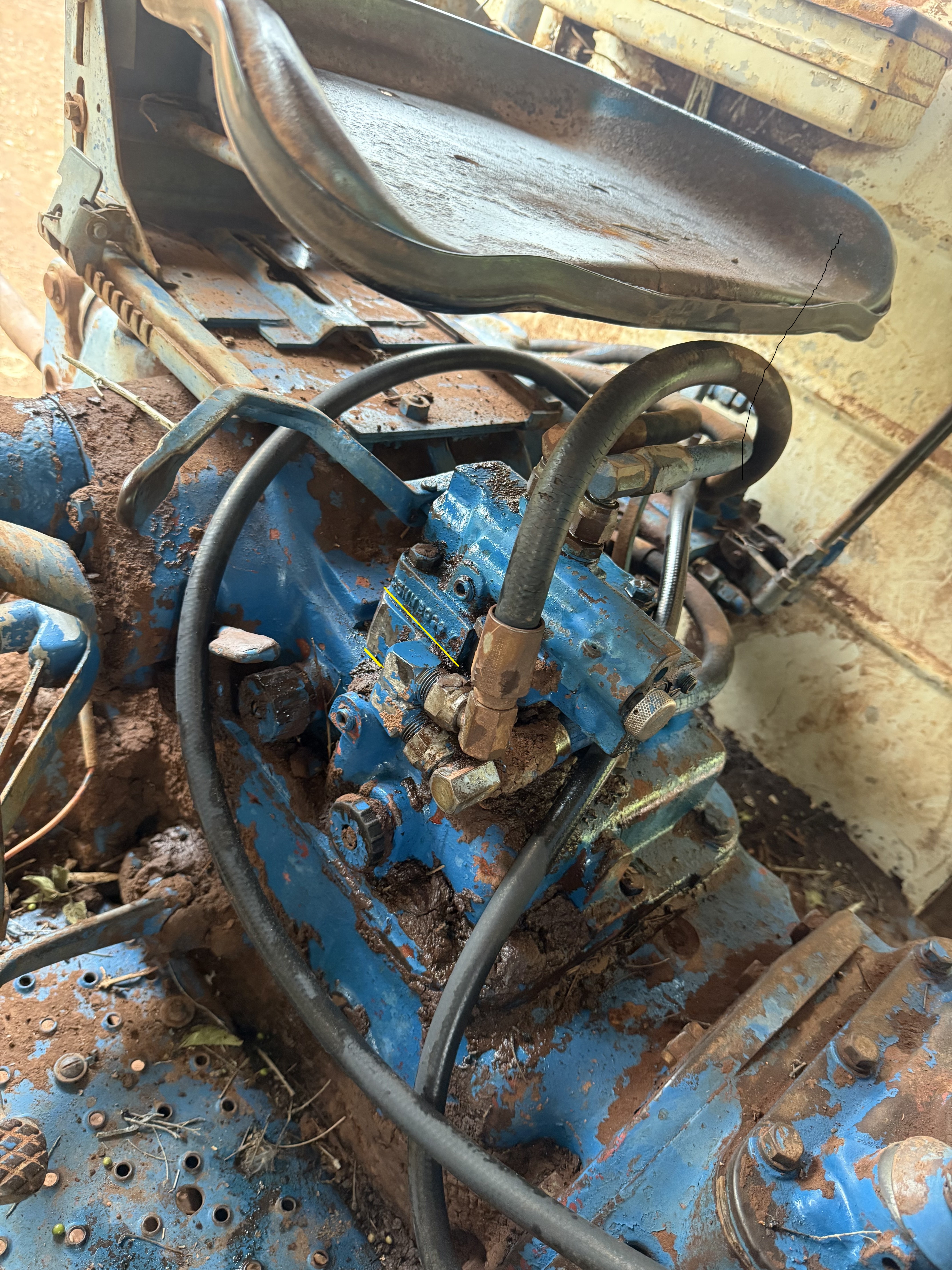

I have added yellow lines to the top and bottom edges of the block that he mentioned. Above the upper line is the remote valve. The two lines are
the upper and lower edges of the hydraulic adapter block that provides the ports for the two lines that power the loader.
I have added yellow lines to the top and bottom edges of the block that he mentioned. Above the upper line is the remote valve. The two lines are View attachment 138932the upper and lower edges of the hydraulic adapter block that provides the ports for the two lines that power the loader.

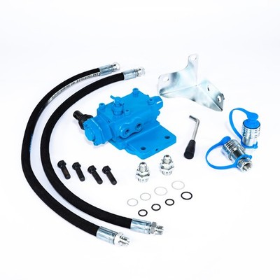

I need to replace that valve it’s corroded to the point the front retainer has blown out I will add the eBay links of people could advise me on which valve would work best please.
Personally for some reason I feel the one from Holland unless there is a dedicated place you guys know of I can get parts like that?
