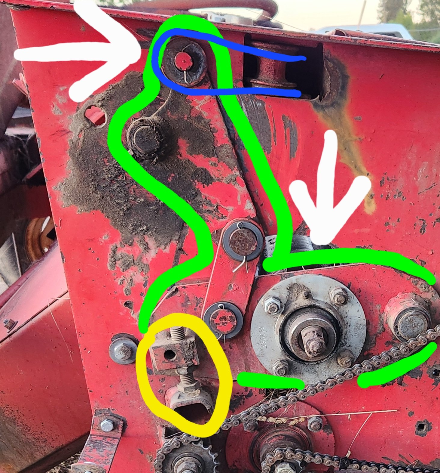

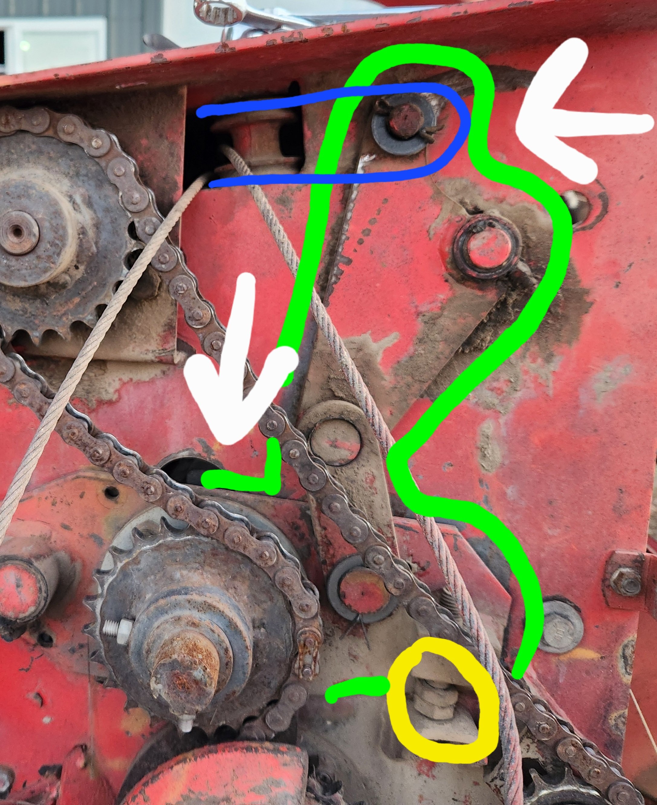

There's a loose loop of cable coming out the side and I have zero idea how it's supposed to be or what it does. It's located above and to the rear of all the moving components/linkage on the side and is routed around what I will describe as a pulley. The cable goes from one side of the swather to the other with mostly "unknown" in-between because it's hidden from view the majority of the way. From what I can see underneath, the two dead ends of the cable going in the one side are hooked to a very stout coil spring that is "floating" behind a cover, presumably because the other end isn't connected properly... Looking through the hole on the other side looks identical (but is completely shielded underneath). Somehow the cable on that side has gone inside... I'm at a complete loss and any help would be greatly appreciated, even if it's a link to a PDF manual I have to pay for. I'll attach the pictures of what I think is needed but will gladly post more. *Someone just said it might be for tension on the conditioners but I don't see how that would work, where the loop of the cable would go, or how to adjust it.*

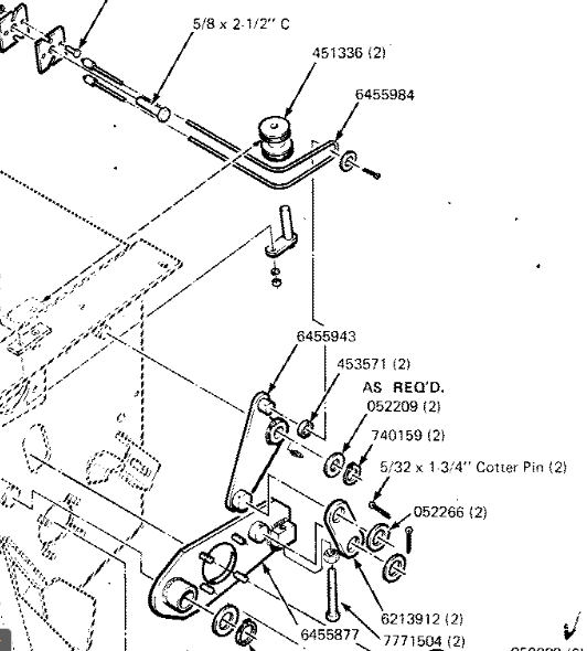

Like Jon F said the cable is for the hay conditioner tension system. It goes around the double pulley then attaches to the link directly behind it. The reason for the bellcrank system is so that when the rolls open up wide to pass a slug the tension drops way off which helps reduce plugging.

From what I read in one of the threads (I can't recall exactly what it said, but can dig it up if needed) it said there were differences in the machine itself (PT10 vs 1010) aside from the tongue not being solid mounted to the side. Maybe something about the rollers being driven by belts instead of chains? Am I completely wrong on that?... Controlling tension of the rollers makes complete sense now. So in these pictures would the cable (blue) be routed around the top pin of this assembly (green), with the white arrows indicating the two directions of pressure which would pull the top roller down, with the bolt/nut (yellow) being an adjustment for minimum clearance? Assuming that's correct, what's the minimum clearance? I would think the only time it would need adjusted now is as the top roller wears? Without that spring being connected it would still function correctly just not condition (smash and crimp) the hay, correct?

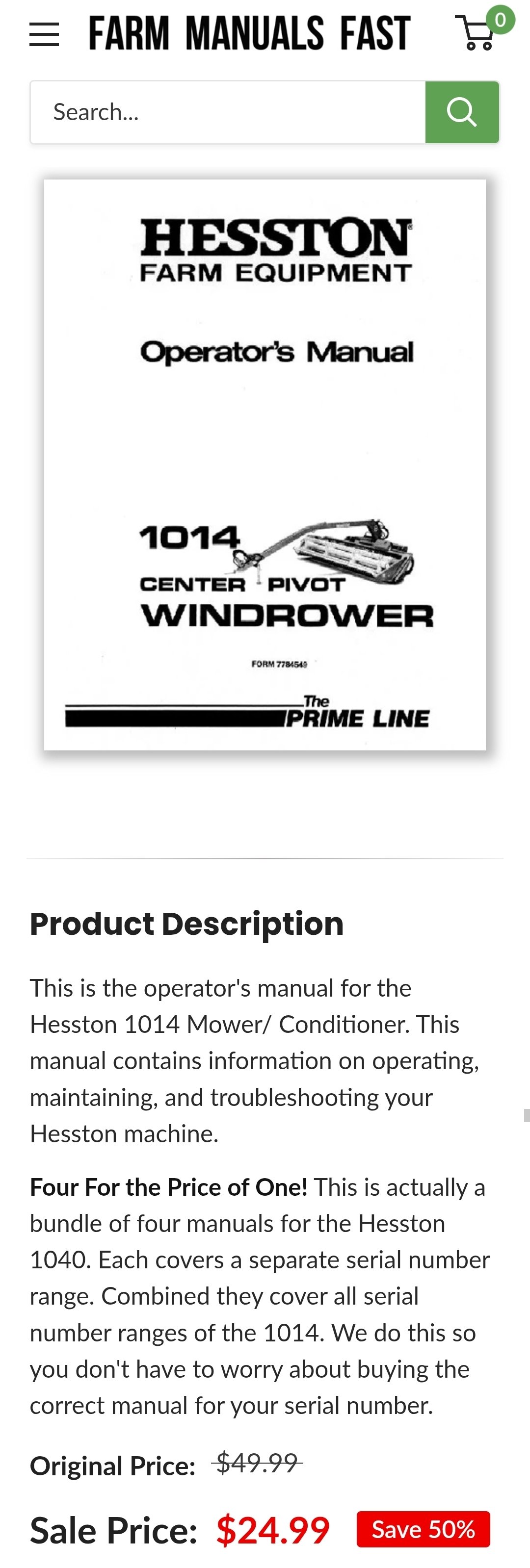

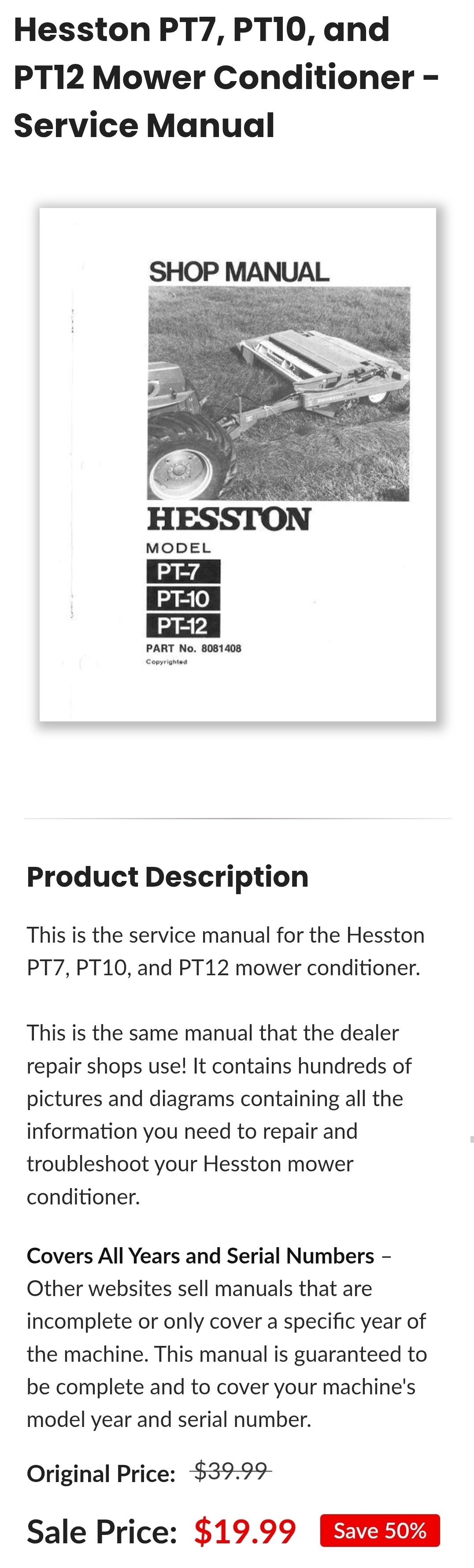

I found two service manuals online that I think would be appropriate for me based off your comment about the PT10. One is that manual and the other is for the 1014 center pivot. Would that cover all the bases for me?... Oh, and finally, the front seal of the hydraulic pump is leaking out the front seal sometimes a thin but steady stream and sometimes a slow drip. Is it a standard seal or something special? Will it be straightforward if I just open it up to swap it?

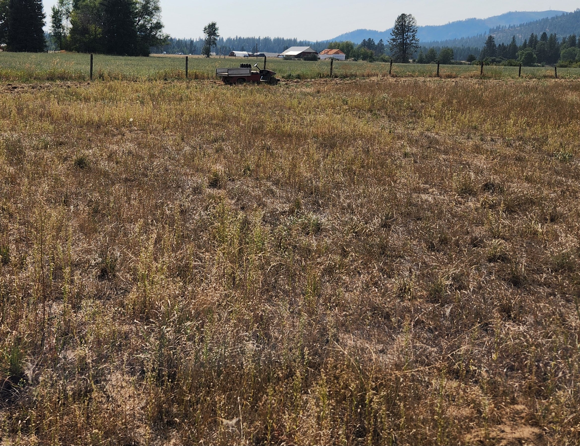

Right now the mower is clogging about every 100-150’. I've been unclogging it by hand and continuing. Would I be correct in believing that is just from what I'm cutting being completely dead and dry? Also maybe from the short stuff being too thin and "seedy"?

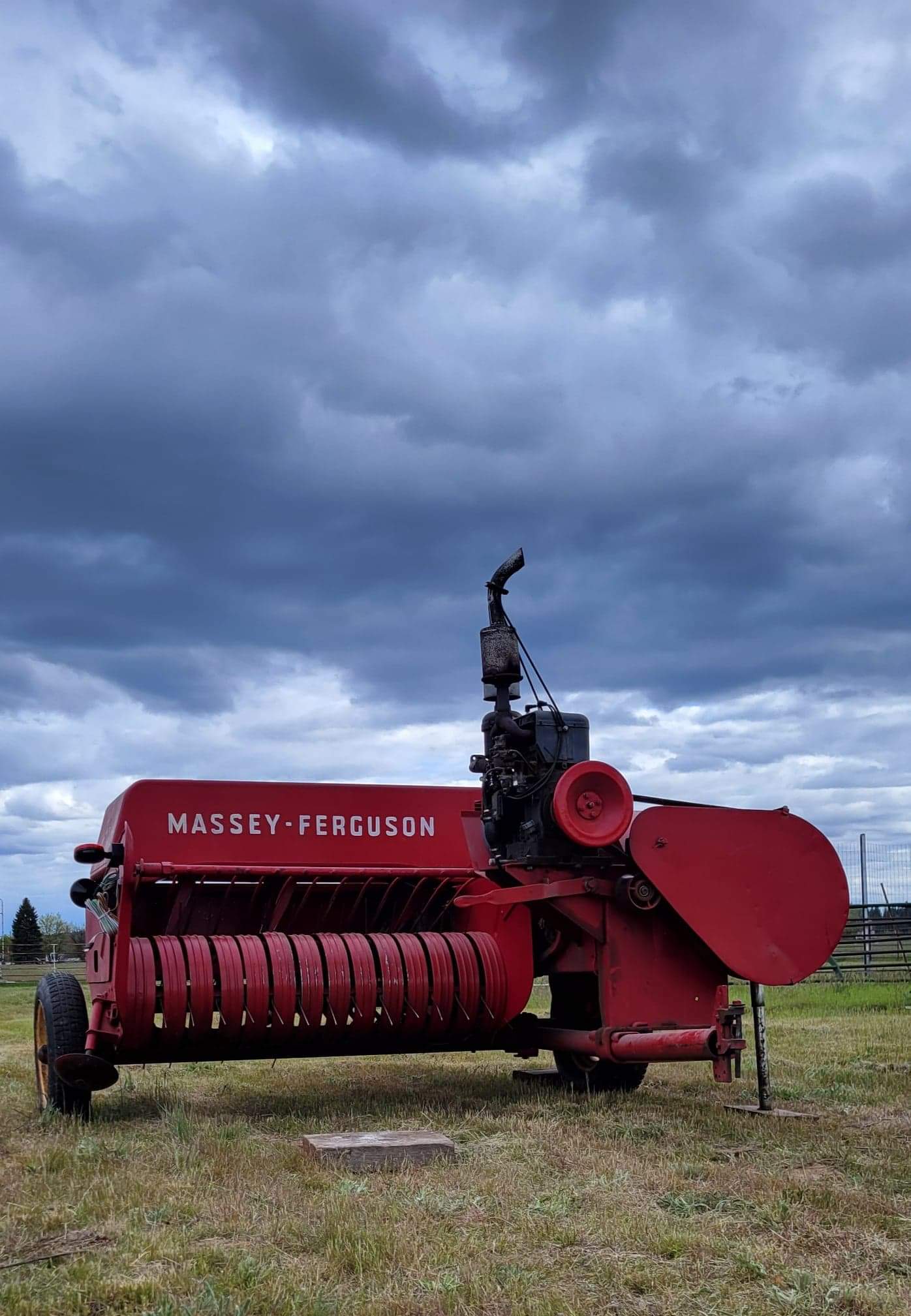

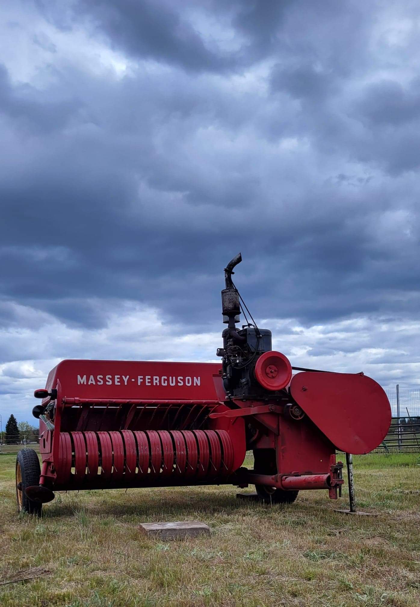

Now to get somewhat off topic and I can post on a separate thread if needed. My plan is to swath my field (in the picture), windrow it tighter with my rake, and test run my baler (Massey-Ferguson model 10, pictured), disc the field, and seed (a mix of orchard grass, timothy, and brome) this fall, and spread in the spring when everyone else does. Currently my ground is quite hard and I would think it needs to be loosened up. Is it a horrible idea to try and bale it. Would I run into closing issues? It's powdery dirt made up of mostly sand with a little clay content. I'm in the inland Northwest (eastern Washington state). Any input would be appreciated.

Thank you. I will get the manuals I posted a screenshot of in my reply to jon f mn. I very much appreciate the information.
What manual is that? I'd love to see the rest of that diagram. Or what parts book?

The parts book is available online at AGCOparts.com. Here is a link to the 1010 CP PT (1010-350 and on) parts book on that site.

If you go to AGCOpubs.com, you can see what AGCO says is available for manuals for it. I snapped a couple pictures of what came up for manuals when I did the search shown in the first picture. You can call the phone number at the upper right and talk to one of the staff to see if they can find any other manuals for it. They are a third party that handles the publications for AGCO (AGCO tell they the publications for the machines), so they can't provide technical support for machines.

Not sure what is plugging on you. I find that if you are cutting any hay and it hangs up on the guards and you don't see it soon enough it will feed a big wad in and plug the rollers. I have lots of trouble in mole hills so I cut a bit higher. Trick to unplug. Use a reciprocating saw with a 10-12 inch blade. cut right up against the rollers on both sides and it works fast and easy. I use a cordless or take the generator to the field and use the electric.
