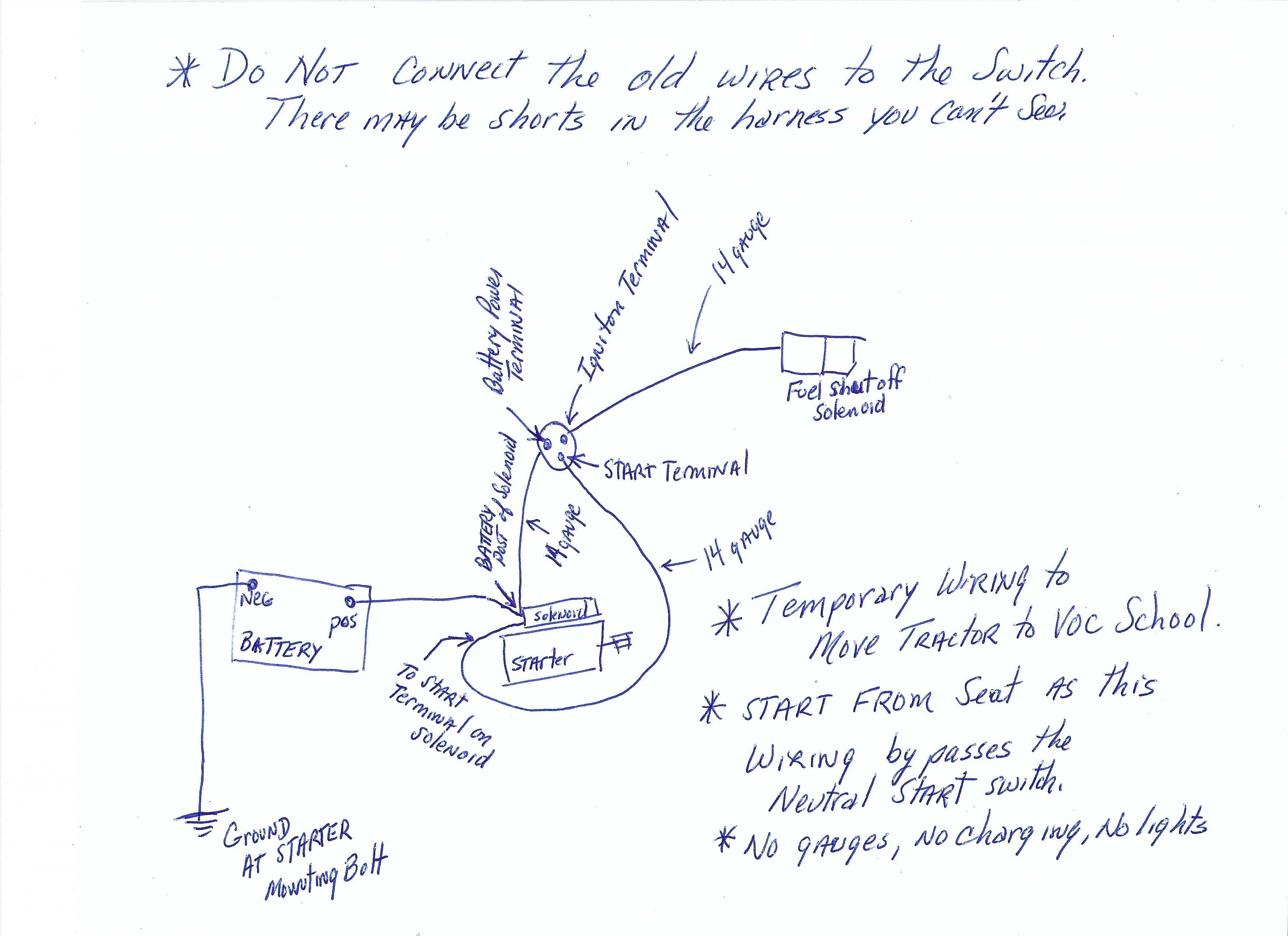

so if I ran my tractor the alternator wouldn't charge the battery the way i have it wiredLifting a battery cable off was done with generators, they were even run, with their regulator, with no battery in a vehicle by some. An alternator is not like a generator. Lifting a cable off the battery with an alternator can cause a voltage spike and lead to other problems in some vehicles.

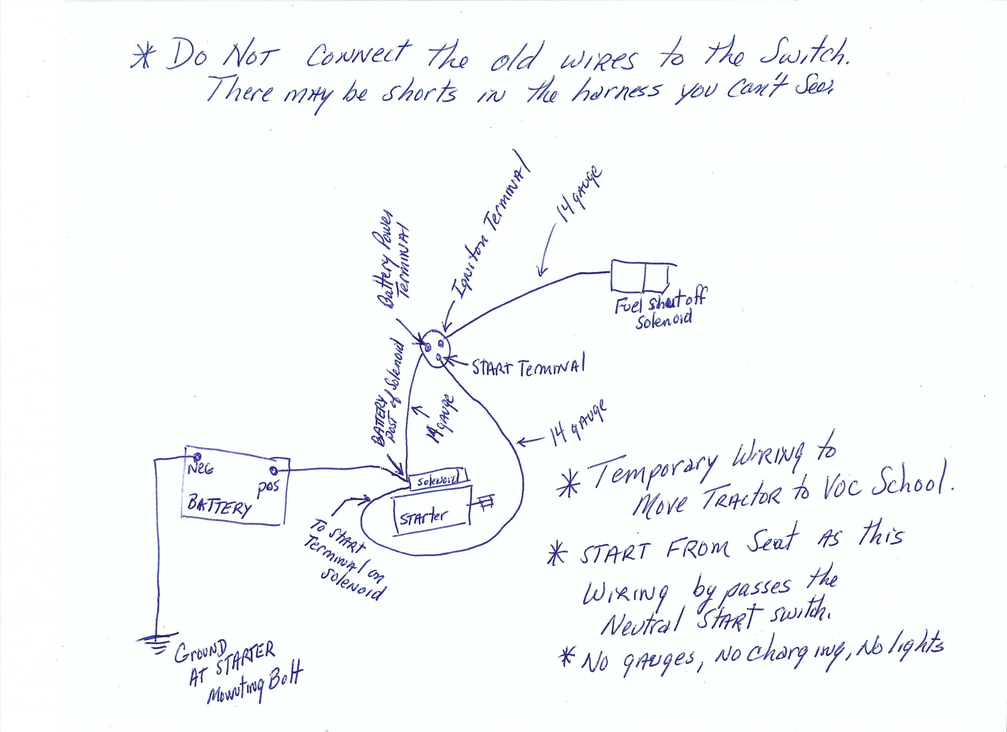

IF you wired it using just the 3 wires in the diagram, I posted for you, it will only operate the starter and fuel solenoid. That was what you wanted so you could load it and take it to the vocational school to be re-wired, by them. All other wires were supposed to be unhooked from the switch.so if I ran my tractor the alternator wouldn't charge the battery the way i have it wired
sorry I was so glad to get it going I missed that.so I'll have to have all new wiring for it to charge the batteryIF you wired it using just the 3 wires in the diagram, I posted for you, it will only operate the starter and fuel solenoid. That was what you wanted so you could load it and take it to the vocational school to be re-wired, by them. All other wires were supposed to be unhooked from the switch.
Read the notes I put on that drawing for you. NO Safety switches, No gauges, No charging, No lights.
Here it is again.
If your wired up correctly, as the tractor's original wiring harness was when it left the factory, the alternator- if not damaged along with possible damage to the battery by arc's and sparks should be just fine. When operated at operational rpm-the motor reved up while mowing will spin the alternator to its highest output. Disconnecting the battery may be shutting the fuel off, a diesel doesn't need electrical to "fire" sparkplugs. I think what happened is power was cut to the fuel solenoid and it closed. Remember, I'm of the opinion that it's likely the battery was damaged by the bad connections at it's posts, I've lost Lord only knows how many batteries by not cleaning those post connections.so if I ran my tractor the alternator wouldn't charge the battery the way i have it wired
You have a severely compromised wiring harness. To think you can continue using it is just asking for more problems. Wiring harnesses shorting out have caused tractors to be burnt to destruction. some have even led to building fires. Given those facts I am not going to tell you anything but have it rewired.sorry I was so glad to get it going I missed that.so I'll have to have all new wiring for it to charge the battery
His tractor burnt a section of the wiring harness up and melted wires. It wasn't just a bad battery post.If your wired up correctly, as the tractor's original wiring harness was when it left the factory, the alternator- if not damaged along with possible damage to the battery by arc's and sparks should be just fine. When operated at operational rpm-the motor reved up while mowing will spin the alternator to its highest output. Disconnecting the battery may be shutting the fuel off, a diesel doesn't need electrical to "fire" sparkplugs. I think what happened is power was cut to the fuel solenoid and it closed. Remember, I'm of the opinion that it's likely the battery was damaged by the bad connections at it's posts, I've lost Lord only knows how many batteries by not cleaning those post connections.
For safety a total rewire would be best. Mainly to make sure it's wired back to factory specs, and all wiring is sound/good to prevent a fire and guarantee proper operation-starting. If you identify wires that are damaged and replace them with new wire, and return them to the correct connection location then that would win also. As long the electrical repairs are sound and provide for the proper functioning of the system without "shorting" out.sorry I was so glad to get it going I missed that.so I'll have to have all new wiring for it to charge the battery

Like these guys have said, your tractor is at risk here. Keep in mind a tractors electrical system needs maintance just like the engine needs maintenance. If corroded connections or cables are not replaced wiring can heat up melting the covering, fuses don't always save the day. Your tractor has been lucky so far. These guys really helped out a lot, and don't want to hear of you still losing your tractor to fire.sorry I was so glad to get it going I missed that.so I'll have to have all new wiring for it to charge the battery
well hopefully I can get it to the trade as soon I hear from them; I'm also expecting a wiring diagram in the mail and am on a waiting list for a wiring harnessLike these guys have said, your tractor is at risk here. Keep in mind a tractors electrical system needs maintance just like the engine needs maintenance. If corroded connections or cables are not replaced wiring can heat up melting the covering, fuses don't always save the day. Your tractor has been lucky so far. These guys really helped out a lot, and don't want to hear of you still losing your tractor to fire.
Good, do not let others get you off the path of a proper repair.well hopefully I can get it to the trade as soon I hear from them; I'm also expecting a wiring diagram in the mail and am on a waiting list for a wiring harness
