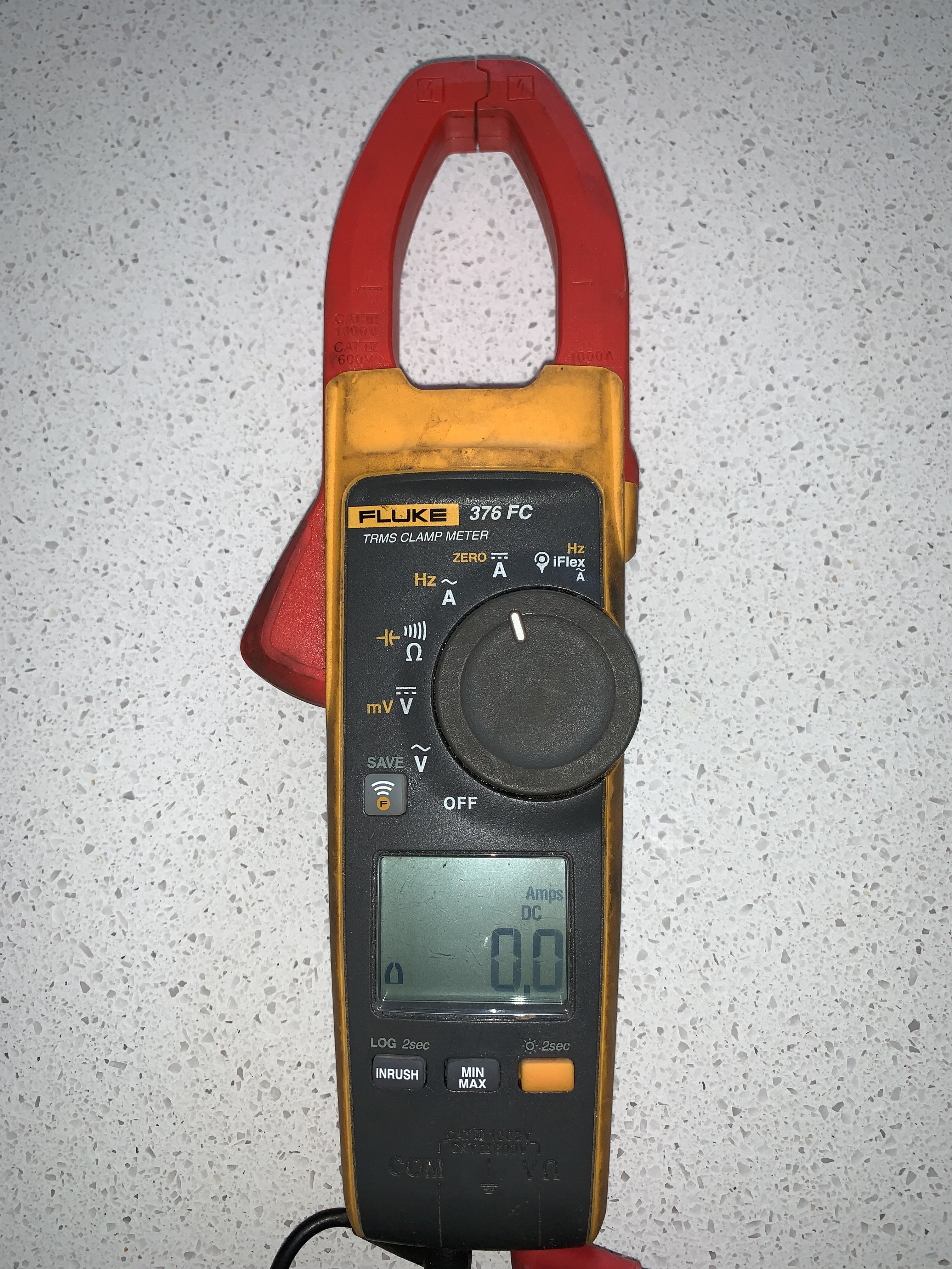

please put that in simple terms for the ignorant and unlearned like me. what is a flukes clip and ammeter
Clamp the jaws around the cable leading from the alternator to the battery or ammeter/battery . Reads DC amps .
Switch the meter to DC volts and use the probes between chassis and the alternator output terminal .

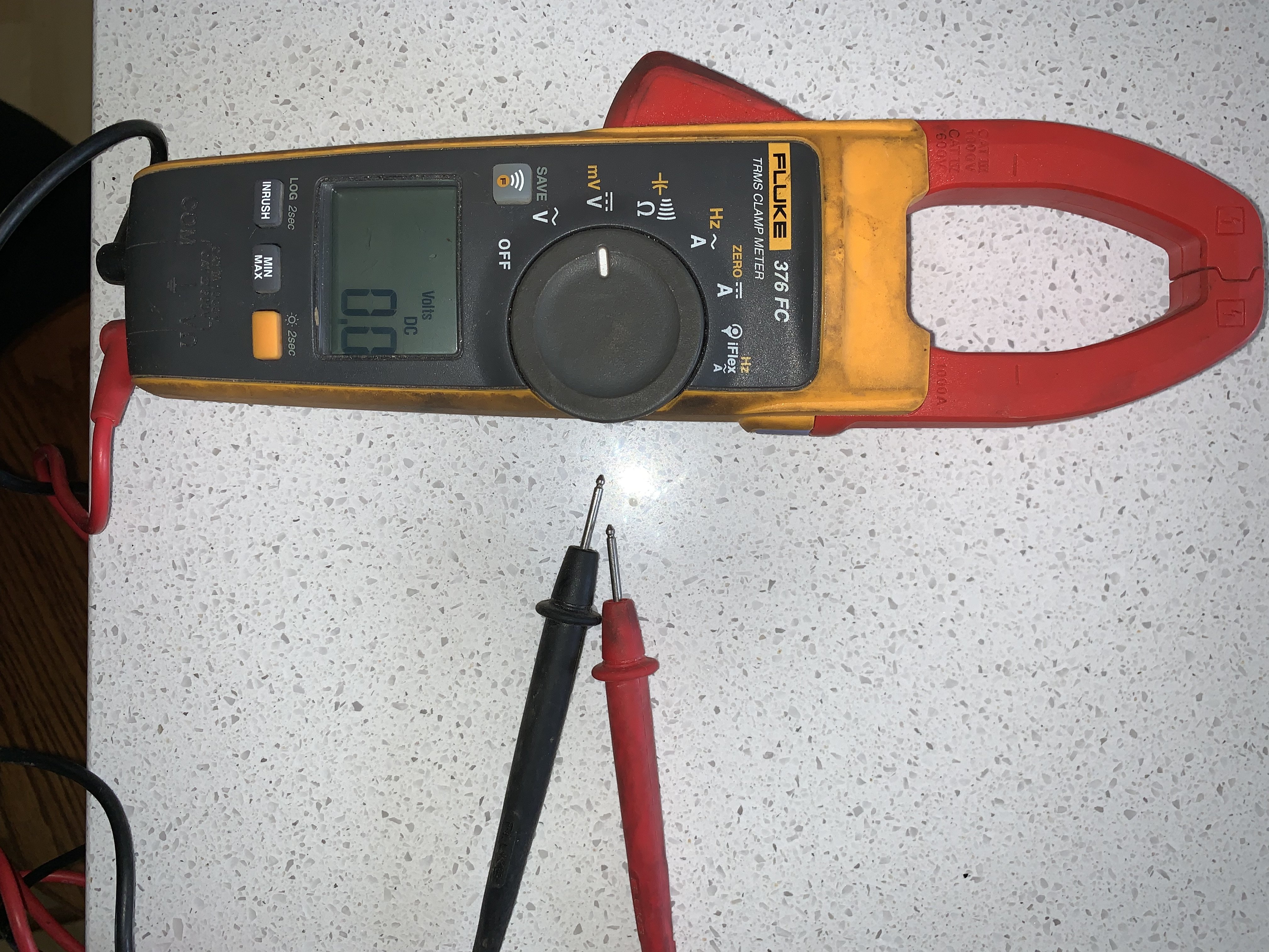

what do you mean about jaws my multimeter doest have clips. this is a pic of my alternator.the multimeter that I have looks like this in pic

Your ammeter is AC amps only . Meter needs to have the DC ammeter option.

If you double promise me you are not going to attempt to make any changes to the current status of the tractor. With your meter on the 20 volt DC scale as you have it shown in your picture connect it to the battery terminals, red on positive (+) and black on negative (-). With engine off it should read slightly above 12.5 volts. When you start it the meter should then show between 13 and 14 volts. If the unit being tested has lights, a heater blower and A/C all those should be able to be turned on and the 13 - 14 volts maintained. That 13 to 14 volt range is not necessarily set in stone but it is in the “playable” range.

used red MN is right you can use the voltmeter you have to tell if an alternator is charging, by checking the voltage at the battery terminals when the engine is stopped and again when it is running 1200 to 1500 rpms. Many vehicles use voltmeters now instead of ammeters. You do not need an ammeter to see if it is charging, just use your voltmeter, when the time comes.
