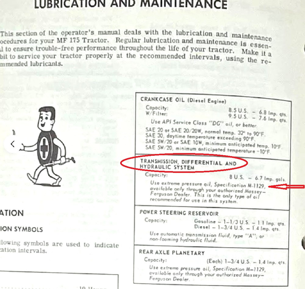

I don't know where you got that info. 303 was a John Deere product, never a direct recommendation of MF. It is long obsolete, Hy Gard is the replacement. Any 303 you find being sold currently should be avoided as it is often "trash" oil. Hy Gard falls in the same group as the ones I gave you info on in my earlier post. Look for a Universal Transmission Hydraulic Fluid listing the specs on the container I gave you before, or the John Deere J20C spec. The info in my earlier post is based on the 135 Operator's manual and several other MF manuals for similar tractors I have, which fall in line with your 175.
You should get an Operator's Manual for your 175.
For a Massey Ferguson 175. What kinda hydraulic fluid would you recommend
A clip from a MF 175 Operator's Manual. See my posts # 4 and # 7.
