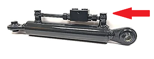

I have a remote hydraulic set up for my 851 & I am thinking a hydraulic toplink would be a good idea. Do you guys have any suggestions on specific toplink brands/resources? I know there is a basic range for the hydraulic toplink - just like a manual one, but I adjust my manual toplink to different lengths depending on the implement (so, I'm kinda confused on measuring the toplink, since it's adjustable & not specific to my tractor). Any help is greatly appreciated!

You are looking for cylinder range. If you know the lengths you adjust your manual top link to, you need a top link with a retracted length shorter than your shortest adjustment and extended length longer than your longest adjustment length. You just measure center of your manual top link pin hole to the center of the other pin hole at your shortest and longest adjustments and get a cylinder that covers that range, pin hole to pin hole, retracted and extended. You use the remote to adjust the cylinder length within that cylinder range.

Measure the minimum and maximum length of your manual toplink and buy a hydraulic link that matches
I suggest you get one with a check valve to prevent cylinder drift when in use.

Top links are nearly always sized not by the length but by category. 0; 1; 2; 3, etc. they are all adjusted for different implements. Your 851 takes a cat 1. Your hyd. unit needs to be sized the same way.
