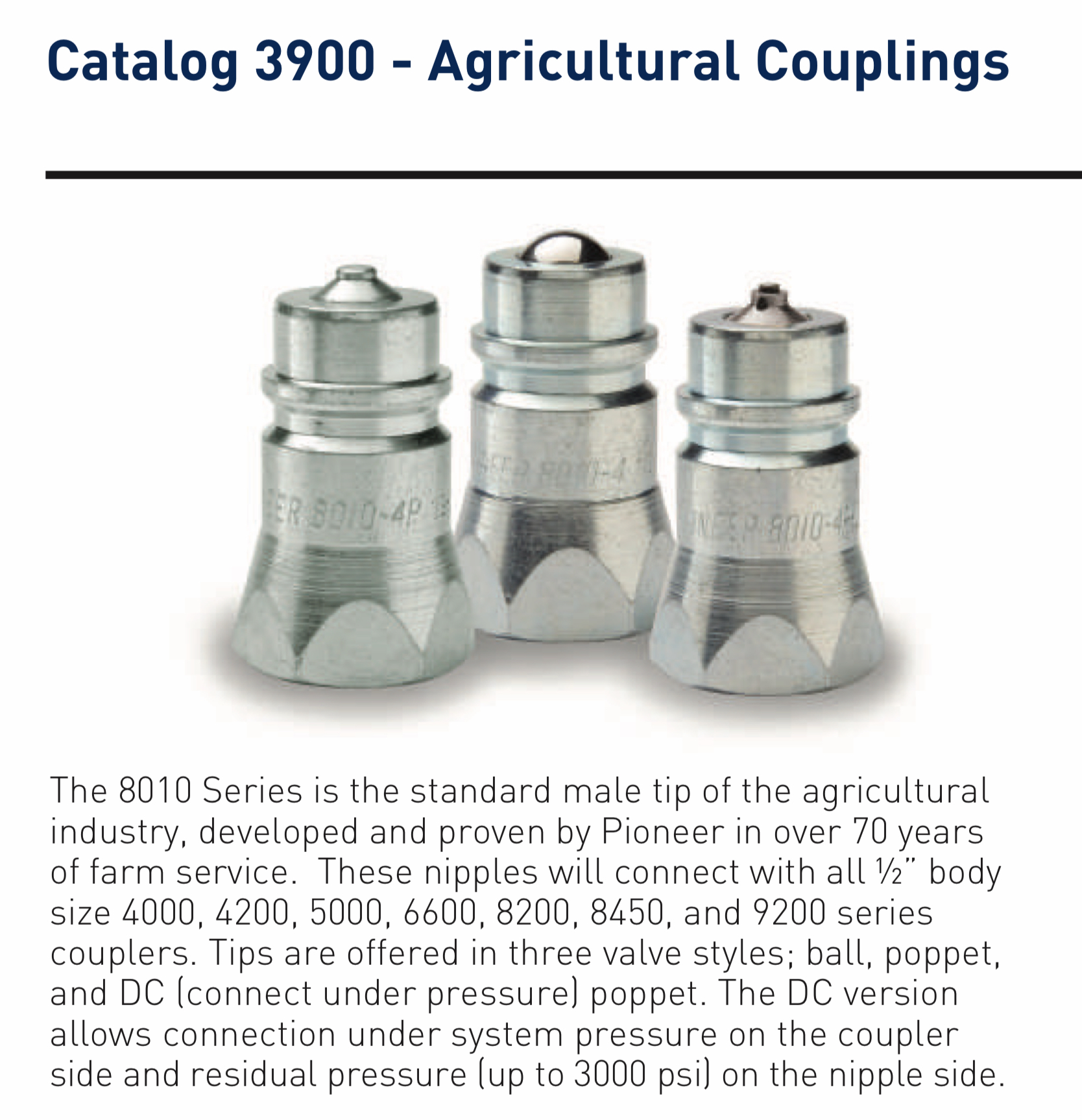

There is a poppet male connector with a tiny movable pin that is designed for releasing the built up pressure. They are a little hard to find, but are perfect for a hyd top link that might often build up pressure sitting in the Minnesota changing climate where we go from near 100 degrees to near 20 below most years. Just sitting out in the sun one afternoon can cause a normal male connector to lock up….
Anyhow, he is talking about that ‘fancy’ connector, not the simple ones you mention.
The little pin one works well, I got them on my top link and kind of forget that I don’t have problems now.

There are plenty of couplers that you can connect/disconnect under full pressure. I use these. Pretty standard on modern machines.
This is the type I’m talking about. You mentioned the standard ball and the higher flow poppit.
The one with the little center pin allows simple easy connection even with pressure on the line.

Thanks. I was not familiar with those tips. Looks like the little valve can only relieve the implement side.
I am sure Parker also offers a coupler just like the Faster couplers which work with any vanilla tip. Here is a little Fergie with factory outlets - connect/disconnect under pressure and dust covers that collect and recover any spillage.
