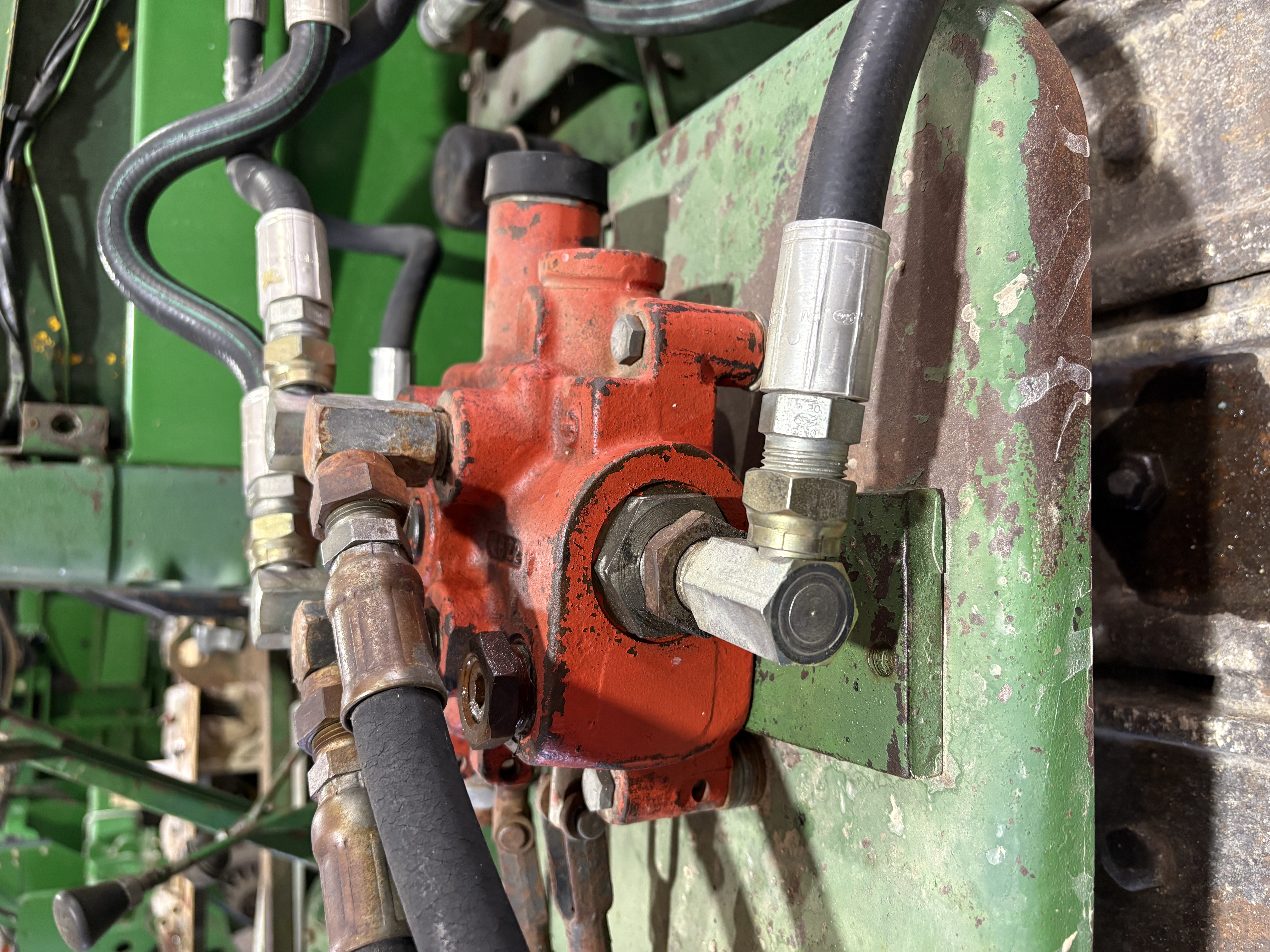

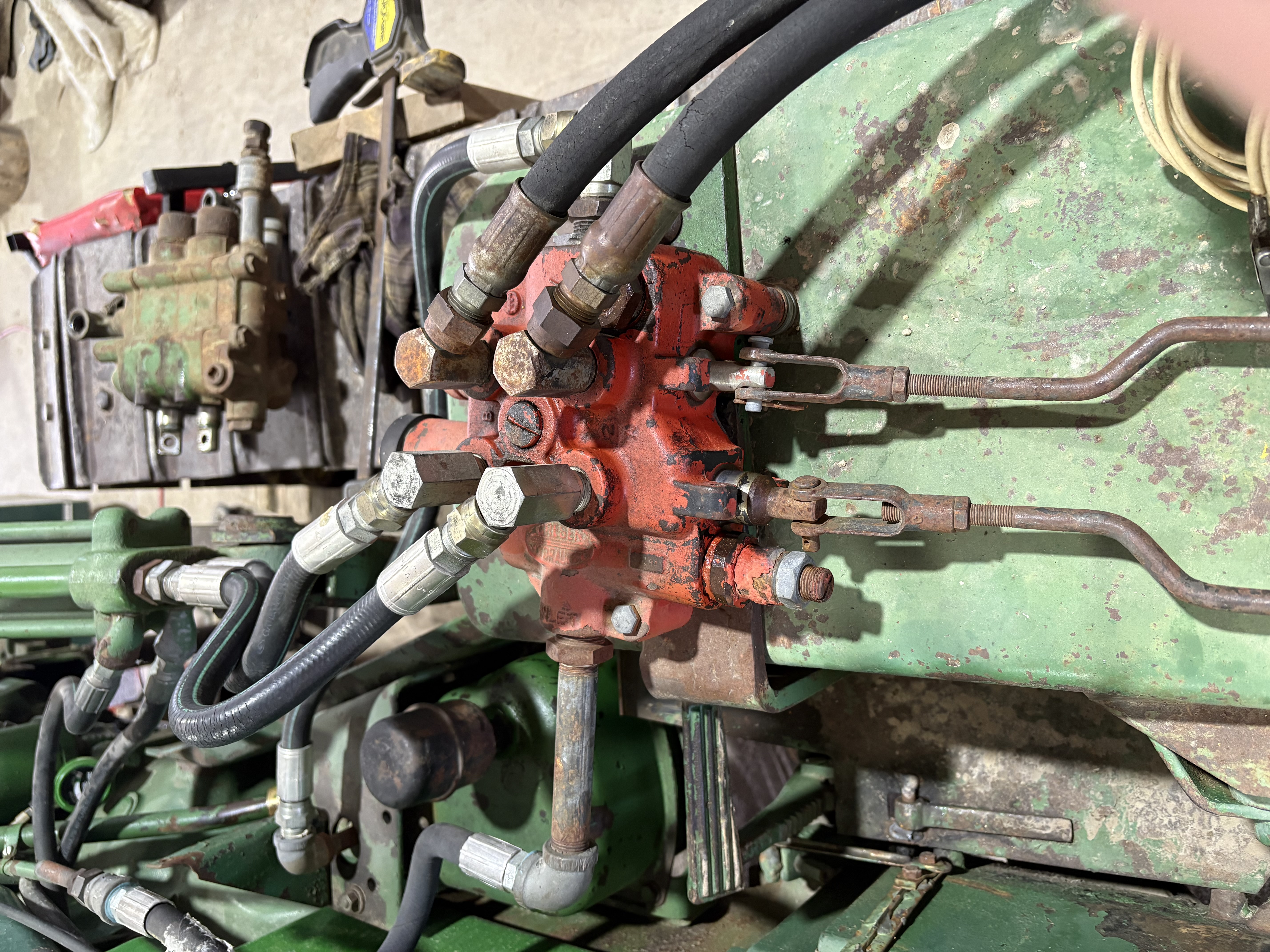

Adding a 3 point to my 420c, trying to figure out how to plumb the valve that came with the 3 point in with the valve that runs the blade and hydraulic outlet. I tried going through the 3 point valve then through the gresen valve then to the reservoir but that didn't work right, it was putting to much pressure in the 3 point valve. Next option I can see is to pull pressure for the gresen valve out of the right plug on 3 point valve and return it through the left plug but not sure if that will work either or will the pressure just go through which ever valve I'm not using since they're both open center?
