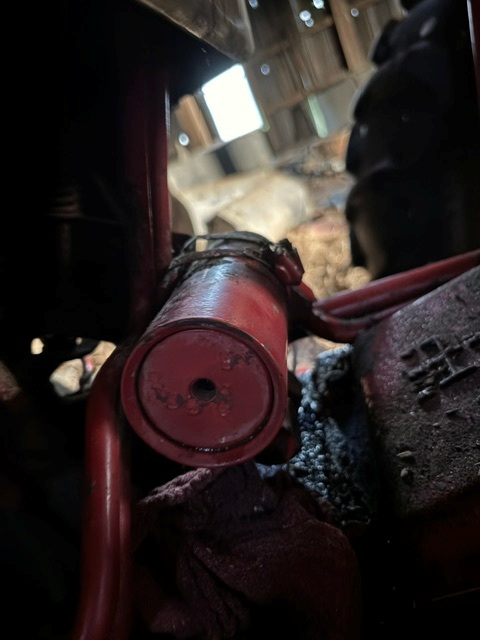

FINALLY got around to putting things back together.
for the suction filter I ended up the new one that has the too small, too long, Dog-legged tube and heating it up/cooking the epoxy out and reepoxying it into my old 1" straight short tube original suction filter line. seemed to work ok. used JB weld's tank epoxy.
seemed to go back together ok other than the new hose is a pain to slide back and forth on the tubes even lubed up. Almost ruined the hose trying to slide it with channel-locks. I suspect you're supposed to disconnect the line up front maybe?

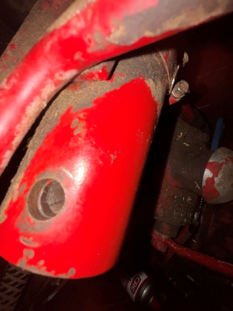

Also went to change the filter that is under the steering wheel for the 444's with hydraulic remotes (not sure why anyone would buy one without remotes).
the manuals really don't discuss this filter and it was hard to find the filter (WIX 51666). so there were no instructions on how to take it apart. basically it is a round housing with lines in/out and has a nearly press in plug with a spring to hold the filter in and a bolt that goes thru the housing & plug to keep it in place. the plug also has an o-ring on it (anyone know PN?) . because it is at a goofy angle and is hard to push in and get out, lining up the bolt hole is very difficult.
anyone have any suggestions on alignment? I thought about a round punch but I didn't have one with me and not sure if i have one that short. as the bottom side its limited by the transmission top. on the top side being on nearly a 45deg angle, the dash is in the way. another option i suppose would be to be to take the in and out lines off the housing and do it on the bench but seems like you shouldn't have to take it all the way off the tractor.

Is the filter barrel possibly warped & causing resistance when pulling the plate out?
