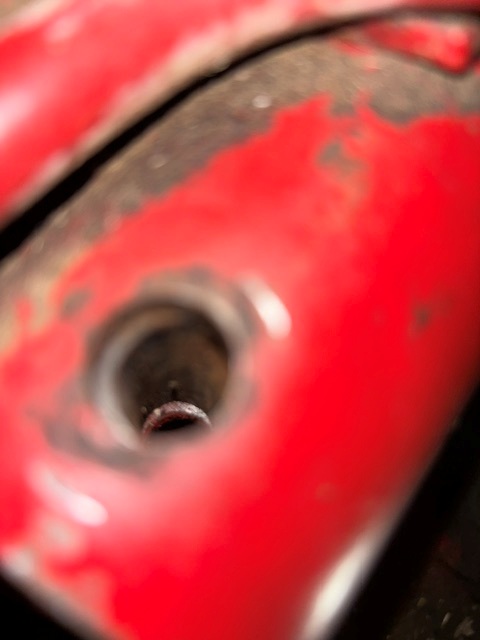

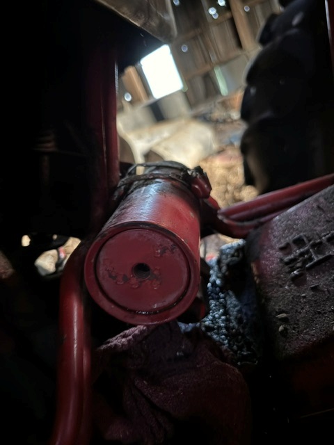

ended up getting a slide hammer (harborr frieght) to help get the "plate" out of the end of the hydraulic filter housing with an extra pair of hands and light holder I was able to finagle getting the bolt hole in the plate lined up. also scotch brighted up the "plate" as it had a bit of rust and some paint in it that I'm sure didn't help getting it in/out. had to wiggle and turn and push and pull the plate a bit to get the hole to line up. if not lined up just right the bolt will not go in. would have been nice if the bolt would have been vertical. as it is no room between filter and dash or transmission plate on the other side.
Hole missaligned
a punch would help (had one that helped but was too small diameter AND marking the plate and the housing before removal would be a good idea too.

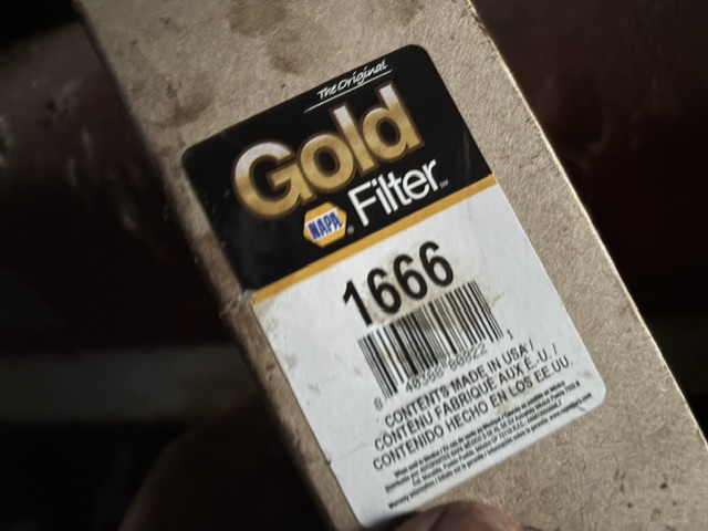

The I got is filter. others are available

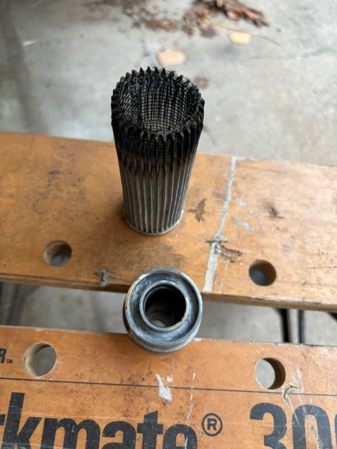

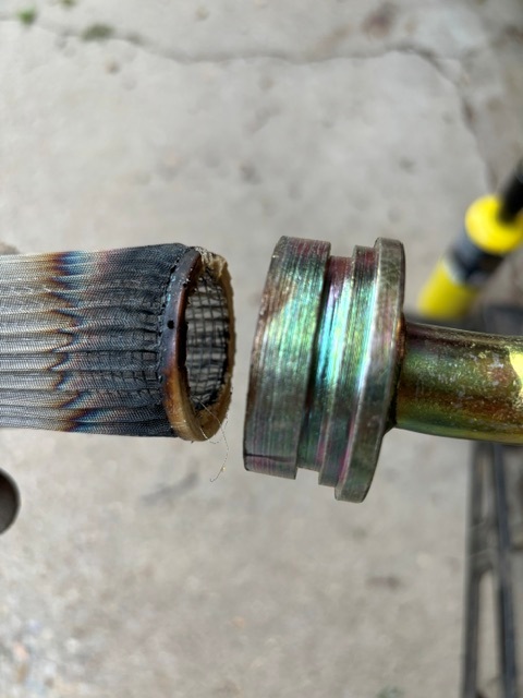

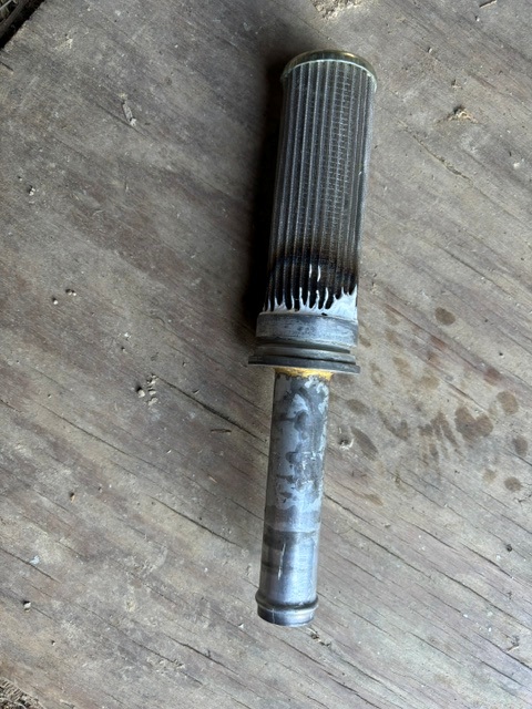

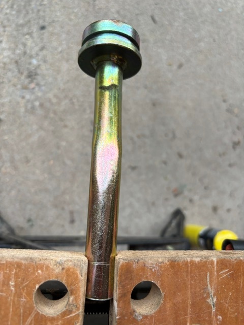

For the suction screen. As mentioned before I had no luck with getting a new one or even a used one. soaked the old screen in gas for about a month and i still could not get the crud out of it.

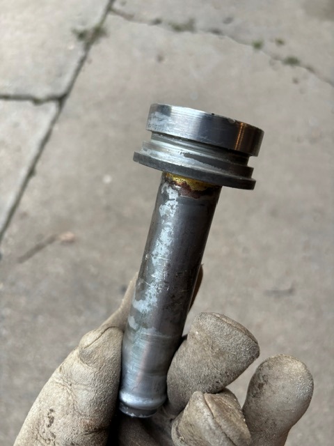

So I got one of the ones that is available new that is 3/4" tube versus 1" and is a long tube and has a dog leg in it. and decided there is No way to make that work without some major monkeying around. so i decided since the epoxy failed on the original and the screen came out of the tube/plate i could do the same thing and heat up the new screen (not too hot) and melt/burn the epoxy in that and remove it from the tube/plate that doesn't work and epoxy the new screen it into the original tube/plate. Used JBweld "tank epoxy" to do it. Debated about a few things and had a few suggestions for epoxy (see RedPower post) but those were either NLA or very difficult to get. the "tank epoxy" says its ok for continuous exposure to oil.
original tube/plate
new tube/plate
new screen removed from new tube/plate
New filter epoxied in old tube/plate

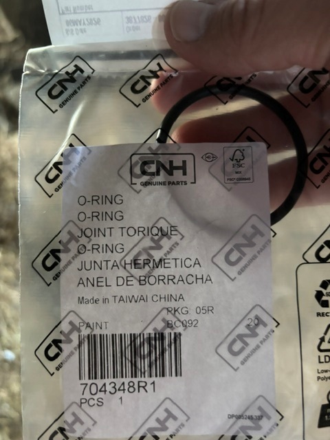

forgot, here is the O-ring for the Plate/tube to go into the hydraulic reservoir. was actually less $ as the CaseIH dealer than anywhere else.
