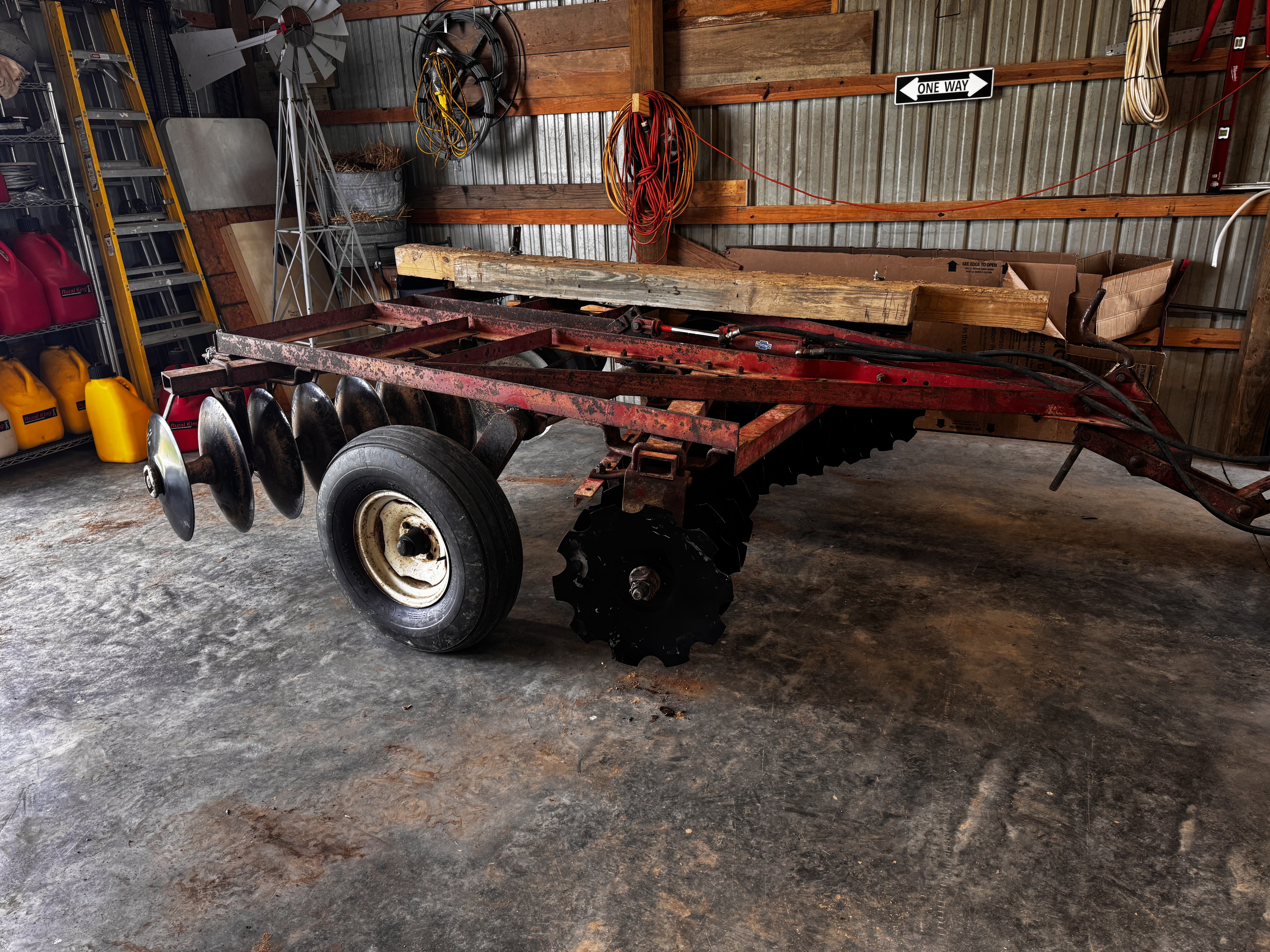

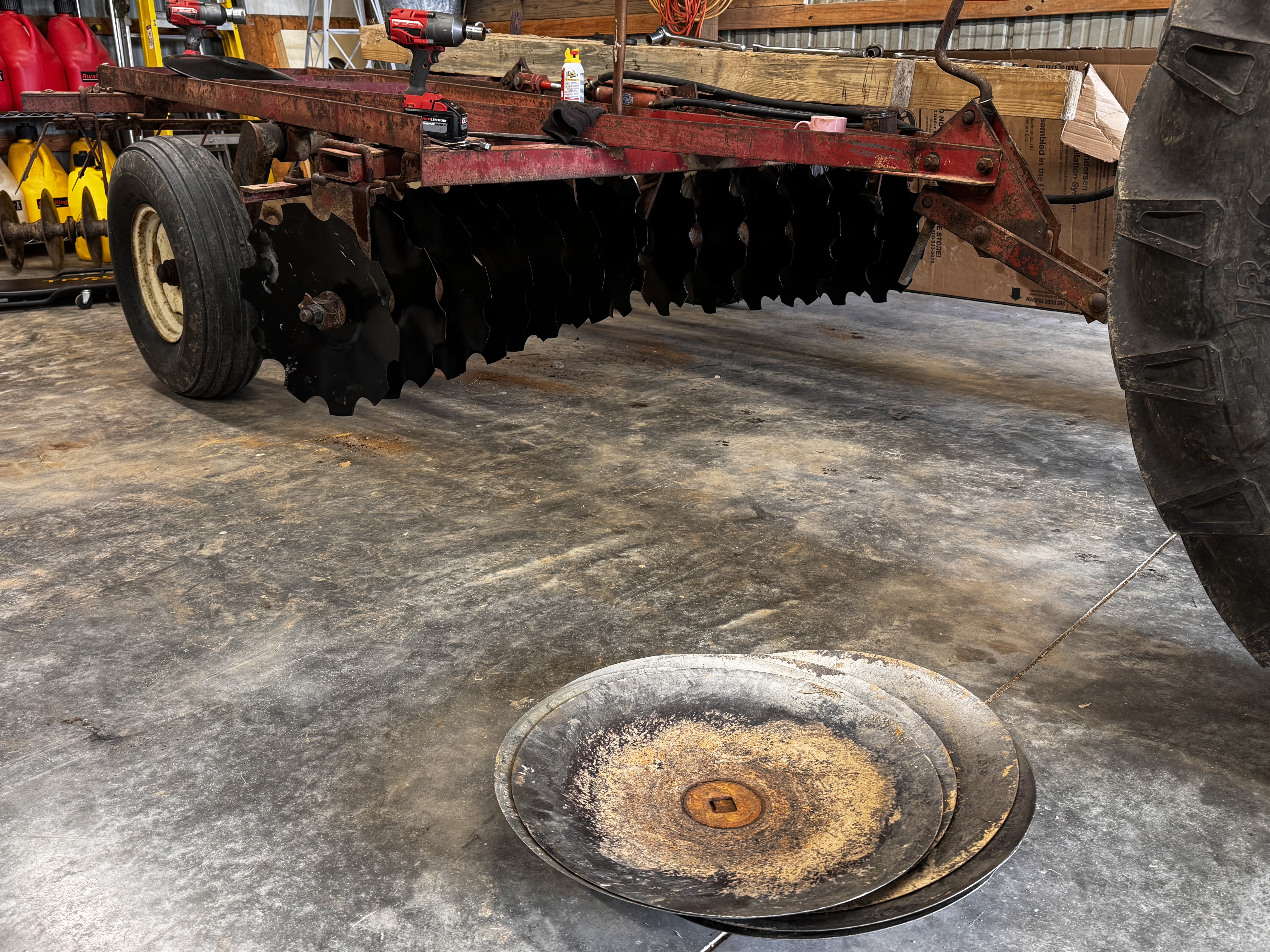

I need to replace the front blades on my 370 disk. They are concave blades but somewhere ready they should be flat centers. Also where is the best source to obtain the blades. Any comments appreciated
Price varies greatly by size... the most common size is 18 inch......but many had 20 inch and a few had 16 inch. These three are all priced at about $50 each from CIH. These are Earth Metal blades...the longest lasting, best wearing disc blade made. Not the soft blades that everyone else is peddling...
I think we put 22inch on our 470 20 years ago now, Still on there too. probably about 18-20 left. Depending on where you are We have a set for a 30 foot disc we'd sell reasonable and most would be in the 17-20 range with most in the 18.5-19.5 size, they would have the 1.5 inch round hole in them and be thick compared to most of what you will get for that disk. We put 24's on that disk.
Earth metal from IH are your best buy. We have had
3 sets on our disc & never had a problem. It came
with 18" blades & we have used 20" blades since
replacing the first set. The price has obviously gone
up since our last set which were $30 each.
Jim
Notched discs wear faser and I don't like the way they work usually don't cut any better and suck to catch things on walking around it greasing.
