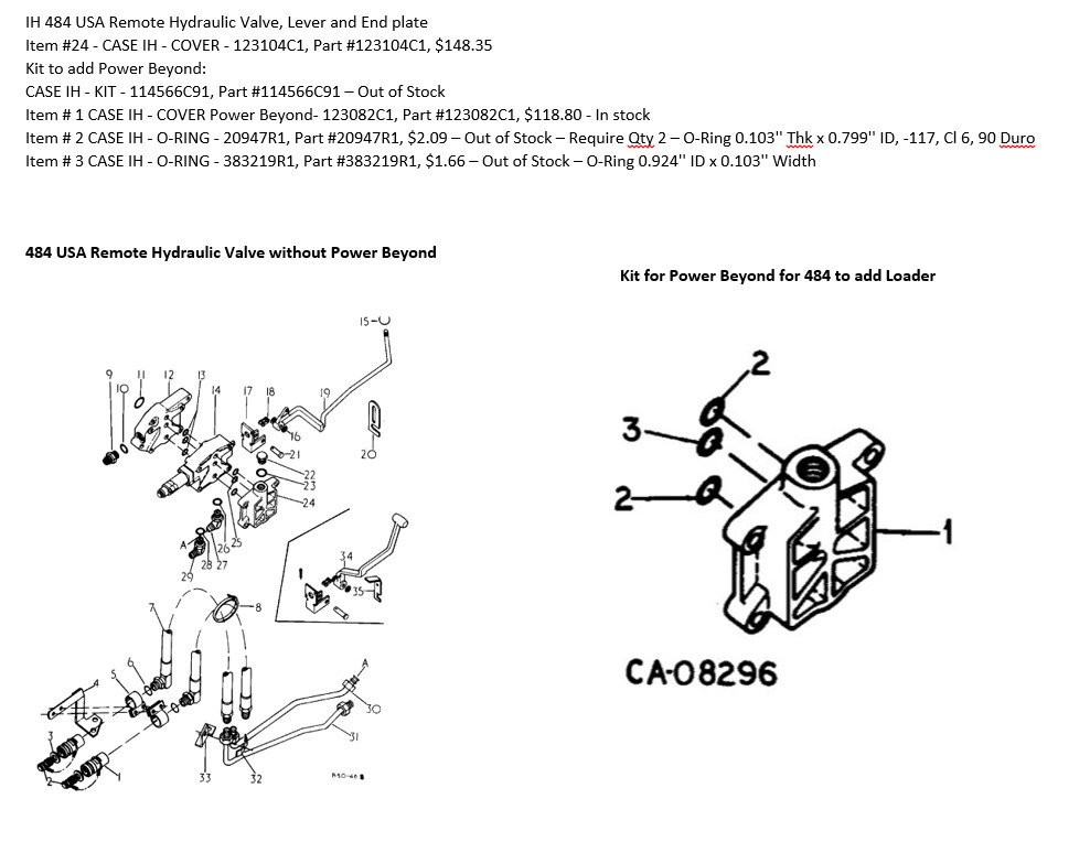

Anyhow I did manage to snap a couple of pictures of my SCV setup. Not exactly sure what I'm looking at yet but will do some more research in a bit.

So I cleaned the side of the valve body cover. It does have 4 bolts. I'm not exactly sure which one I have and if this is one you can plumb to loader into?
I've done some searching, but I'm still slightly confused. Can anyone point me in the right direction?

Did some reading. Appears the plate I have is not the power beyond plate. Sounds like there are work around without having it though.
I believe you have the IH USA remote valve not the IH UK valve that we see here in Canada with the 3 bolt end plate.
Please post a photo of the remote hydraulic lever with the hand grip, that will confirm which style your 484 has USA or UK.

Hi Jim, it is the rod with a round grip at the top for the remote lever, not the cast style.

Yes, that is the photo of the lever I was looking for. Your 484 is a late model crate unit that was assembled in Louisville, KY, USA that has different parts than the 84 Series tractors that we receive in Canada completely assembled at IH Doncaster, UK, plant.
Look at attached photo below, your 484 is a late model as it has handle Item #19 not #34.
I looked at CaseIH.com parts and I found the kit to put a Power Beyond end cover on your 484 was out of stock but the Cover itself was available just the three O-Rings were Out of Stock. The $118.80 price for the Power Beyond end cover is reasonable for todays parts prices. I assume it is in US$ as everytime I go to CaseIH.com parts it forgets I am in Canada. The O-Rings should be available at any good hydraulic shop or Google the part numbers and other vendors have them in stock.
Also see this post: https://www.yesterdaystractors.com/cgi-bin/viewit.cgi?bd=farmall&th=639078
Disclaimer, everytime I try helping someone with the adding a Power Beyond Cover to an IH Doncaster crate unit tractor assembled in Louisville there is always some difficulty as mentioned in the post above. IH Louisville appeared to change parts and there are no serial number ranges mentioned in the CaseIH.com online parts.
Hope this helps, but please verify which Power Beyond Cover your 484 requires the 123082C1 or 123082C2 version.

Hi Jim,
Thanks for assistance as usual. When I look on Messick's I see the power beyond plate being over $900...
It looks like you can use the 123082C1 or 123082C2 since it says it was superseded in the catalog at least according to Messick's.
From what I read in the post, the C2 has a return plumbed in, and the C1 you would have plumb another return, like lower on the axle as I have seen mentioned.

You are correct about the C1 version, that probably explains the price difference. On the IH Doncaster built ones that we receive in Canada that don't require a different Power Beyond Cover, we always do the return to under the right axle where the drain plug is.

I cannot find the C1 version in parts like you did, is that a Canadian site, or? I would gladly pay $118 for that cover.
