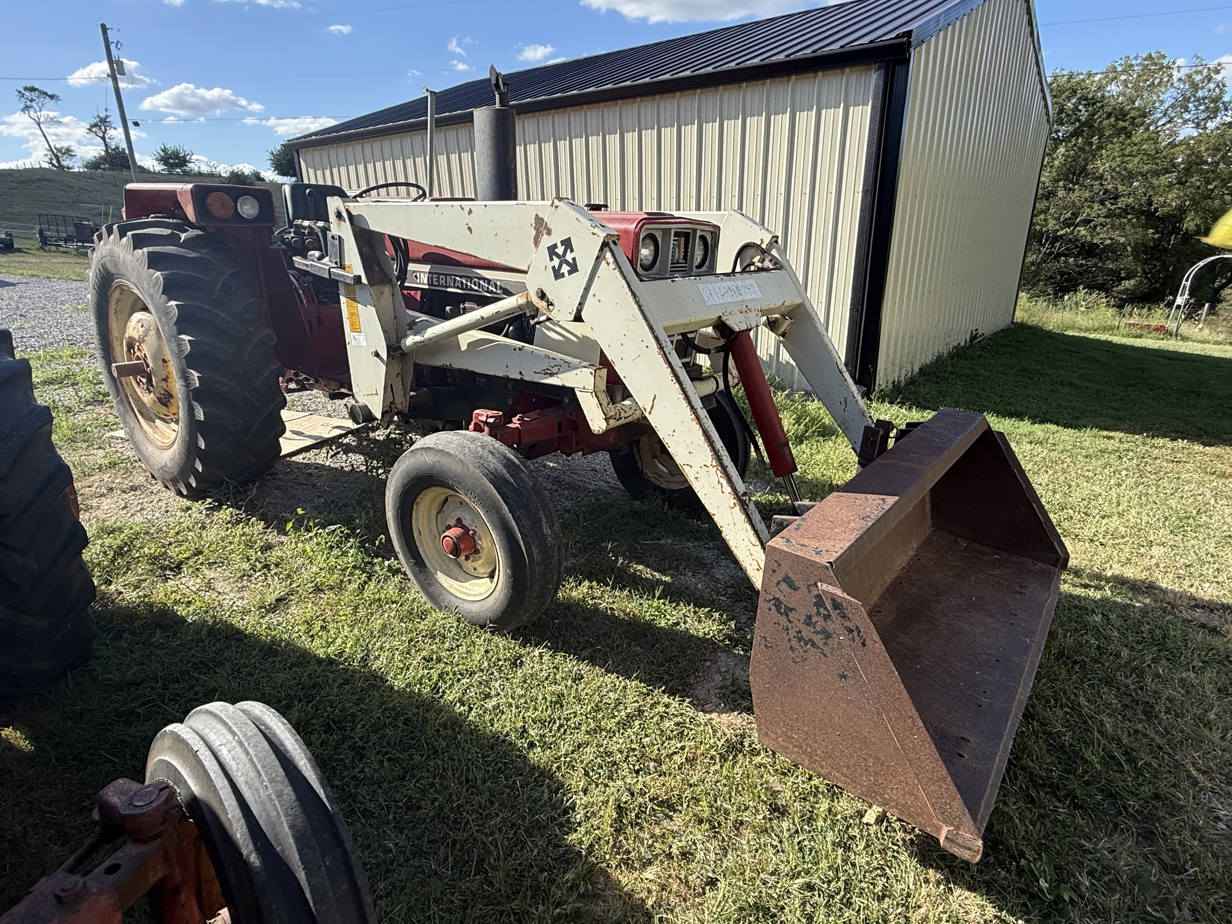

I installed my loader from my 484 to my 584, my 484 had a double spool remote which I plan on putting on the 584. What is the best way to plumb the remote to my 584? And in the mean time how do I use the rear remotes for the loader until I get the remotes installed?

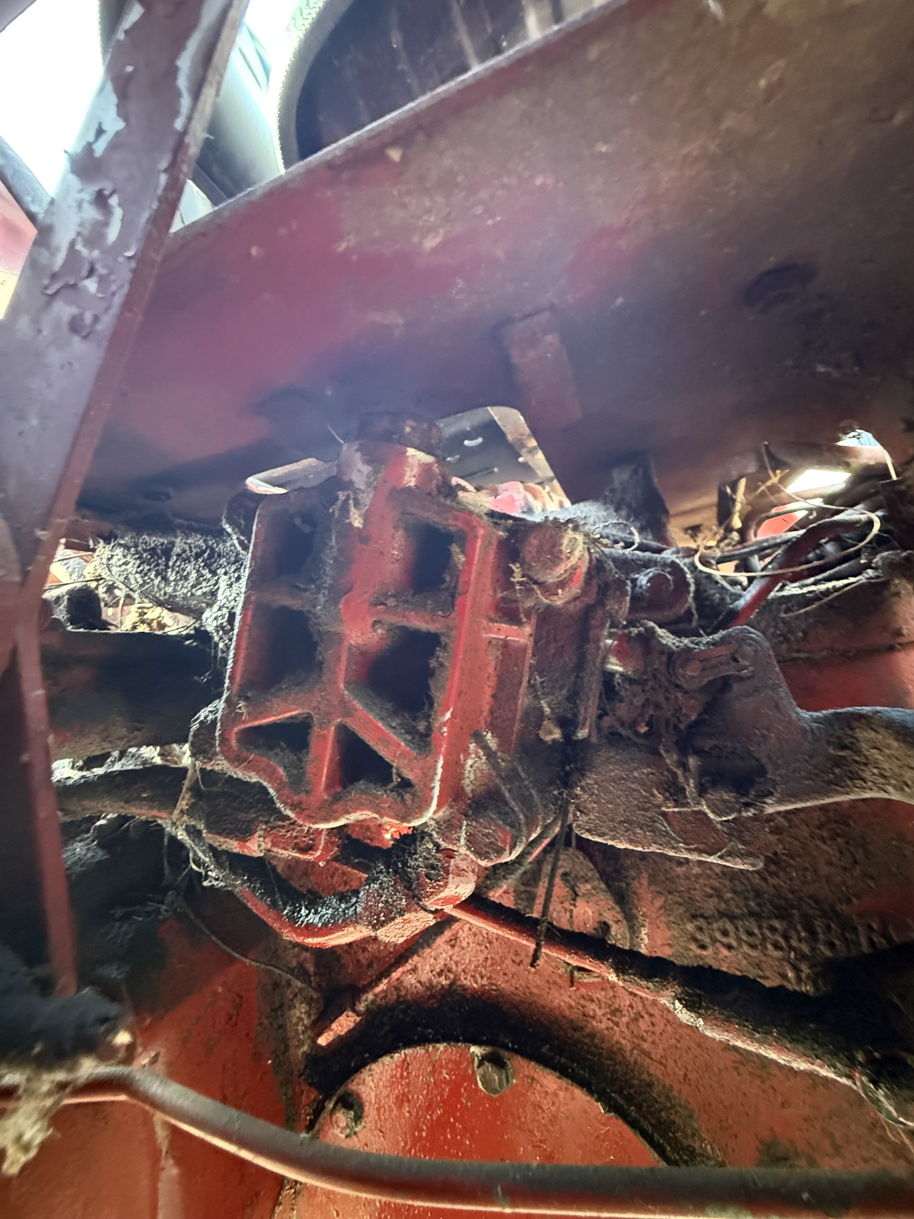

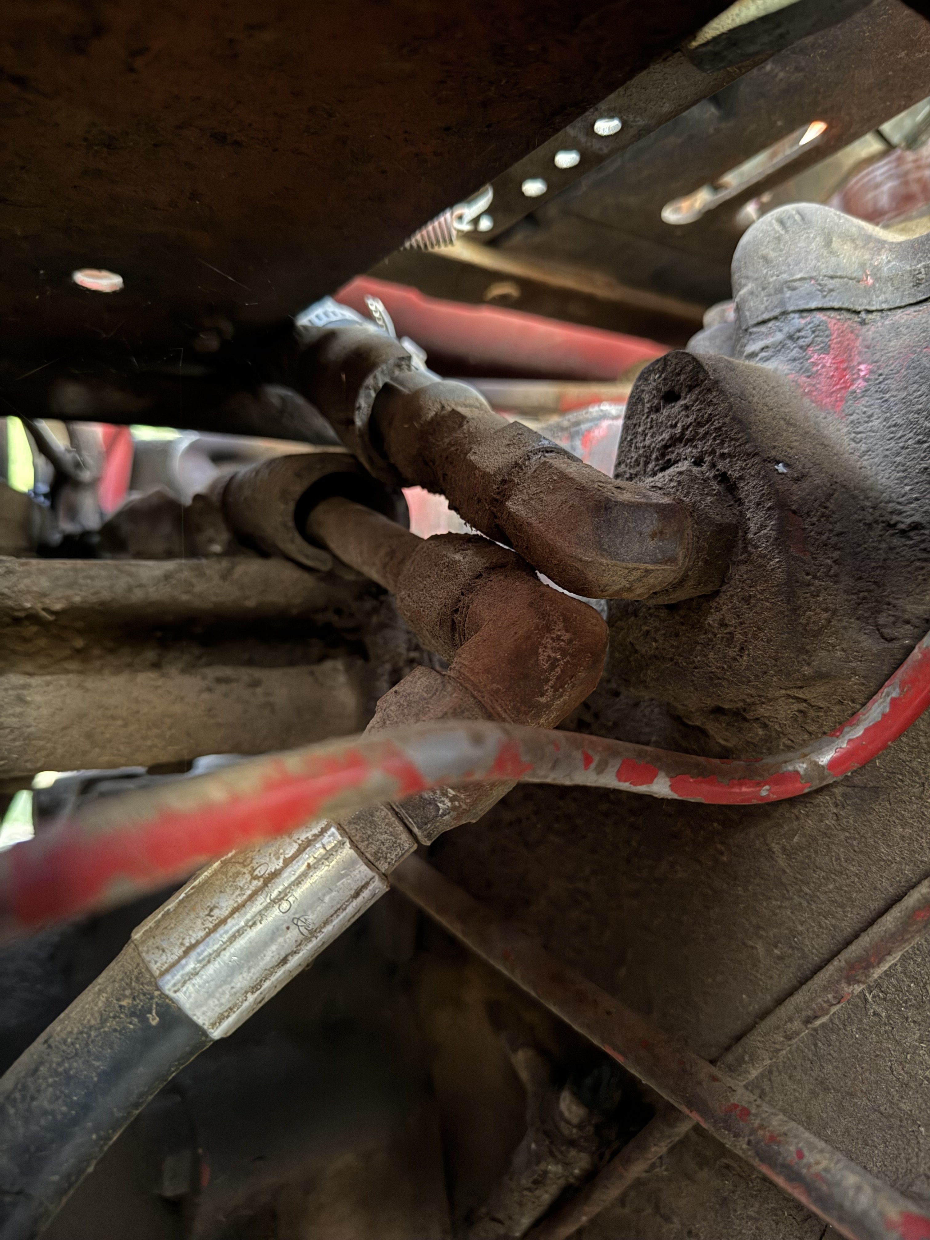

They are different. Here’s a picture of my 584 and 484. It looks like the 484 doesn’t have a remote under neath like the 584 does.

You're right, no remote... Now I can't say if what we're looking at on the 484 is the base for the remote stack, or what's going on here. Someone more familiar with the platform will have to chime in here.
To @caterpillar guy 's point, yes there are two different valves. One was for the North American spec tractors, one for the European tractors. One has three bolts, one has four. Which is which... Can't say off the top of my head. I believe the North American version is far more common in North America, and I was betting on that.
Well one version is the same as the row crop tractors like the other bigger tractors have on 06,56,66,series models. Then the other is a completely different valve. I don't know what the difference in them is .I just know you can't stack them.You need the same valves or both to be the same. Like Barnyard said no valve which I would wonder if you could even mount a valve there like the others have there. The Ones I'm familiar with have 3 bolts.
I went and looked it up. The 4-bolt is the North American spec, and the 3-bolt is the European spec. The 584 is a North American tractor. The 484 is... who knows what...

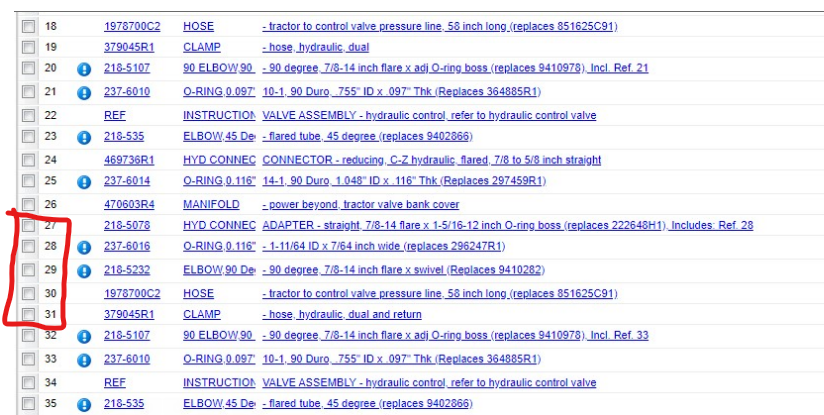

From the parts diagram there is a "base" for the hydraulic valves that bolts on to the tractor somehow. Of course the diagrams don't show how. I'd imagine this base connects where the hoses do in the picture of the 484 above.
From your photos, your 584 has the IH USA, 4 bolt hydraulic valve and requires a power beyond end plate to connect an external set of loader hydraulic control valves. I suggest you look at the following link.
Link: https://www.ihpartsandequipment.com...lics/ih-574-tractor-power-beyond-housing.html

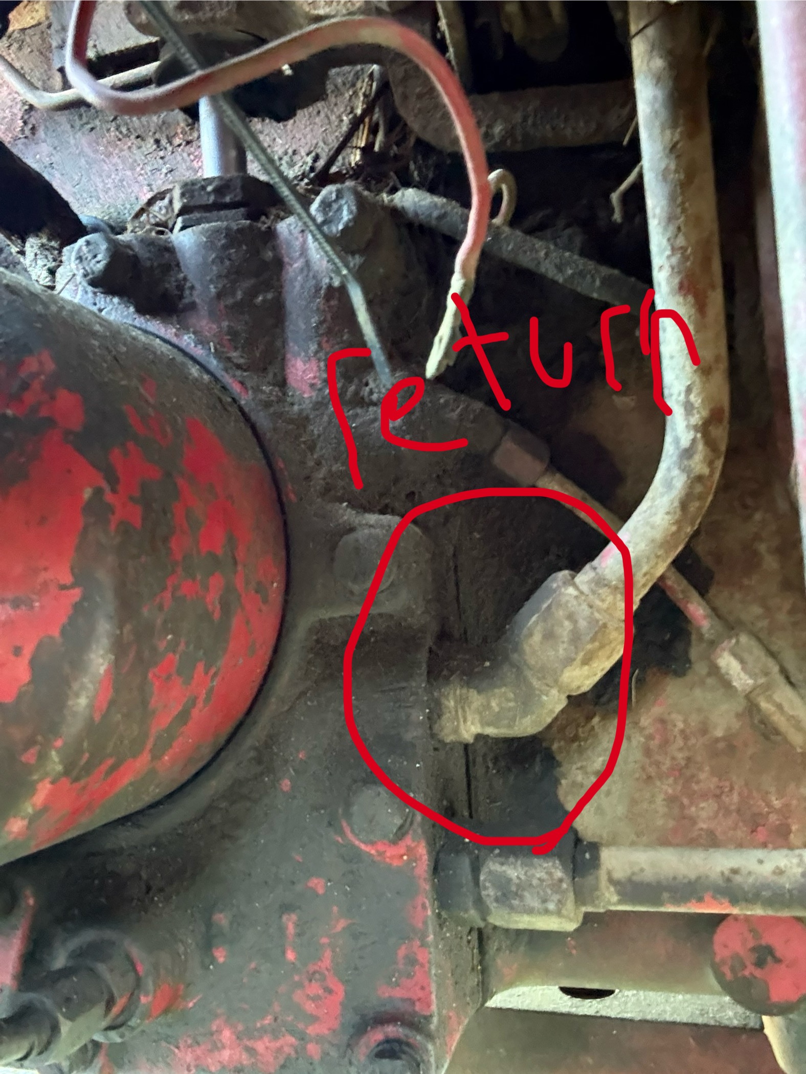

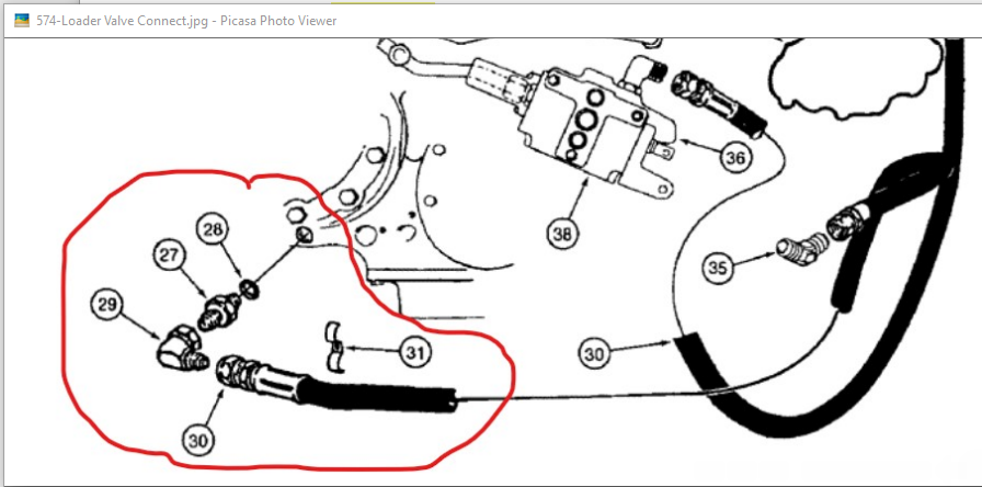

For the return hydraulic line that goes into the hydraulic drain plug under the right rear axle, see photo below with parts circled in RED
Parts list from several years ago

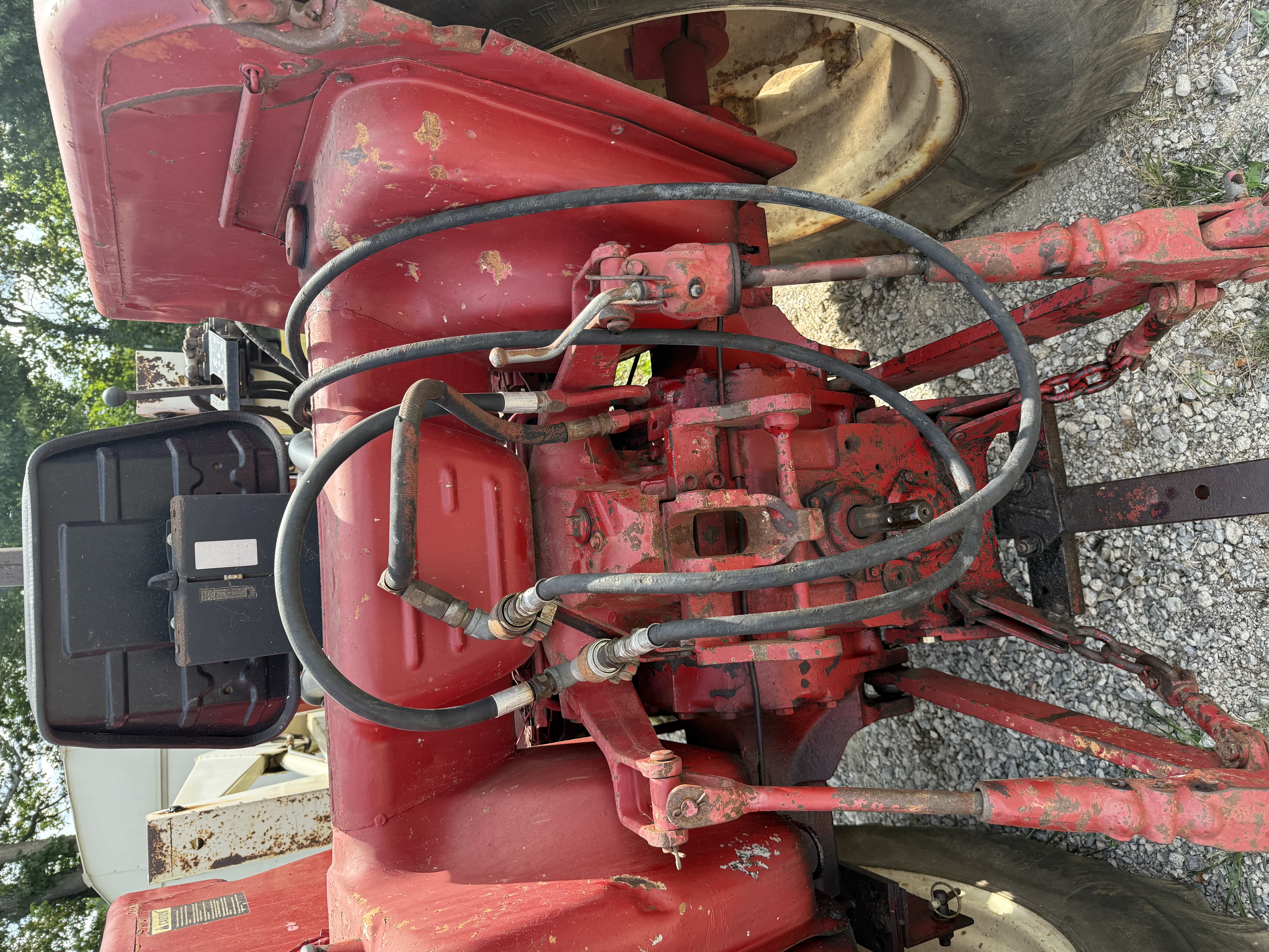

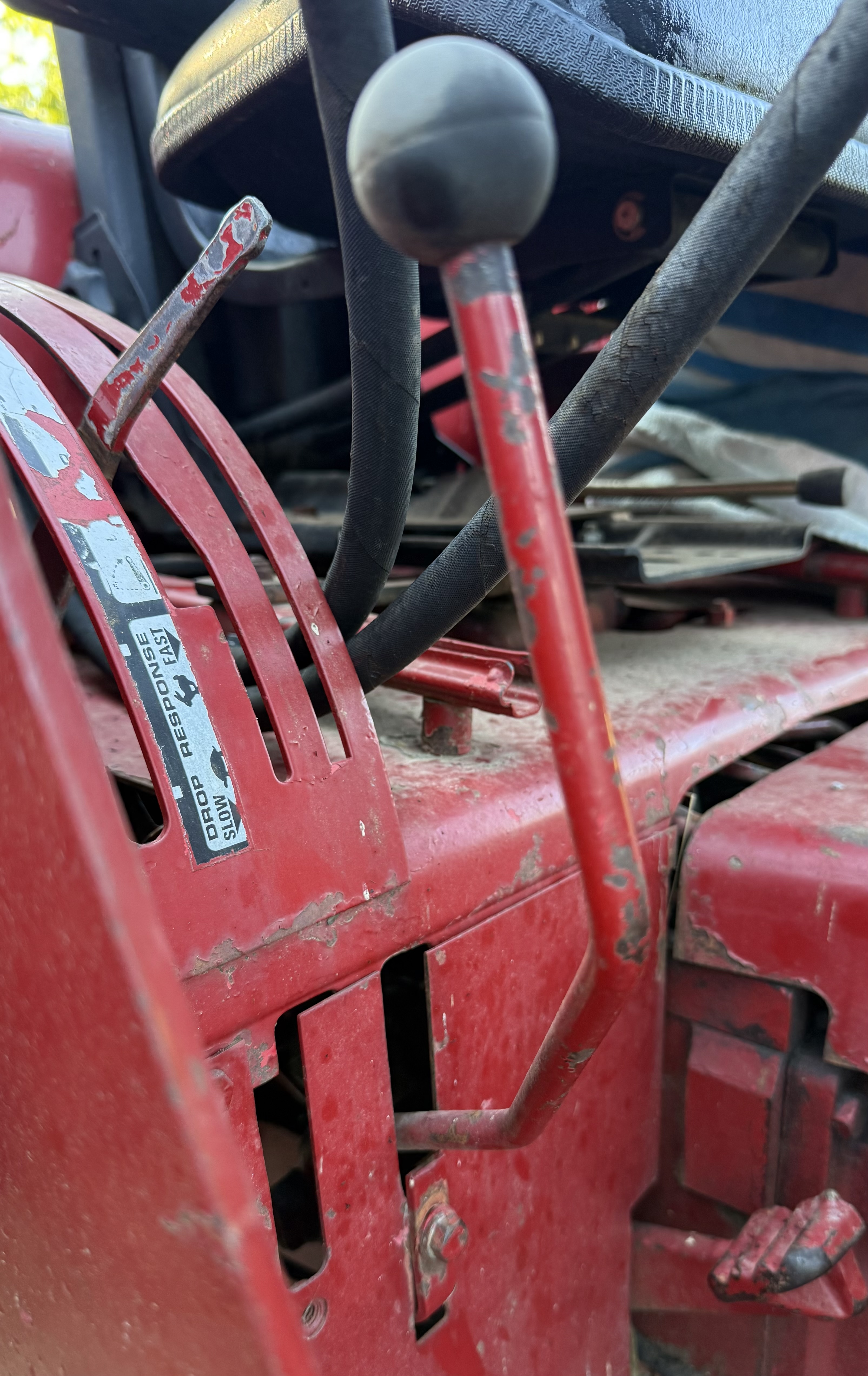

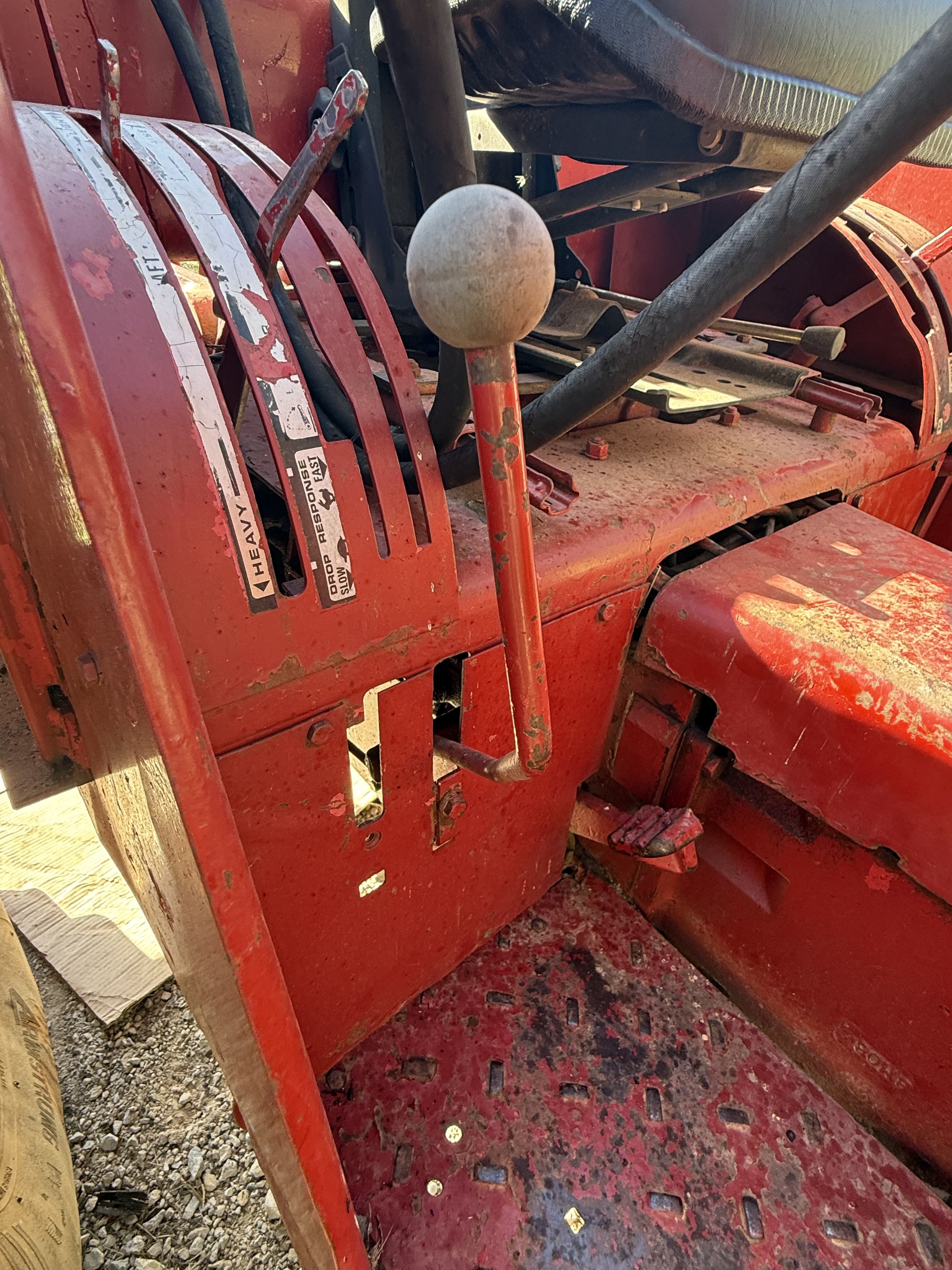

Also I’ve got it hooked up to the rear remotes right now, is it fine to run it off them? And do I hook both lines up to the remotes? When I’m lowering my loader the auxiliary valve lever pops up and I have to push it back down, is that normal?
Lots of farmers ran the loader of the rear remotes, yes hook up both hydraulic lines from loader valve to the remote outlets. You want the hydraulic hoses plugged correctly to the rear outlets so when the remote hydraulic lever is locked in the UP position with that strip of metal under the lever that when you pull back on the loader lever, the loader lifts.
See that bolt with the strip of metal under the remote lever, loosen bolt, pull remote lever into UP position and move strip of metal to lock lever in place, tighten bolt.
If you disconnect the loader hydraulic lines you will have to unlock the remote lever.

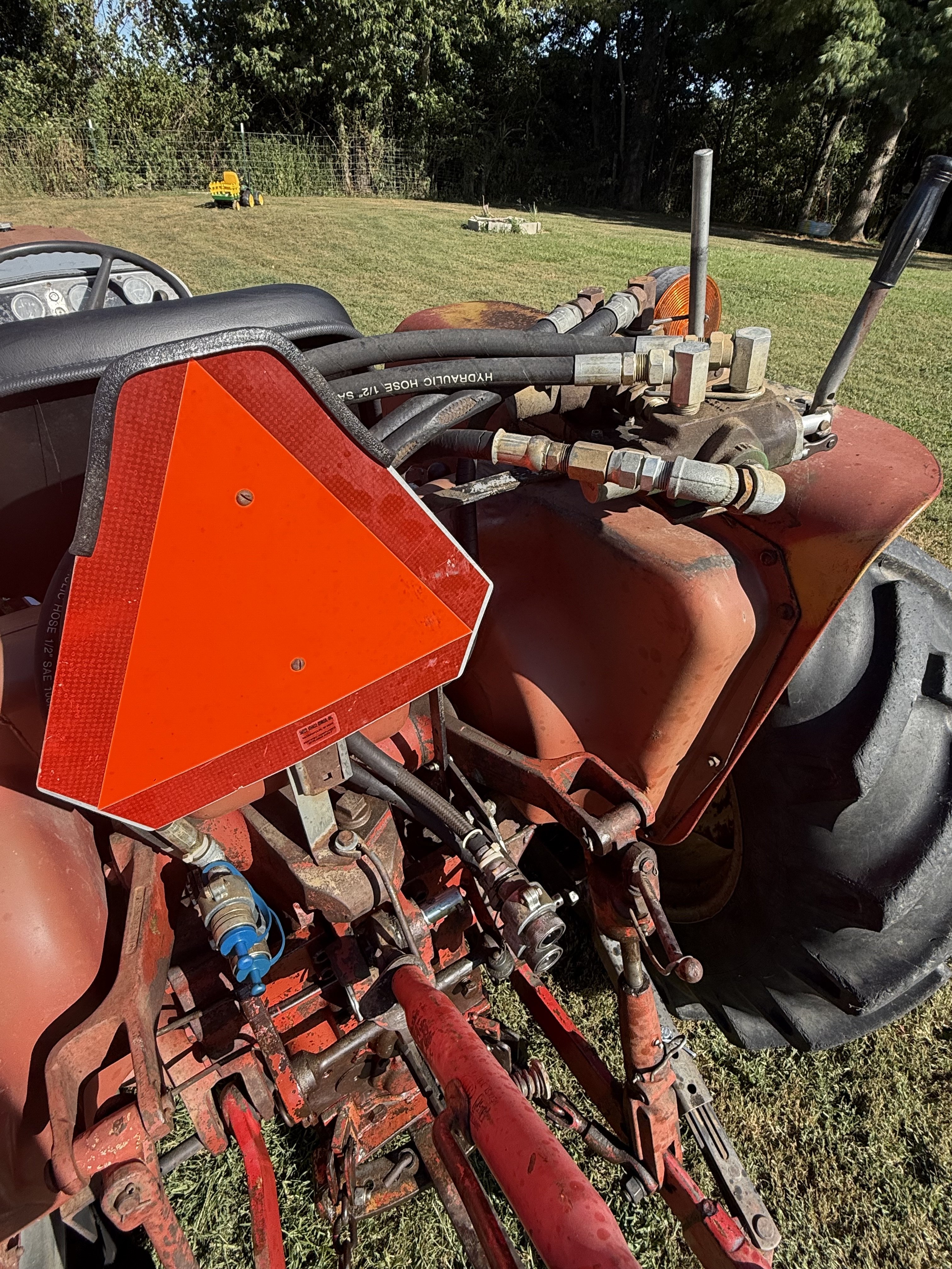

Ok I will give that a try, right now it only works if the lever is pushed in the down position.
The 484 has a double spool remote hooked to it and the loader was attached to one of those remotes. The 484 doesn’t have a remote underneath and is hooked straight to the tractor. I wanted to put the double spool remote on the 584 but then would have to put another one on the 484, so I think I’ll just leave that one on the 484 and get a power beyond plate like you suggested for the 584. Here are pictures of the 484 set up. The top line goes into the tractor, the one under it goes around and in to the tractor under the hydraulic filter.
I wonder which hydraulic line is the pressure line, the one from under the hydraulic filter?

The pressure line is the one you see in the picture above going into the tractor, the return is the one at the filter in the picture below.

This is the only position that the loader will work correctly on.
Re 484, the remote valve plumbing is opposite to others I have seen in the past but it works.
Re 584, have you tried reversing the hydraulic hoses from the loader control valve to the rear remote outlets to see if the loader works properly with the remote hydraulic lever pulled UP?

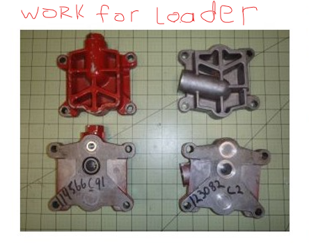

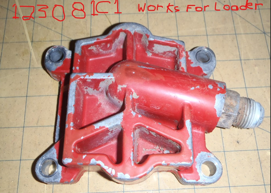

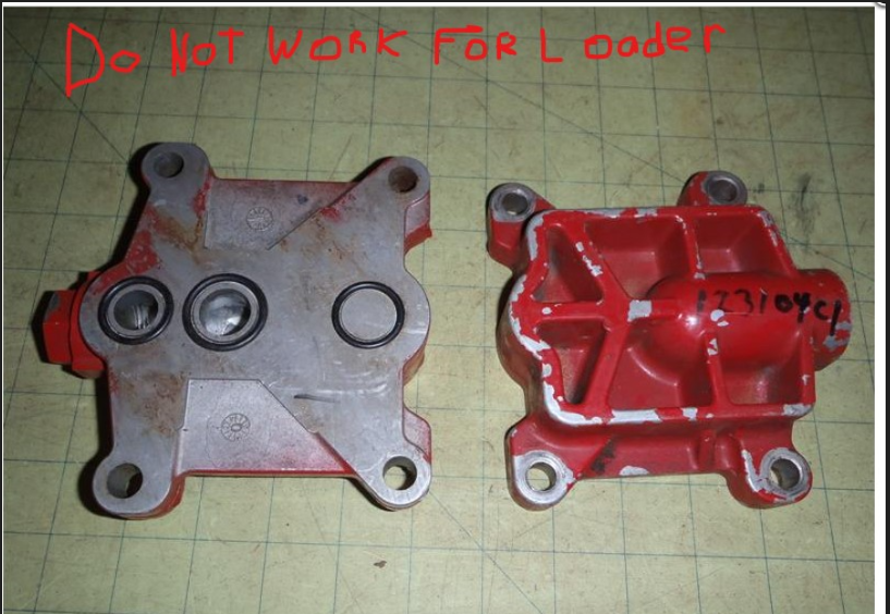

Re Power Beyond end plate, I still recommend calling the people in the web link that I provided to get the proper Power Beyond plate for your tractor. IH Louisville used several different remote valves on the IH Doncaster, UK tractors that they performed final assembly on.
See photos below of the style that works and don't work. One old IH mechanic said that a the plates with two holes can be made to work by machining a plug to plug one of the holes.

I plan on buying that plate for the future, just want to make my loader operational for now. I locked it in the lower position and while lowering the loader it stopped and my pump got loud and smelt like it was burning up. In the up position I can swap the hoses and it works but the lever will not stay in up the position , I have to hold it up, it is also slow and very loud.

Re 584, loader plumbing, from the symptoms you are describing it would indicate there is a restriction in the hydraulic flow between rear remote outlets and the loader hydraulic valves. Are you sure that the hydraulic Quick couplers that are on the loader hydraulic hoses are a match for the female Quick couplers on the 584? Back in the 1970s-1980s there were a couple different Quick coupler standards, John Deere used one and IH used another, later the ISO standard coupler was used by most tractor manufacturers.

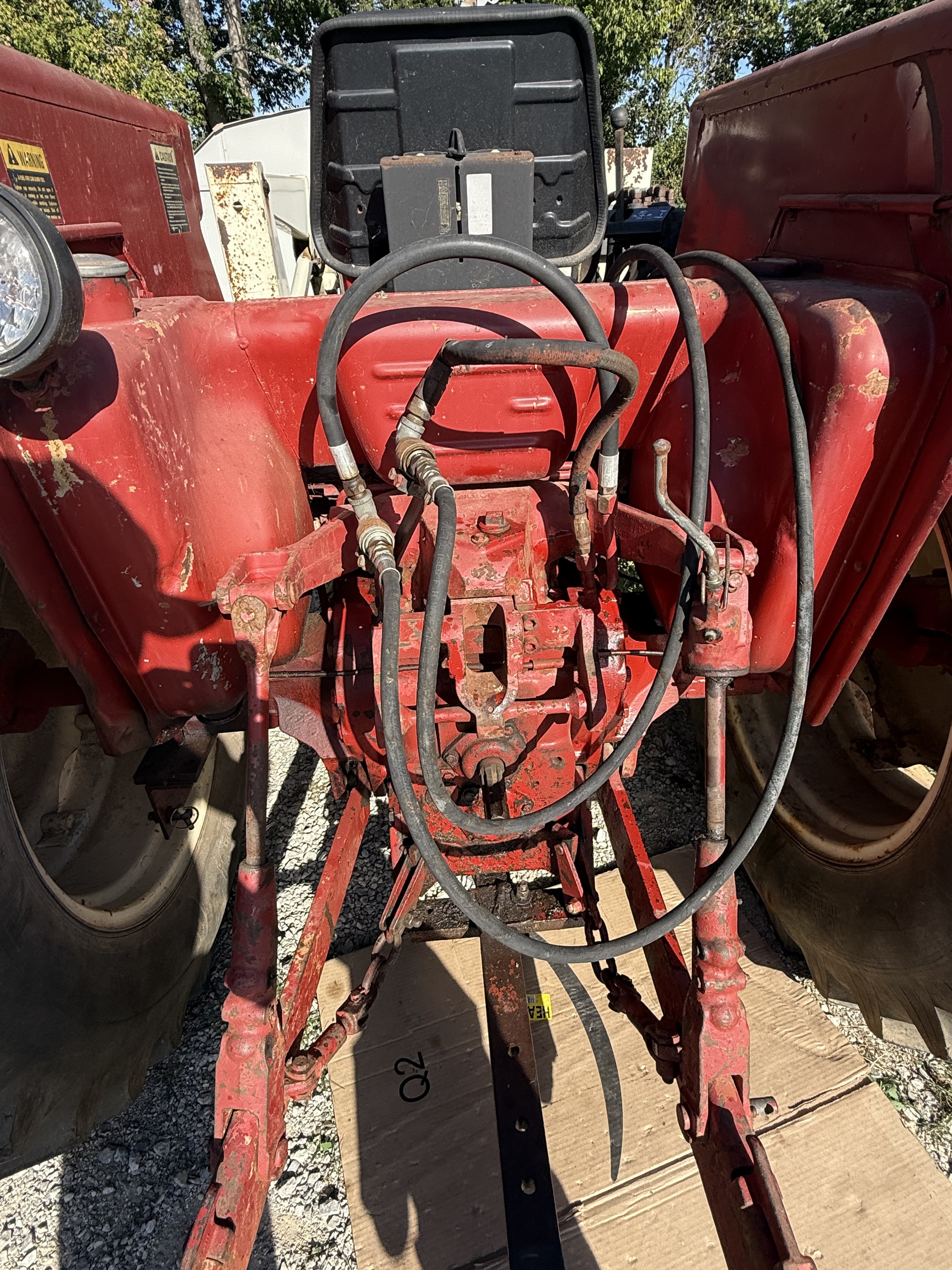

View attachment 126365View attachment 126366
Swap the hydraulic lines on the remote. That way the loader will work with the lever pulled BACK, and you can use a bungee cord to hold it there.
