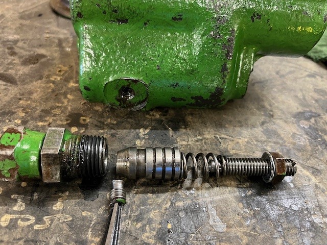

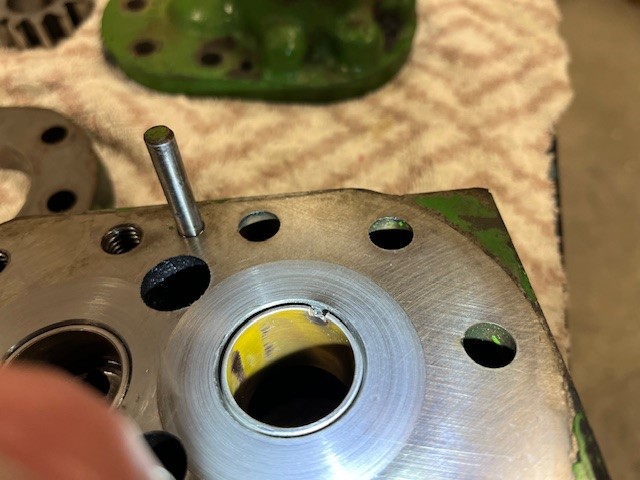

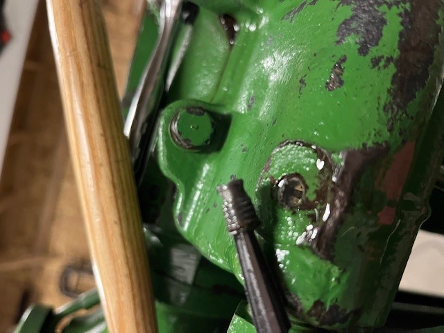

I have JD 60 (Serial #6062360) with non working power steering. The pedestal was leaking, so I pulled it apart, put in new O-rings, and filled the system w/ JD power steering fluid. My hope was the power steering was not working due to very little fluid....unfortunately not, there is ZERO assist from the pump. My multi part question(s) is:
Scott
- Any ideas to pursue before jumping to a failed pump
- Does anybody have a spare screw that is removed to test the pressure. This one was broken off....I was a able to get it out, but am curious if it is seating too deep? Does it bottom out or sit on the bolt head?
