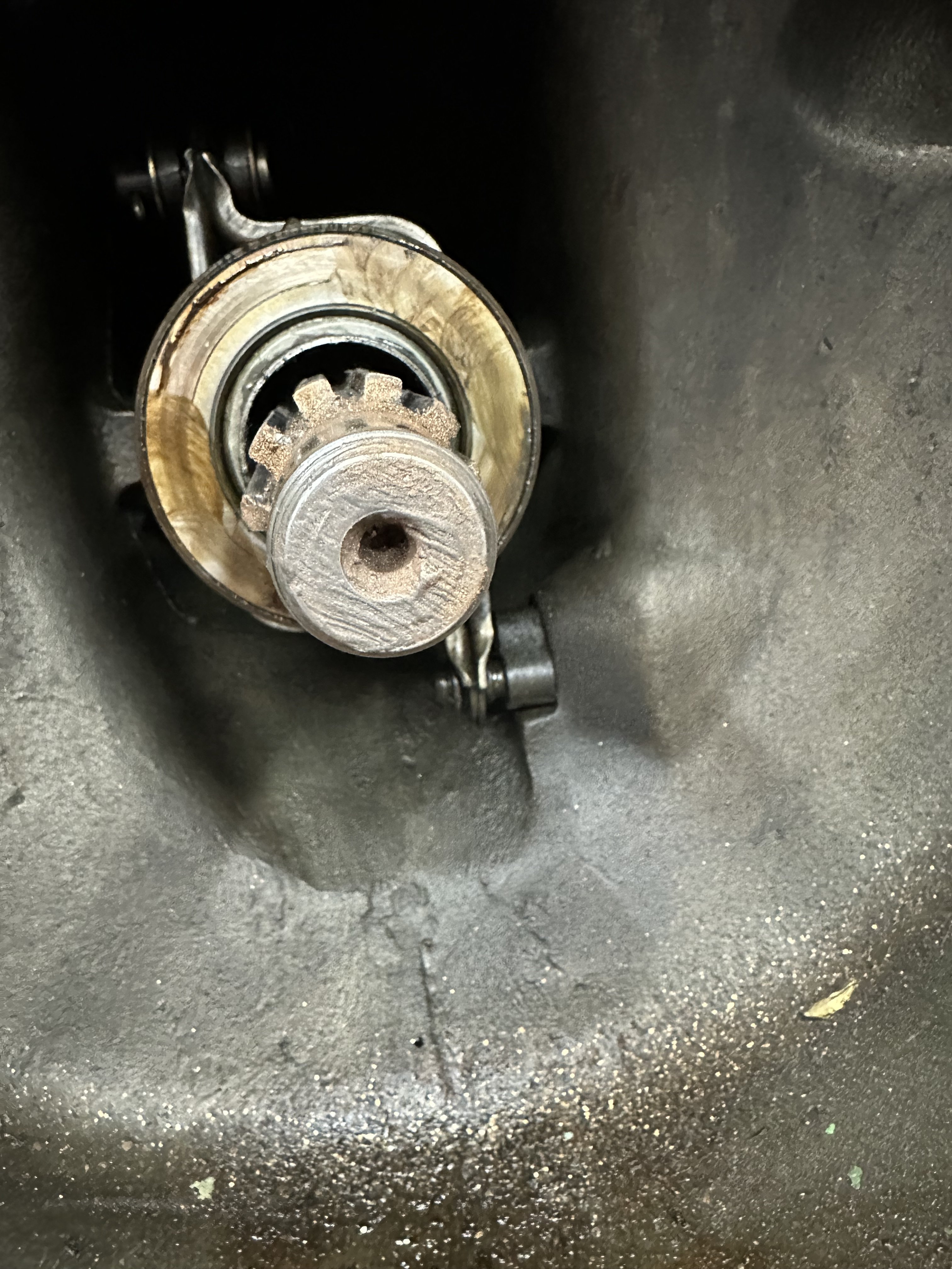

I inherited a JD M from my dad and the clutch has some issue going on. It'll grind when disengaged 90% of the time. Sometimes it'll act right.
I've adjusted the clutch pedal for 1.5" free travel. That didn't help. Figured I needed to get in to it and see what's going on, so I split the tractor. I don't have any experience with tractor repair etc but got the service manual to know exactly what it is I am looking at. From what I've read online the issue may be the throw out bearing. Any ideas or suggestions looking at my pics? If I can get away with just replacing the bearing that'd be great. A full kit that I was looking at runs about $320 (https://www.external_link/JDS3013-Clutch-Kit-Engine-).
By the way, if I am replacing the throw out bearing how do I pull the dang thing off and press a new one on?

I'll share a video I took of what happens when depressing the clutch pedal to disengage the clutch. The grinding is coming from the center frame bellhousing.
I can depress the clutch pedal over and over again and very rarely does it seem to 'catch' and operate as intended without the grinding.

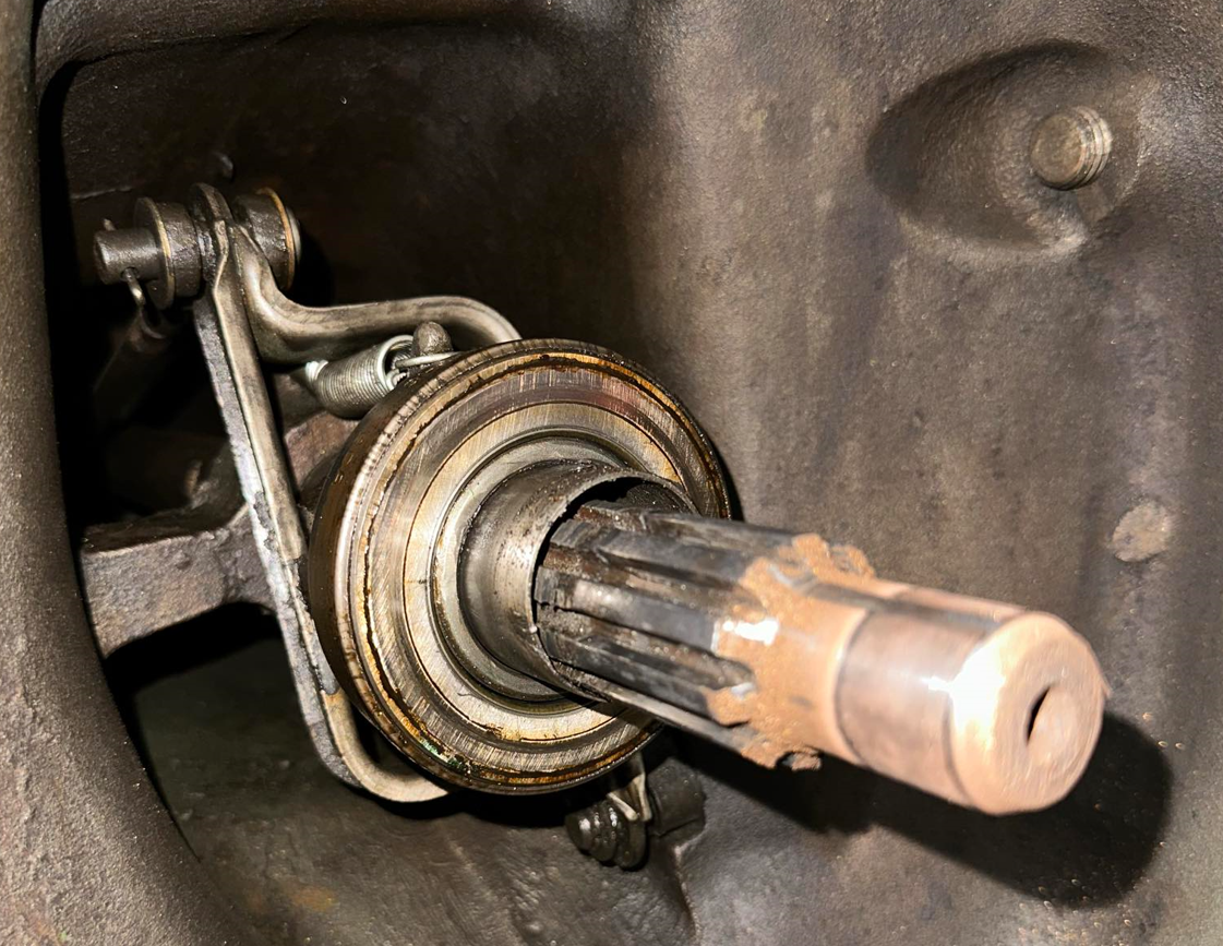

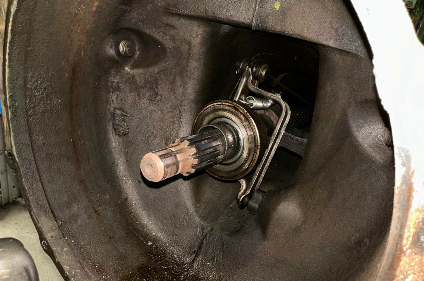

I tested the throw out bearing. It gives resistance when rotating l. If I apply pressure and turn it then it rotates more freely and felt smooth and quiet.

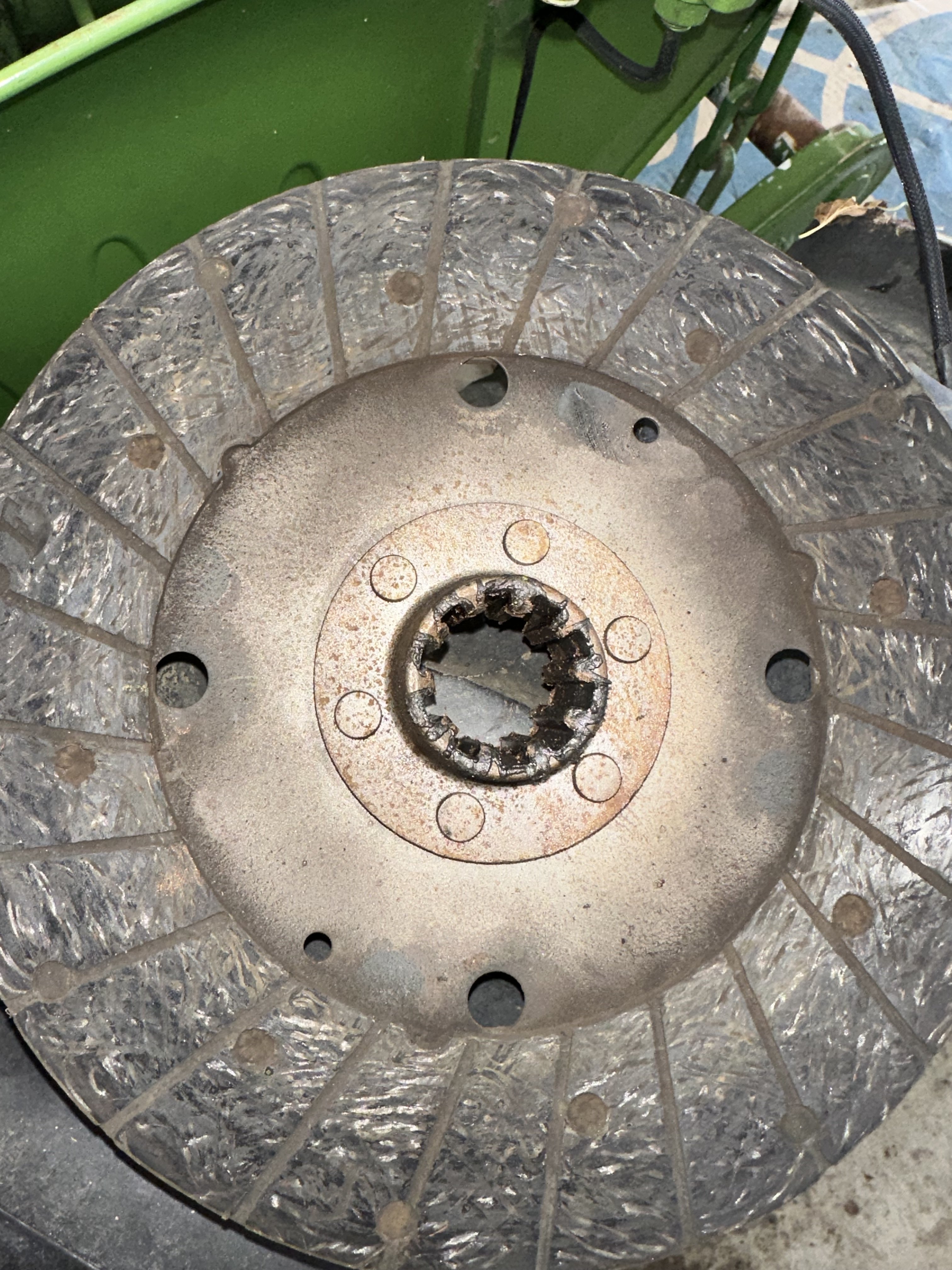

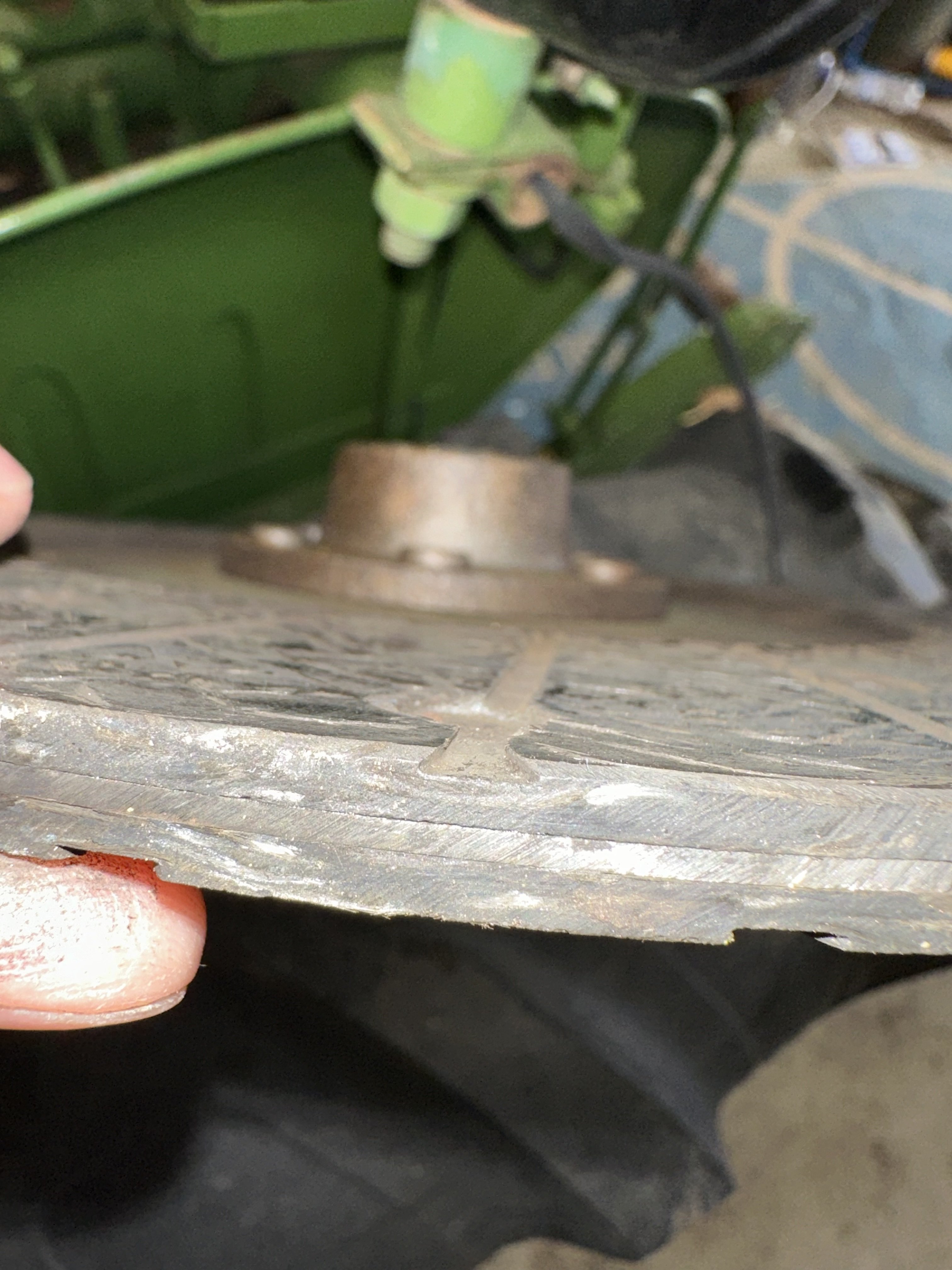

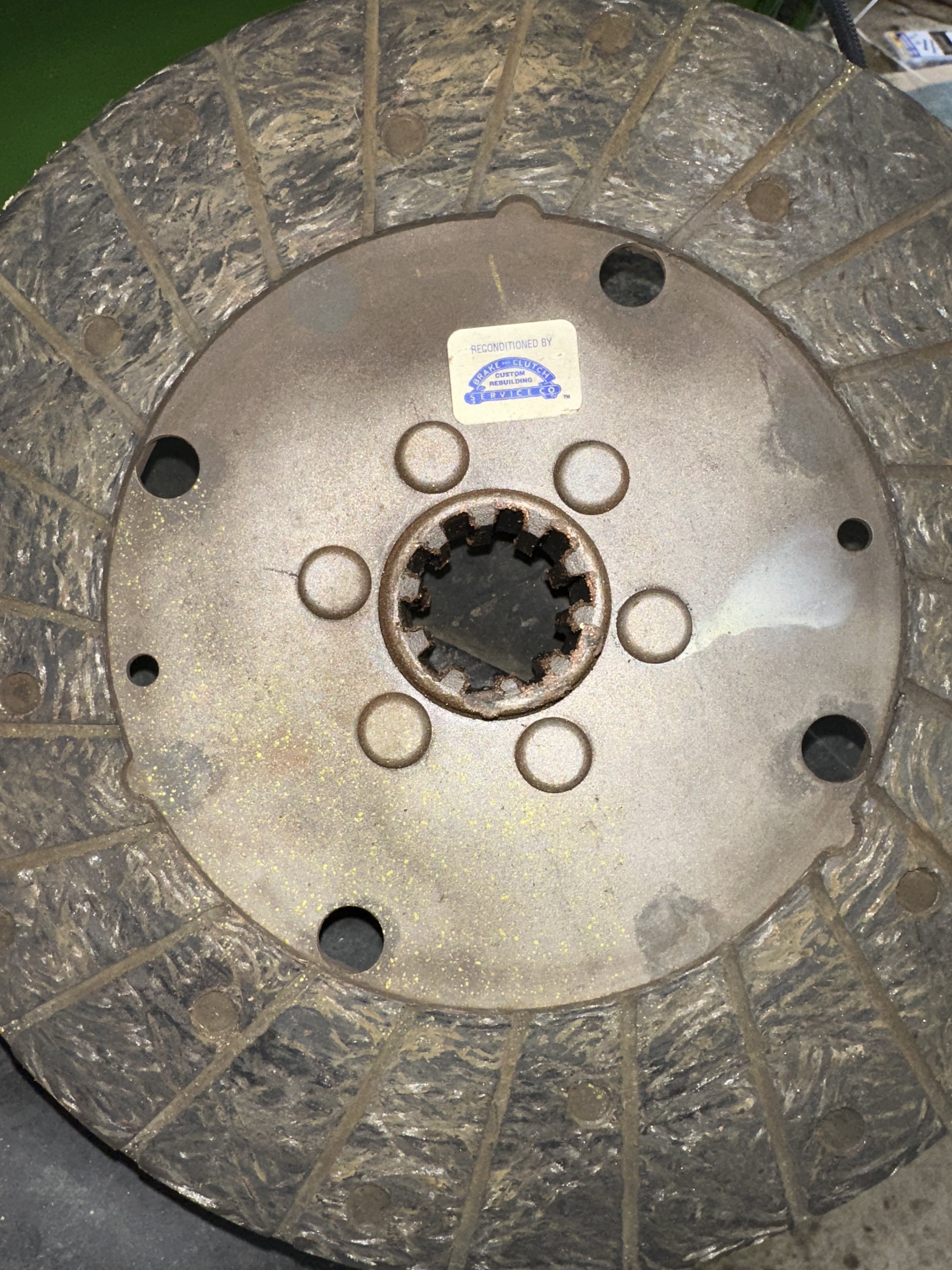

Pulled the pressure plate and clutch disk. Disk doesn’t seem worn down to the rivets and no obvious damage to it. There are some gold flakes that I’m not quite sure what to make of it.
"There are some gold flakes that I’m not quite sure what to make of it."
The "gold flakes" are what's left of your pilot bearing/bushing!
It's absence would allow the pilot shaft and lined plate to flop around when the clutch pedal is depressed.

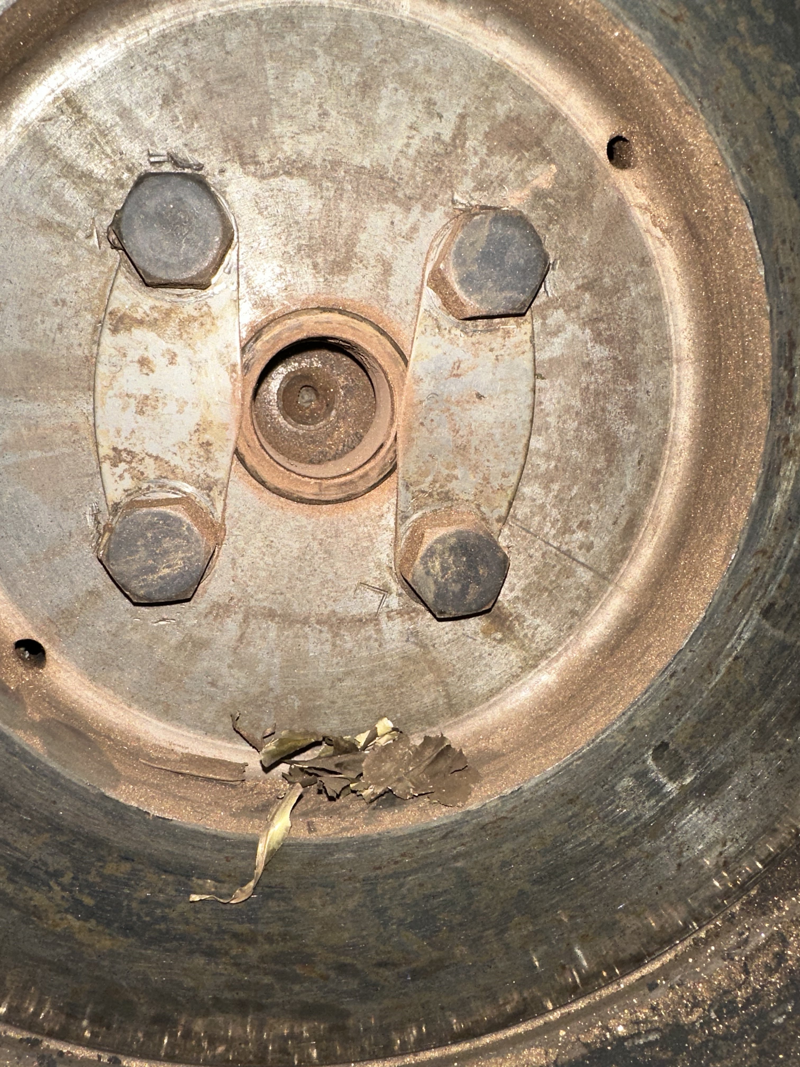

Incase you don’t know the pilot bearing (really bushing) in this case is in the middle of the 4 bolts in the flywheel. Ideal clearance between the inside diameter of the bushing and the outside diameter of the shoulder on the input shaft should be around 0.008 to 0.012” roughly 2 sheets of paper. For the sake of exaggeration, you could probably sling a cat through the clearance you have the way it is ground out. I believe the ball bearing woreout posted should fit and be an update improvement for you. Post a photo of the stub on the end of the trans shaft. The bushing was made of “oilite” bronze which is oil impregnated, sometimes they just decide to go south. If what fixing farmer suggest is true that someone recently replaced the clutch they made have “dinged” the ID of the bushing bore. That may have caused a local hot spot there initiating the failure.

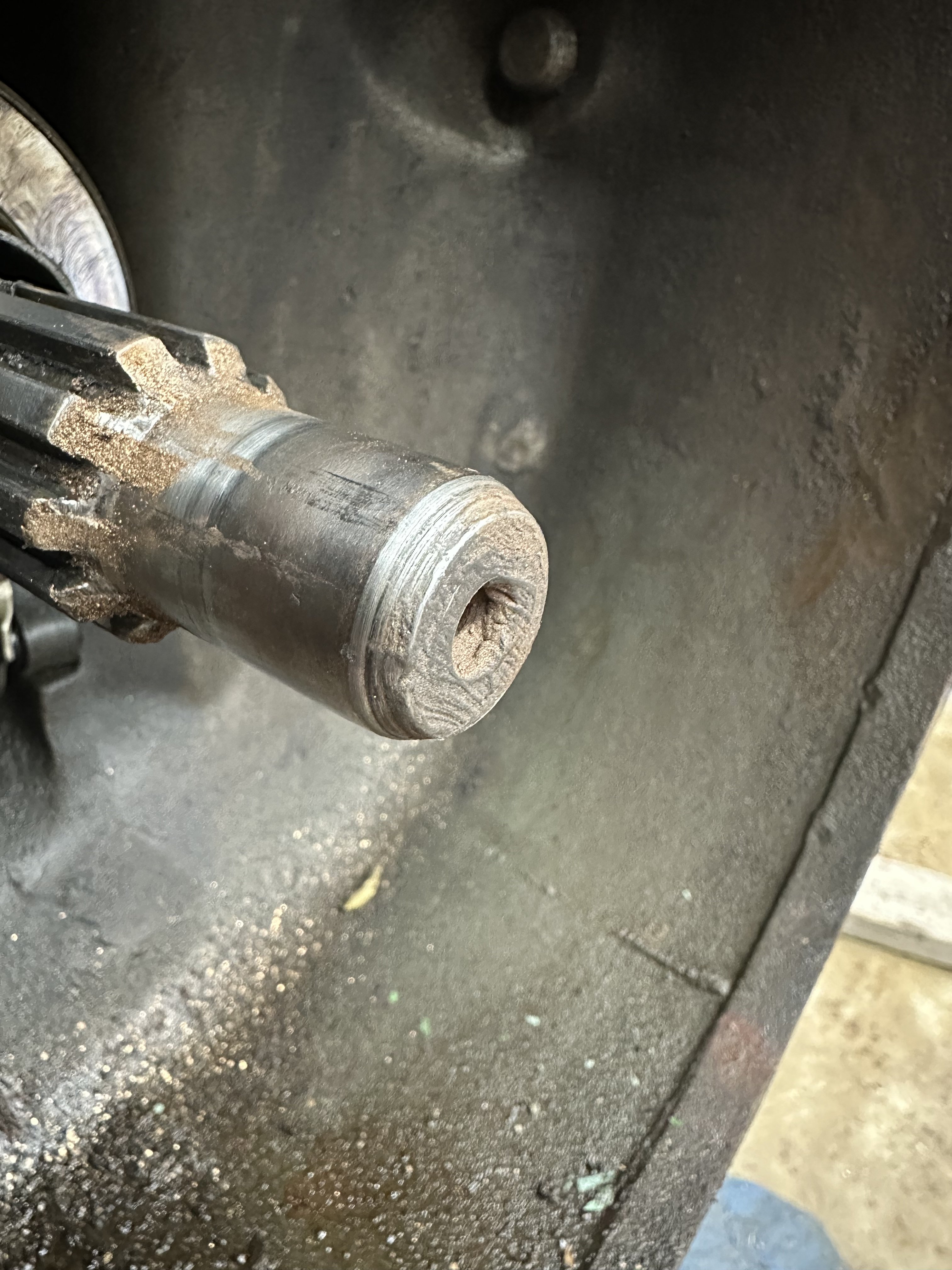

That shaft looks fine.YT has the bearing but they “slice and dice you” on shipping in my opinion. Probably can source one locally. I think they show the ID incorrectly; 0.591” is what I found other vendor show, 1.378” OD.
