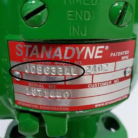

If it's the JDB pump shaft can stay in place and pump removed rearward off the drive shaft.
How would a person know if it’s the JDB pump?
From the internet...
The JDB fuel pump is a type of injection pump commonly used in diesel engines, particularly in John Deere tractors. To identify it, check for the model number on the pump, which may include designations like JDB331AL2732 or similar, and consult resources like parts catalogs or forums for specific details related to your engine model. forums.yesterdaystractors.com jdcrawlers.com
The pump should have a tag on it. Here is the tag on a JDB pump.
