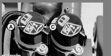

The block on the rear of my hydraulic main block has 3 ports to hook the gauges to. Which one is for what test and what should my readings be? I checked with my dealer and he said I need to get a different manual to find my problems. The manual I have is how to fix the problems, not to diagnosis the problem. He gave me the manual # so I looked it up. $875.00. I think not. Since Deere lost its right to repair case there going to get you for the info. My problem is my cylinder leaves don,t return to nutural when it gets to the end of the stroke. It has been this way since I bought it, My son has a 6420 and it does the same. It doesn't matter if I use remote 1 2 or 3. When I return the leaver to
nutural it sounds like a relief valve is sticking. I can tell the engine is working the pump. I can get to quit by taping the leaver the other way or by turning the steering wheel a little. I thought I would start by checking the preasures. I have the 200 series valves. My dealer can't tell me if the leavers should return to nutural by them self or not. Other than this all systems seem to work ok. Any help ?

I looked at one of the Op Manuals and it read like the 200 series valves don't have the detent and kick out to neutral. The 300 series have that option.

With the 200 series SCV's there's 2 settings for the SCV levers. One is no detent (C in the pic) which will allow the lever to release back into neutral when the lever is let go. The other is detent mode (A in the pic) which keeps the lever held in the operating position even when the hydraulic cylinder is fully extended or retracted. Sounds like the levers are in detent mode??? But that wouldn't explain why pressure is still being built up with the levers in neutral. I'd have to do some more research on that.
I have the operators manual. The setting A is for using a hydraulic motor and setting C is for using a cylinder. All are set in the C setting. All the dime valves are where they should be acording to my technical manual.
