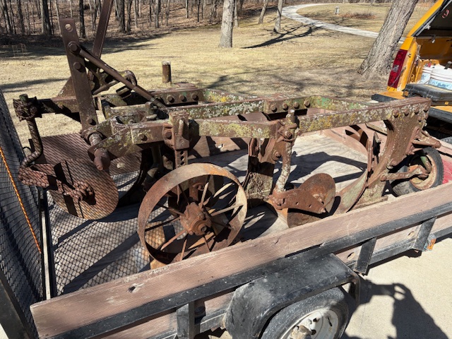

Well, I went and got it today. Mark-la you are correct. I am guessing that the whole thing is somewhere between 1000 and 1200 pounds. It just barely fit in the trailer that was 52 inches wide by 96 inches long. Trailer handled the weight well.

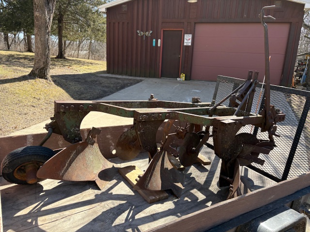

Pretty sure it is an 813 John Deere integral plow. 3-14” so should be about the right size for my JD 60.
Told the forklift operator to not scratch the paint, ha ha. I was happy that it included the Mast Head coupler.
Think it will get the sandblast and new paint routine. Will be a while till I get to it. Next winter project I suspect.

I looked up in parts book the plows we have. First of all, I said the plow similar to the 813 was a 410. It is a an 810A or 810B. Both the 813 and 810 plows use the same parts book. When I last looked at the parts book about 20 years ago, I had made a note that my plow is a 3-14 810A. Only difference I can find in the parts book is that the 813 has the longer bar for the 1st coulter and the 810A has a shorter bar. Mine has the shorter bar. Also, both plows have the same length handles. So it looks like someone must have put a shorter handle on yours. Also from the parts book it seems the 813 was made up through 1954 and 810 series after 1954. Not sure when the 620s came out, but must have been in 1955 or 1956.

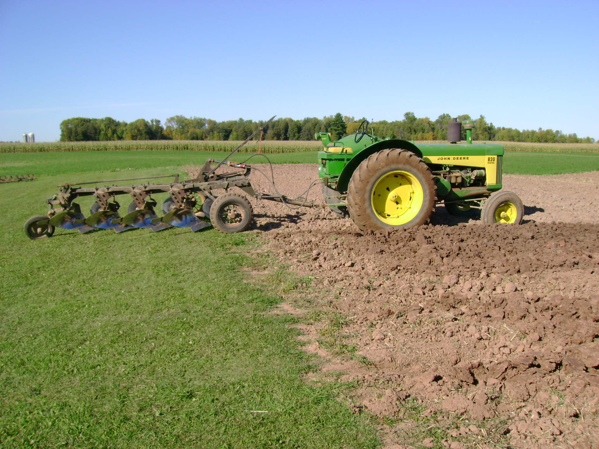

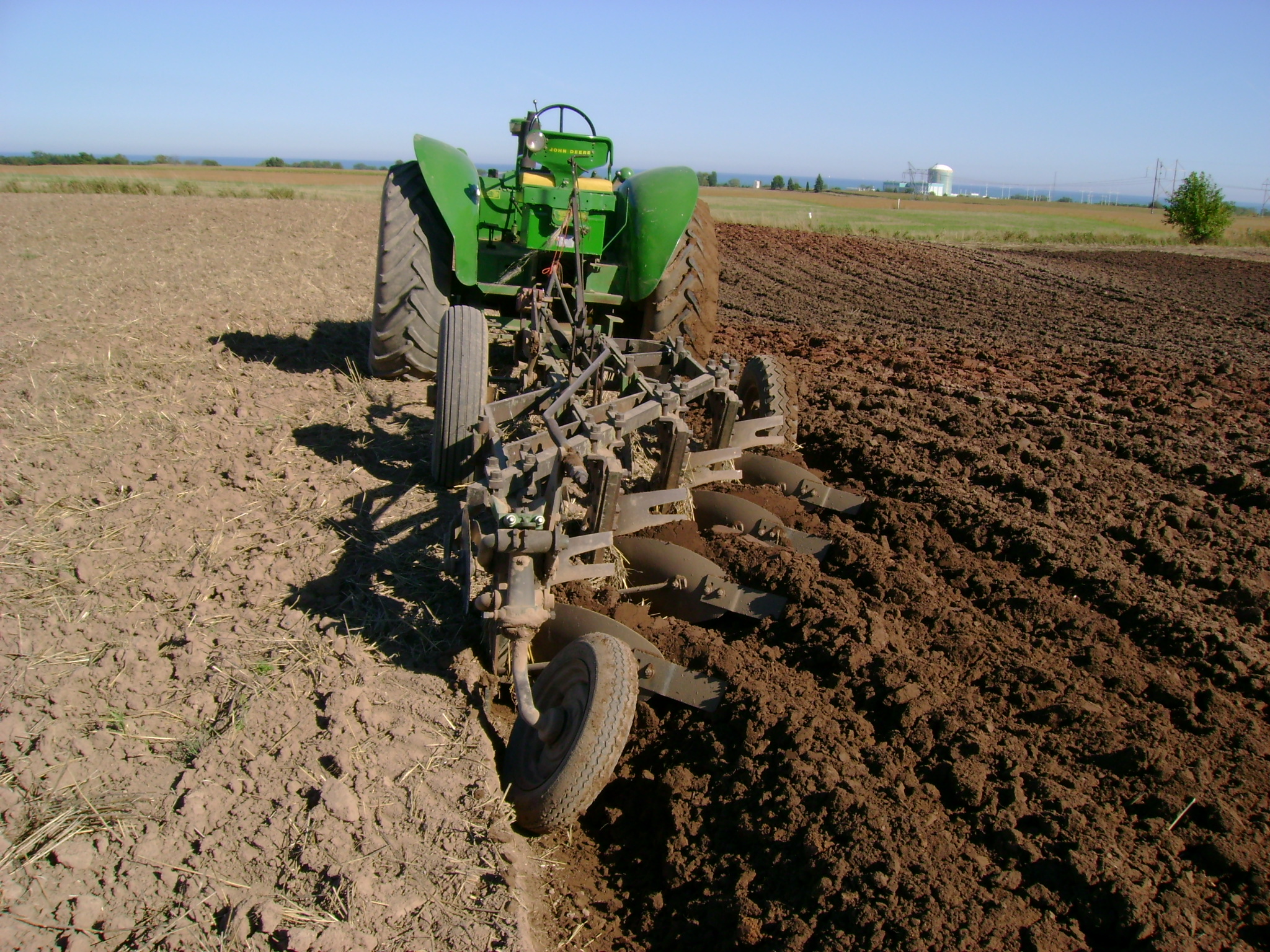

Attached are a couple of pictures of my JD 830 and my JD 4-14 66 plow. AlView attachment 65903View attachment 65904

Also, I believe the only difference between the 813 plow and the 810 3-bottom plow is that the bar that mounts the 1st coulter is about 6 inches shorter. I thought I had an 813 plow, but after studying the 813/810 plow parts manual, I found mine has the shorter bar. So it technically is an 810 3-bottom. I think each bar had a different part number. I was told the shorter bar was needed because the longer one interfered with the 2nd remote hydraulic box on the 620/630 tractors. My JD dealer many years ago said you could just the cut the bar shorter on the 813 if you had a 620/630 tractor with a the 2nd remote box. That's what I remember about my 810 (813) plow that I still have. Al

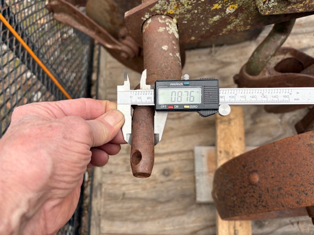

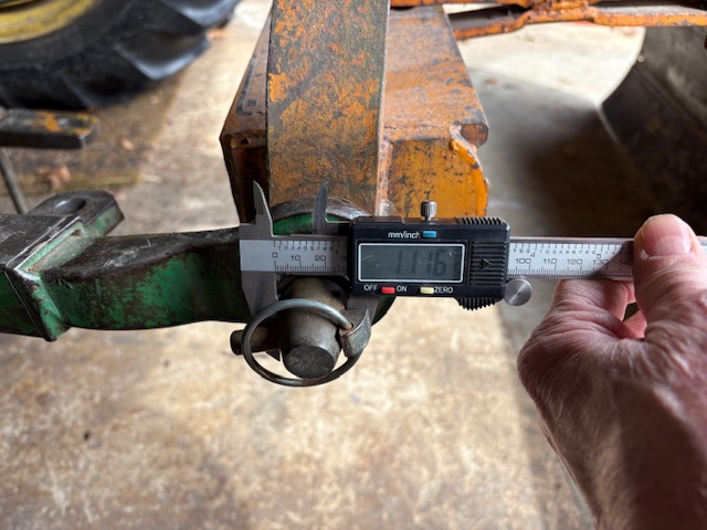

I notice some interesting things regarding hitch and plow. The coupling pins on the 813 plow,appear to be Cat one, while my hitch eyes are Cat 2. Strange that JD would make something like that, when the plow seems specific to the 60 or 70 tractor, as is the 801 hitch?
Plow pins are .876”

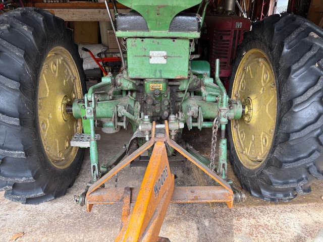

Hitch on my 60.
Cat 2 pins on my Woods rear blade are bigger than the plow. I would say that I will need sleeves to go over the plow pins.
Plow has probably been modified. As far as I kinow all 800 series plows were cat 2. I have a neighbor that turned his 812 down for hie Massey tractor

I believe I had to use a set of sleeves when I had my plow on my JD 70. The sleeves are still wired on the plow. I also had it hooked to some new JDs like a 6230 so I will have to measure if it was the 70 that required the sleeves too. Will reply once I get over to my hobby farm. If that picture is your JD 60, that is an 800 hitch with the crank just like on my JD 70. Al

I checked my 813 plow this afternoon. And it must be a Cat 2 as the pins are the correct size to fit the arms on my JD 70 with 800 hitch. I did have some sleeves, but it looks like they are Cat 2 to Cat 3. I must have used them when I had the plow mounted on my JD 6110R, which is Cat 3, to move it. I also looked in my 810/813 parts book and it doesn't show any options for Cat 1 or Cat 2. So not sure why your 813 is just a Cat 1. Al
