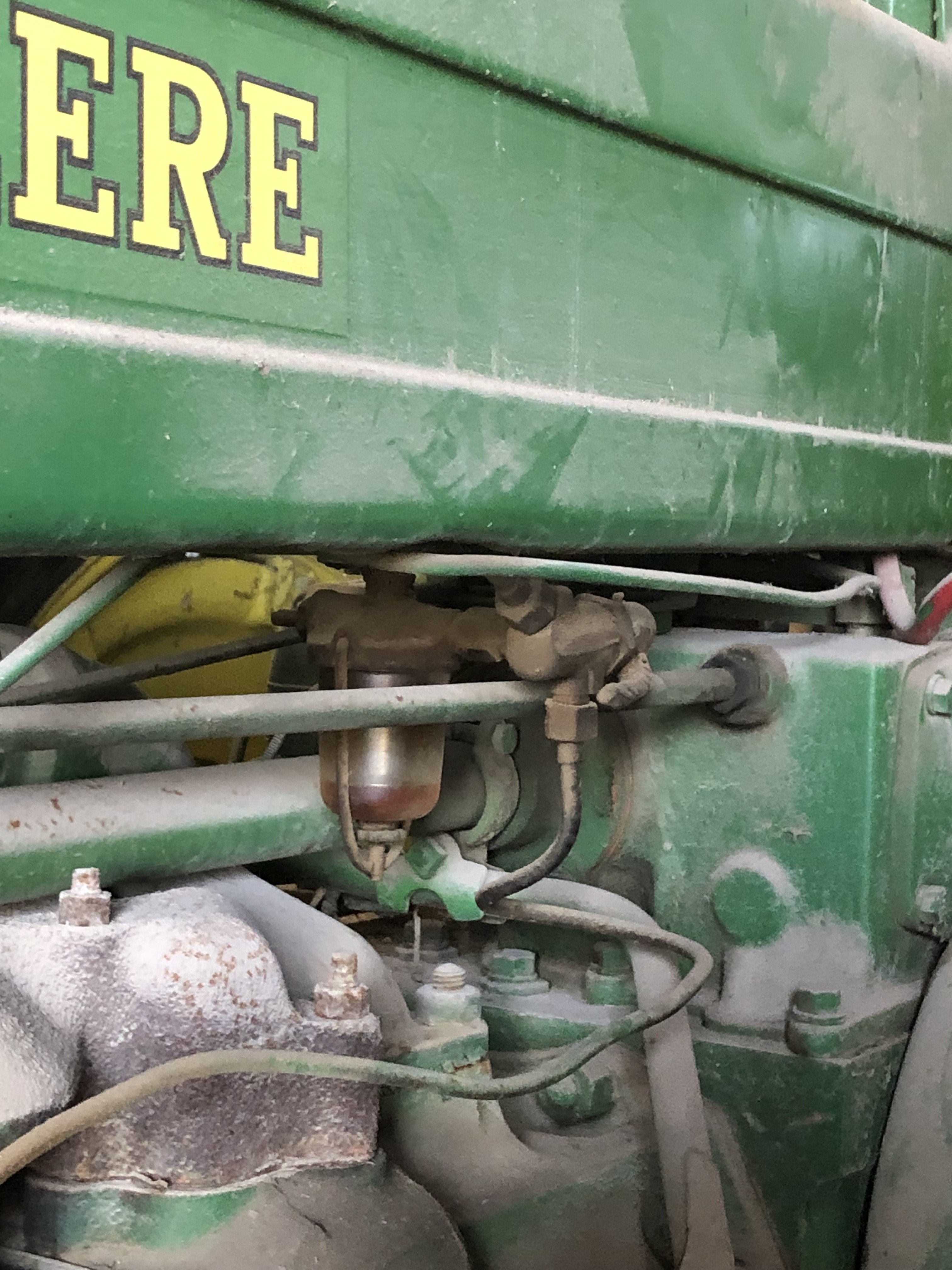

I am trying to figure out some stuff on our 1944 B but everybody that would know has died. I always heard that it was hit by a car and the head was replaced with one from an A. Could an A head fit or more likely, one from a Gas B ? Also, could an A gas tank fit a B? Thanks.
The cylinder head from a model A will not fit. Perhaps the model A gas tank could be made to work but I think you would quickly recognize such on inspection.
An older b head would be about the only one that would fit with different pistons I think that’s why they make new ones of the un styled head because it fits so many tractors.
I think the tank is bigger and deeper on the A than even a long frame B like said above it would be noticeable

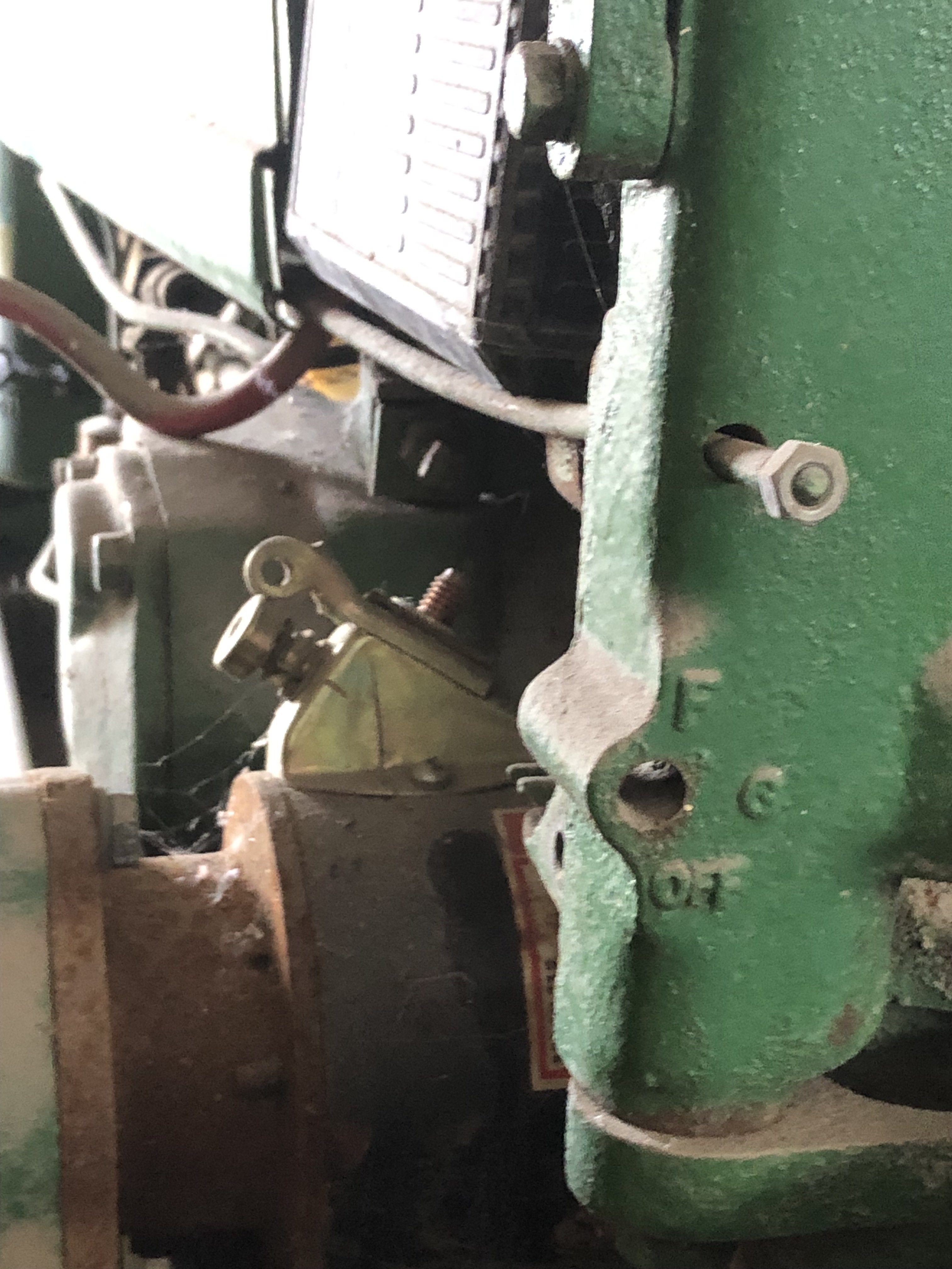

It appears that the 3-way control valve lever is about an inch lower than it should be ( hole with F and G) on the dash.
So the late G that was here and all fuel had 2 couplers made out of a tube and a couple cotter pins to line everything up. There’s one in the shed that hasn’t been redone yet we assumed was a 44 b might be close to yours I’ll look when I get home at noon and take some pictures if nobody beats me to it.

My B does not have a starter. So if I understand right, my B can only have a B head. It is in a dark building and I am trying to first get it going . I am going to have to work on the sediment bowl and 3-way valve , but from looking at it so far, I can't figure why the 3 -way control rod is about 1" lower, that is why I asked about an A gas tank fitting a B.
yes no other model would fit. It could have an older b head is the only one I BELIEVE that would fit and it would be IF it has the right amount of studs in the right spots. If you pop the valve cover off there is a casting number in the center of the head b357r I believe is the old one without any relief in it the head is flat like a lot of Diesel engines. ive heard people would put the flat one on to increase compression on the ones that had the cyclonic head. I think you have to do something different push rod and piston or connecting rod wise but I've avoided doing it and used what was original on the ones i've done luckily two of them here are unstyled the one that is mine got one of those new heads. The stock head FOR YOURS would have a casting number of b2871R, part number of ab4204r. other possible casting part numbers would be b1784r and b2501r look up item number 200274 on yesterdays tractor and you will get a good picture of the bottom and how its not flat. all of those castings except b357r are for sure interchangeable.
a picture of your valve might help that tank fitting question it could be a different segment bowl or??? the tank straps could also be broke or missing some bolts the tank is held up by that hood I never have liked how that was all supported by the hood but the idea was to never take it apart if you were just doing head work.
does the steering wheel pedestal look the same as the one in the picture I sent or does it look more like the later one the hole for the 3 way will be higher I believe
