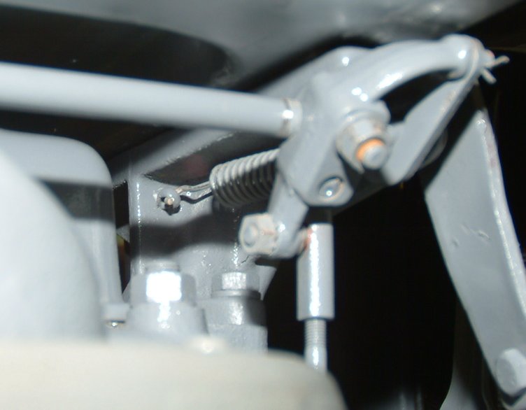

Does anyone still have John(uk) governor instructions that he used to send people. I understand he isn't on here anymore. I've replaced my governor, governor didn't work before I put the new governor in. Plus set everything by the book, triple checked all settings. But still no luck getting it to work.

I have the same problem with mine too. Adjusted everything like I watched on the video. I can get to idle down but will not go to full throttle, when I get it to go full throttle then it will not go down to idle. I had another mechanic look at it and he couldn't get it either.

I brought the new governor from Steiner because they said about quality. I didn't see anything wrong with the old governor. Old post from John(uk) said most of the time it was the linkage and not the governor. I found every post on here that I could from him. He always email the governor instructions and other instructions to people, but never posted them that I could find.

Almost everything kind of information I found they say it's the linkage and not the governor.
On mine, which is a different brand of tractor, so might not pertain to your's. I had to add to the length of the rod between the carb and gov to get it to work right.
Thanks, I'm in the process now of making sure there is no binding anywhere and trying to fix any looseness. May have to remove cover and replace the 2 needle bearing in there.
When I changed the manifold on mine, the throttle rod lever on the carb, and the idle adjust screw was binding on the manifold.
The on the other end of that rod at the governor arm, someone had replaced the clevis with a 1/4" bolt with two nuts jambed together to hold it in place. That was binding too. I replaced that with a clevis and all the linkage is all smooth and free.
The governor works but I've not had time yet to set idle and WOT speeds with a tach.

Is the throttle control plunger/governor lever spring in good shape?
You might have to loosen the U-bolt on the end of throttle rod that hold the compensating spring to adjust WOT once idle is set.

I found today that the throttle rod at times barely rubs on a manifold nut near the front of engine.

My understanding is John(uk) died a few years ago. I was hoping someone still had his "governor adjustment" file on their computer and would share it. Yes, he was a great source for information on Ferguson tractors.

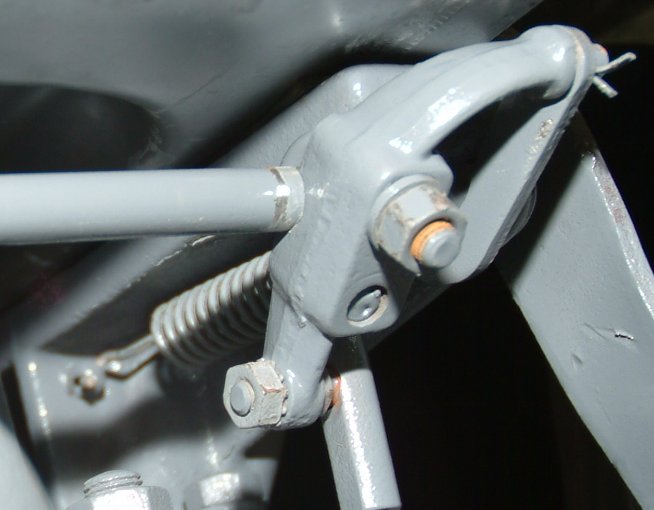

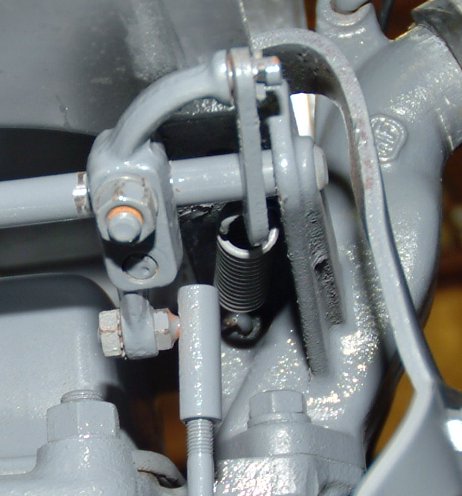

This is what he sent me. I had to go through a few old hard drives to find it. Good luck
Thank you very much, I was hoping someone still had these files. Not knowing him he seem like a expert on Ferguson tractors. I saw on the net where he was a Ferguson mechanic working on Ferguson tractors for over 40 years. Again, Thank You.
John (UK) was very much our go to for problems. He had worked in a Ferguson factory in England, and was a great contributor here for our problems. He is very much missed.
