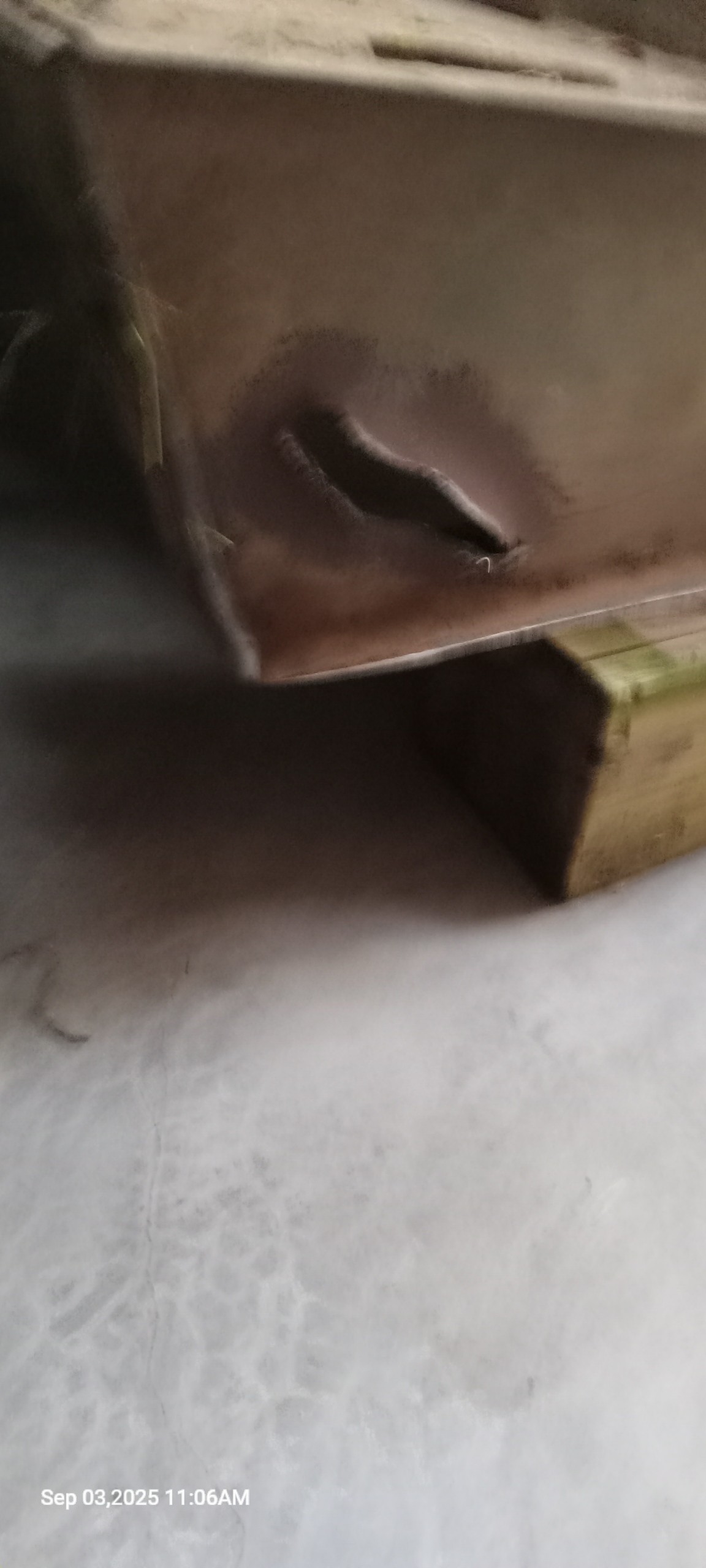

This is the result of a broken blade. Pic is the LF corner of the old mowerl Before I could fully depress the clutch the violent vibrations shook all 4 gearbox bolts loose.
