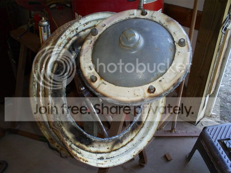

The gray on the front wheels is Van Sickle dark Ford Gray, lightened be me. They came off my 43 which is red/gray. The 43 just received a set of 16" that I made.
The hood came that color, its kind of like the Johnny Cash song with all the Cadillac parts except these are all the same year, just different sources
The rear wheels and tires I bought on ebay. The other 40 I bought had a perfect set of 28" hat rims that I sold on ebay which nearly paid for these. I drove to the west side of St. Louis to pick these up, back when gas was 2.50 a gallon, about a 5 hour drive each way. The tires are like new with a few scrapes and cuts on the tread.

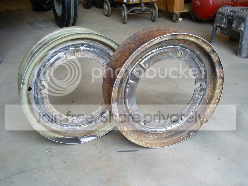

The wheels came off the 43 I have. I moved it to 16" as I had the tires.
I made the wheels from 16" wheels I had and a couple of donor 19" centers, 1 from TOH.
That little project was 3x as much work as I expected.
