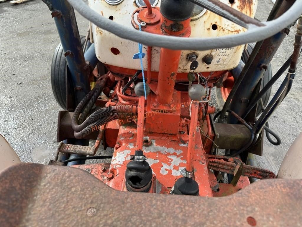

Hello There.

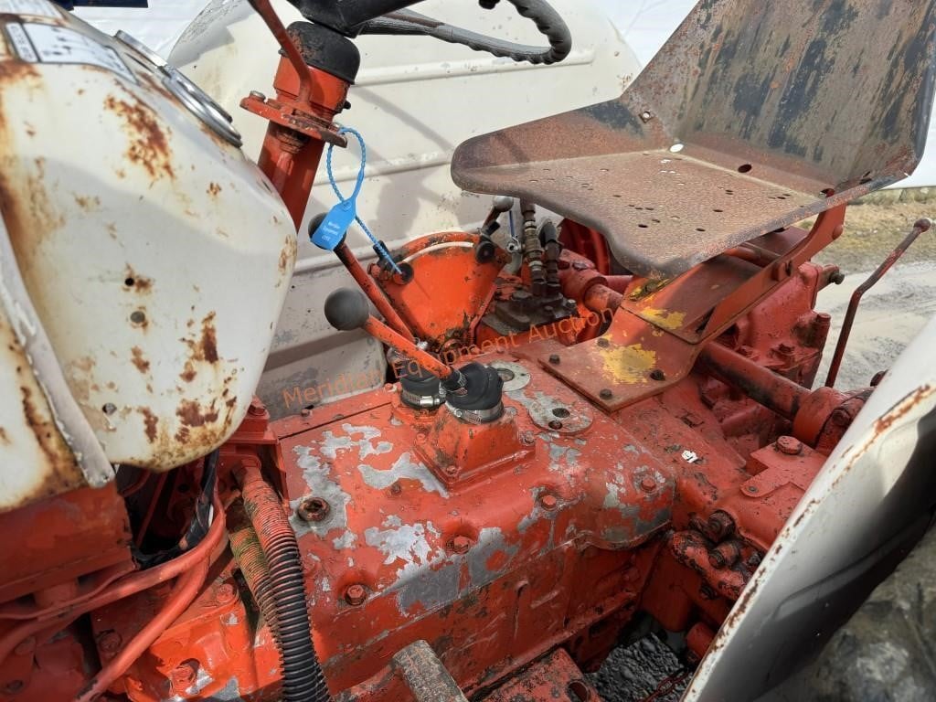

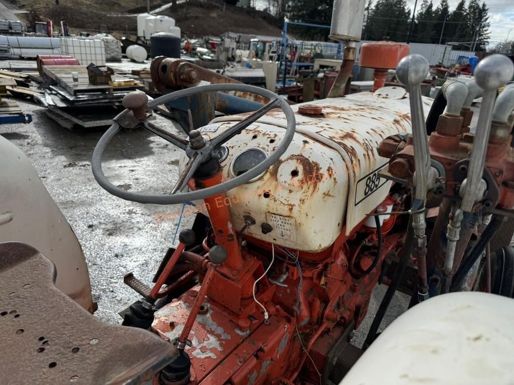

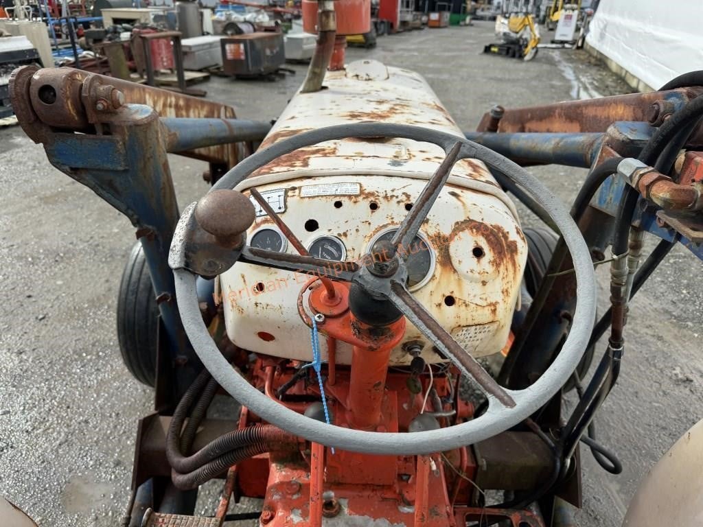

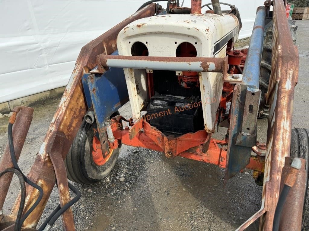

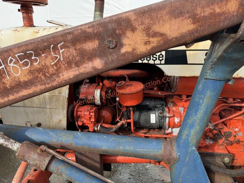

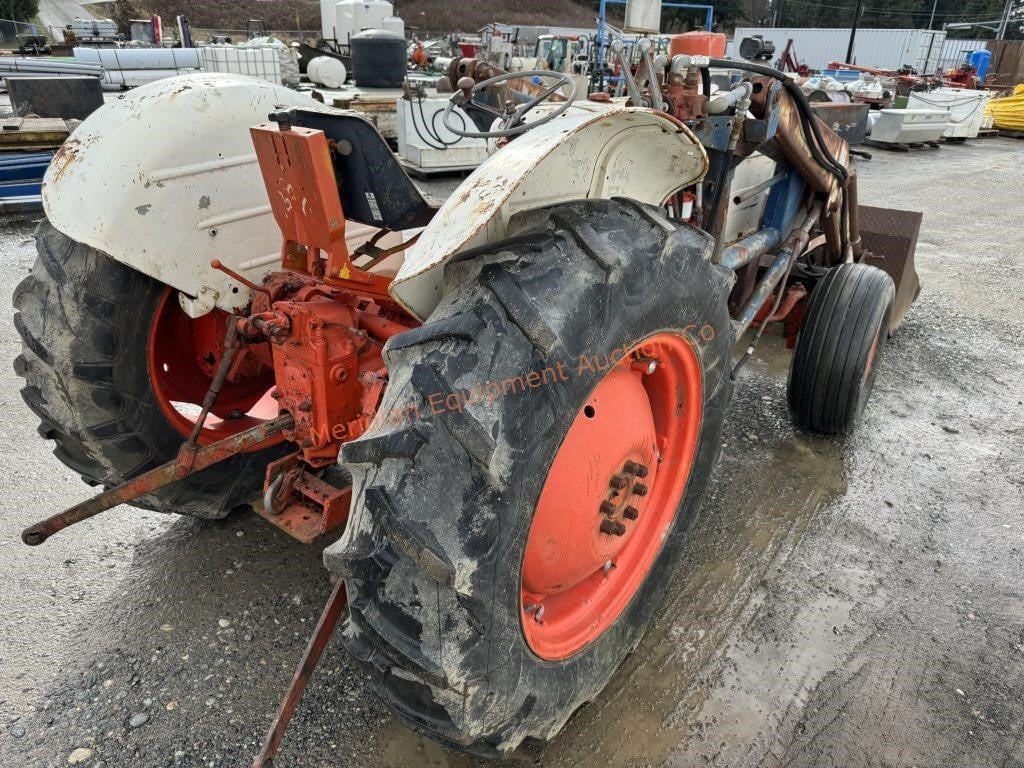

I got this David Brown/CASE 855 from local auction (for $1250+125 auction premium+ 120 hiring trailer), unkown model year. I don't know if it's a good deal or not.
It's my first real tractor, in hope to do some yard work with it, moving gravel dirt and clear dense blackberry high grass with PTO attachment.
I know pretty much about car repair (my hobby) and with lot of car tools, and repaired riding lawn mower before. But no experience on real tractor. After initial assessment, I think the biggest enemies to deal with are: 1, old rust, 2, heavy part to be removed such as big wheel, final reduction, 3, antique parts. I am surprised that the tractor parts (no matter new or old models) are so expensive compared to ebay auto parts. As early ground work, I have found the operator manual, service manual, bulletins, part number manual.
I plan to fix the issues I found and gonna find, to bring it back to work, with mad max/fallout style cheap redneck methods as much as possible. Sounds good? I hope to borrow some priceless knolewledge from you guys on such antique machine, please give me some guidance and advise. Any idea would be great.
Issues, todo list (I will update):
1. Hydraulic
the loader moves but slowly. Had not figured out how to make lift hitch moving because I just managed to get it back home for 2 days.
I found the hydro fluid is milky color on dipstick. The shifter boots are teared pretty bad. It's said water can go into from there. The hydraulic fluid and filter needs to be changed for sure.
For shifter boots, I can simply put another layer of used rubber glove on the outside, to make it waterproof. A simple fix.
For such tear on the boots, how bad the hydro fliud could be? Could it be the culprit of slow moving? It looks like has been sitting outdoor without much use for pretty long time.
2. Brake
Both sides dry brake are stuck. The camshaft needs heavy hammer to move little by little between open and close positions. I think the camshaft is stuck by old rust. Proved my guess that not used for long time.
3. Throttle lever friction disc
The lever doesn't stay. The big holding nut is rusted on the lever shaft.
4. Lubricate every moving link, make grease fitting when needed. The pedals and levers feels stiff due to rusty links. The homemade style front end loader's links are rusty worse. I didn't find grease fitting on some critical links. Need to drill and put on fittings.
5. Instrument panel, wiring
Because of possible wrong wiring, the alternator area got on fire due to short when I putting on the new battery. The wire from alternator to starter solenoid shorted.
All warning lights are gone (plan to fix). Light related switchs are gone (leave it as is).

Welcome. You’ve got work ahead of you but don’t not be scared by it. It sounds like you have some background with mechanics. You’ll do fine. When done I believe you’ll be happy with the 885.
There are several good YouTube instructionals on the issues you listed. Read your manuals. That’s how I figured it out. There are some DB aficionados here so don’t be afraid to ask specific questions. Mr. RG Martin is very good with DB.

Forgot to ad. I just resealed my hydraulic pump and drained it empty in doing so. Upon refilling and moving snow I found the fluid to be milky. In 12 years of ownership I have always found milky fluid in the hy-tran. Filter change and drain only seems to stem the tide to later return. I can’t place the cause.

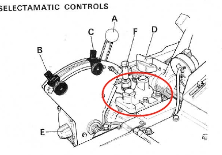

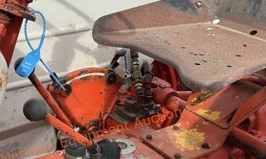

Hi Momo, on my 1210 there is a selector lever on the right rear side of the seat that determines if the loader gets hydraulics or the 3 point. My loader has always seemed slow as compared to my other tractors...
Hi,

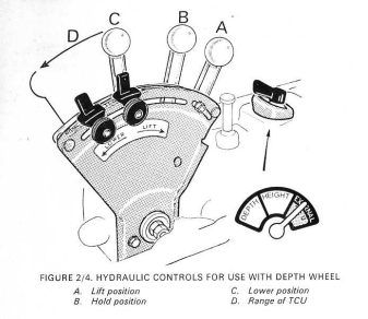

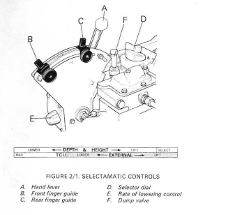

I just checked 1210 manual. The hydro control looks esentially same as 885.
I think you are referring the turning dial "D" in the picture (page 32 in 1210 Manual), correct? At what option the lift hitch works? Left/Depth; Middle/Height; or Right/TCU?
In original design (at least according to the OEM manual), it controls how the internal lift hitch hydro operate (toggle among height, depth, TCU). But I realized the tractor I am dealing with has been modified. The original panel besides the hand lever has been changed, with 2 fittings that go to the front end loader. (red circled). You can see the difference. Does your 1210 come with similar setting?

Hi,
View attachment 62687View attachment 62688
View attachment 62689View attachment 62690
1210 Manual:
A gold mine:

First things first, keep track of the model number when ordering parts. David Brown had the 880, 990, 1210, and 1410 (I think just those?). Before Case bought them I believe the 880 turned into the 885 (I'm not well versed in the older models), but it is NOT the same as a Case IH 885 (that came after the merger with IH, it was a rebadged IH tractor).
Case changed the styling to the '90 series, and they were the 1190, 1290, 1390, and 1490 (then they added the 1690). And changed again to the '94 series, 1194, 1294, 1394, 1494, and 1594.
So I believe some of the internal parts you might need are at least somewhat interchangeable between the 880, 885 (Case or DB, NOT Case IH), 1190, and 1194. Pretty much everything external changed through those models though.
My experience is with the 90 series tractors, not the older models or even the 1190, so take some of this with a grain of salt.
The engine should have a manifold heater called "thermostart". Basically an electric heating element and thermal valve, inside the intake manifold. When the element gets hot, the valve opens and douses it with fuel. That should catch on fire, and warm the intake. The intake manifold will likely be covered in some soot on the inside because of this. The key switch mentioned in your manual is the one our tractors have, turning clockwise it is off-on-manifold heat-start. The heat position is right before start, you have to hold the key turned. Some other tractors used the left of off position for manifold heat or glow plugs, but it still should be spring loaded to the off position. Maybe in WA where you are it's warm, and you never even need cold starting aids, but... NEVER USE ETHER AND MANIFOLD HEAT AT THE SAME TIME-(bang, boom, other cool details, etc.) Here on the frozen tundra I'm well versed in cold.
The selector lever Frank(Mi) mentioned is the hydraulic pump selector, I think. The 1390s and 1490s have two hydraulic pumps, one in the transmission and one (besides the power steering pump) on the front of the engine. I think the 1210 is similar. One runs the hydraulic remotes, and the other runs the lifts. Or you can move the selector and have doubled hydraulic flow to the remotes (both pumps), and nothing to the lifts. Handy for loader work when you don't use the lifts. (There is a plastic knob by the left end of the lift rocker arm, that can mechanically lock the lifts in the fully raised position. That way it can't leak down hydraulically). I believe the 1190 (and the 885?) only has one hydraulic pump, so you wouldn't have that feature on yours. I know the hydraulics on ours are not fast even with two pumps, so slow might be the only speed you've got.
If the PTO is the same as a 1290, the transmission hydraulic pump is driven through the PTO drive shaft. That means when the PTO clutch is disengaged the hydraulics will not function (the lever left of the PTO is not the clutch, it's a shifter for the PTO. Engaged or disengaged). If you have a "live" PTO (PTO driven through traction clutch) when you step on the clutch pedal you won't be able to lift the loader, the hydraulic pump won't be running. I think your tractor has a "semi-independent" PTO, it has it's own clutch but it's controlled by the same clutch pedal. Half way down disengages the wheels, all the way down disengages the PTO/hydraulic pump.

Per manual, the 'thermostart' is in the fuel pump, a butterfly valve, and it's optional feature. On this tractor, the buttlerfly knob is gone (or never existed). Since it fires up every time eventually as long as the battery is strong enough, I have not digged into the thermostart yet before solved more critical issues (lift hitch, sinking loader, milky oil, frozen brakes, rusty links).
The hydraulic system on this tractor has been modified in pretty redneck way. They cut off the top of "connector plate" (part#K917127), and welded 2 fittings that lead to loader control valves. Homemade quality welding. According to the diagram, in this way the pump feeds pressure to the loader directly.
Manual says the pump is driven by PTO shaft. So you should be right, in theory the pump should stop when PTO shaft stops. I didn't notice that yet. Too many things to worry about (vague shift, stiff clutch, throttle don't stay, loader keeps sinking) As a newbie, every time sitting on the tractor is as scary as rodeo for me.
